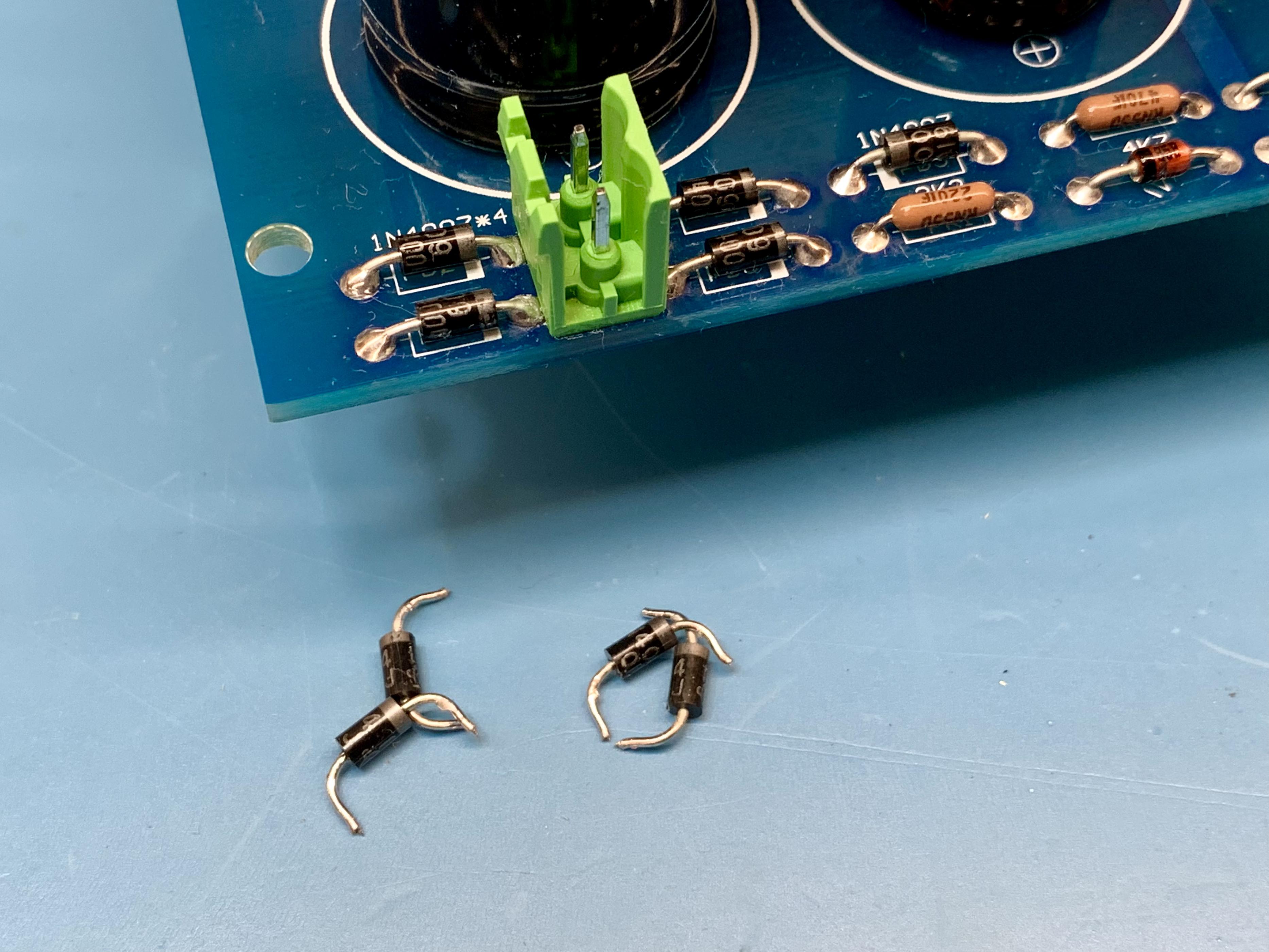

All was working well with input and output VAC being shown on my DMM with input from the sig-gen. Good start! Then I attempted to connect my o’scope grounding lead to the board and the smoke gods got angry. The boards are floating ground right now, so presume my scope ground caused an imbalance or surge of some sort and took out at least one, probably two bridge diodes. Reckon I’ll try a CL-60 to ground to equalize things and try again after I replace the bridge diodes. Surrounding circuits test good compared to the good board.

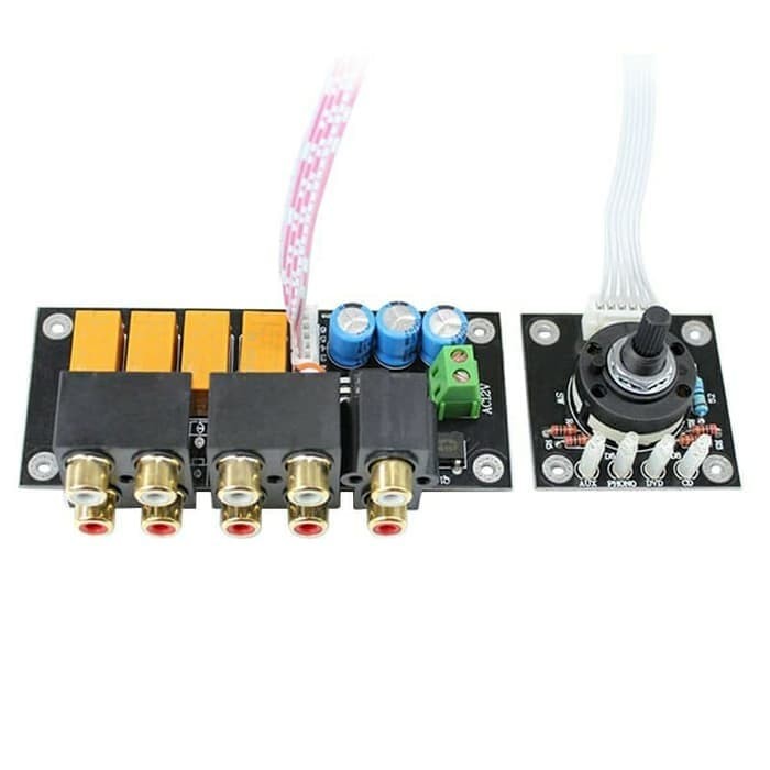

currently my dcb1 has 3 output : direct to J2, to subwoofer, and to minidsp, while amb a20 might have it's place later.
due to subwoofer output is mandatory, i'm planning to use this rca input selector to become output selector. so dcb1 will only see 2 output in paralel instead of 4. at the same time i will only listen to 1 main speaker setup

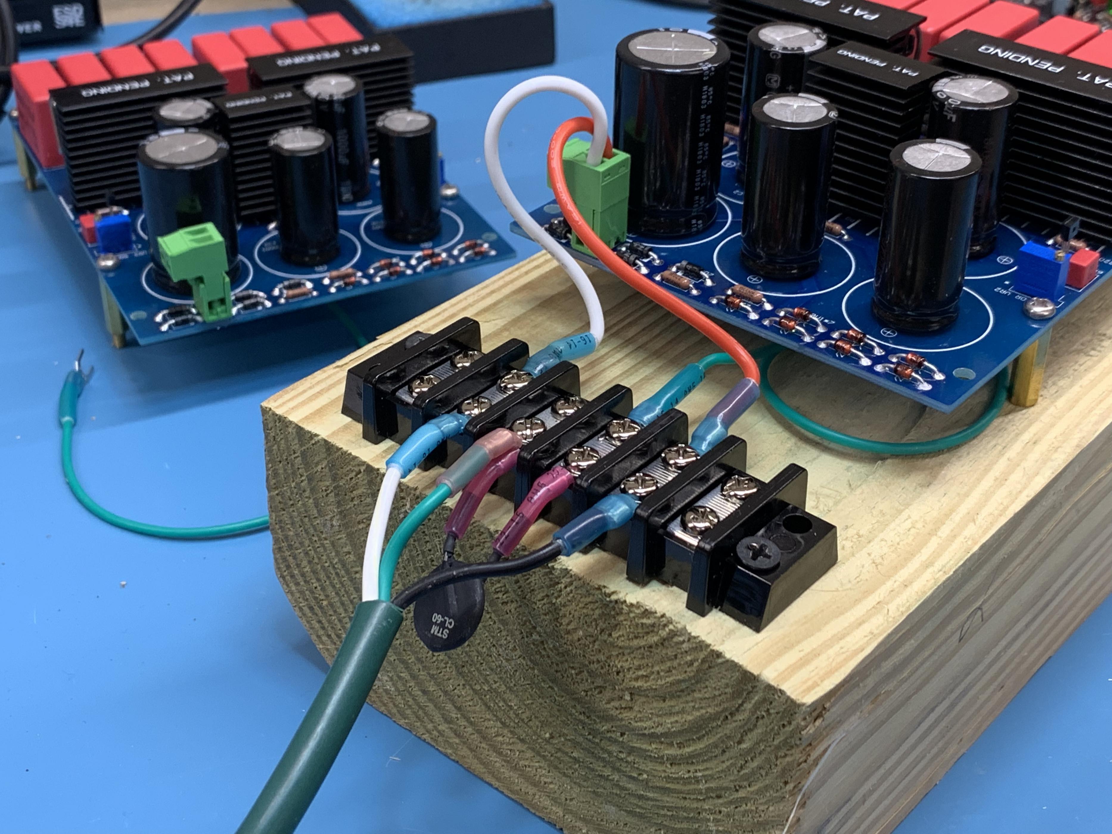

I repaired the damaged bridge tonight. One diode open and another shorted. This damage occurred when I hooked my o'scope ground lead to the ground plane of the board. Sparks and smoke, then no work. I presumed a current imbalance or some such thing because the ground was floating.

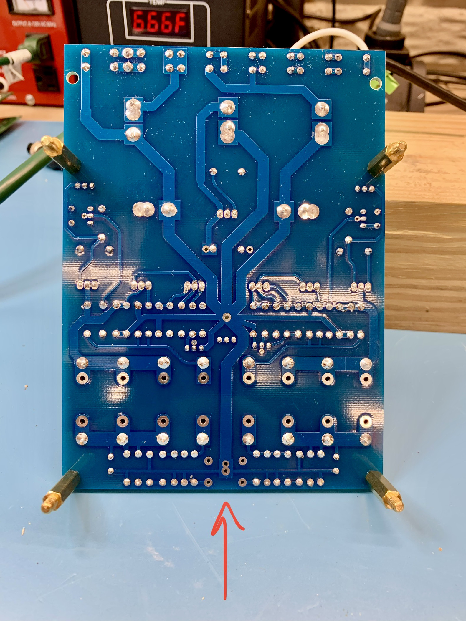

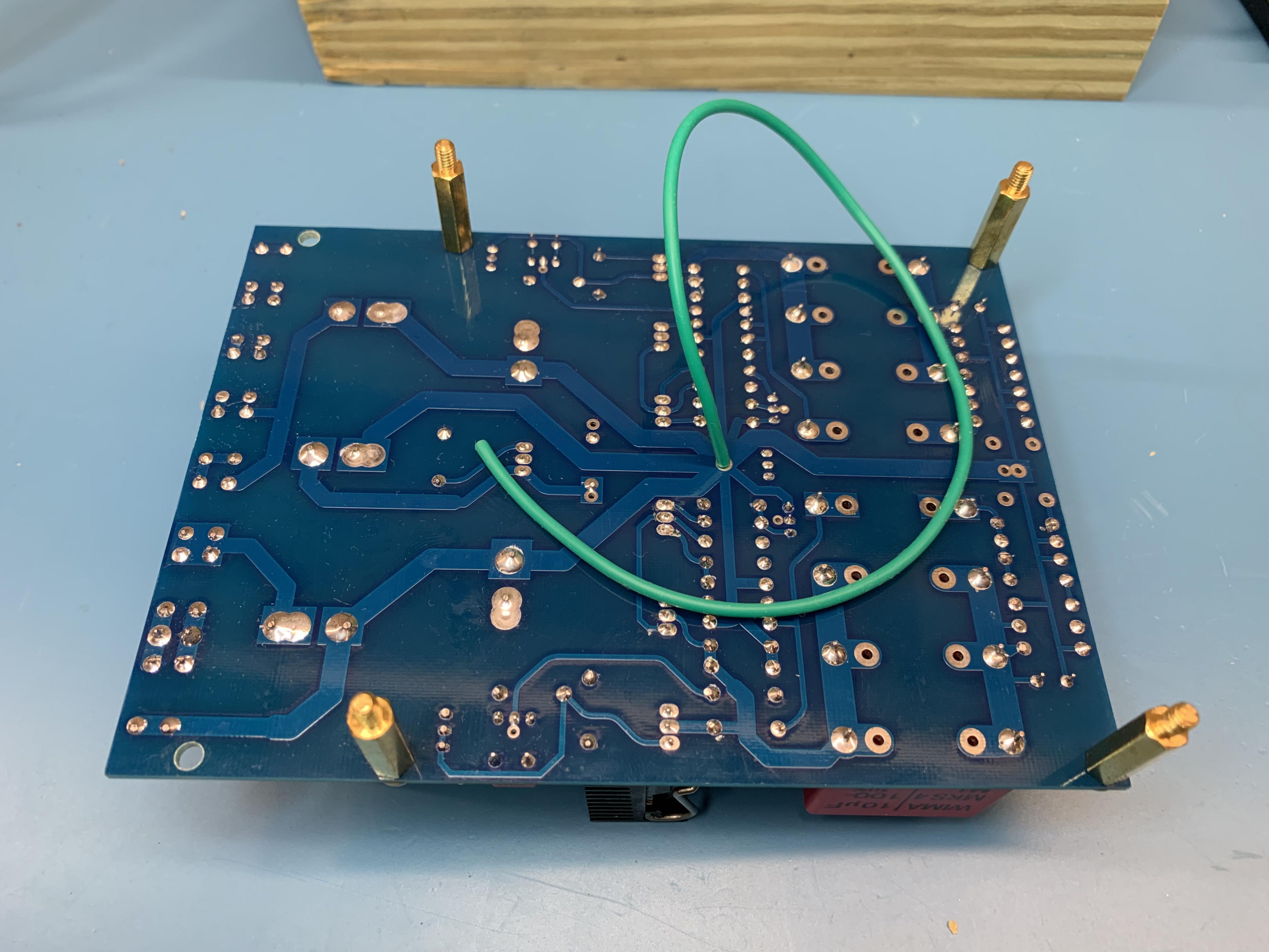

After replacing the parts, I set off on getting a proper ground on the board and attached a ground wire to the star point of the ground collection. The arrow indicates where the signal and power ground come together at the edge of the board. On my test rig, I attached a CL-60 between earth ground from the power outlet/variac and the circuit board. This would replicate how a typical Pass power supply configuration would be in my best estimation.
Ready to test, I set the variac on zero, turned it on, and started to dial it up. No sooner did the knob come up off the bottom than the GFCI popped on the outlet to which the variac was connected. Just for the sake of testing, I moved it to a different outlet on a different electrical panel and the same occurred. If I disconnect the ground, all works as it should and voltages are normal.
So this grounding configuration is puzzling. All the caps, transistors, and FETs are installed in the correct orientation, so nothing there that seems out of sorts. Quite ponderous, indeed. I welcome comments from PSU experts.
