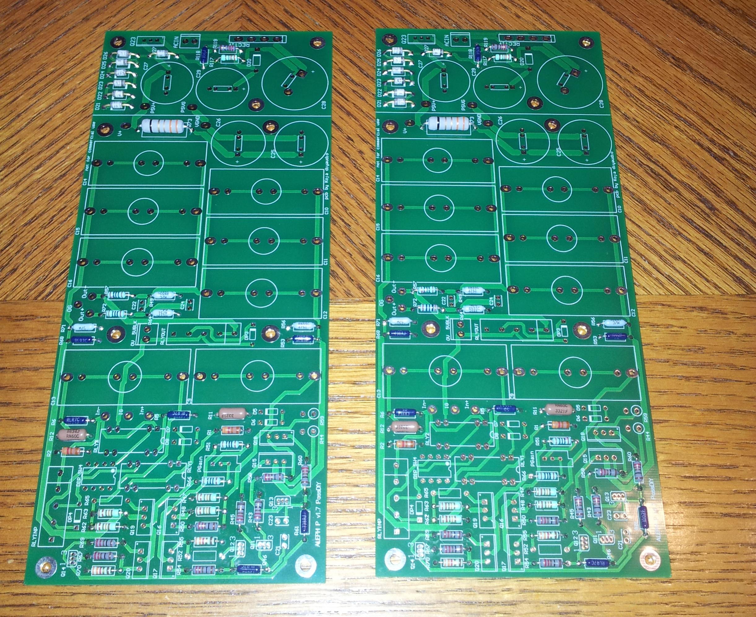

Chris,
I was happily looking at your pictures, impressed by the organization and soldering (something I strive for!).
Where is your Toroid in all of this? Are you using it as the great ZM is wondering? I don't see it in the last pic from post #39.

You’re both correct. Feeding directly from variac. Sounds like this is suboptimal. I presumed since it’s a variable AC source that I could use it to simulate the transformer’s output. I see this is an inappropriate use of the tool? 😱
I’ll get the toroid involved with next tests.

I recognized one of my boards in a post here. Glad to see some are still playing around 🙂. I am routinely using my two AlephP v.1.7 builds to drive anything balanced, even if the gain is not needed since they come with the volume attenuators. They sound their best set to a high internal gain even if the attenuator has to take that back down. Also use the input attenuator to reign in hot sources. Check out old builder's thread for pointers.
Yep! That was my P1.7... I also built a second one for a friend and he still has that one. Since I retired and moved to an apartment, I have drastically down scaled my system. But am thinking of building another P1.7 and F5 as an integrated amplifier to drive my LS-50's. That would replace an Arcam integrated I am using now.
Do you still have any boards available?
