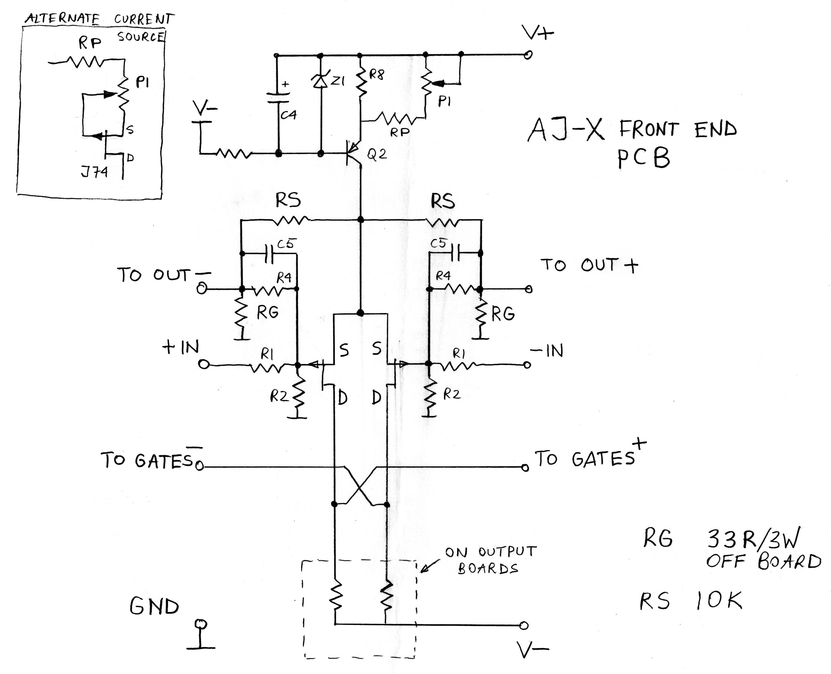

So, can someone tell me what the input impedance is for the Aleph J-X for my PLLXO calculations
Thank You for all of the suggestions with respect to the sodering station, I have looked at them all and have not made a choice yet because I am not shure, do I need the desodering vacume ? Is it best if I just get it now for all of the changes I will be making with my stero now, I will have to take out and change parts I am not happy with or just to see how different parts sound ?
Input impedance is whatever resistance you're using input to ground.

So the input impedance on the given schematic would be R2=221kohms before additional parts for the passive xover ? Is that correct ? I thought it would be R1=22.1kohms ?
nope
R1 is input impedance - for unbalanced
2x R1 is input impedance for balanced
R2 is there to reference gates to gnd , and usually one range higher in value than R1 ;
so - their influence on input impedance is max 10%
example - both R1s are 10K
both R2s in range of 100K
both R4s in range of 47K
gain is ~ 4,7 in balanced mode
input impedance for unbalanced 10K // 100K
input impedance for balanced 2x(10K // 100K)
everything is clearer when you know that gates are virtual ground(s)
in any case - this rough calculation is pretty close to what you can measure or sim
If you're planning to use a balanced output preamp to drive this, you'll need a PLLXO on both branches of the signal. Play with it in a circuit simulator to see what happens if you only filter one side.
ZM, I agree with your balanced case, but I think it's R2 (+R1) for single ended. For the low frequency intended for the PLLXO in this case I don't think the 10% matters. If this was a mid-tweeter XO, I'd be concerned. Papa's A75 design uses R1=475R and R2-75K. Input impedance quoted in the article is 75K. I thought opamp - inputs were the virtual ground and the positive needs a DC reference. Mixing signals into the positive input generates crosstalk, but the go into the negative and there is no crosstalk. Could be wrong, though.
Edit:
Following the calculations outlined in the A75 article, the positive input impedance is 243K, and the negative input about 11.5K.
from http://www.passdiy.com/pdf/a75p1.pdf
