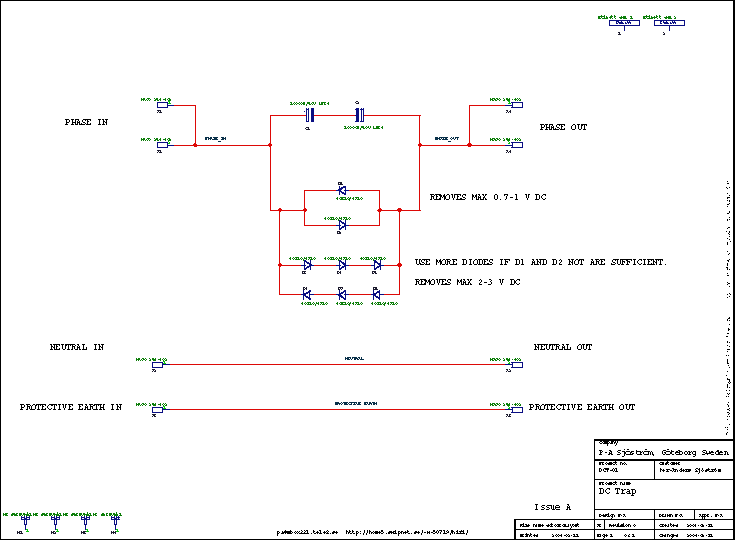

Power Supply DC Filter
Hi Everyone,
I have a problem in that I know nothing about DC filters, aside from the ten electrolytic 6800micro Ferrids capacitors with one 0.15microFerrids Film capacitor placed just before one of the AC lines into the Power Transformer(see Power Switch schematic below, I have discribed what is supposed to be in the green box labled DC Filter, I dont have an image of this on my computer, just a hard copy of it and I dont have a scanner), some how this dose not seem like a good solution, is it ? I wouldnt know ? I found another one on the internet is it better, it is made up of two electrlytic capacitors mounted with the negitive inputs linking the two capacitors with the positive terminals each linked to one of the AC inputs on the power transformer, and also some diodes (see schematic below).
Thank You for your help.

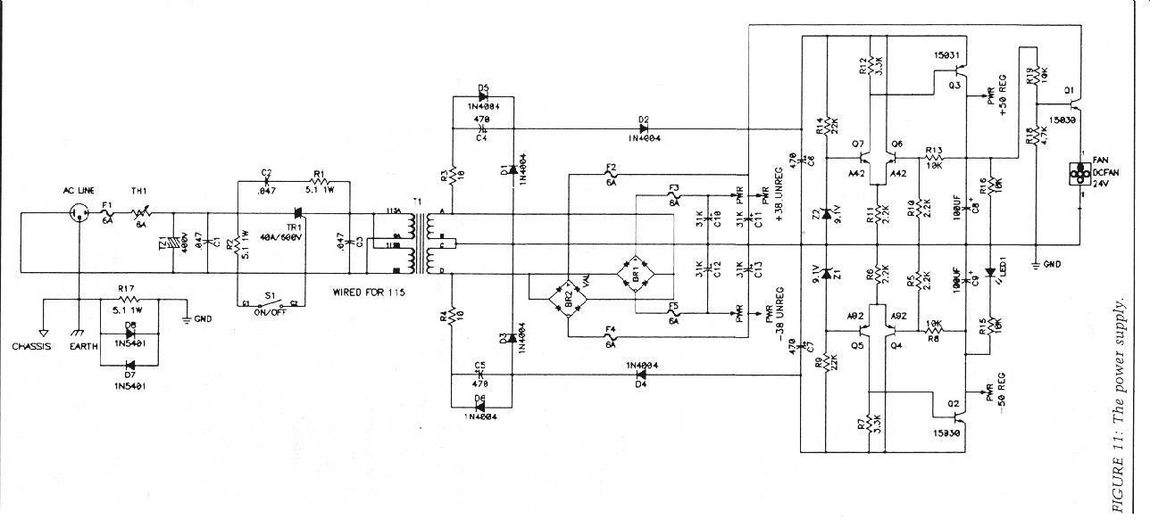

Can anyone talk about a Power Supply DC Filter hypothesis
Hi Everyone,
I have not herd from anyone yet discussing DC Filter theory, did I miss it ?Is it important to address a power supply DC Filter at all ?
Help ?

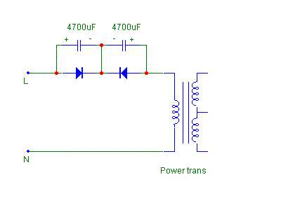

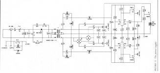

If you have significant DC or distortion on your mains it becomes very important to keep your transformers from mechanically buzzing. Many of us get along just fine without a DC filter. You might want to leave space in your chassis in case you need the filter and just try without it and see what happens.
The DC blocking for dummies version of the theory (at least as I understand it) is the diodes block a DC offset up to their forward conduction drop. That's why some of the circuits you posted earlier allow for multiple diodes, you may have more than .6VDC on your mains.
When the mains voltage swings above that drop, the diode conducts. When the main voltage swings back down below the diode drop, the diode stops conducting and the capacitor conducts the AC portion of the mains voltage until the voltage goes more negative and the other diode begins to conduct. repeat on the positive going part of the cycle.
Pretty simple really, the diodes block DC and the caps conduct enough to smooth out the waveform. If the load was perfectly resistive there wouldn't be a lot of current in the caps. It's not, and there is, so be sure that they are rated for a ripple current in excess of the line draw.
Edit: The A75 power supply you attached has no DC filtering. It has some RFI filtering for mains carried noise and that generated by the triac used for switching. RFI filtering is a good thing (the line rated caps across the mains, ad the MOV for spike protection). It also has an inrush limiter, TH1. Works fine leaving it in place although many would have you bypass it after the surge.

DC filter & other power supply B4 transformer topics
Thank you for this detailed comment, I have a better understanding of it but have to read it a few times b4 I can research what you have told me.
How do I bypass the inrush limiter after the surge, a pysical switch ?
I have not ordered a Triac, is it importent, I know nothing about them ?
