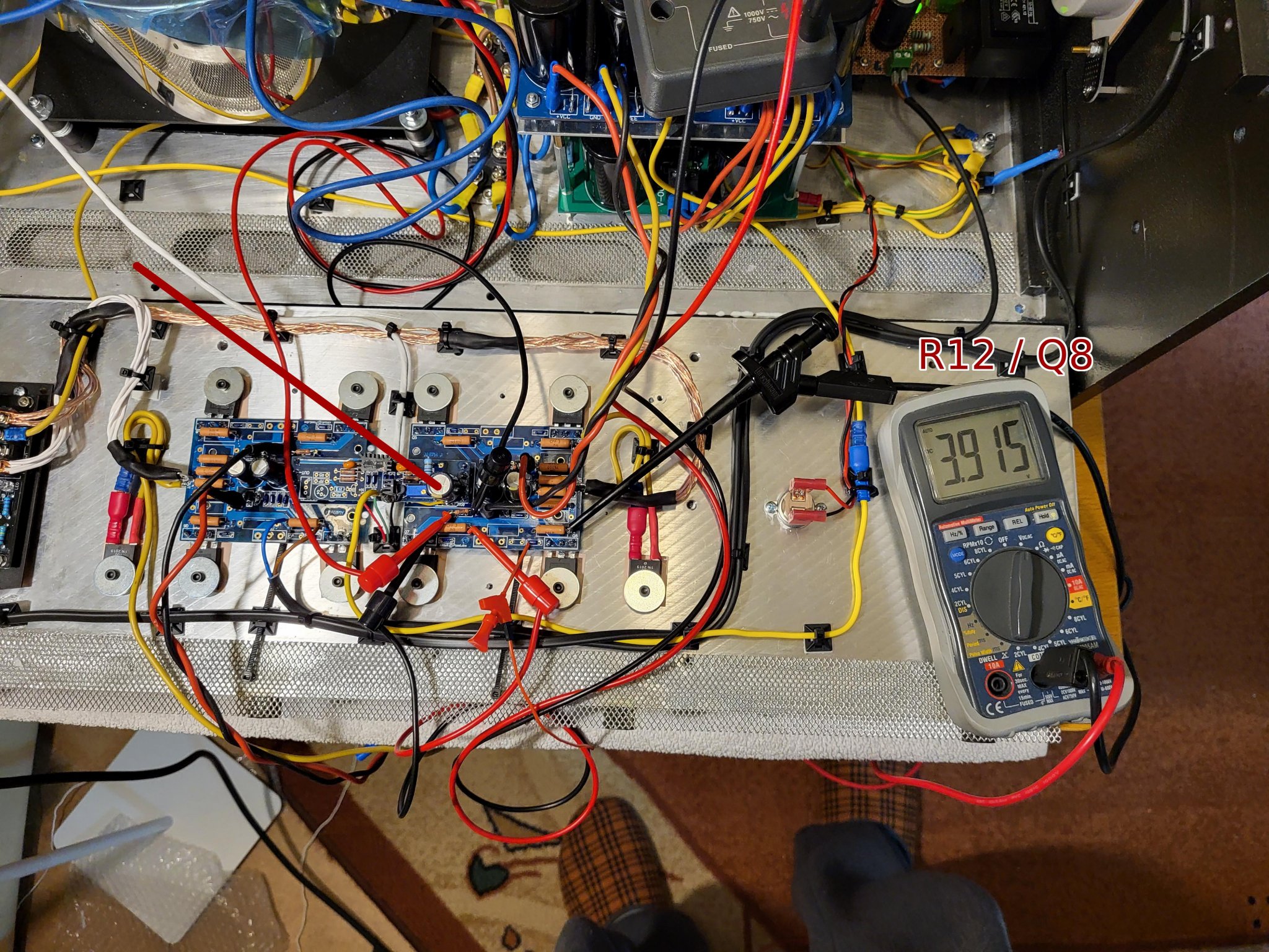

Hello Zen-Mod, Thank you for your help.
I removed the lamp.
R7 = 4.6 volts
R2 - Q8= 4,0Volt
RP= 0.58Volt
Out = 0.1 mV
Will now connect the Planite Symmetrical.
I removed the lamp.
R7 = 4.6 volts
R2 - Q8= 4,0Volt
RP= 0.58Volt
Out = 0.1 mV
XJ Balanced connected.

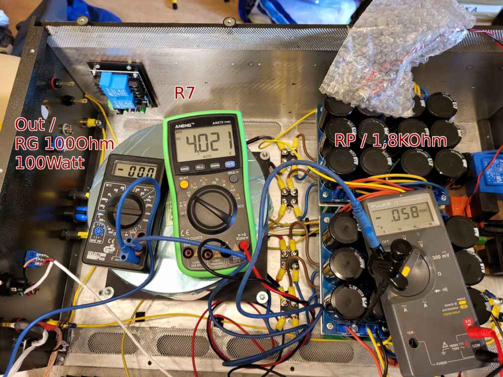

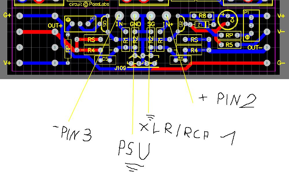

My aleph XJ is not working proberly.
RP = Euvl Version J74, capacitor + after Rp before P1, - ground.
Measuring points
R7 = 4,3V setpoint.
only + circuit board
R7= 4,6 V
only - circuit board
R7= 2,21V
sym. boards (+ and - board )
R7 + Boards = 3,4V
R7 - boards = 4,3V
Measuring points
P1 over R16 .
R16 = 0,55V
R16 = 0,05V
R16 + board = 0,00V
R16 - board = 0,52V
Measuring points
R9 - R16 = 4,3V setpoint.
R9 - R16 = 4,0V
R9 - R16 = 3,89
R9 - R16 + board 3,89V
R9 - R16 - board 4,19V
Out over RG (100R, 100W) max 50,0 mV DC
out only + board = 10,32V
out only - board = 0,00V
Out over + Board and – Board = 16,2 V
I hope the measurements are understandable.

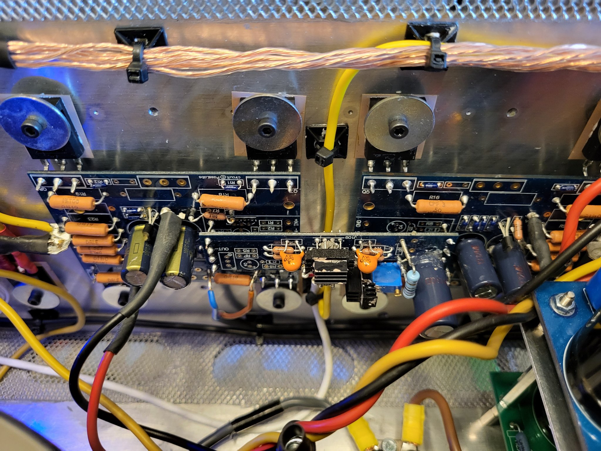

My question, is 2SJ109 (Q1B) defective?
Pictures only with connected + board.
Lg Dirk

I believe there is setting procedure explained for that actual physical arrangement
try to find it
if not, hope Guys who made it will chime in with help
in any case, ground both inputs, outputs without load, for setting procedure

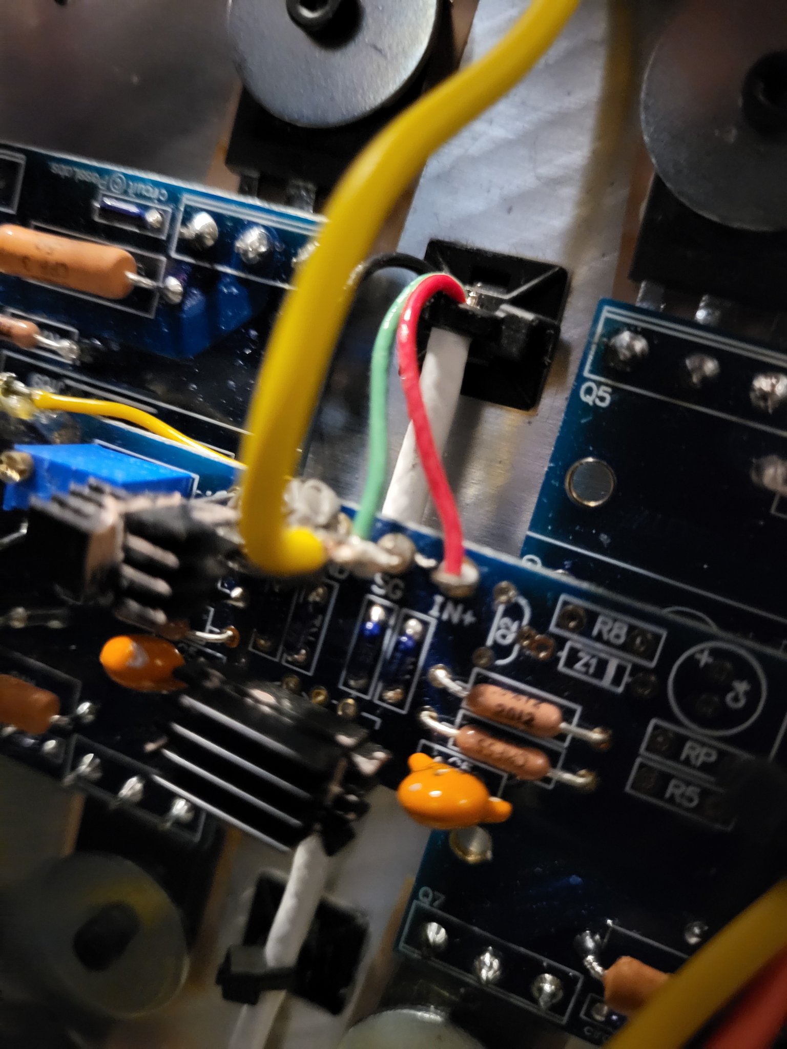

Hello Thanks for the help.
The amplifier sings.
But I still have a small problem.
If I have connected both channels via rca with a CD player, a slight hum comes out of the speakers in the break position.
If only the right or left channel is connected, the humming is not there.

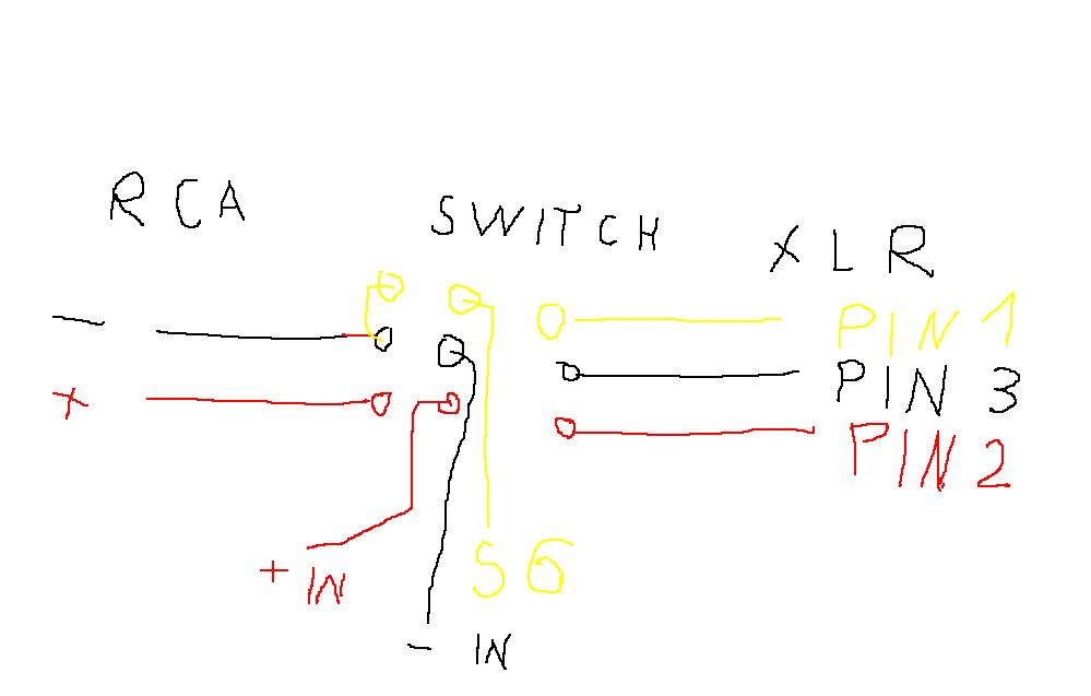

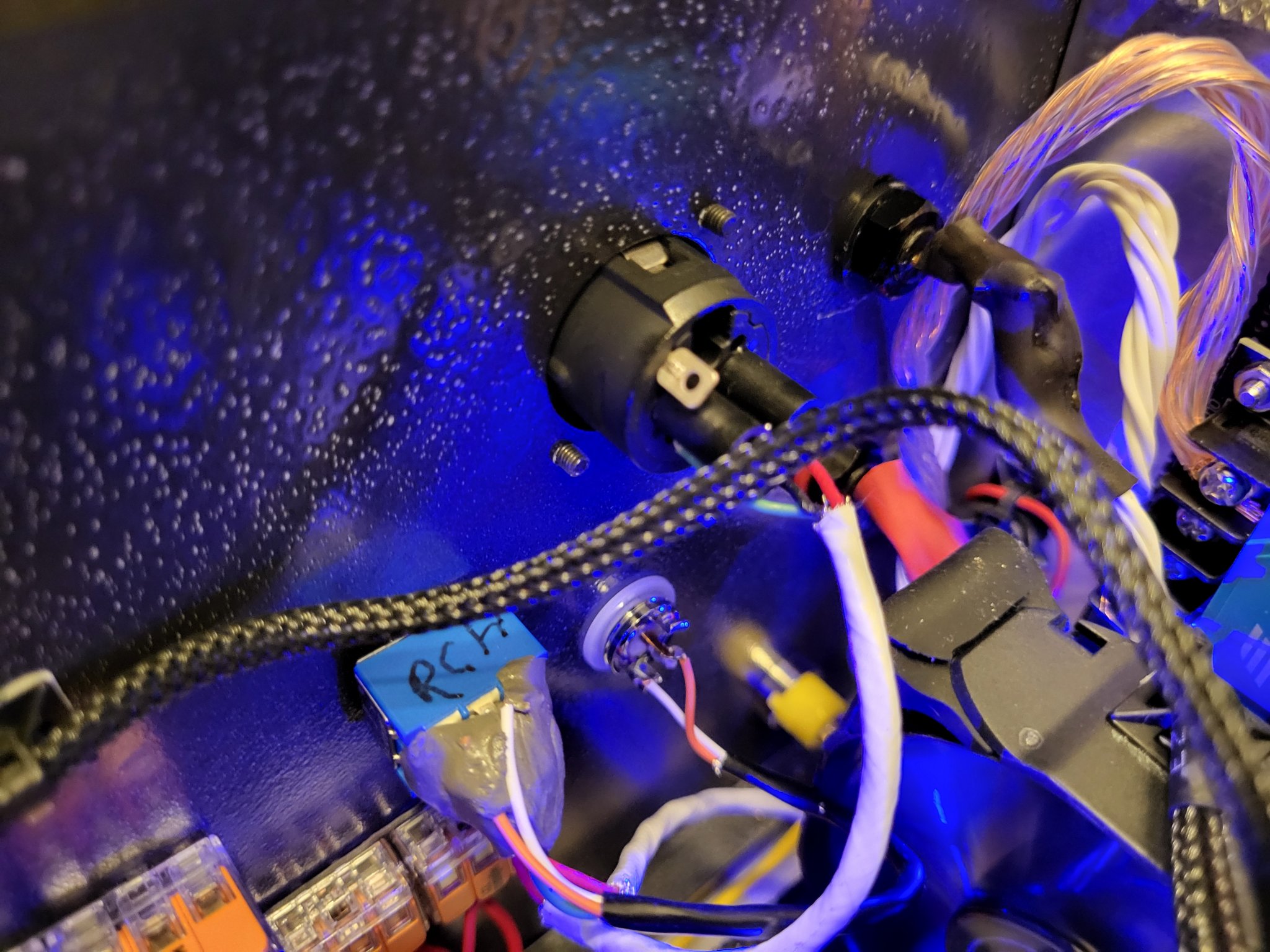

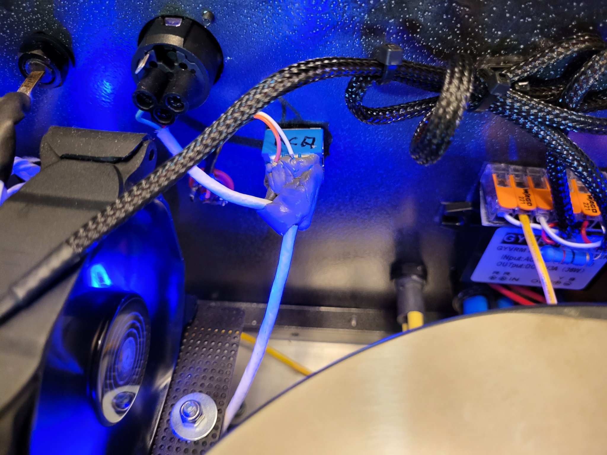

I have a switch for switching between XLR and RCA.
IN the RCA position is negative and mass is bridged.
Could now only take pictures of the assembled amplifier.
I don't think this is very strong.

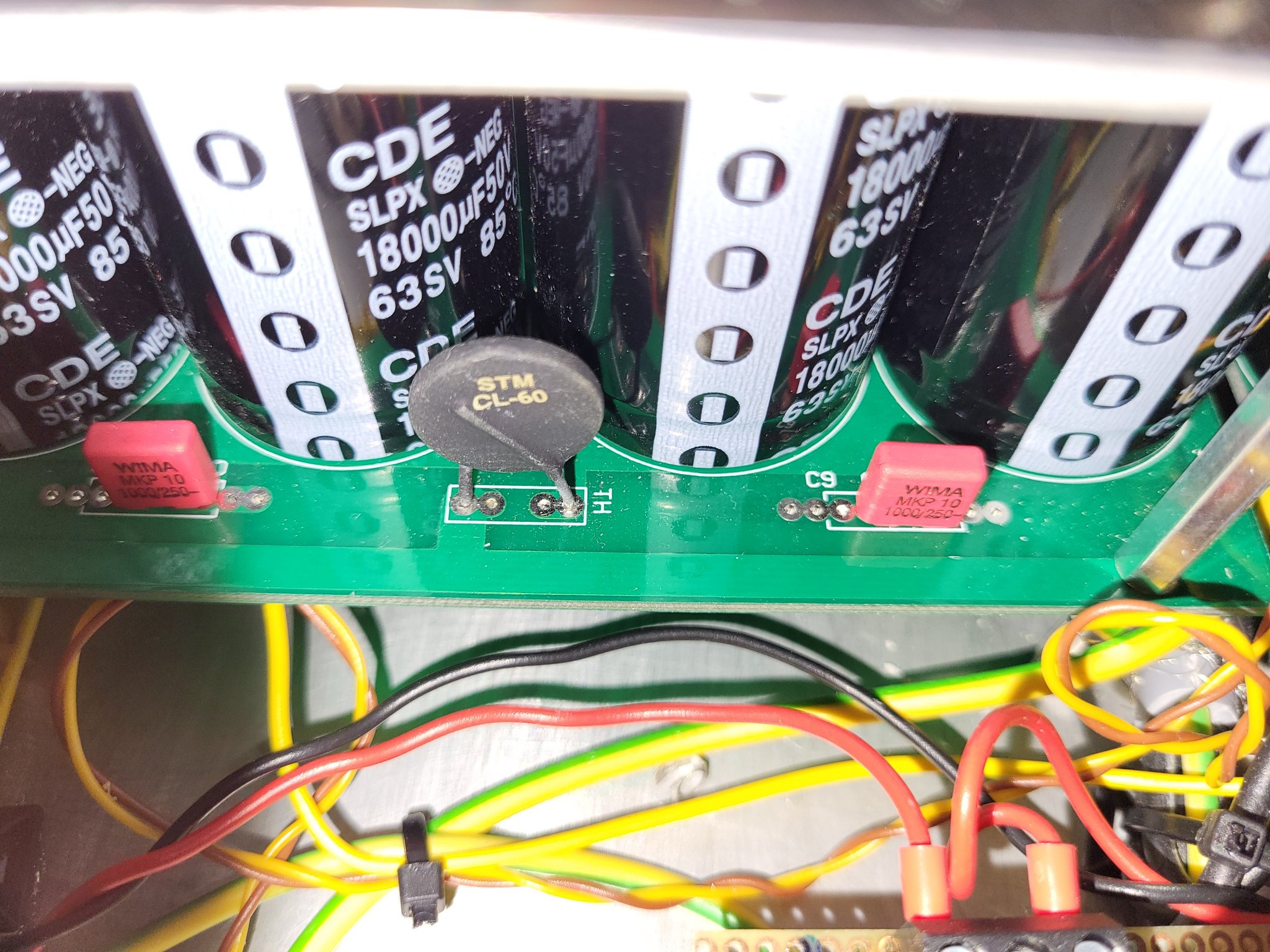

is that coaxial input cable properly connected - how you did connect screen?
what is happening with hum when both channels are having inputs shorted?
do you have NTC between audio GND and case/safety GND?
Sorry the bad drawing hopefully can recognize something.
Both inputs RCA short-circuited, no humming.

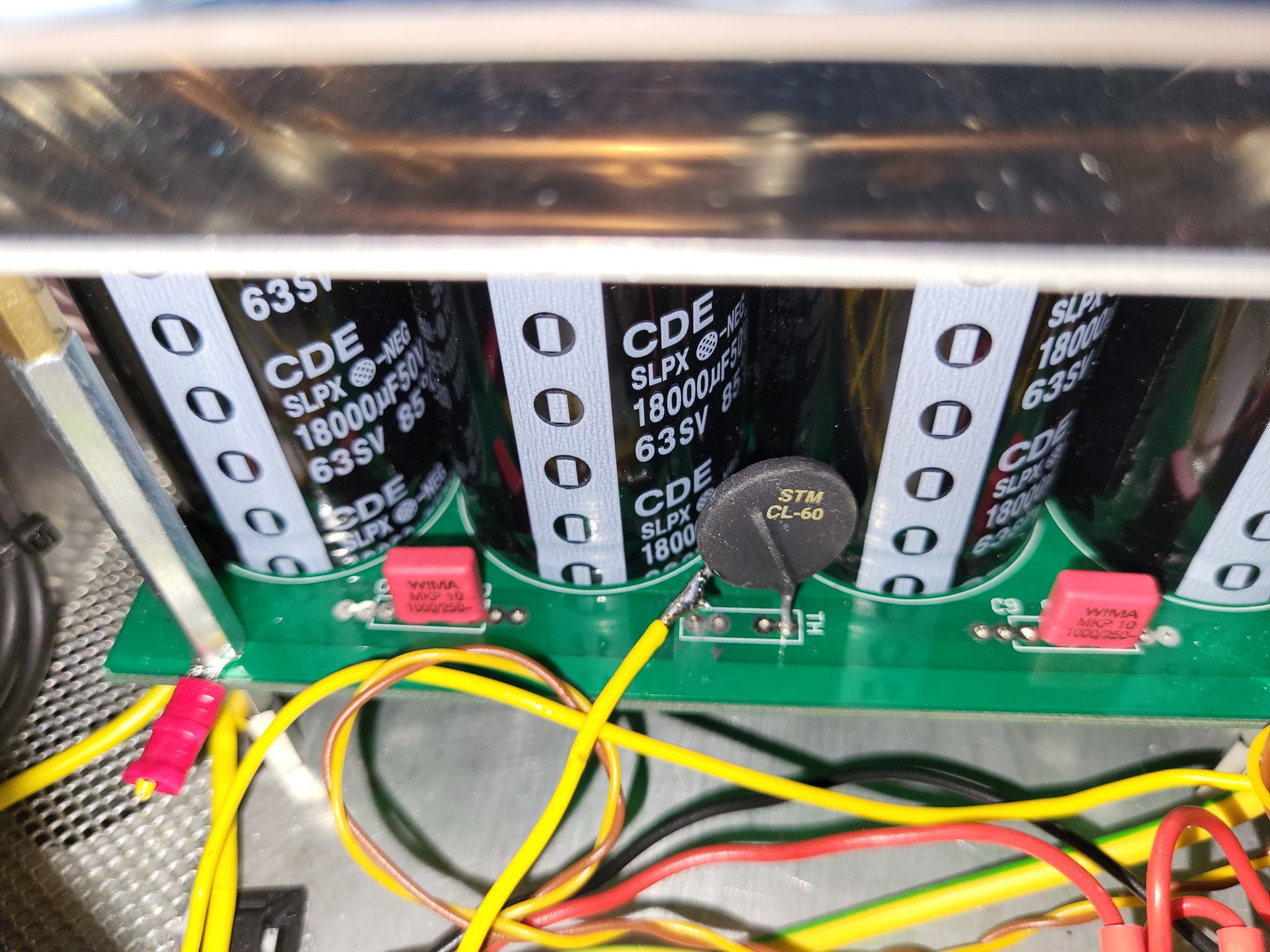

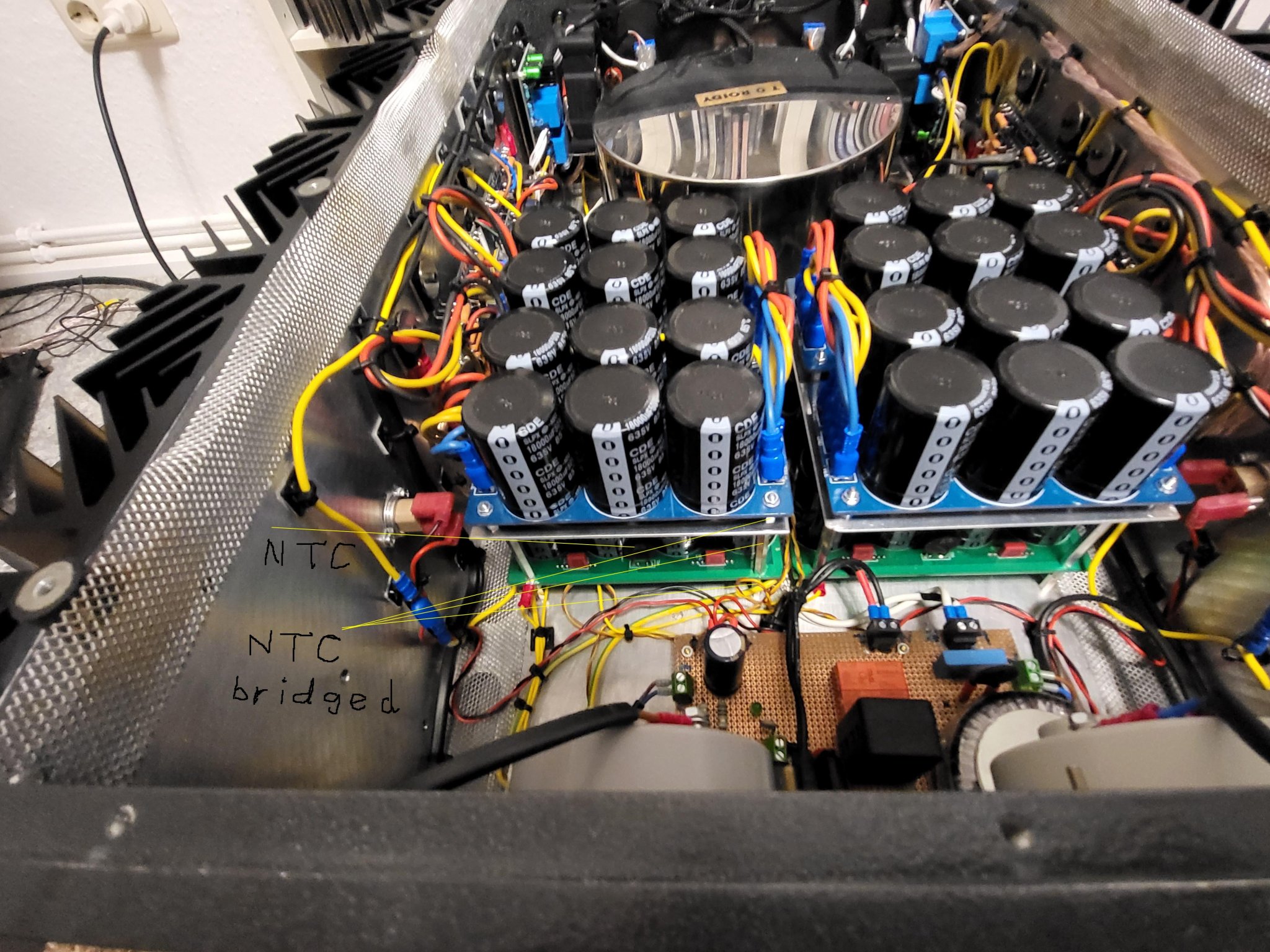

I found an error.
NTC on 1board, 2 pcb connected to metal abtan holders, NTC bridged.
( Only CD player (Euro plug) slight humming. CD and preamplifier (Schukostecker) very strong humming.)
I found an error.
I found an error.
that means - no more hum, or it is still huming, with preamplifier connected?
now, you know that - when one apparatus in chain is connected to safety GND, you can lift other ones from safety GND, either in organized way ( option in apparatus itself) or with "cheater" plug - sometimes even simple isolating Schuko contacts on Schuko connector with sturdy isolation tape is good enough
Error still there, hums strongly with preamplifier.

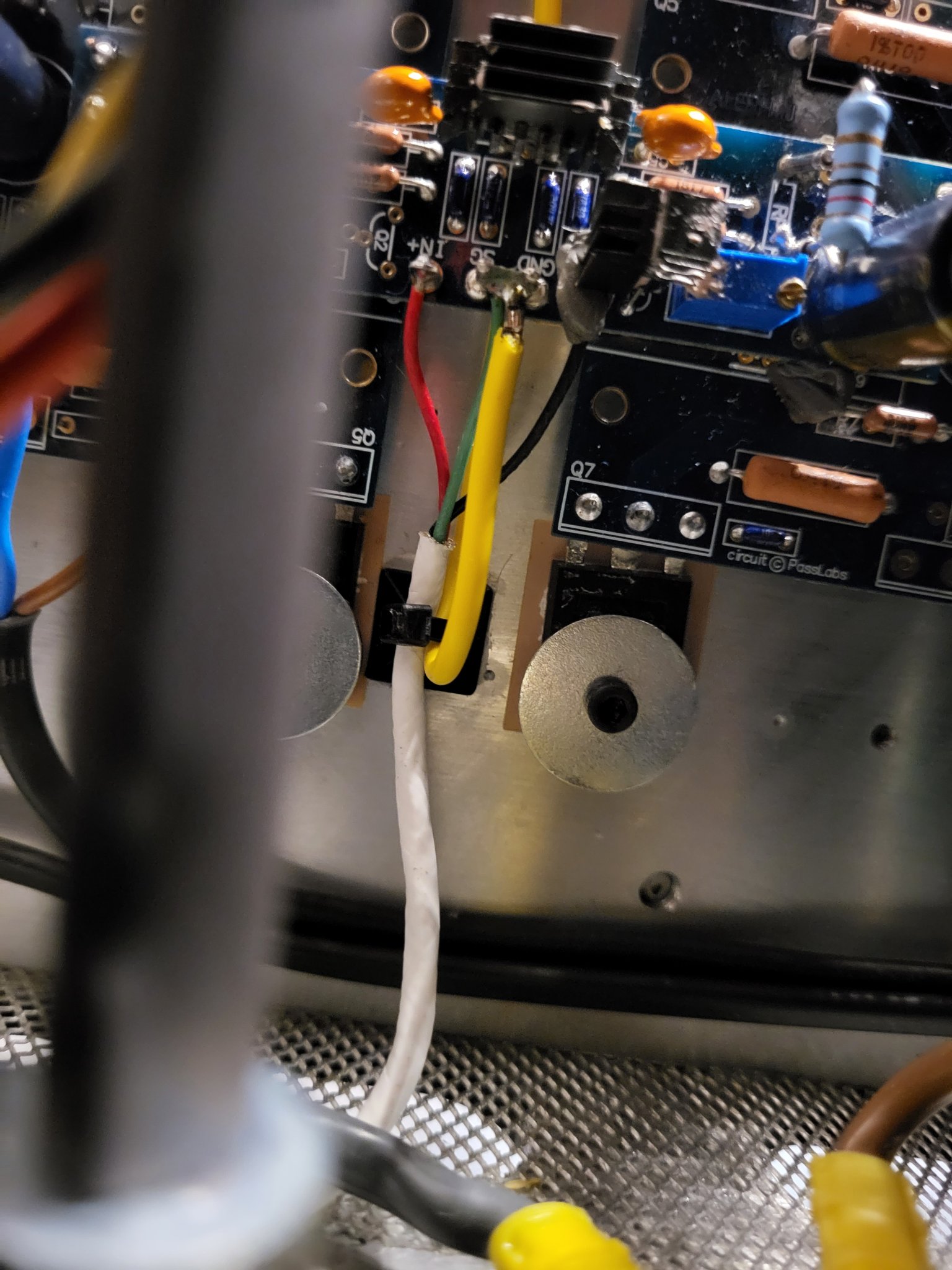

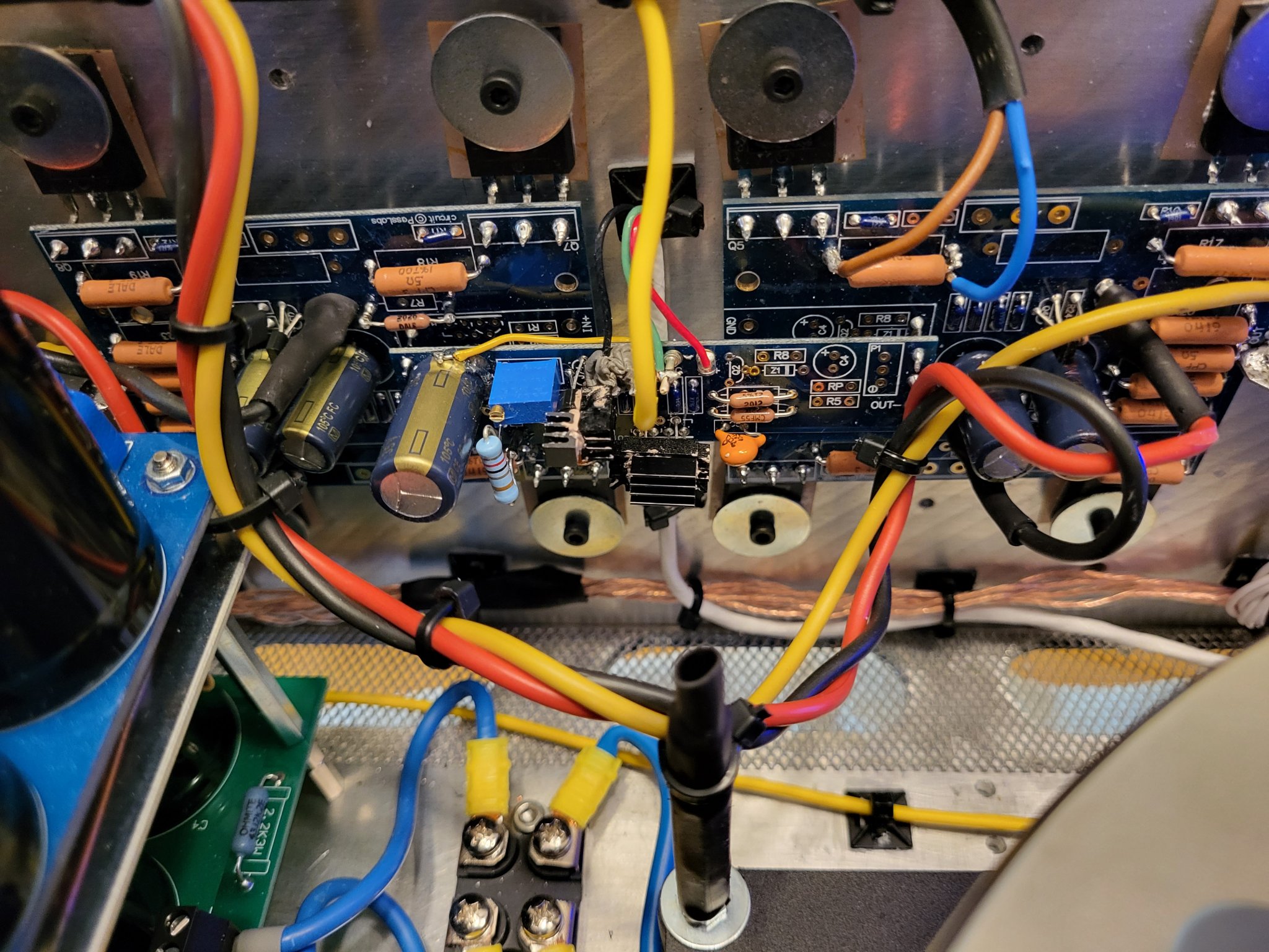

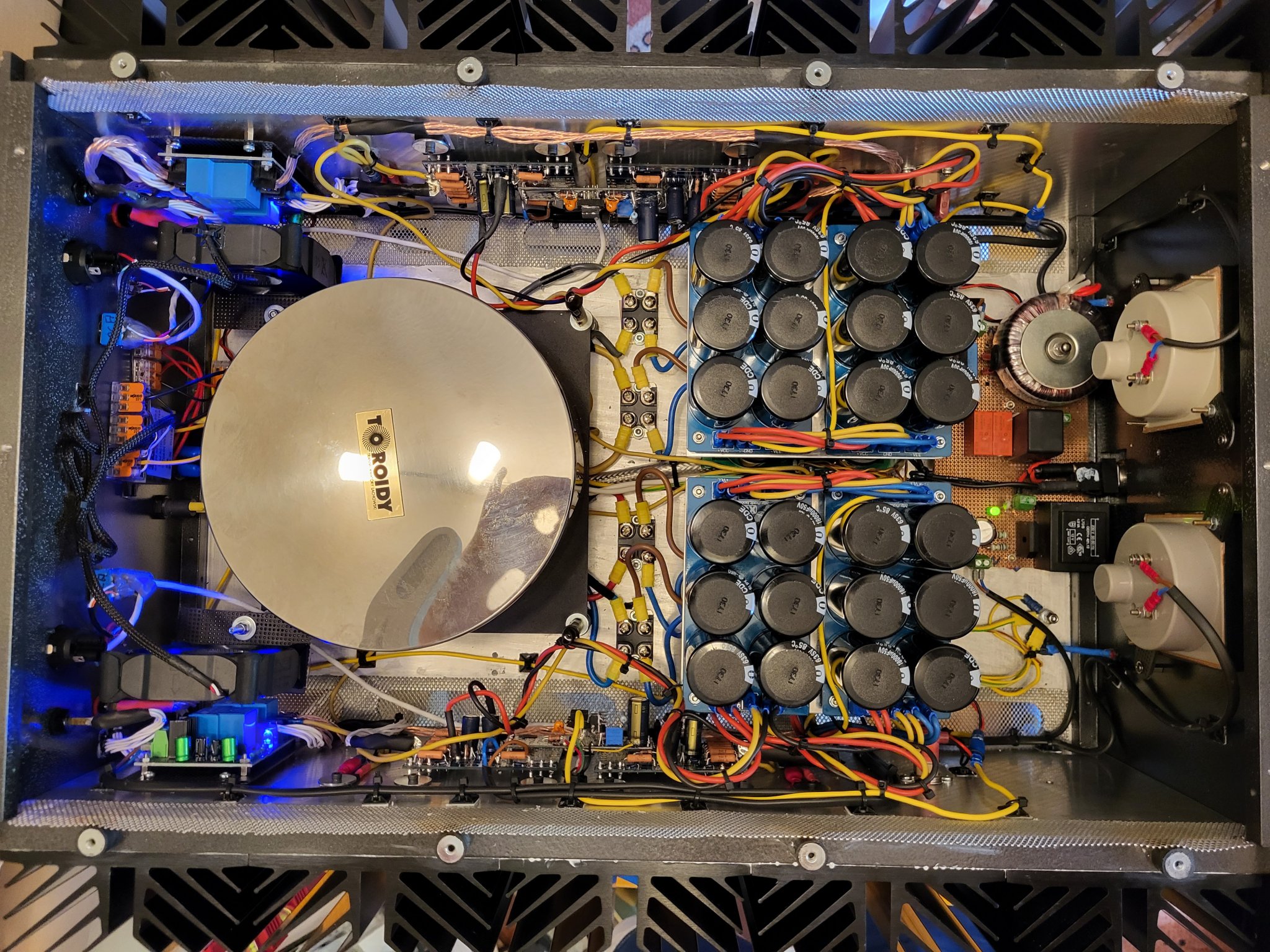

Hello Pos.
1-4 after warming up and adjusting without load, preamplifier RCA and speakers connected.
1. Upper board with capacitors insulated by plastic spacer, Strong hum.
2. Scam plug built, strong humming.
3. 100 ohm resistors installed in the ground line PSU, but no longer rest stable bais. Values are constantly changing.
4. CL 60 mass input removed from the board and placed directly on the star mass.
The amplifier starts to swim, no longer holds values and knocks loud 50 HZ.
With and without a scammer plug.
LG Dirk

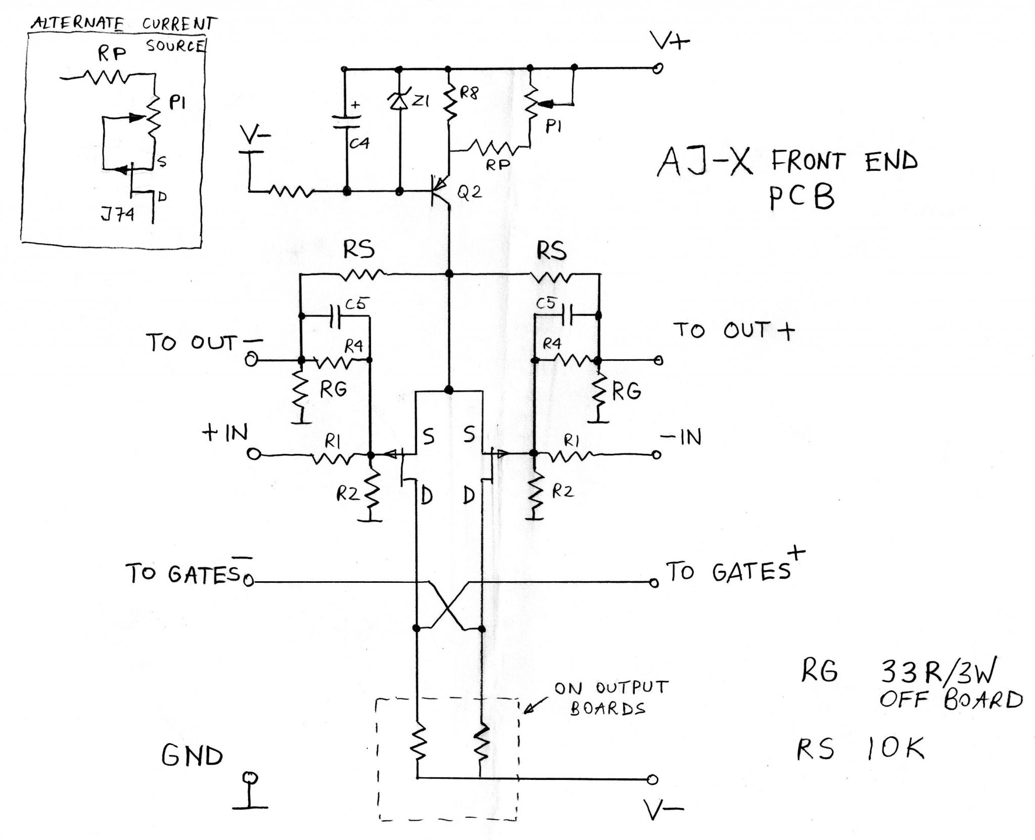

Hello,
the JX sings wonderfully without humming, but the Bais values always change.
One day the values hold, the next day they change continuously.
I now want to build Peter's circuit using BJT, but I can't find a value for RP and P1.
After looking at the JX circuit, P1 / RP are parallel to R8 (1KOhm original J).
If I can take R8 2.2 KOhm, RP 1KOhm and P1 5KOhm, then I can regulate below and above 1KOhm R8.
