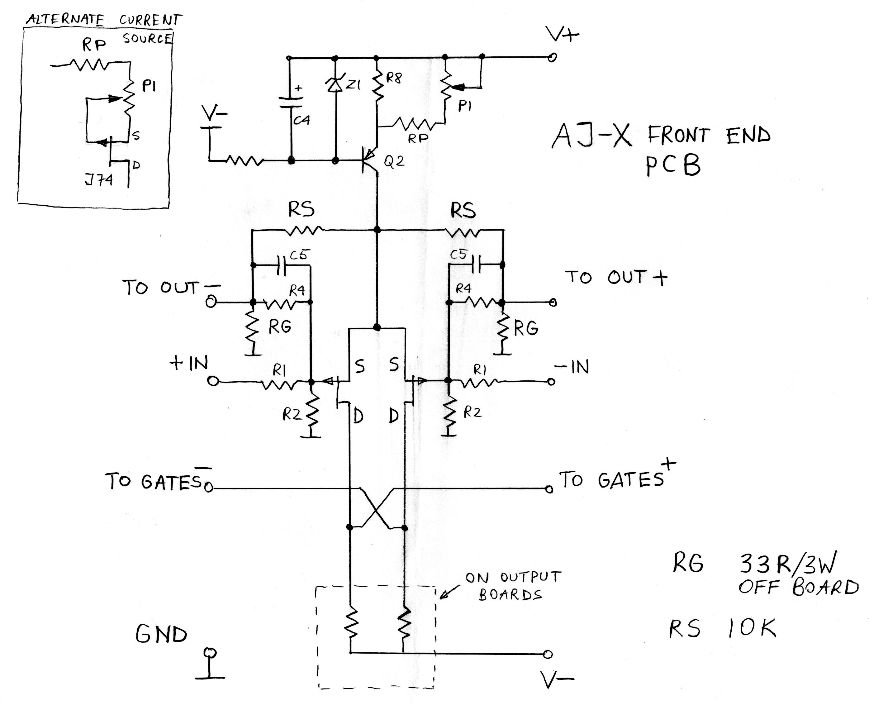

If I use dual 15v secondary transformers...
Much appreciated if I (a newbie who built myRef and VFET by straightly following build guides) may get some help on a potential build of JX.
I have gathered the following parts so far:
-Peter's pcb;
-2 matched pairs of J74 BL; and
-some 20 IRPF240 (not yet matched).
Q1: I happen to have 2 piltron 300VA transformers with dual 15v secondary. I don't want to spend money for 18v secondary transformers. Do the resistor values need to be adjusted for a lower rail voltage? I seem to read somewhere that R8, R25 & R26 etc. need to be adjusted. I am happy with a low wattage (say 15W) amp.
Q2: Is my understanding correct that each channel requires a matched pair of J74?

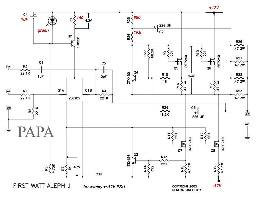

I am trying develop a better understanding on the circuit and came across the attached schematic for "wimpy +/-12V PSU" you posted at post #36 of thread titled "Low watt Aleph J".
Low watt Aleph J
If you don't mind to share with me, what is the purpose of modifying the values R8, R25, R26 & C4, using the green LED and connecting R4 to OUT??
Thanks again!

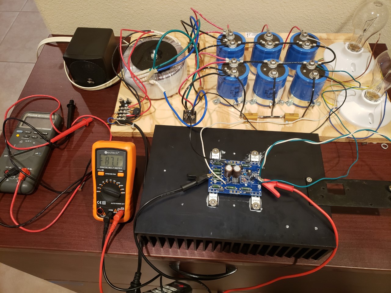

I am bringing this thread back from the dead. After way too many years of collecting parts to build a Pass clone I finally put power on one channel of my Aleph J.
There was no magic smoke so it looks like I put it together correctly. The DC offset started at 92mV and dropped to 72mV after 30 minutes. The heatsink warmed up to 120 degrees Fahrenheit. The PSU is a test PSU that I put together, the light bulbs (100W) were used to test the PSU. I got +-24V when testing with the bulbs. With the one channel powered I am getting +-22.9V. The transformer is a 2 x x18V 600VA Antek, capacitors are 68,000uF / 50V.
The second channel is already assembled, I just need to put it on it's heatsink. I still need to order the material to finish building the chassis.
Next I need to see if this will actually produce sound.
