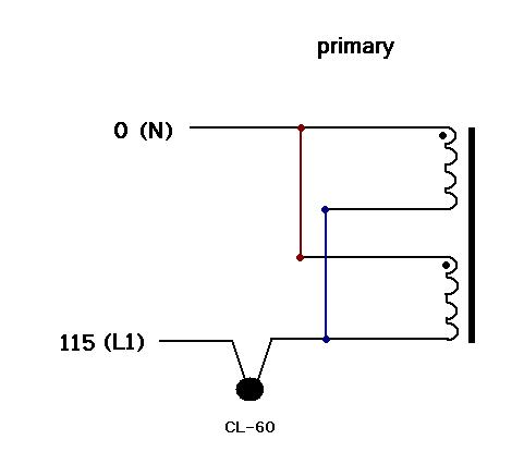

2. I looked at the Burning amp 2 article and decided to add the .0033 caps before and after the switch, along with CL-60 thermistors on the xformer primaries as shown on that PS schematic, rest of the PS is Peter's board.
The CL60's are extremely hot, is this normal? Also the transformer is physically buzzing and I get some slight motorboating that does not change with input level. Should I remove those CL60's and see what happens?
3. My rail voltages were both right around 25v unloaded, now they are 19.8 V+ and -21.2 on V-. Transformer is an Antek 400VA 18Vx2

1. This is acceptable, if you used 2SJ74 for the inputs, possibly they're not tightly matched.

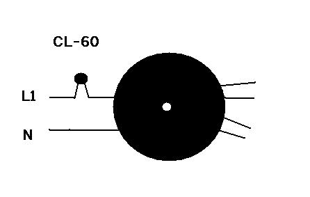

2. When you say thermistors, I assume you are using one on each primary? Only one is necessary, put it on L1. If you're sharing one trafo for the stereo amp, thats close to 4 amps constant draw, it will normally be pretty hot.
3. 400VA may be a bit too small for stereo use, maybe not. Maybe the rail mismatch is due to using two (assuming) thermistors. Remove the .0033 caps, use one thermistor, and see what you get.

Yes I am using one CL60 on each primary, its a dual primary transformer like the one shown in the Pass schematic, 120-0 + 120-0, I have a thermistor on the 120 end of one winding and the other on the 0 end of the other winding. Not sure if that makes sense when I try to type it out.
I will try removing the caps and one of the thermistors and post back, probably will have to wait until tomorrow. Thanks 🙂
