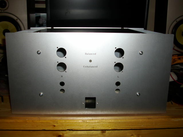

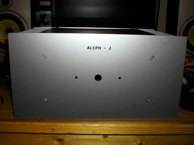

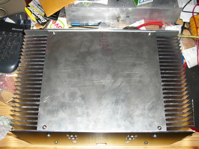

I finished the rough assembly of my Aleph J enclosure and I wanted to share some pictures of it. I still need to finish the top panel, drill and tap holes for the fets and holes in the bottom panel for the power supply and transformer.
I'm wondering if I need to add ventilation holes in the top and bottom cover?

Very nice! Can you describe how you did the front and rear panels with such nice cutting and finishing?
I would add a few holes top and bottom. I used perf material on the top of mine.
Is that 4 XLR openings and no holes for AC power inlet or fusing :scratch1:

Thanks!
The front and rear panels are from Front Panel Express. I'm going to be using Neutrik D series jacks for both the XLR and RCA, so they have the same bolt pattern, the lower pair will be the RCA's. The IEC socket I'm using has an integrated fuse holder so no extra hole for that.
I like having my power switch on the front, so I'm going to use a latching Bulgin vandal resistant pushbutton mounted on the front, it's only rated for 3A/250VAC so I was a little concerned with long term reliability and will be using it to activate a 30A DPST relay.
I might try taking the top panel to a local machine shop to see if they can rout some nice looking cooling slots in it, I don't have anything that can slot cut 1/8" aluminum. Drilling all the holes for this really makes me want a drill press, doing it all with a hand drill kinda sucks haha 😛

Sounds like a great plan. I've always wanted to try FPE but didn't have confidence in things like real world clearances and such to use their application and pull the trigger.
I bought a fairly inexpensive Delta press at Lowe's. That and a step bit will do wonders. I did break down and get a Greenlee punch for XLR's though.
Good luck with the build!
