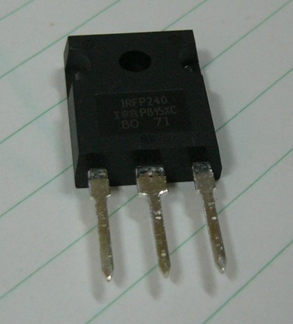

I received my fets from this seller. A very good ebayer. I've read someone saying that there are fakes components. I've brought some IRFP240 at a very good price per piece (please see img 'IRFP240'). Would they be fakes? How do one tell if it's a fake or original? Thanks.
IRFP240's are such common parts, it's hard to imagine why
anybody would bother selling fakes. You can check them
by measuring Vgs, and see if they fall in the range of about
4.5 volts at 1 amp.
