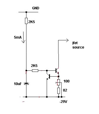

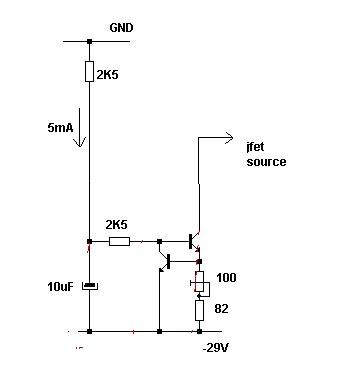

Am I in the ballpark?
sorry - I meant on CCS which you can see in Shunty , not :Pumpkin: 😉
it's here :
(EDIT: you're really nutz :clown: ........ I can't understand what you are doing with these two little bjts there ..... )

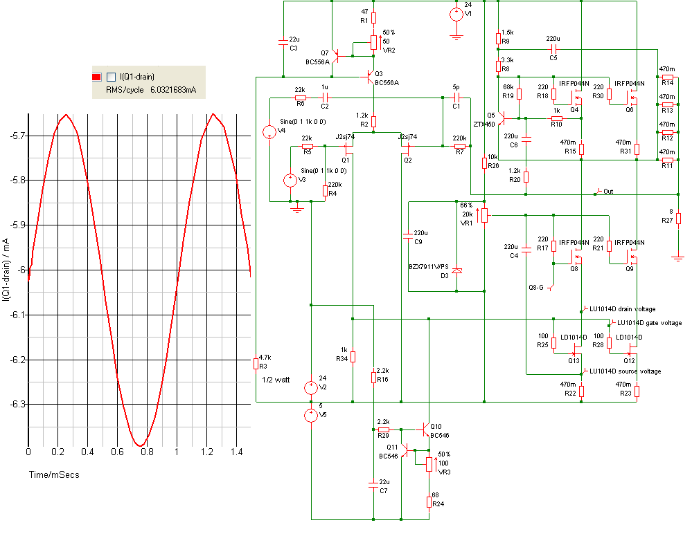

Call me grasshopper? 😀 :clown:

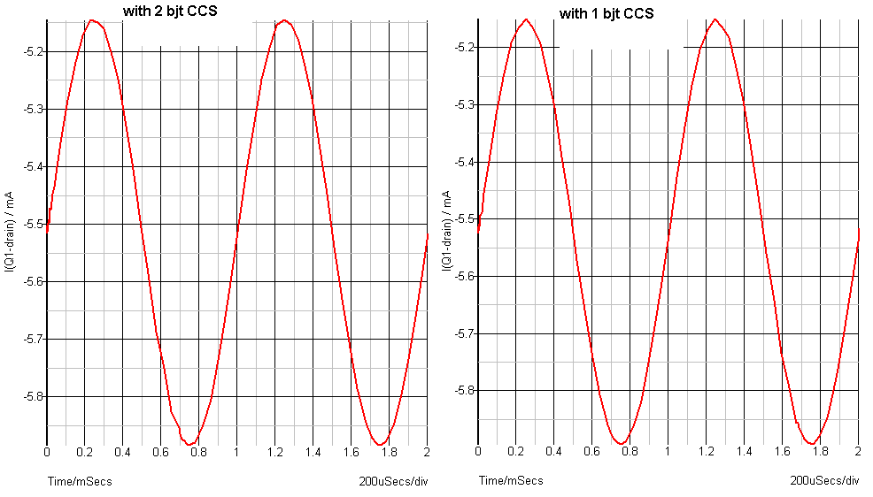

Edit: the little change I made (adding the second bjt) formed a more attractive (fuller) looking sine wave when I checked the current in the drain pin of the diff pair jfet.... there was a little distortion in the first peak, but it smoothed right out by the second.
That's why I thought I might be on to something.

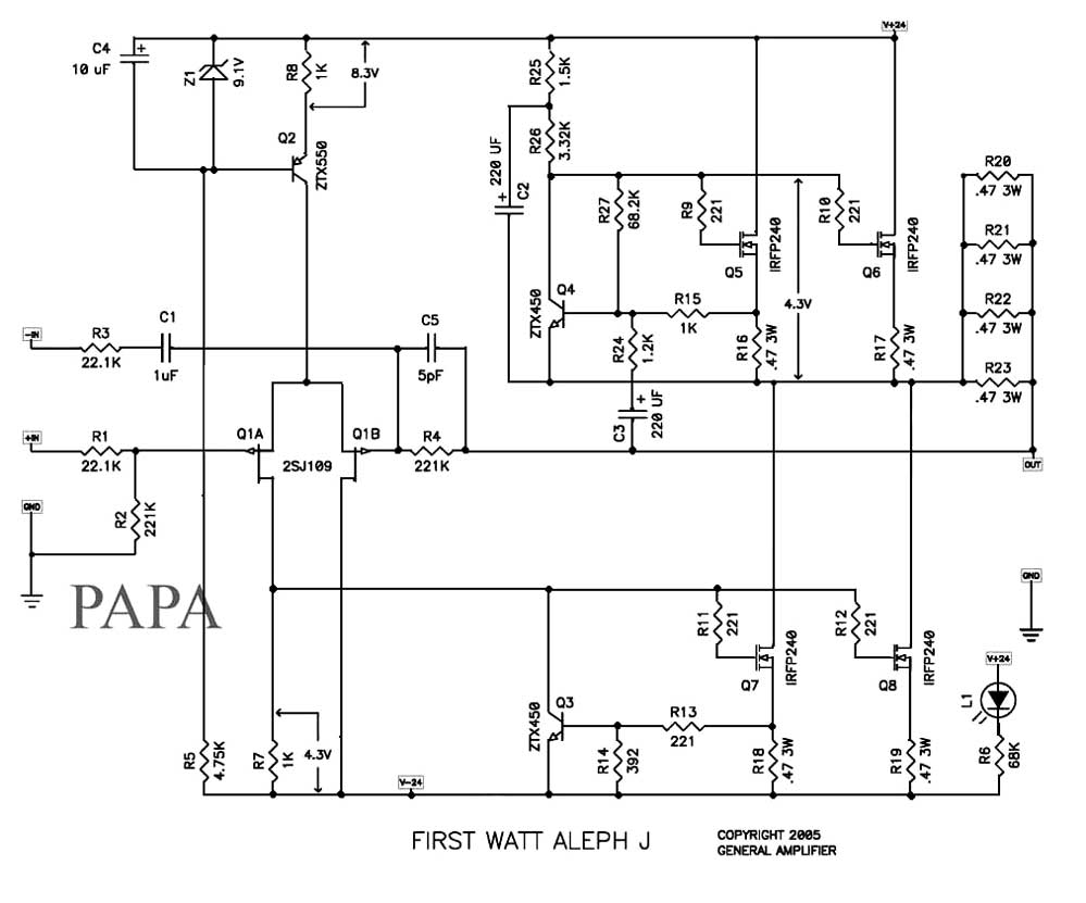

It might be of topic (haha), but I have modified one of my old creations to Aleph J, but the bias current seems to be too high. I'm suspecting that the value of R27 should be much lower than 68k.
My reasoning:
If Q4 is to be kept active, it must have roughly 0.7 Vbe drop, and the drop over R16 can be 0.5V for the sake of the argument, which leaves 0.2V across R15 - right?
If that is true, and the drop Vce is 4.3V, the value of R27 can be calculated from this equation:
(4.3V-0.7V)/R27=0.2V/R15
R27=18k 😕
And it must be even lower, if the bias current should be lowered below 500mV.
I have just read through the thread and it doesn't seem like too many people have reported their bias currents, but 540mV which I read somewhere is not too far away from the figures I measure 600mV.
I have lowering R27 to 33k, which yielded approx 500mV - still to high for my sink.

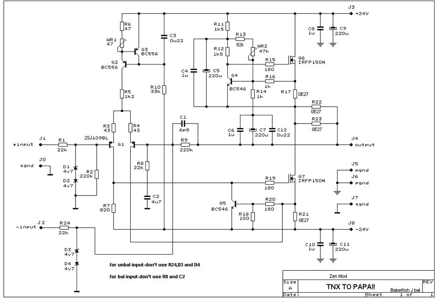

After watching columbo last night I did some more DC analysis (based on my previous assumptions), but with the difference that I place R27 the same way as in babbelfish and other alephs, which is between R25 and F26 instead of between R26 and Q4c.
With this change, the voltage drop across R27 is obviously much higher, hence the current required for feeding a voltage drop of 0.2V on R15 is much less. In fact, I calculated R27 to be 83k, which seems to be quite spot on, since in the calculation I aim for 500mV on R16 is higher than stock Aleph j, so 68k will be perfect for the 3-400mV range.
Is this simply a small typo in the schematics?
After doing these calculations, I have started to like the placement of R27 in the aleph j schem posted more, since this is not depended on rail voltages (try to do the dc calculations), and R27 is effectively cut of from the music going on on the node between R25 and F26. However, to be current limiting the value of R27 must be in the 10k-20k range.
cviller said:
I am looking at papas last (I think) Aleph J schematics, in this post:
http://www.diyaudio.com/forums/showthread.php?postid=1343785#post1343785
Schematics:
http://www.diyaudio.com/forums/attachment.php?s=&postid=1343785&stamp=1194303063
The purpose of R13-WR2 in your schematics is the same as R27 in papas, but look where leg with the highest potential is connected - very different indeed.
yup ;
I saw that ( we probably discussed that in thread already ) - again just after posting these two schematics ;
anyway - I dunno can we hear any difference between "old" and "new" type of connection ;
I'm pretty sure that I can't hear the difference 😉
