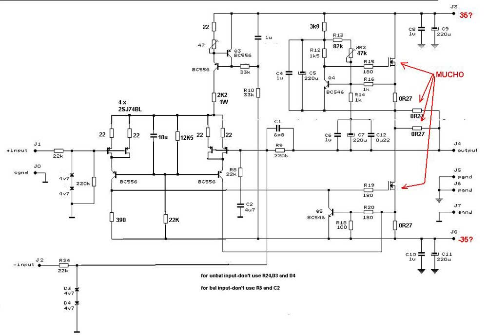

nope ....... yes ......... ?
but yes - now ;
sketch ; few DiyAs already implemented that in few X-es

thanks choky, thats on my list of things to do one day.
Aleph 2 is 45V rails, will this work ok?

resistor just above input LTP must be ~ 1K1/1W ....... ppl don't call me 4eyes without reason

why not ; if you choose to make it , just buzz ...... so we'll make dedicated sketch , with triple checked values

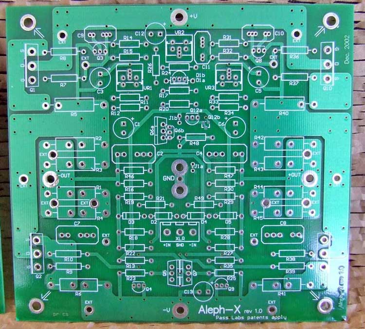

have you these , ya cwayzee Mod ?
(work is in progress ........ as soon CeeVee finish prototyping of his Drekling
Ahh Choky, I forgot I have 4 of these unused boards tucked away. Still if Nelson plans on offering board I'd buy.
Mark, need a pair?
-David
Mark, need a pair?
-David

OH MY GOD!!! I was about to write and say that I was interested but it would depend on the final direction that we go. Kind of a crummy response to such a generous offer...
THEN:
I was looking at the photo of those boards, and thought: "those look familiar" Then I thought "Well if those are the old Aleph X boards I can't imagine that I didn't order any" because back awhile I was a sucker for any board being offered. So I went to my Drawer Of Shamefully Unused Boards, AND THERE WERE 4 Aleph X rev 1.0 boards!
Now I don't know how many I'll use, 2 for me and maybe 2 for my brother who won the bidding on an amp. I know that AR2 would be VERY interested in a pair though. I'll write him. Now maybe we will end up going a different way to the same point, depending on what Nelson comes up with, but it looks like we have about enough to standardize on them. I can only assume that there are a lot more out there!
Here's a quote from the Aleph X builder's thread:
"I am also wondering how many will be built in the end. But with over a thousand boards out there I estimate conservatively that if half those that ordered are serious then we have about 100 people that intend to build it in the near future.To be even more conservative I think about 40-50 Aleph-x's are going to be made at least."
