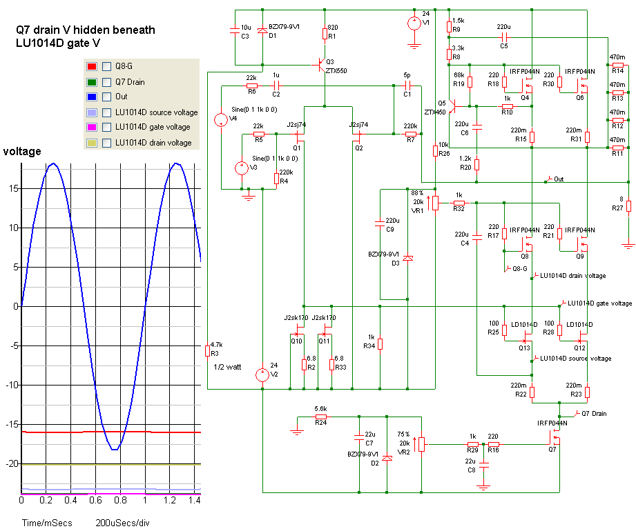

In the preceding schematics there's a blip that shows up in LU1014Ds drain voltage. It occurs when the sine-wave dips across its position on the graph. This blip seems to transfer to the cascode Mosfet. By lowering the setting on VR1 to 36 percent, I was able to lower LU1014Ds drain voltage below the bottom leg of the sine-wave and remove the blip.

Thanks Thorsten. It's similar to the power resistors on the right hand side of the amplifier, yes? Each bank has a resistor. I should have realized..... I remember staring at the SK170 and wondering if there should be additional resistance. Excellent.

This one's just for fun (and strickly for my 110 db 1W1M horns)... the power through the LU1014Ds is around 33 watts each (a bit high, wouldn't you say😀 ) and drastic means are required to remove the excess heat. I wonder how it would sound?
Pointless? Maybe.
Still, it's a fun exercise.🙂
Pointless? Maybe.
that output CCS is rotten :devilr:
remember - biasing of LU is same as for triode , or any little N Jfet ;
carpenter said:
I dropped the extra current source, added a cap between LTP and power jfet's gate--to let the jfet bias itself. Lost the sine-wave.
you lost ME there , too :clown:
you can't drop CCS - its working LOAD for output Jfet ;
in fact - which CCS you dropped - additional one ( hangin' on drain of input Jfet) or output CCS ?
gimme that schematic , and somebody will tell you wher eis mistake

Carpenter, you need to ground reference the gate. I don't know why you don't simply read the posts you were linked at; you could avoid all these simple things.
Have fun, Hannes
EDIT: oh and I forgot: maybe you want to read a bit about differential pairs as well? Then you probably don't want to remove its tail current source.
