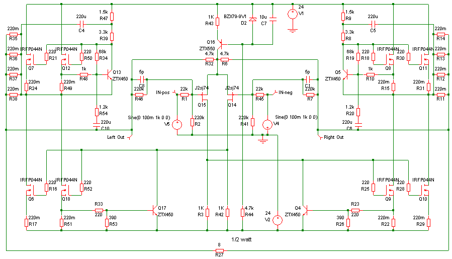

Aleph J Schematic
Zen Mod said:
you see Irony in that ........ because all you need is what PWK sez ....... 3 to 5 watts
( I need usually 1 or 2 watts more than you 😉 )
That's all I need for my horns. The Aleph J will do nicely in that regard.
For my midbass units, I want much more power. 150 watts will do the job.
So, my feedback isn't symmetrical. Guess I've got some reading to do, huh?🙂
print that schmtc I posted , along with your schematic , then compare them ;
don' try to read Papa's SUSY patent papers - too confusing, but you can read his later pamflets on subject :clown: , they're much clearer
if you can't find them - all you need is to ask .

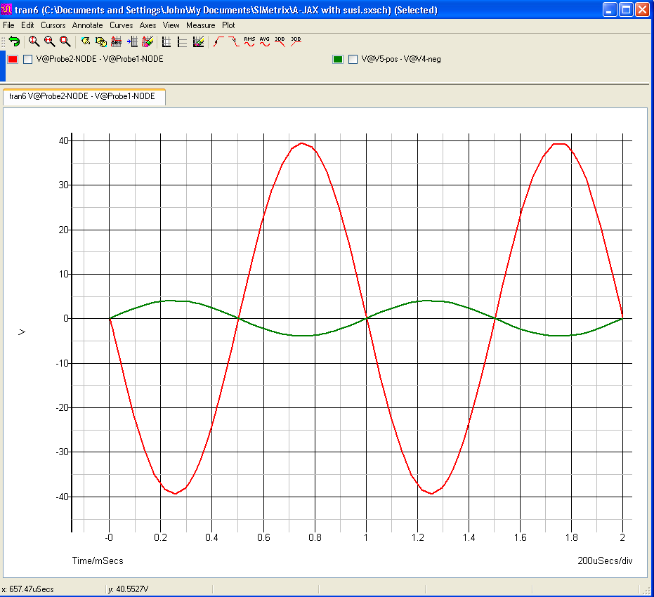

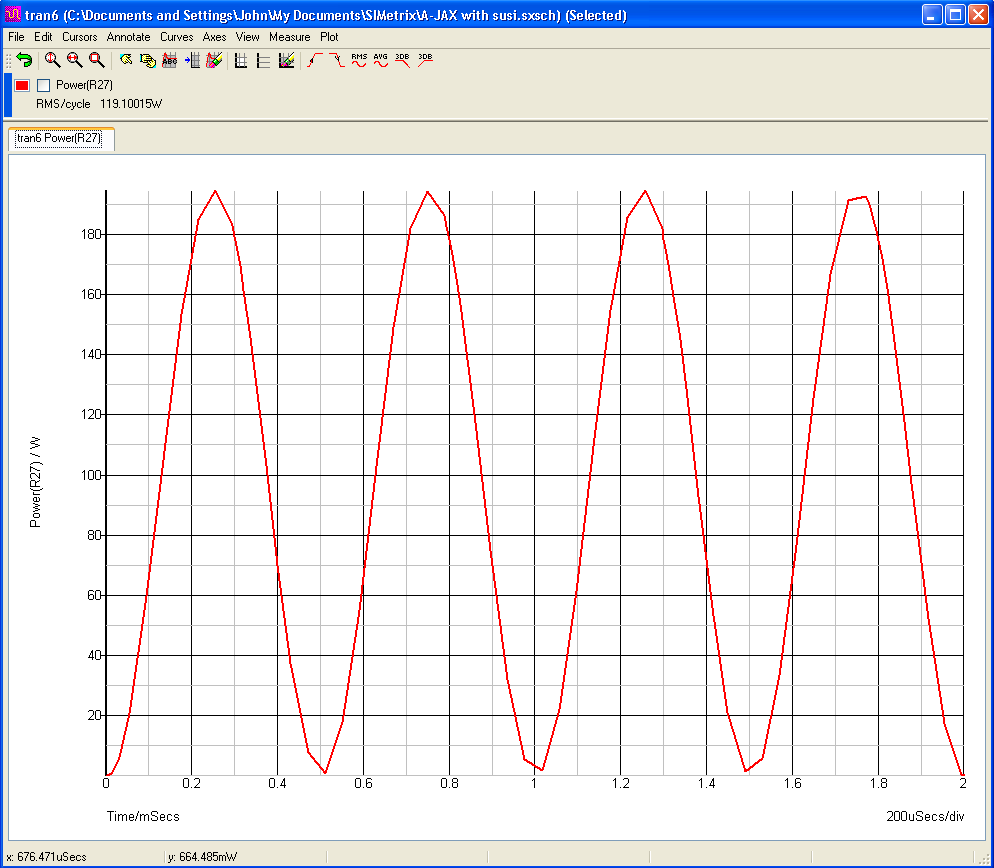

Got it working:

Why, thank-you, Allan.
I downloaded the 2sj and 2sk... The software is user-friendly, which is so important for a novice like me. I even found the LD1014D spice.
I'm very happy that Nelson challenged me to learn how to simulate. Now, I can tinker without being such a bother to everyone. It's almost embarrassing to see some of my previous posts (prior to learning how to sim).🙂 😀
