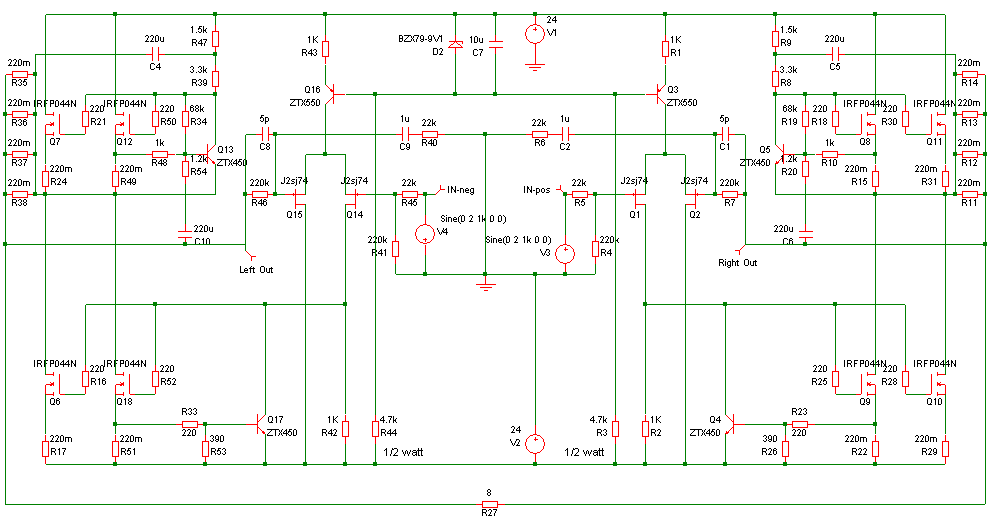

Here's something I'm playing with. It's a bridged version of the Aleph J. It's balanced and, I believe, the feedback is symmetrical.
The sim says it's output is 145 watts RMS. It seems to swing 40 volts peak to peak when I run the voltage differential on R27. The power resistor values could be halved if twice as many fets were used. My sim (free from SIMetrix) has limits on circuit size, so I can't build up the circuit to full capacity. As it stands the fets are handling 50 watts of power--a bit high, but not totally ridiculous.
woodie - you're peach 😉
pardon moi ...... if we have all these SUSYversions of same circ , with all benefits of thingie , why on earth you play with plain bridged version ?
:clown:
carpenter said:
Because I'm learning????????😀 😉 😀
there is no better reason for that , certainly ;
but - you can use LM3886 model for that (bridging) exercise ....... with lot less mouse moves and kbrd tickin'
:clown:
(NB - I worship ya - I never learned to simulate .......... maybe I need to prolong my first tries ......... to more than 10 mins ....... :rofl:
naah ..... I'm hopeless :clown: )

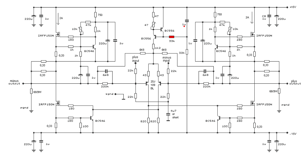

woodie - that's drawn ....... pretty long ago ;
in fact - I never tried it ( to confirm values of McMilan resistors , loading resistors on outputs etc. ) just because few other wackoos tried something similar already .......
anyway - there it is , for your pleasure

Blues said:
Try with one differential front end, John. Keep the other 2 jfets for the other channel😉
I tried, Blues, and couldn't get the sine wave even top and bottom. Then I got the bright idea that two differentials might do the trick. Of course, I ended up with a bridge amplifier circuit, but what fun!! I now know how to build a great, balanced, powerful, bridged Aleph J...🙂
