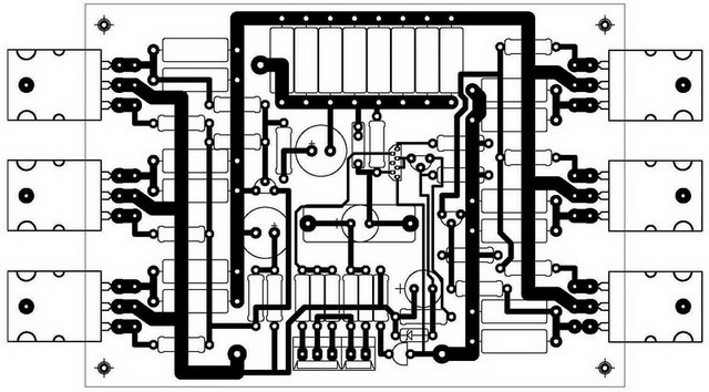

Here is my implementation of the Aleph J.
These are set up for the 2sj109's.
The artwork is mostly just a cut and paste of Holger’s wonderful work.
I relocated and resized the footprints for the electrolytic caps so that I could fit Elna Silmic IIs. Also I placed the snubber caps as close to their mates as possible.
As for Input/Output I added space for terminal blocks. I realize the use of 2 position terminal blocks for one node is a bit clumsy, but it is an easy, mechanically stable solution.
Go to http://www.rainmakerconsulting.biz/moJO.jpg for a higher resolution picture.
Dave

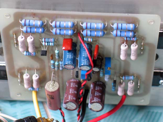

This my prototype base on HBarske .

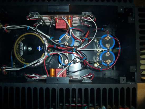

I also finished Aleph J !
Superb sound and great for drive variuos speaker ( I used Spica TC50 and Mission 782 SE)
Ask to Mr.Nelson, Could I use F5 to compare with Aleph J in 3 ways floor standing ?
Rubydac

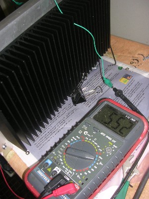

Has anyone checked the voltage across the sourse resisters?
On my Aleph J I get aound 540 mv
I am using K6-104 — BERGQUIST Thermal resistance:0.3°C/W insulation washers ..I could not source mica anymore.
Heatsinks Conrad MF30-2F-151.5 0.25 thermal resisters
0
The fets are :redhot: to touch.
I have not measured it yet but I calculate junction temperature at about 78c
Ian
