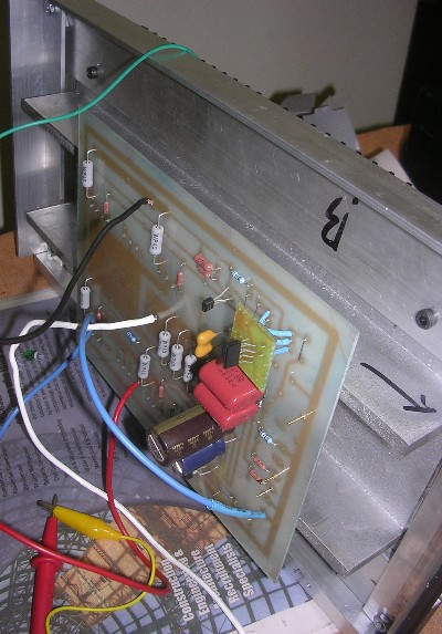

On the temp I tried to use Williams X Aleph spread sheet and scaled the bias accordingly.
The good news its still alive!
The boards are Mark Finnis Aleph 5 and I fabricated a small daughter board for the 109's.
The Master said I should move on from the X Aleph so here we are.
There is an interesting story to this project.
I little while ago a friend in Brooklyn asked me what would I recommend a as diy project for biamping his horn system..he uses Light Force amps on his Altec woofers, I suggested the Aleph J.
Initally I was going to help with the boards and a few parts because I had some of the Jfets. When I got started I enjoyed it so much I thought I may as well assemble it and one thing lead to another. (I do this for fun only)

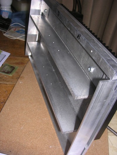

The hard part as always is the chassis. So we decided to make the amp as modules around the heatsinks that would form the basis for the chassis.
Conrad make some of the best heatsinks so I called Julian and went from there (its quite interesting to tour through the factory)
I used L angle and some square 12mm rod & flat bar stock and extended the angle an inch proud of each end of the 300mm heatsinks. All the hardware is M4 and M3 stainless steel except for the flanges so metric Allen keys want be a problem in NY trying to assemble it!

This was taken the first time I turn it on.
Offset starts at 40mv and drop to about 38mv slowly.
The power supply will be dual mono 300 va (dual 18 volt secondaries) and CRC (C= 30,000uf) Panasonic.
