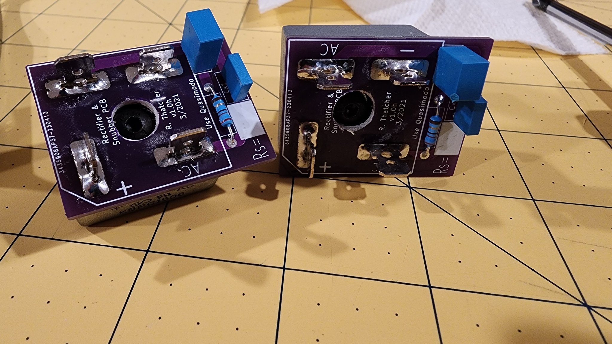

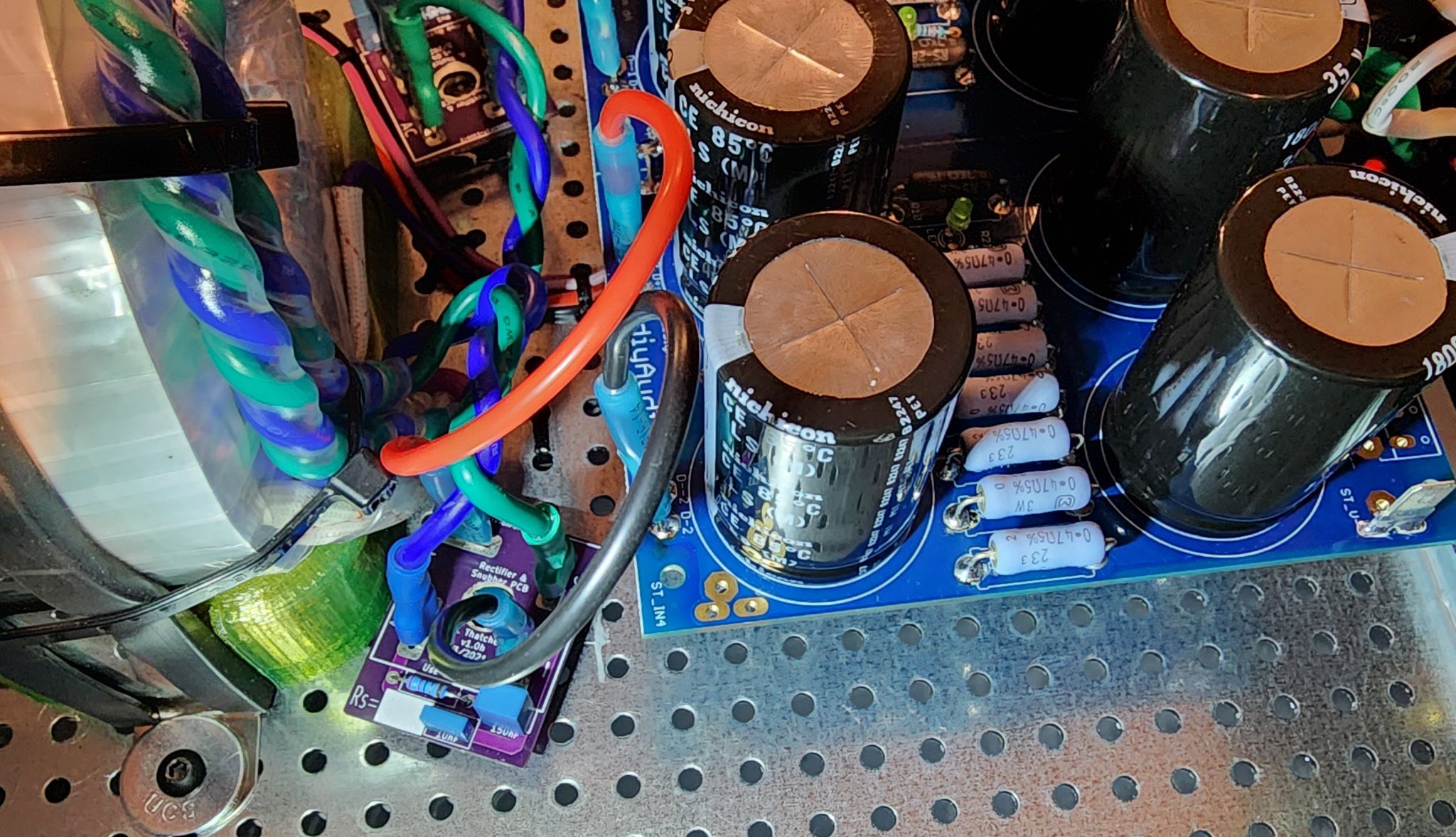

You have two secondaries (4 wires total) with Antek transformers. They are AC output of course and you need one rectifier for each secondary. I recommend you look at the datasheet for the specific rectifier you have to know which pins/tabs are for the two AC wires from transformer secondary vs which are your rectified DC positive & negative out to the CRC filter board.My question on the rectifier board from the shop is how to wire it up correctly.
Heres an example showing blue/green Antek secondaries going into the rectifier, with red/black DC rectified coming out and going to CRC PCB. Note the purple PCB on top of the rectifier is Randy's snubber PCB.

@birdbox where did you get the rectifier pcbs? Is there a project with the schematic / board files or did you just order them from somewhere?Heres an example showing blue/green Antek secondaries going into the rectifier, with red/black DC rectified coming out and going to CRC PCB. Note the purple PCB on top of the rectifier is Randy's snubber PCB.
From the photo it looks like you are using the capacitor side of the diyaudio power supply board - just not the rectifier side?
@roboDNA posted free gerbers and you can have a PCB house fab up 15-30 for around $10 shipped. PM me if you need a little guidance.
The boards you see in the photo are sold by @rhthatcher. I had to drill out the center hold in the PCB though to get the bolt head through. I belive roboDNA's design has a larger general hole to accommodate bolt heads to pass through to the rectifier base (don't want to load up the fiberglass PCB as that can lead to problems.)
Thanks!@roboDNA posted free gerbers and you can have a PCB house fab up 15-30 for around $10 shipped. PM me if you need a little guidance.
