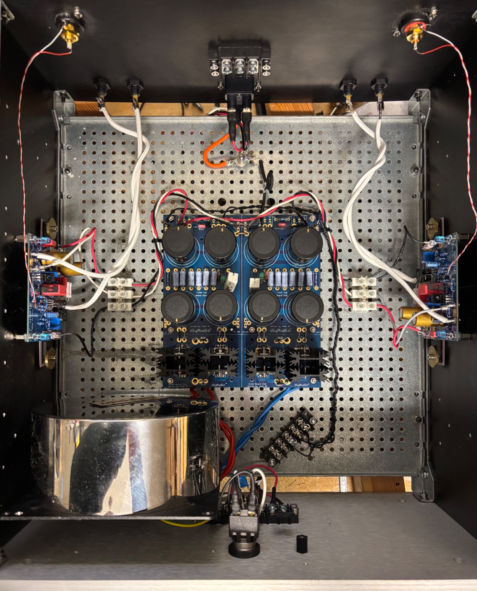

Hello,
I'm in the planning/gathering stages of an Aleph J build. I'll be using the diyaudio universal power supply board, and I plan to run dual transformers/pwr supplies. Would 200VA rated transformers for each side be acceptable? i.e. Antek AS-2220 or Antek AS-2218.
Any advice would be appreciated.
Thanks,
Steve
I’m also interested in dual mono and ask myself just that question, 2x200VA should work. I could not help myself in salvage a case, trafio and psu from old projects just to see how it sound. I have not yet biased it up but it behaves ok. My dual mono thought made the trafo slide to the side 🙂 My first time with the universal psu. Time to bias within a day or two.
