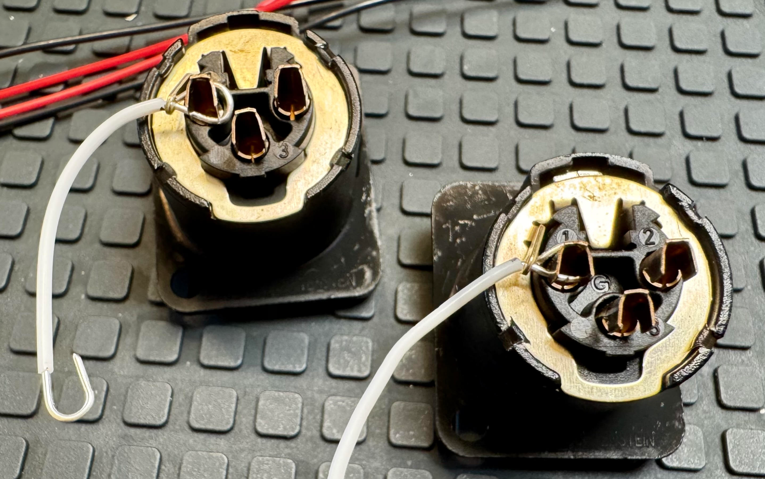

Hi all - using an XLR connector (for the convenience, I know it is not 'better'). For the ground wire, is it OK to run the wire through the little hole for the (cable shield?) or should I keep that isolated? I am not sure exactly what it does or what it is connected to. In one of the build guides, it is NOT connected through this hole. The intent is to ground it with one of the mounting screws to the chassis. If someone feels strongly I should connect to the amp board vs. this way, let me know.
Asking before I solder it.
Thanks!
Well, it probably IS better, but that's not what you're actually asking about...
Don't do that.
Connect the little tab thingy to the chassis, preferably with a small wire directly to the screw securing the XLR jack.
Connect pin 1 to signal ground, as this is how the factory F4 are wired.
It's a belt & suspenders way to make sure the XLR jack is at the same potential as chassis.
6L6 thanks for the reply, but can you be a little more blunt (like hitting me over the head with a large hammer)? Can you be clear as day where I should connect the 'tab' and where I should connect pin 1? I think I hear you saying:
--Little tab (not any of the three pins, the separate tab thingie) - to the chassis via a short wire like I show...but NOT connected to Pin 1.
--Pin 1 goes to Ground (NOT: negative - ) on the amp board with another wire.
I don't understand the technical reason for this, and would love to learn more.
