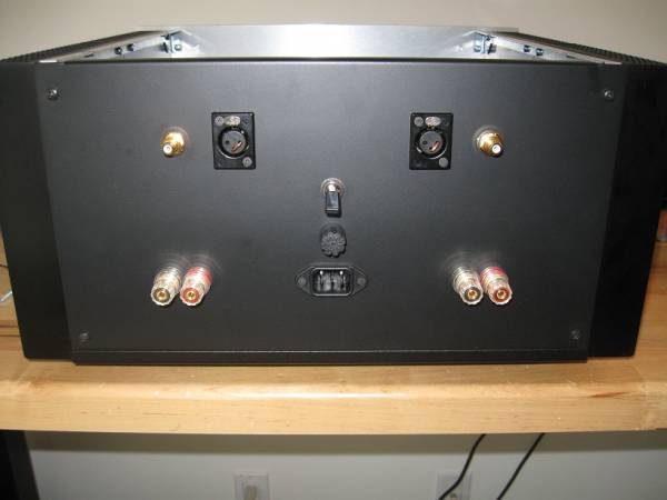

This being Aleph J, changes things. It HAS a differential input stage, so running balanced is actually the ‘normal’ way, and signal from RCAs need the jumper. Sure, you could make a dedicated cable that does that, but it’s better to just stuff the XLR jack with the little jumper and use standard cables every time.
So, install both XLR and RCA jacks. If feeding from balanced, use XLR. If feeding from RCA, use the RCA and jumper pin 1-3 on the XLR jack.

For the sake of getting this build done sooner rather than later, I would like to proceed without the dual RCA/XLR connections (I can do that later). I hear you saying XLR is the 'right' way to do things and I am good with that.

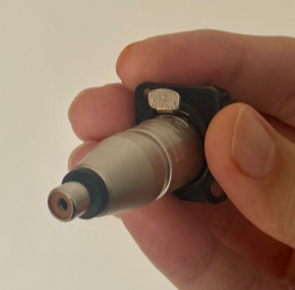

I just to happen to have a set of these: https://www.neutrik.com/en/product/na2mpmm
3 pole XLR male – RCA / phono plug
Wired according to IEC 268-12:
Pin 2: signal
Pin 1 and 3: connected to ground
I believe that solve my issue when using RCA (if wiring XLR as it should be) - not only the actual cable itself, but needing to bridge pin 1 and 3.

if feeding Aleph with Bal signal/pre, just use regular XLR to XLR cable
if feeding Aleph with SE signal/pre, use custom made RCA to XLR cable , where pins 1 and 3 are shorted in XLR cable jack itself
4th tab, do whatever you want, in this case - leave it floating or tie to chassis

Got it on a XLR-XLR cable. I think the adapter I listed above (when used with a standard RCA cable) effectively does that, correct me if I'm wrong.
Would love a final nudge on confirming how I should wire the XLR input to the amp board. Just follow the logic of the 3 pins are connected to the amp board as their names suggest (pin 1 to ground, pin 2 to positive, pin 3 to negative)?
Aside that the particular one you posted has the wrong gender RCA from standard, yes.

First, sounds good on the wiring, I'll heat up the ol' soldering iron and get it moving along.
Well lucky for my crass consumerism made me buy the other version, too!
https://www.neutrik.com/en/product/na2mpmf
So with this connected, pins 1 and 3 are connected/shorted.
