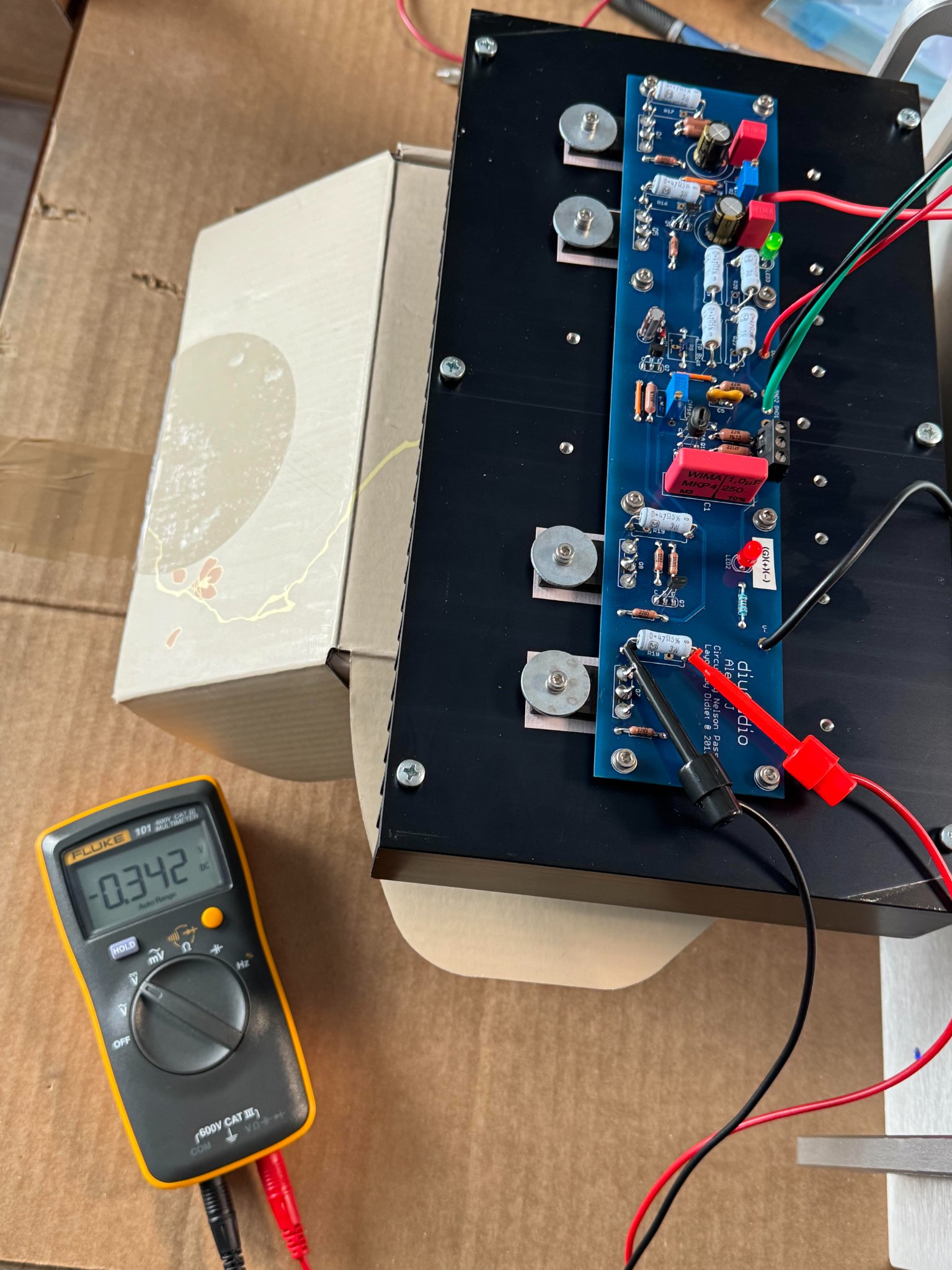

Hey, guess what? After all these years.
Wanted to take this moment to thank everyone here for their AMAZING help. I won't call it done until it is connected and playing music, but both boards have been powered and now waiting for heat soak to do final bias.
And it's alive!
Bit of a scare, did all the biasing, DC offset, everything good. Hooked it up to speakers and audio...nothing. Well turns out my Bluesound was being a dork and wasn't playing even though it should have been. Once I reset things, music!
First listen on my KEF LS50 Meta, which are 85 dB. sensitivity speakers. They sound AMAZING, wow! This is my upstairs background system and I drive it with a Rotel RA-12 integrated (which is a respectable unit). Using the Rotel as a preamp, and the sound difference is night and day. The speakers just come alive with the J vs. with the Rotel they 'play the music'.
Going to hook this up to the downstairs system and really let it rip.
So excited!!!
NOTE: for anyone reading this in the future, the Neutrik NA2MPMF works perfect to connect unbalanced, standard RCA cables to the XLR inputs.

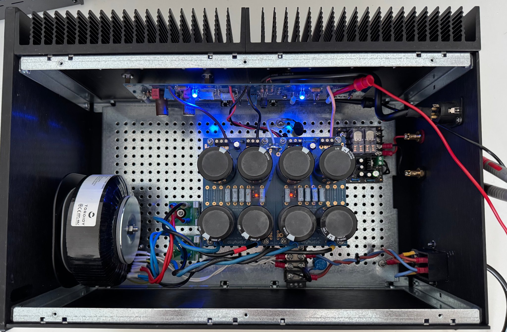

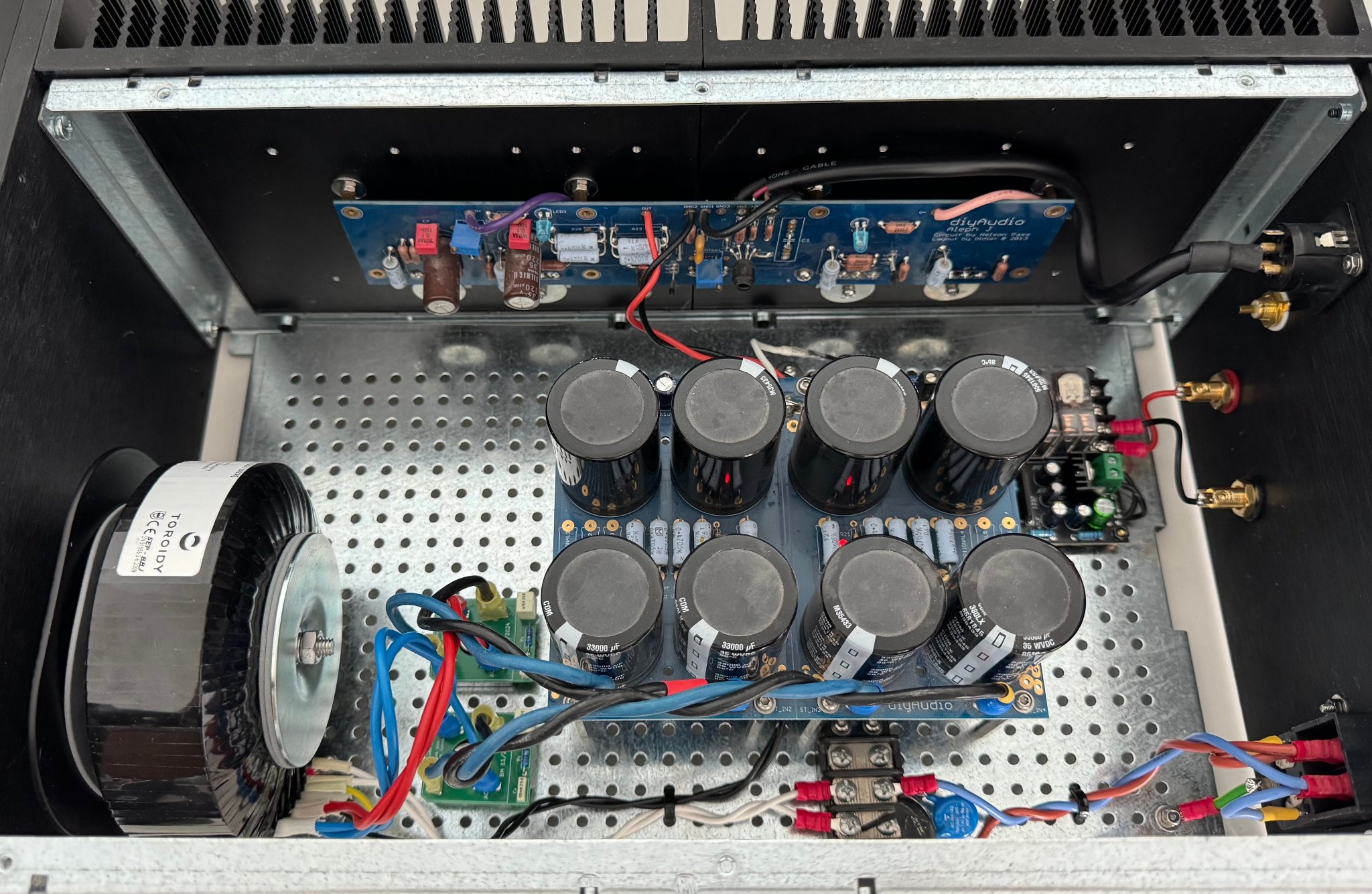

After 4 years Aleph J got multiple upgrades. I decided to remove C1 as suggested by few and add speaker protection board. I can highly recommend this that (big improvement in the bass region and more details and clarity).
I changed the trafos and run the amp with almost 26V rails (my speaker are 18Ohms), 400mA bias. I have to say that trafos from toroidy handle much better different loads – less voltage drops with higher current. Also DC is much more stable and do not drift like with Antek.
The monobolocks from modushop are very good. My only complain is that heat sinks and are not well aligned. This is why UMS threads do not fit to the Aleph J board. Maybe it is improved in the production version (I bought a beta version for a discounted price).
Great amp, awesome sound.
Cheers!

Well done.
I have moved from Dynaudio Contour 1.3 to Contour 30i... 🙂. My modified Aleph J drives them with aplomb. Stunning sound.
You should remove the short circuit protection components as well (a transistor and 2 resistors).
Once the amp has settled and you are happy with the bias and offset, remove the trim pots and replace them with resistors. That will be on par with the C1 bypass mod - the major improvement in sound quality.
The mono cases allow for a very nice layout, segregation of AC wiring, and very short DC wiring (which is another reason the sound has improved). You should consider using thicker wires... though.
Well done.
