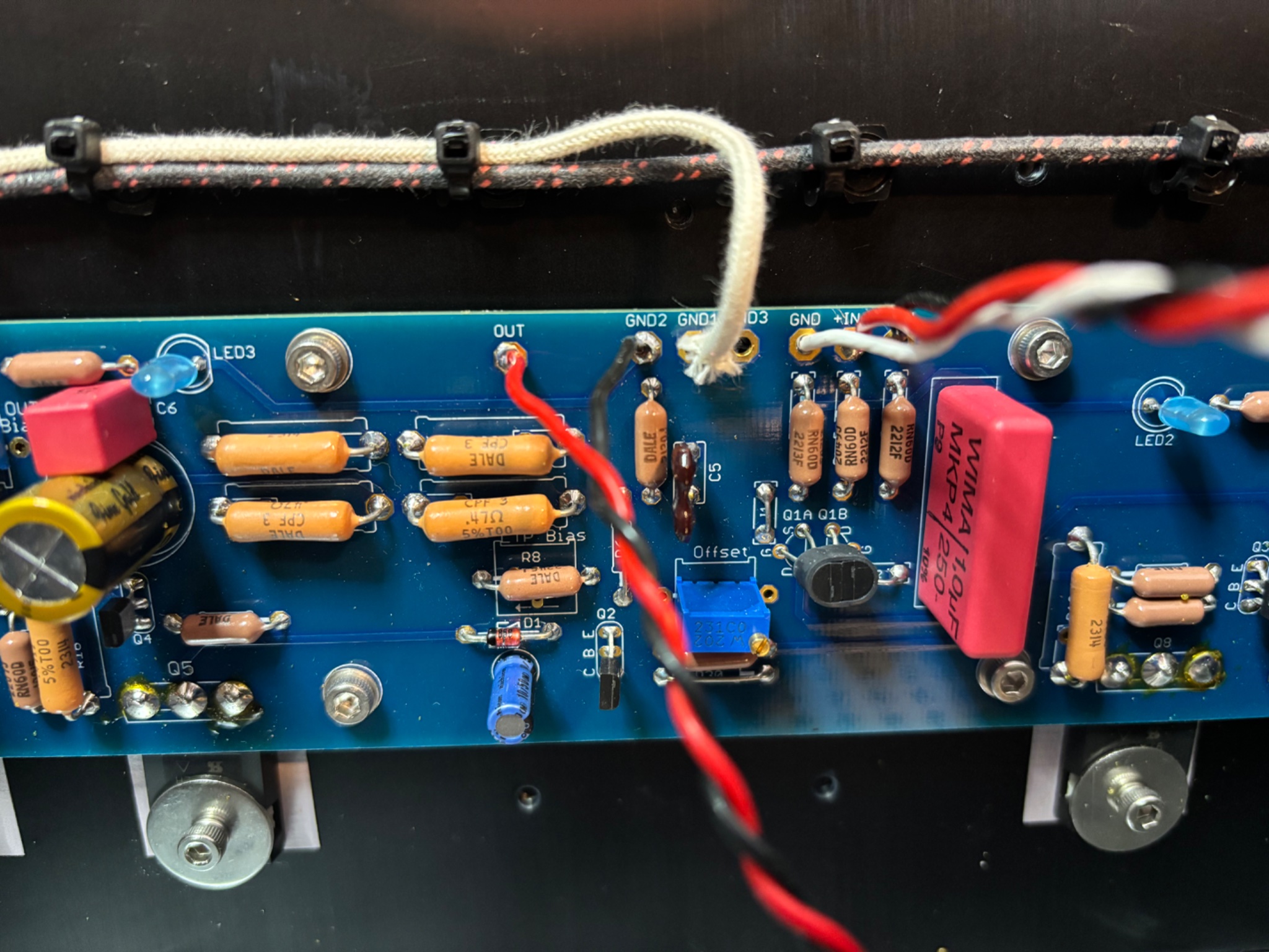

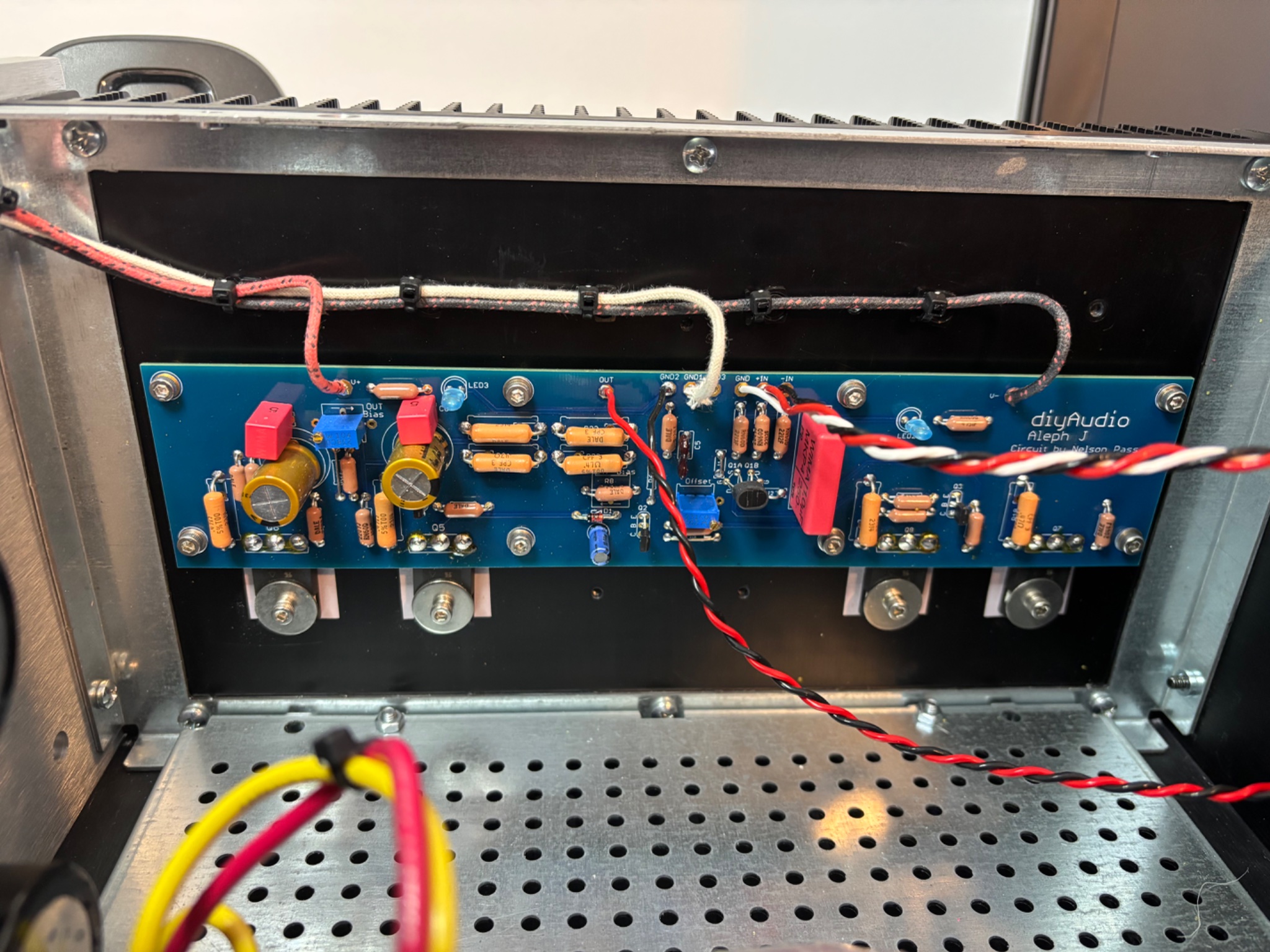

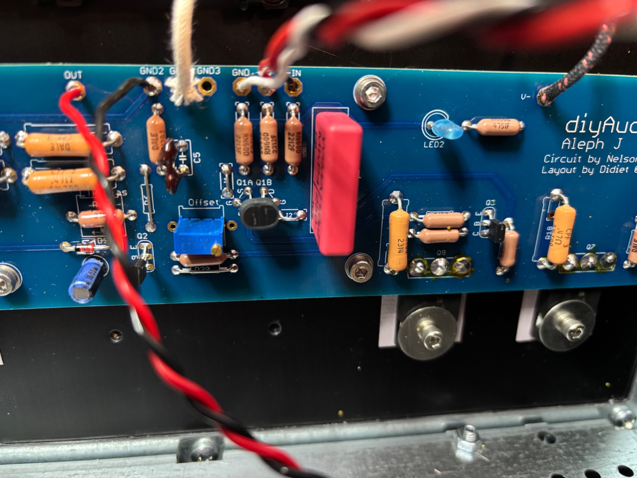

I could use some help. Powering up my Alepha J and the voltage across the emitter resistor is 0.55v. Tested both channels and the emitter voltages are the same, so I must have made the same mistake twice. Things I had checked so far
  • power supply by itself produces good voltages
  • desoldered and measure the pots as 1k and 68k
  • checked that the right small bjt’s where installed in the proper location
Thanks for any help, very annoyed with myself right now

^ I need more clarity re: "and the r18 voltage was lower".
Are you saying that when you turn R27 you can lower the voltage across R18?
If so, then set the voltage to as low as practical (<0V35 preferably). Remove the DBT (if you have not already) and bias the amplifier per the process noted in post #2.
