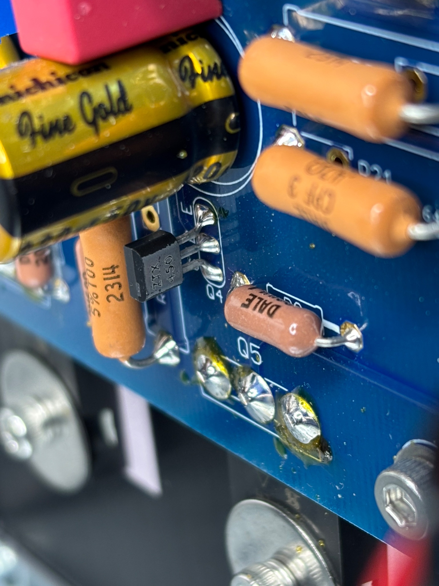

Looking at your picture of the board showing R15, I see RN60 and 2207J. What is its value? That should be an 1k resistor.

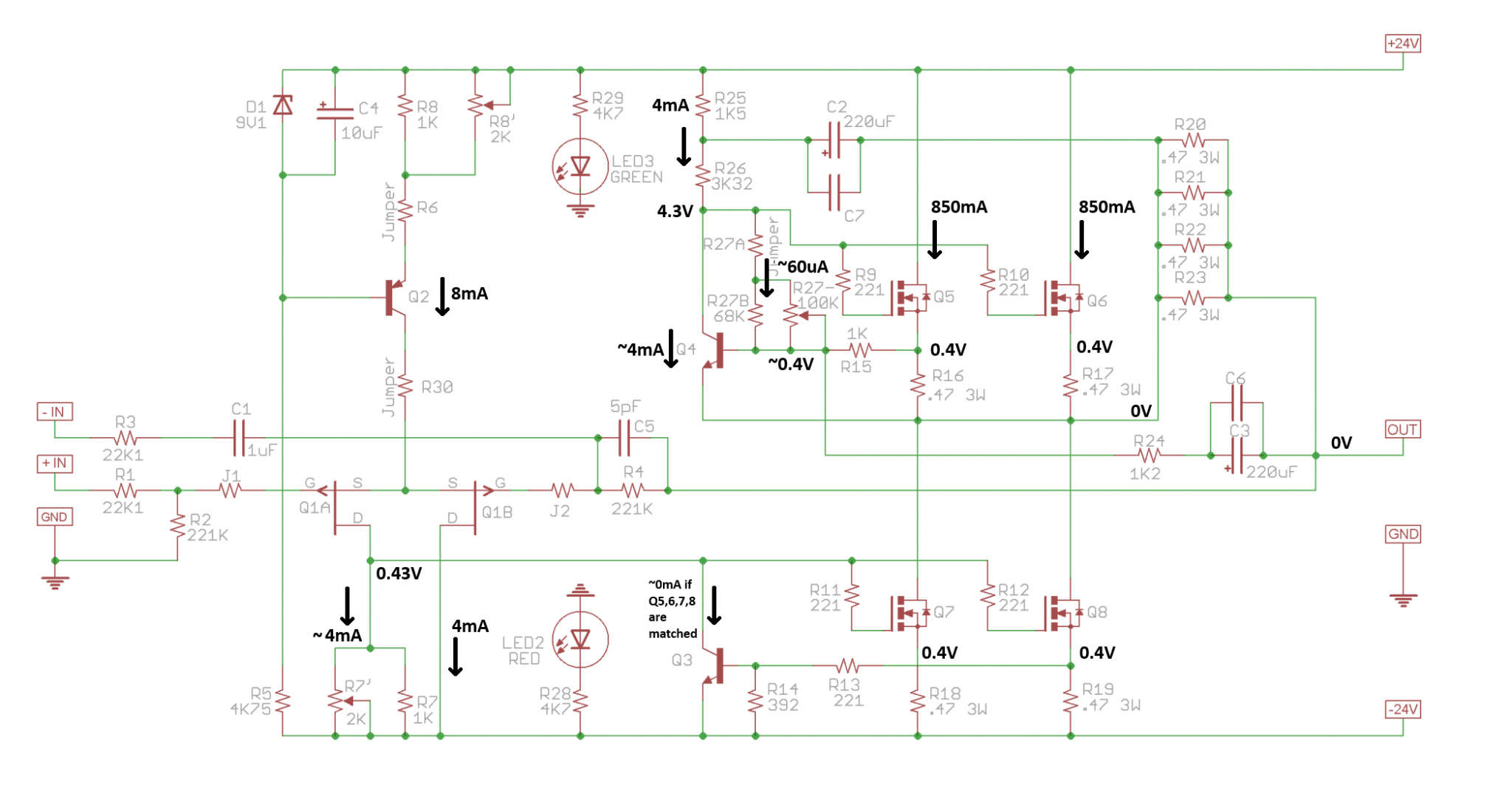

Hello Folks, busy with work and cannot get to my bench. But in the mean time I wanted to understand the circuit better so I can better debug (plus it's fun). I did some back of the napkin math, but I haven't used a BJT in almost 20 years so I hope someone can check my math here and see if I am way off. I am mostly unsure of the base voltage of Q4
I think your numbers look reasonable.
The R27 pot controls the Vbe of the transistor and its current, which sets the Vgs of the mosfet through the voltage drop across resistors R25 and R26.

I agree, After spending some time understanding the circuit the logic place to look is why I am not getting enough drop across the resistors loading q4.I think your numbers look reasonable.

I am analog integrated circuit designer, who has been spoiled by simulators doing the math. It was fun to go back to the basics. I am the middle of a tape out so don’t have energy to deep dive this amp, but I have hope I’ll find it soon.
@DominicD - similar to ZM's suggestion of removing parts not in the circuit, perhaps model it with Q4 E to B shorted and see if the model follows what you observe, even if it only solves one channel.

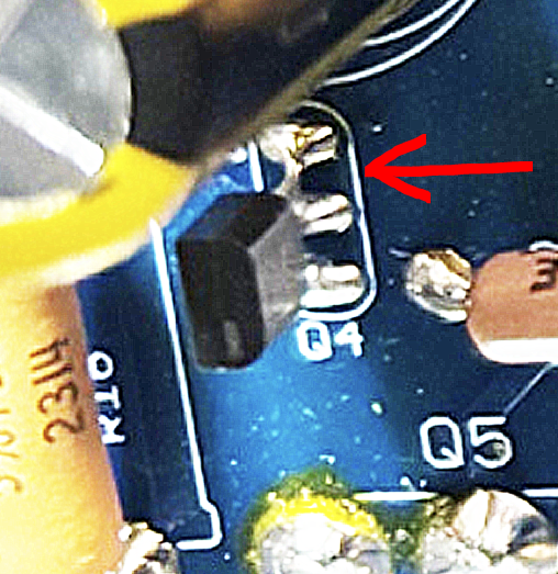

If I short Q4 base and emitter my math seems like its pulling 3mA through R26 .... which is what I measured. What situations would cause the base and emitter to short ?
Yes, a short on the board will do it. If base and emitter are shorted, Vbe=0V and the device is off, and not conducting current.

Well, darn. That may have made life a little easier. The good news is that once you get back to the bench, you can validate your math / sim at various nodes. As Ben notes, that should point you toward the culprit.I think that is just an optical illusion, here is a better photo of q4

But to get back to Q4, if Q4 was not conducting, the 3 to 4mA measured would go through R25, R6, R27 pot, and R15. And adjusting the R27 pot would affect the total resistance of the resistor string and affect the current and voltage drop across the fixed value resistors.. However you stated that when you adjusted the pot, the voltage did not change.
So a close look at those components should be done. Are the resistor values correct? Is the pot working properly? Are there any soldering problems?
