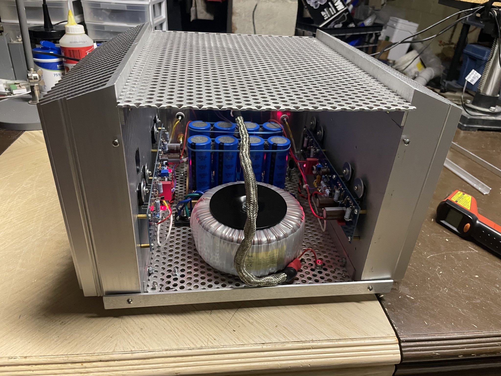

I think your heatsink is too "shiny" for infrared thermometer.The temperature of the hottest part of the heat sink after an hour.
Real temperature could be higher.
Yup, the shiny washers will not give an accurate reading. Apply a piece of kapton tape to the heatsink and aim at that 😉

Sorry, I used the thermometer one last time. I left the amp on for 1.5 hours, and the hottest spot I could find was 43 degrees Celsius. This was on the inside of the heat sinks in between the pairs of output mosfets. I made a dark spot with magic marker and measured there.It seems strange but it is normal. The heat conductivity between MOSFET plastic case and the washer is negligible, compared to the MOSFET metal part of the case and the heatsink. I actually just tried this with my Aleph J - I turned it ON from cold.... and yes... the heatsink around the MOSFETs gets hotter, compared to the washer.

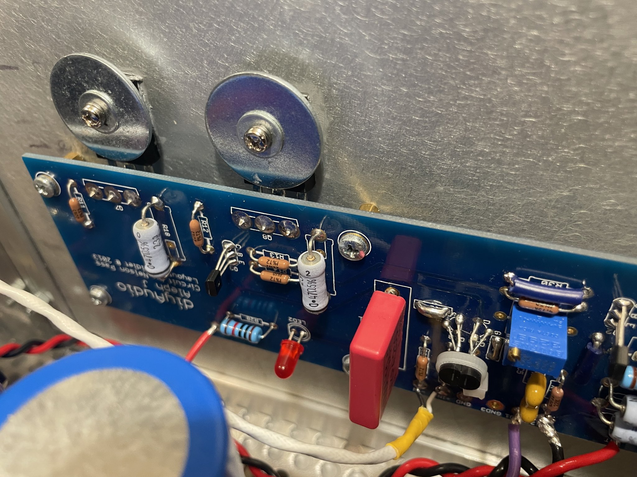

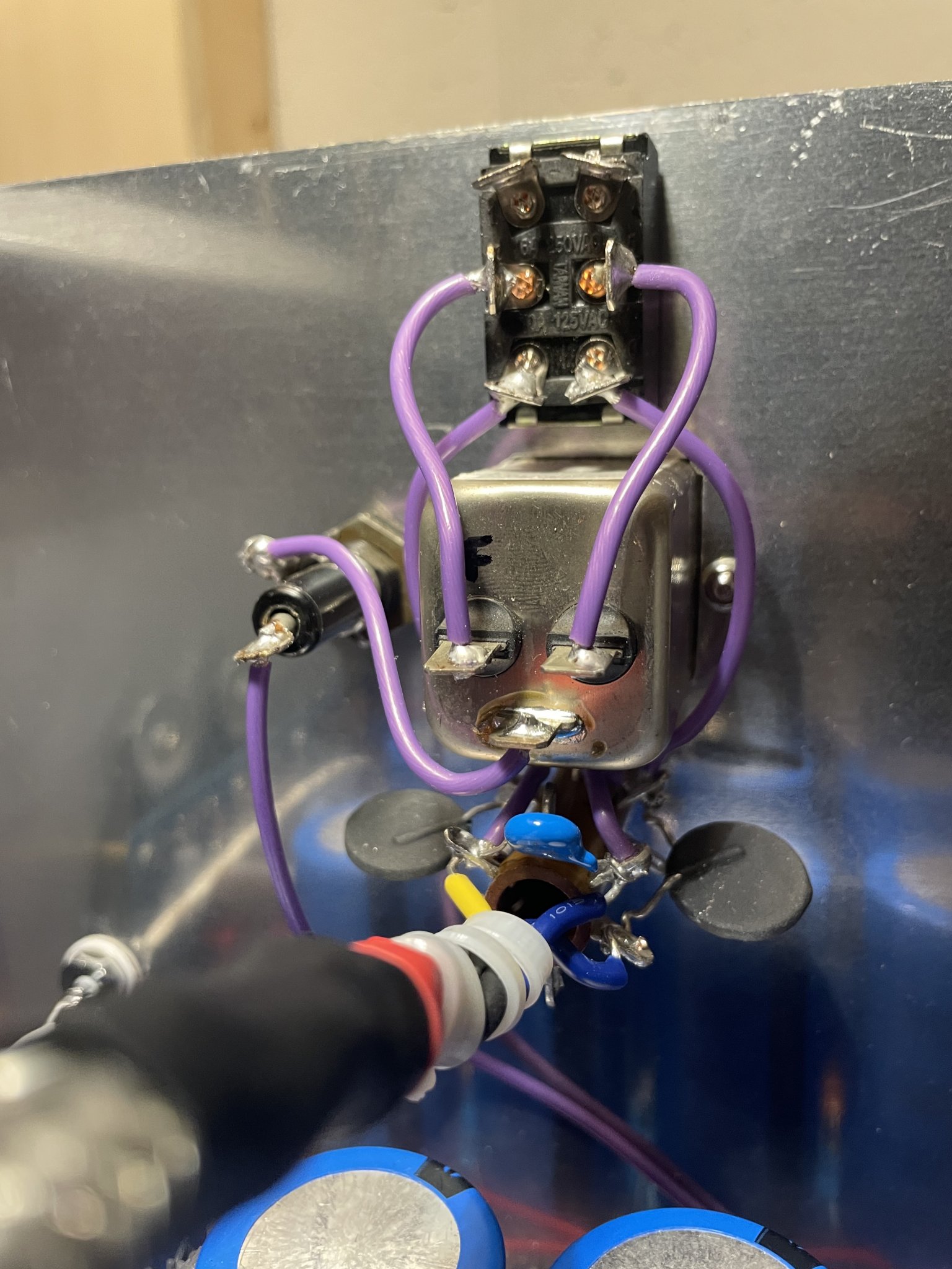

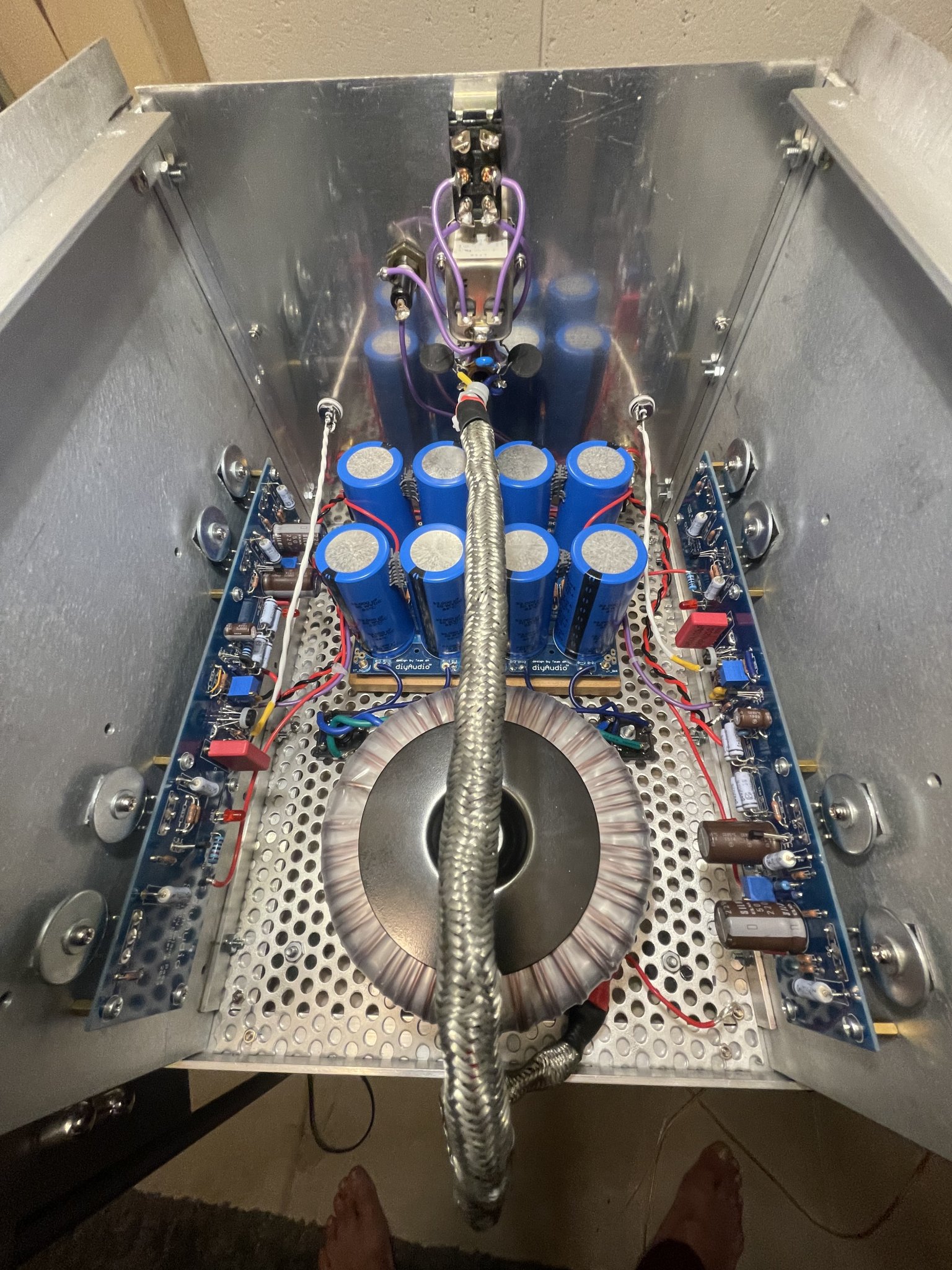

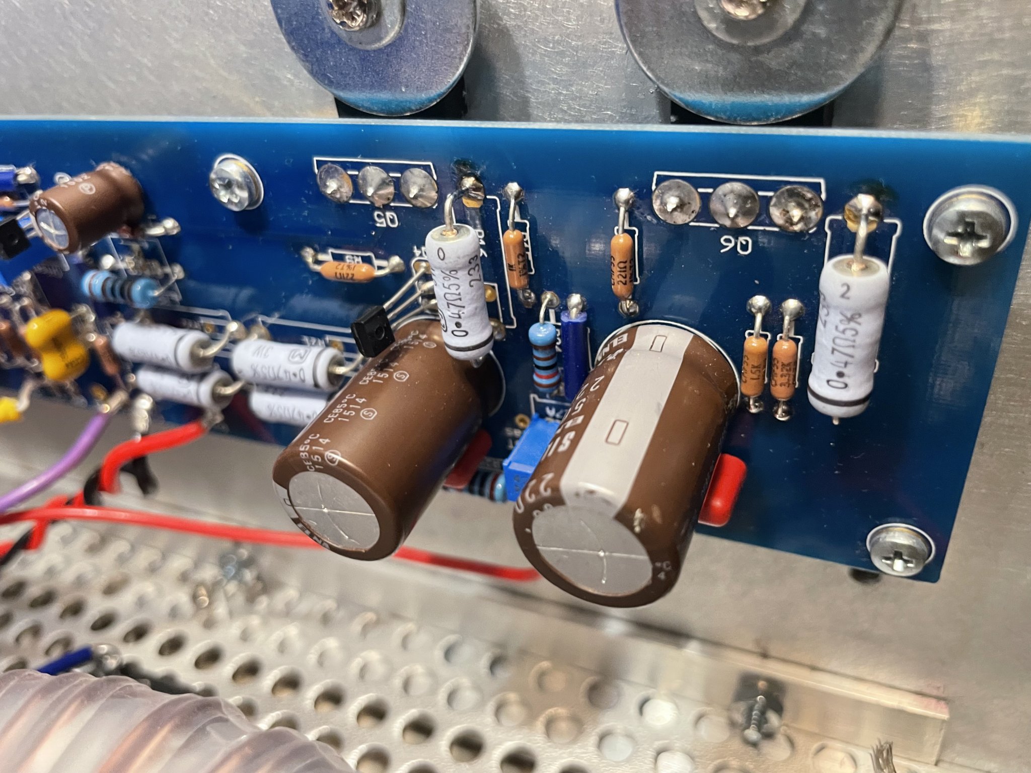

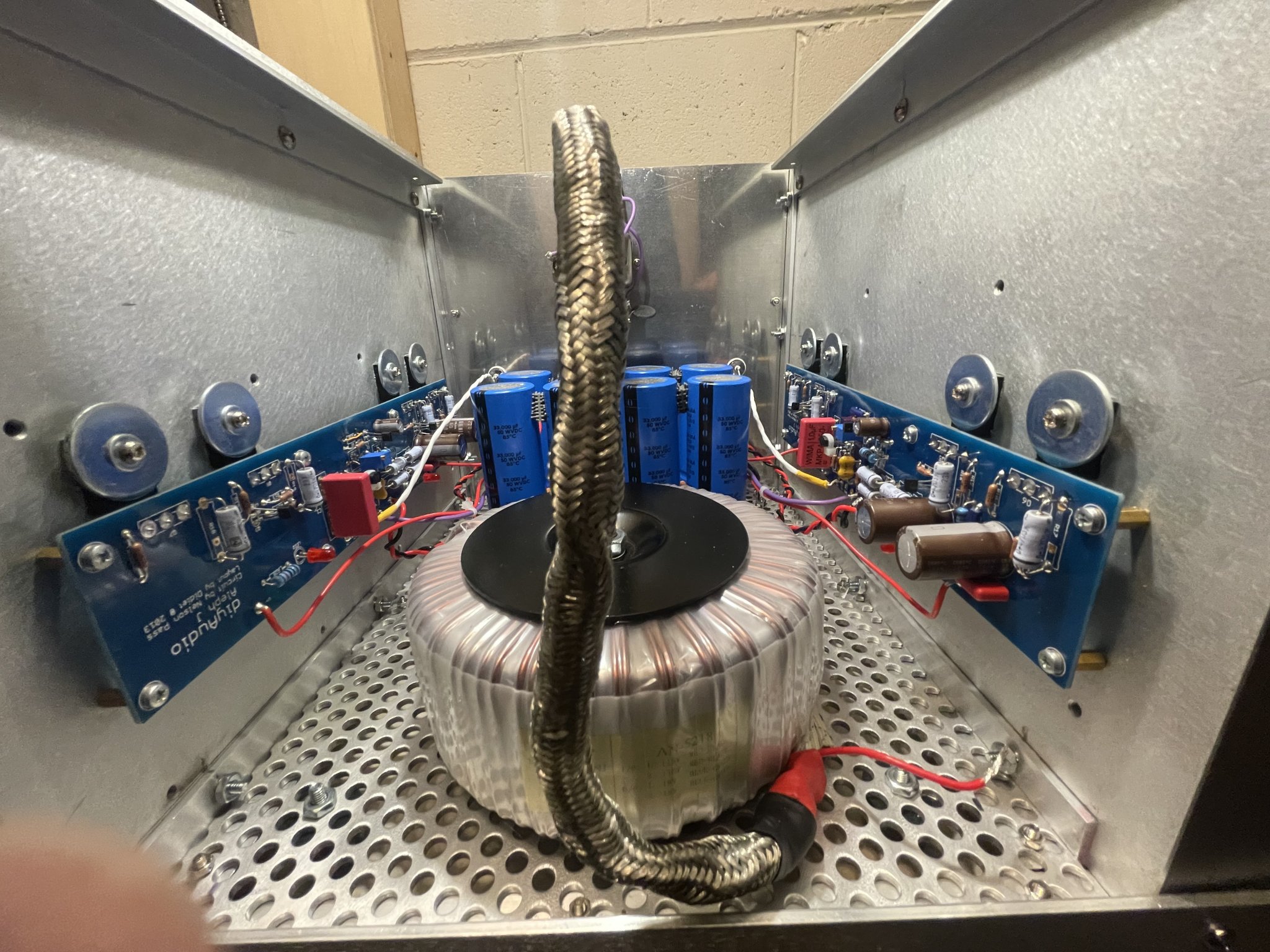

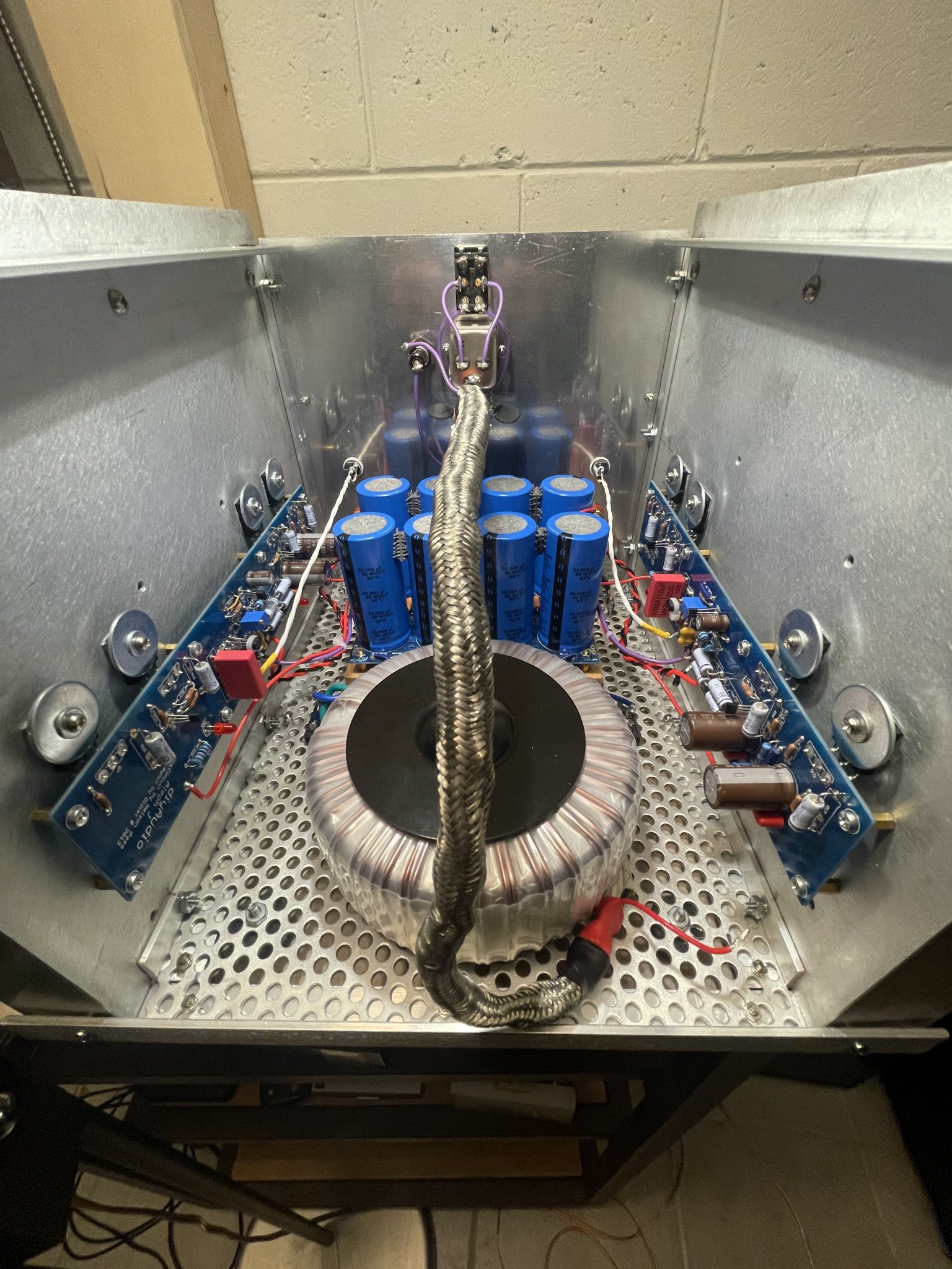

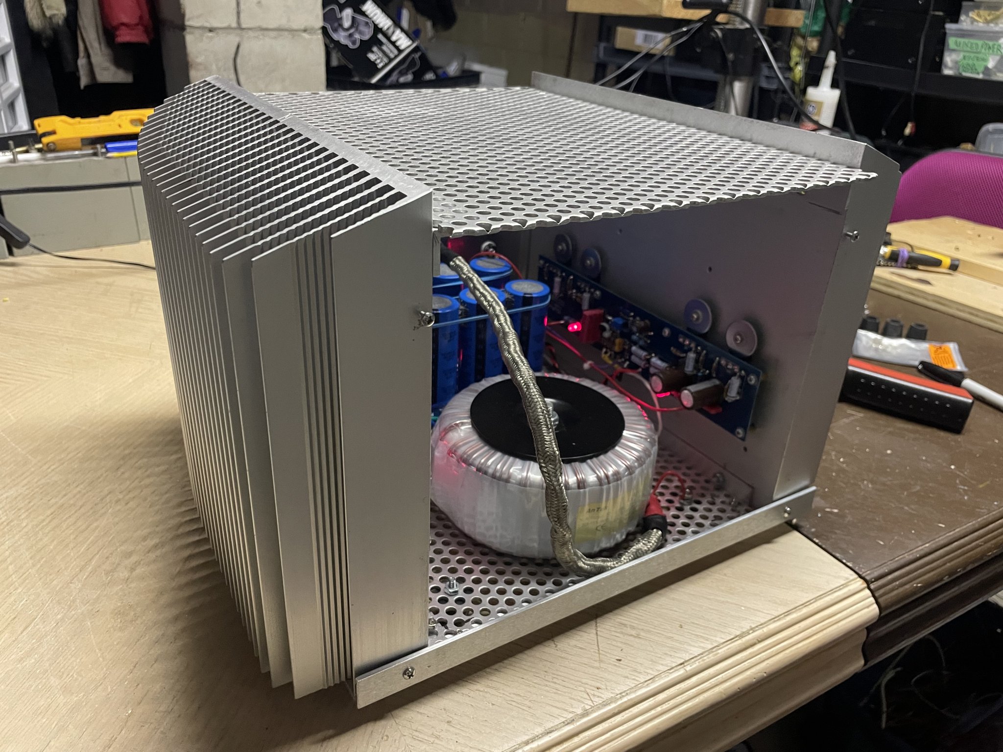

Here is a photo without a faceplate...View attachment 1097662View attachment 1097663View attachment 1097664View attachment 1097664
It is not impossible that your fairly low temp readings are correct with those cool large heatsinks. 🙂👍
But before you crank things up use a regular HQ food thermometer to double check the temps. And to paste black tape on any shiny surface if you want to measure with a contactless IR-meter.

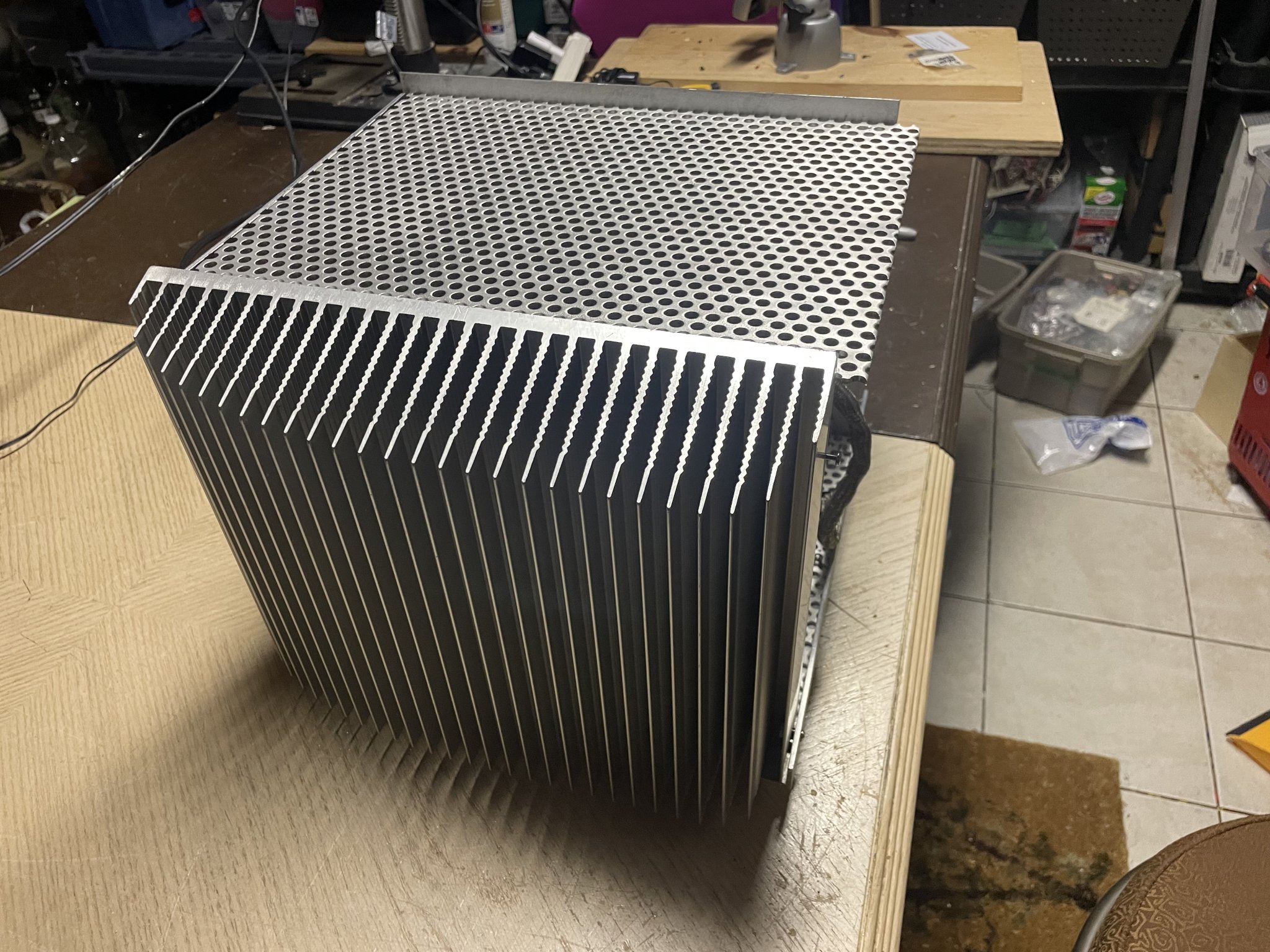

The sinks are just warm to the touch, and not at all hot. I also have a pair of the older style ACA mono blocks, and they are obviously much hotter. I tried darkening the hottest part of the interior heatsink with black marker and measuring, and got 43 degrees Celsius.It is not impossible that your fairly low temp readings are correct with those cool large heatsinks. 🙂👍

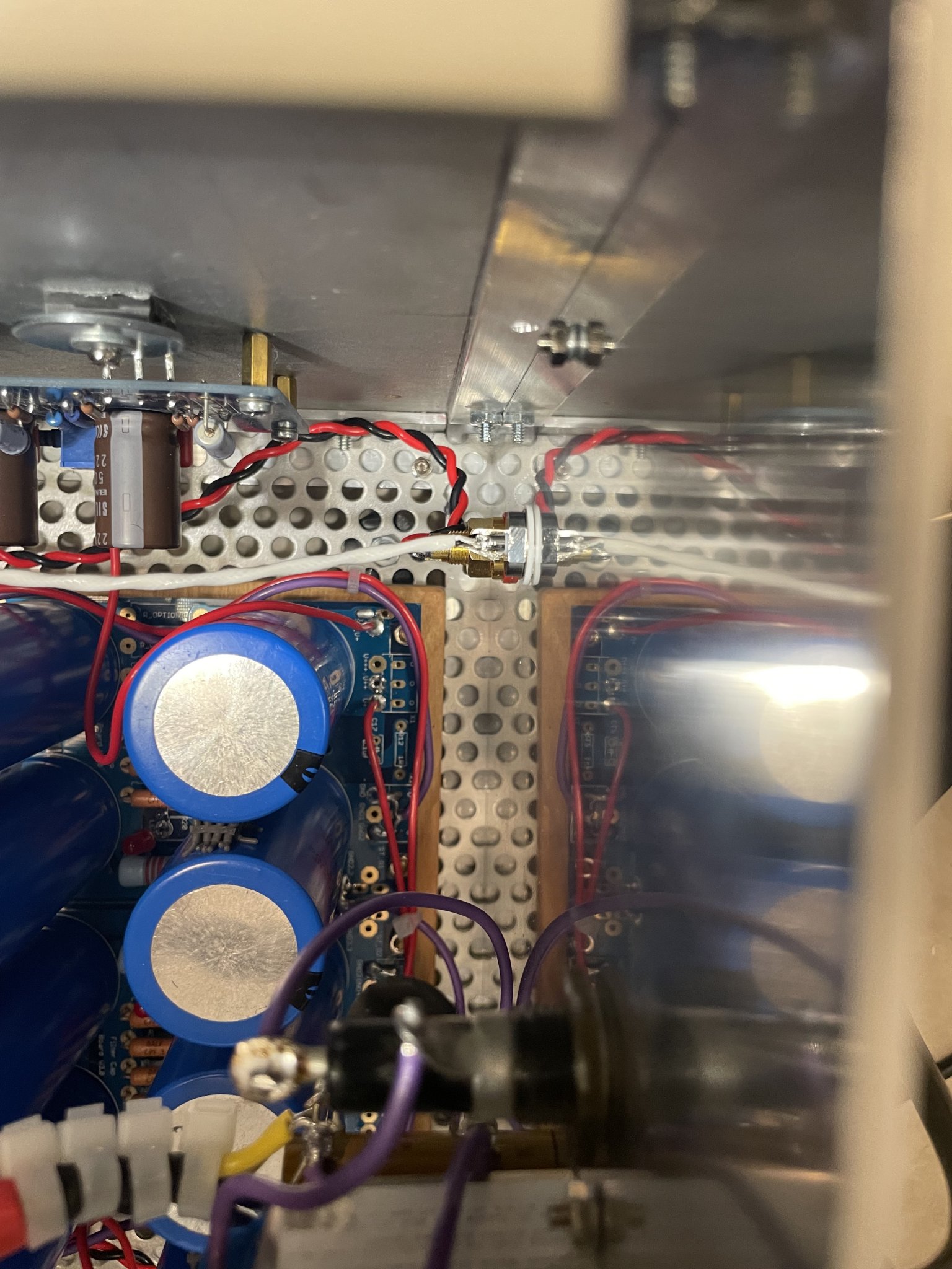

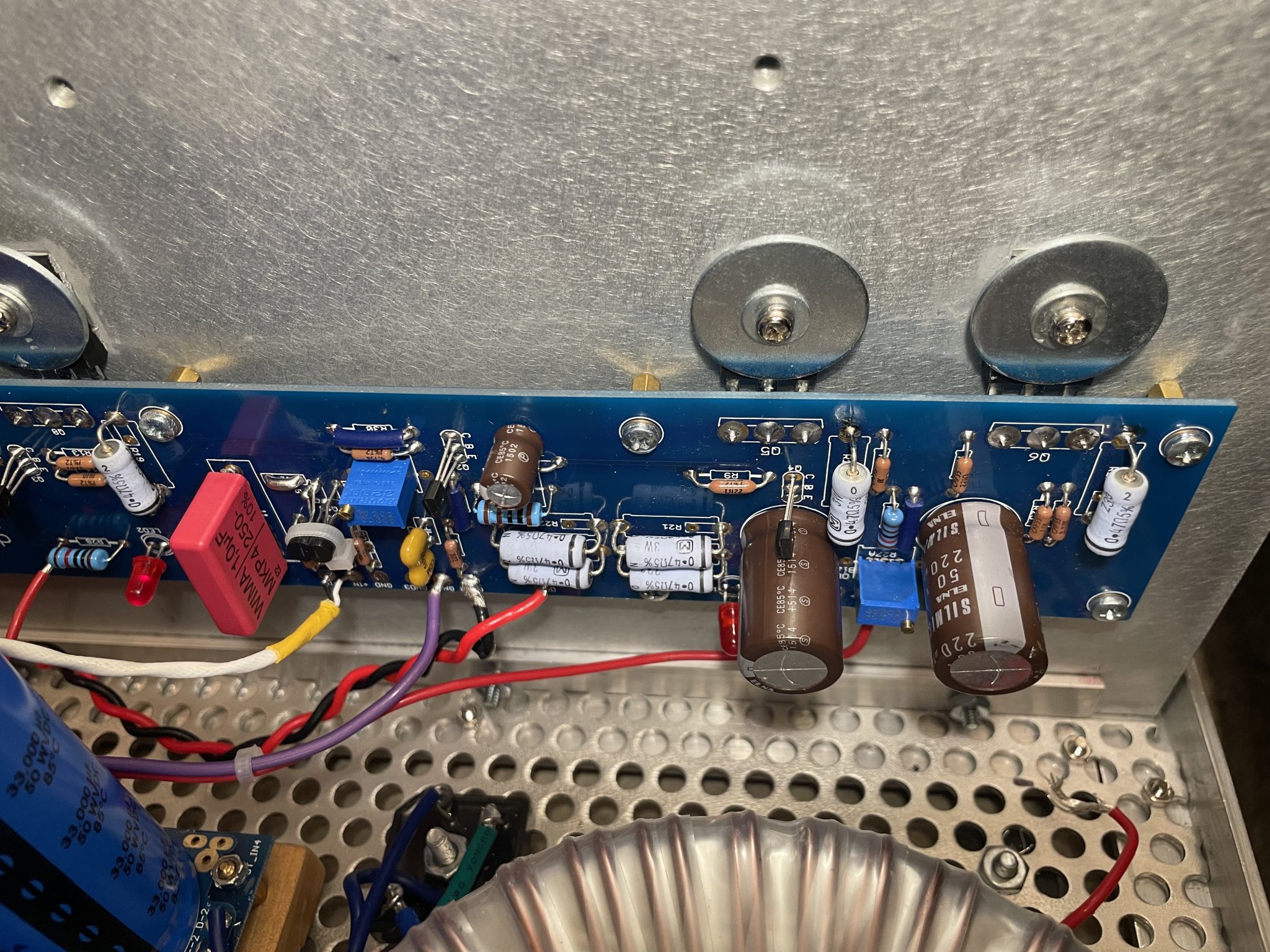

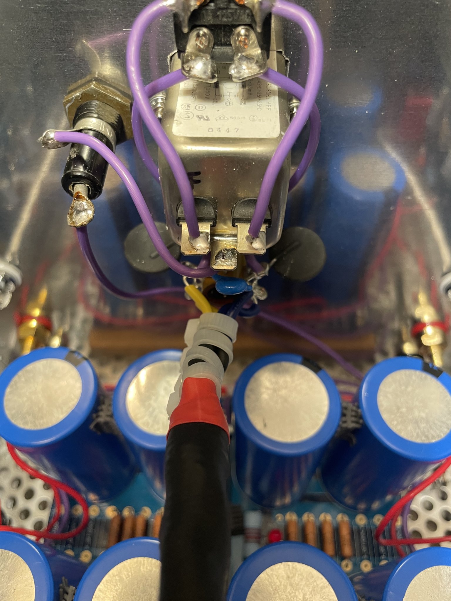

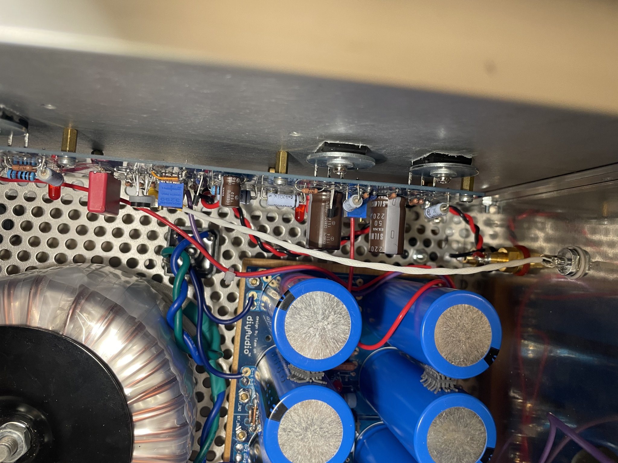

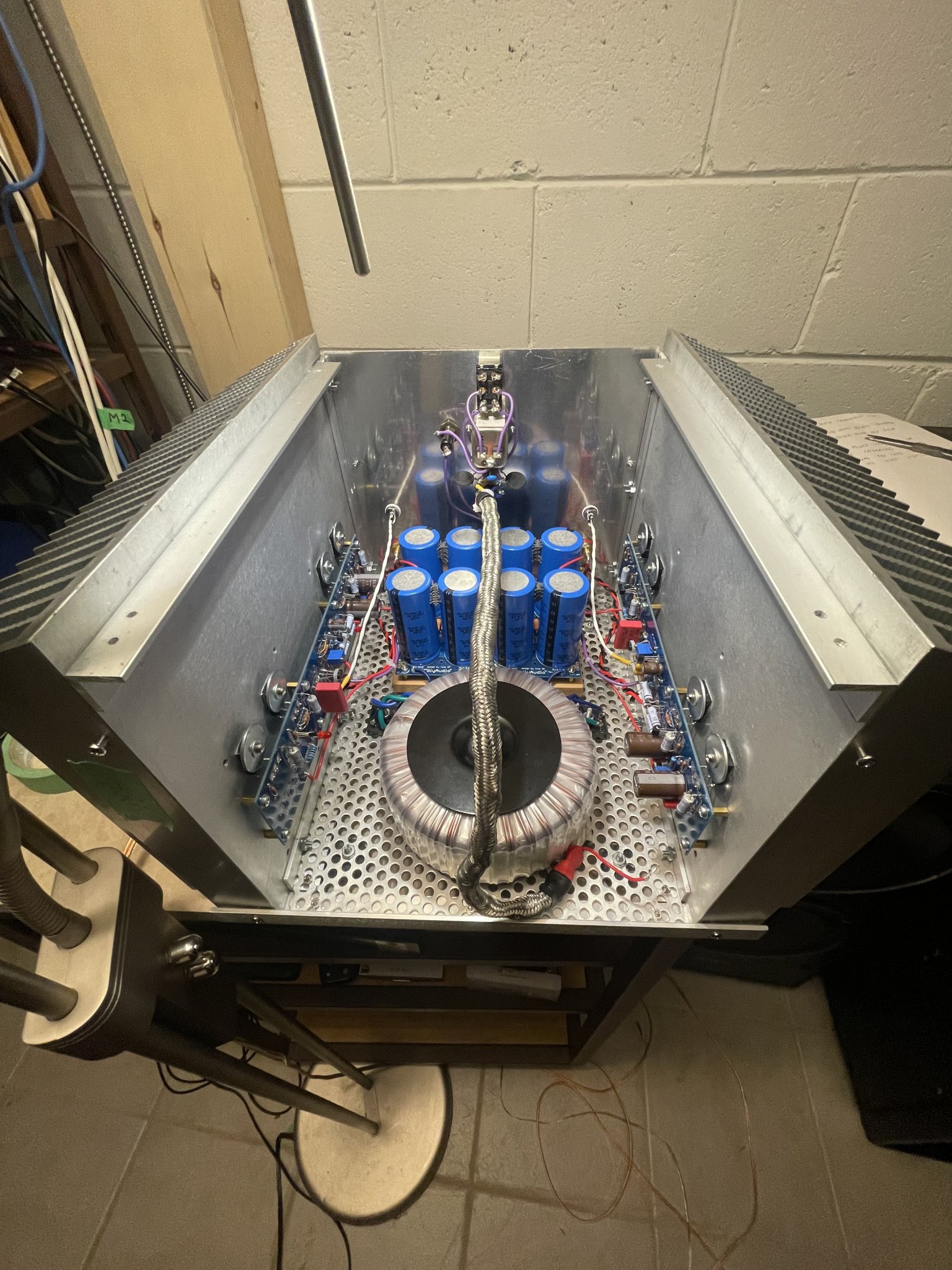

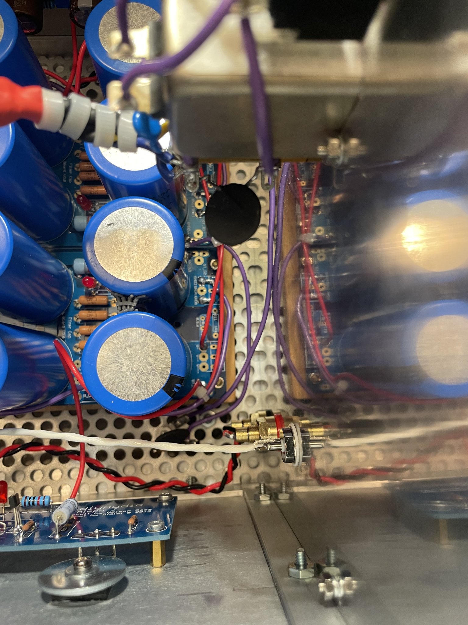

Yes, follow Ben’s advice. But if you want advice for possible easy fixes, we need to eyeball the PSU and specifically the grounding layout. Post a few well lit pics of the internals of your IMMACULATE build if you want 🙂

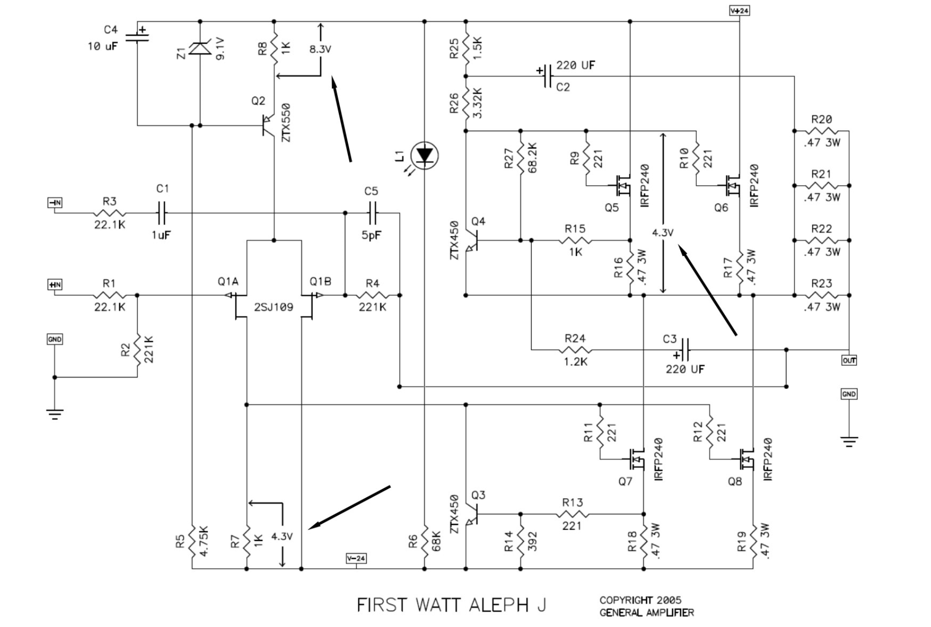

Just to add to what's already provided in the above posts, there are 3 critical voltages on the schematics that will set the DC operating values of the whole amplifier. Make sure they are all good. Double-check the bias through the MOSFETs and confirm that R16 - R19 are all good (0.47ohms).
Aleph J may require a ground lift resistor when used with a single-ended RCA input, to team the slight hum/buzz. This hum/buzz will be audible on both channels - equally, and will not cause what you are experiencing - which is the loud motorboat noise when turning the amplifier OFF. The most likely root cause for this motorboat noise is the input differential pair... and possibly the active current source transistor Q4.
You could also use a good working side (PCB) as a reference point, i.e. compare the bad side with a good working side.
I'd do the ground lift mod first, replace the Q4 second, and then replace the JFETs last.... just make sure what I mentioned above is all good first. Or, do all 3 in one go... while the PCB is removed.
Post some close-up well-lit photos. Make sure the braided shield mains wire is not resting on top of those filter caps.
Good luck. The build looks great - such a shame you have that issue with one channel.

Most kind. I would have actually preferred to put the power supply in a separate chassis and used an umbilical with an additional final capacitor in the signal chassis, but it has sat on the bench for so long that i just wanted to get it done as per the original plan. My primary concern is that the power transformer is too close to the boards. I'll work through the articles referred to by Ben Mah and see where that takes me. I will also get some photos at that point and post them.Is it audible with the inputs shorted or with a source connected?

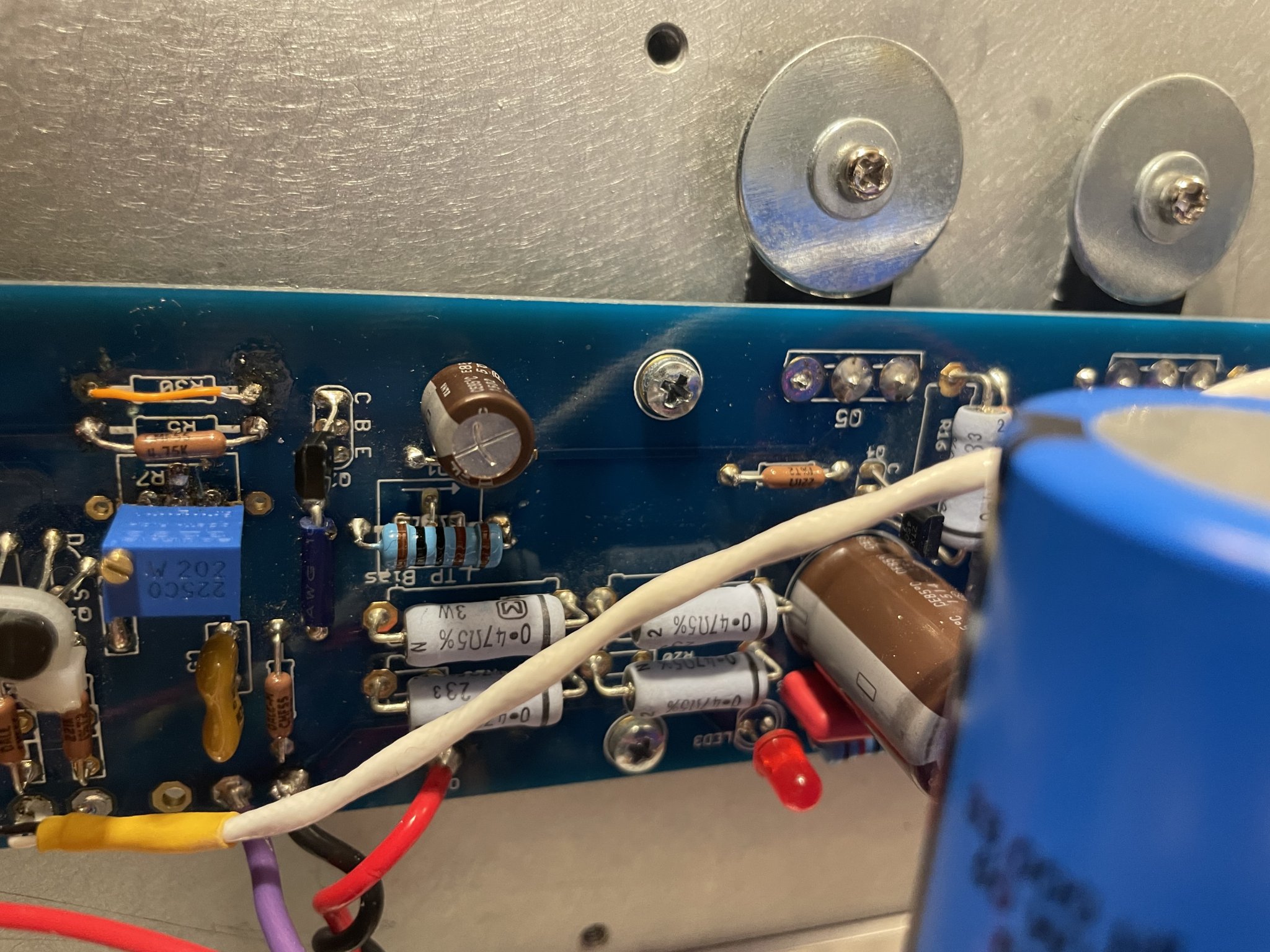

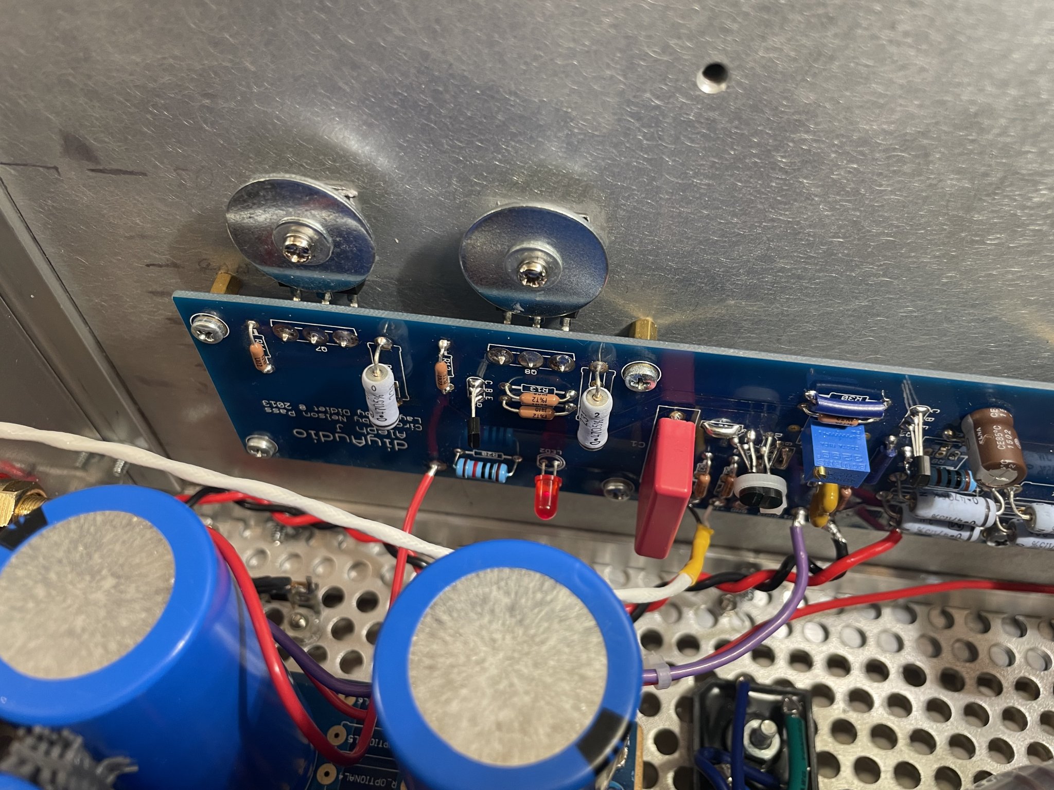

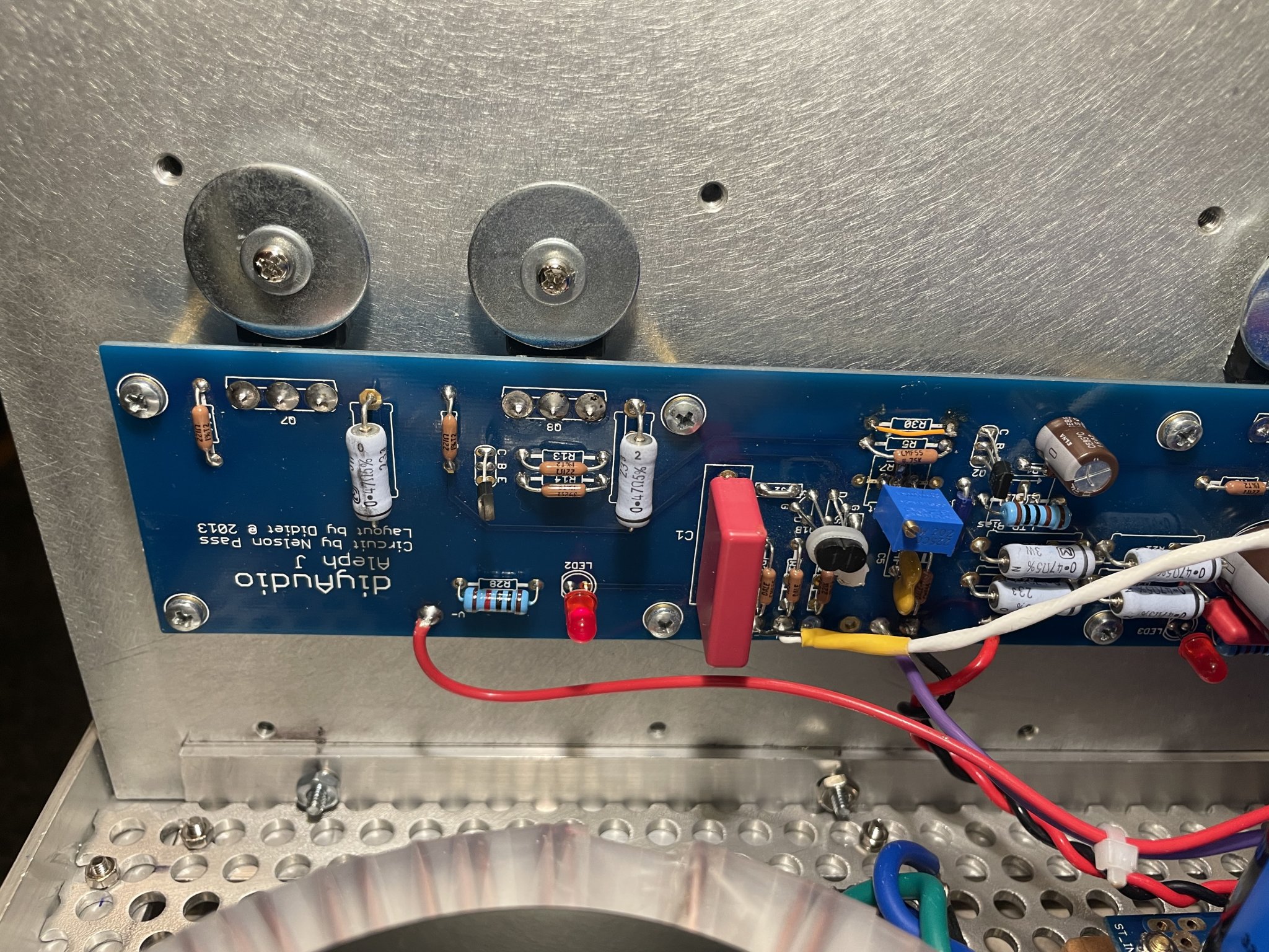

I went through the amp and shortened and rerouted all the wiring. With nothing plugged into the RCA inputs, the amp is absolutely dead quiet in one channel, and has a faint hum/buzz in the other channel. When shorting plugs or cables from the source are plugged in, there is a slight hum/buzz in the previously silent channel, and a louder hum buzz in the noisy channel. My guess is that there isn't a grounding issue, and that there is a bad component or soldering problem on the one noisy board. When I built the amp boards a long time ago, the BOM I used called for a 500 Ohm pot in the the LTP Bias space. This was apparently an error, as that is supposed to sit at 1K Ohm, so I replaced the pots with 1K resistors without removing the boards. I did this by rocking the pots back and forth slowly (they were not installed tightly to the board) until they snapped off, and then I put in a 1K Ohm resistor in their place. Unfortunately, on the board I'm having a problem with, I accidently removed the 2K Ohm pot at R7 instead of the LTP Bias pot. I replaced that pot with another pot, but did it without removing the board, and didn't do a good job. When I removed the R30 jumper and R7 to get to the pot, I tore out the trace on one side of the R30 jumper. All in all a mess that wouldn't have happened had I done the right thing and removed the board and done it properly. I am going to test voltages first as per your post, and then report back. Here are some closeups of the interior....Just to add to what's already provided in the above posts, there are 3 critical voltages on the schematics that will set the DC operating values of the whole amplifier. Make sure they are all good. Double-check the bias through the MOSFETs and confirm that R16 - R19 are all good (0.47ohms).

This is where I messed up. You can see the thinner orange wire at R30.
