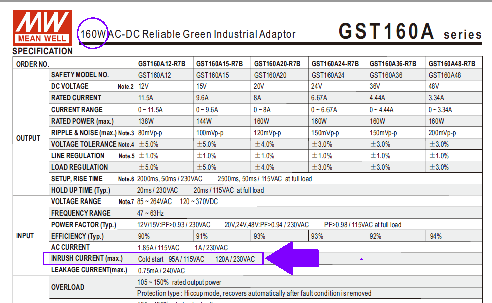

Lots of switch mode power supplies actually include an inrush current specification on their datasheet. For example, here is the one that Nelson Pass supplied with his VFET amplifier kit, sold by lottery at the diyAudio Store. Apparently this one is NOT a soft starting device. So, check the manufacturer's datasheet for your SMPS and see what it has to say about inrush current.

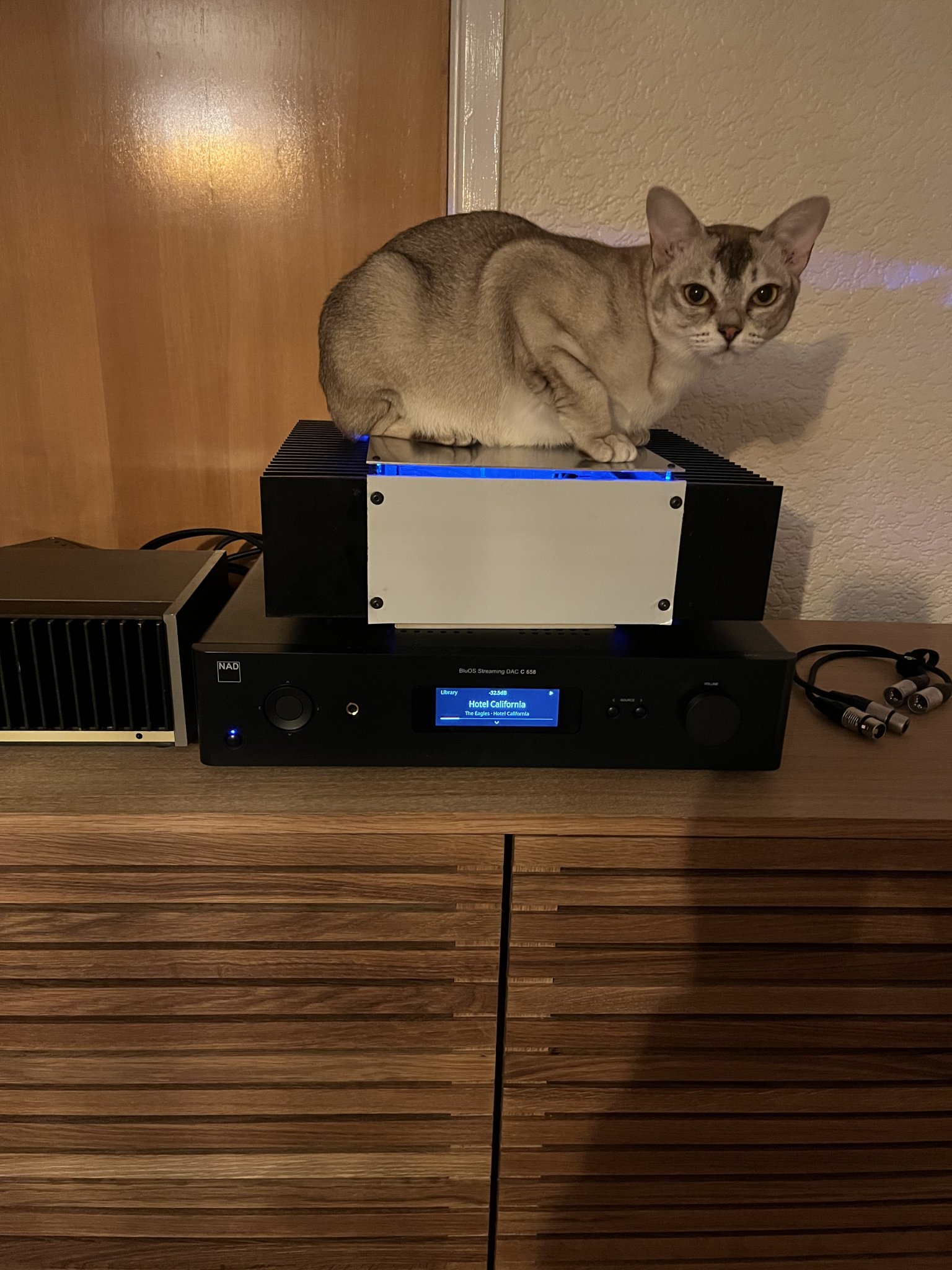

Almost finished. The case is a work in progress as it needs paint, feet and a decent faceplate. I had both channels at about 410mv and near 0 dc offset after 30minutes of being on. I could not resist having a listen. First off it is dead silent, no noise could be heard when my ear was on the tweeter. The highs and mids were very clear. I only listened to Hotel California at low volume and I could hear more detail than normal. I normally use a quad 405-2 and the AJ is noticeably more musical at low volume. I will try it at a decent volume when my daughter is not sleeping.

Your cat will love this warm cozy spot..👍

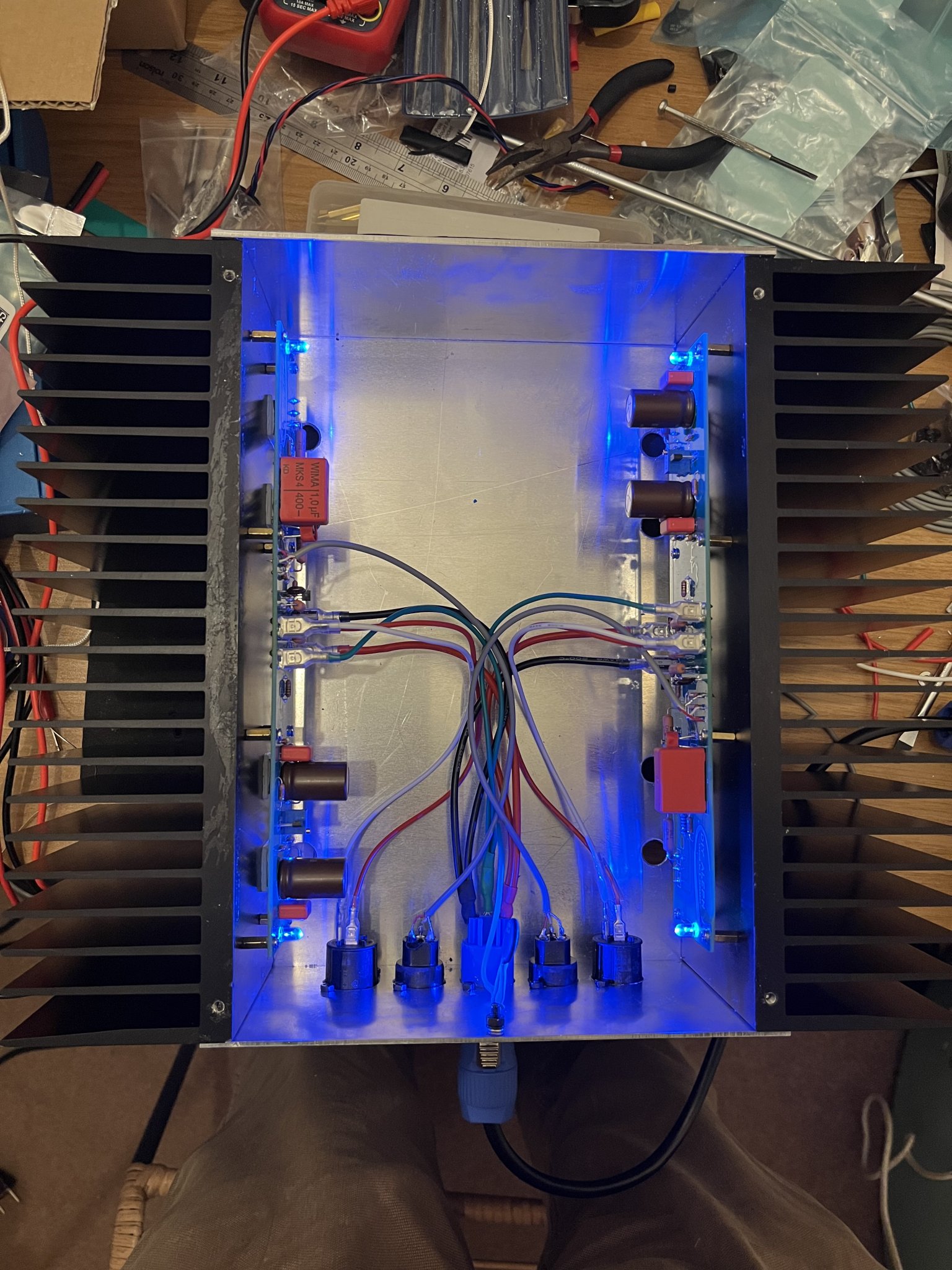

I’m sorry everyone, I think I wasted your time last night. The fuse hadn’t blown, the smps had tripped out. The tiny thing can’t handle 200w continuous for more than 10 minutes. I even put it in a larger enclosure this morning and that did not help, the Heatsink still gets too hot. However I have managed to test the amp and I am impressed, absolutely totally silent with better bass, mid and treble than my 405-2. I’m sure it would continue to get better after a couple of hours of being on.

I will try a fan in the external psu case. I will also try with the psu case open when there are no people or cats about and then a mesh top could be a solution. When I was running it on my workbench/table with only one channel it was fine and stayed cool, it was naked and dangerous just sitting on standoff’s.
