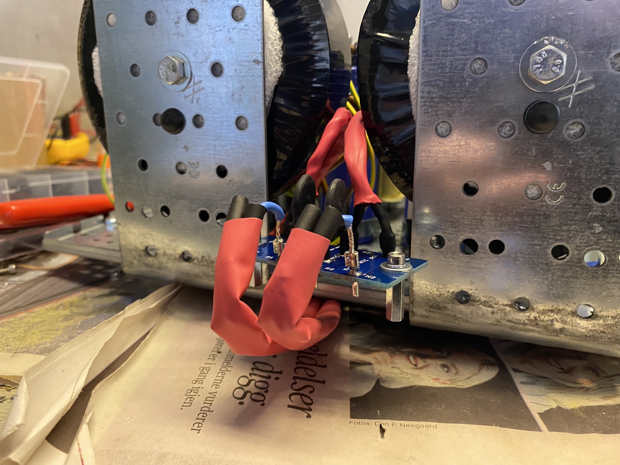

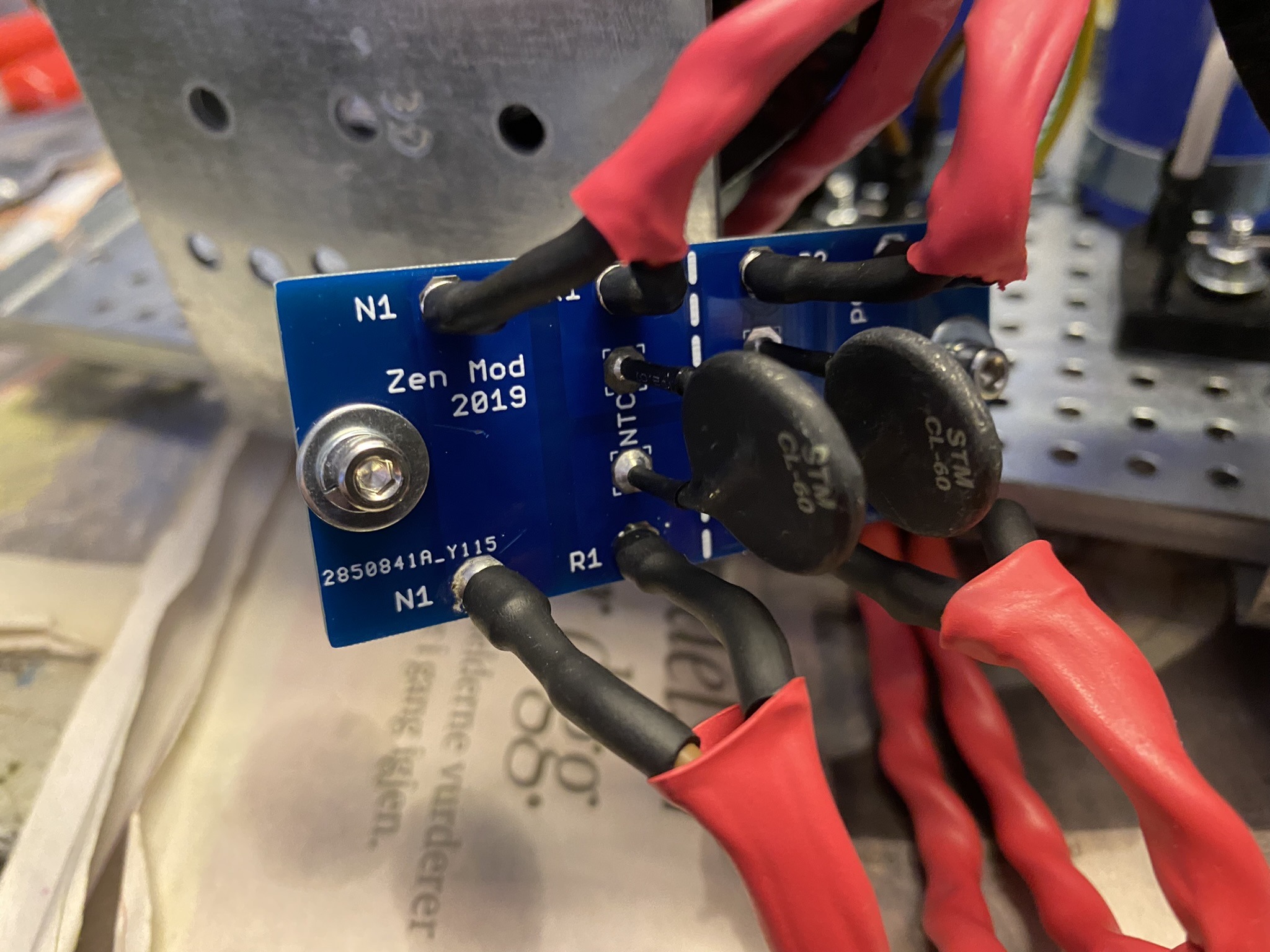

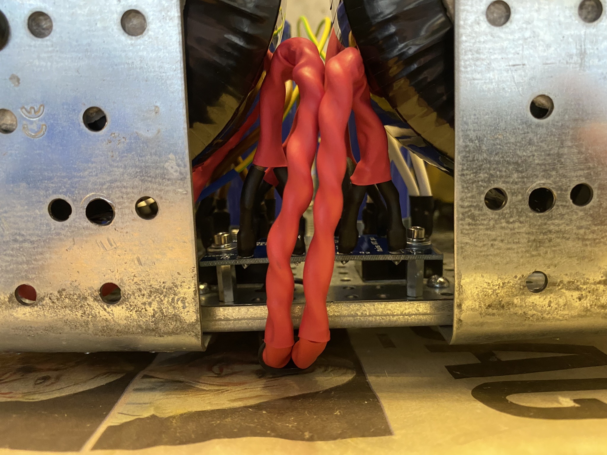

Same here. Most of those plastic covered ones I grab with needle nose, hold it in flame and scrape the plastic off. Solder, cover with shrink wrap.I highly regard direct soldering and or shrinked needle pins instead of fastons. Not as flexible, but ensures tight sleep every night

I'm curious what a needle-pin is as a connection. Could someone share a picture?
I used a lot of fast-on connections in my builds. Bought lots of crimp-on connectors in various sizes (20awg, 16awg, etc.) from Amazon
Thank you.
looks like some are soldered fast-ons and some are wires soldered into the board.
Do some have a physical pin in them?

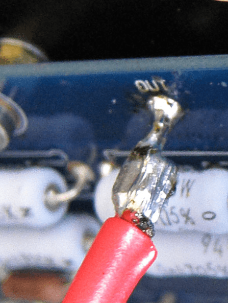

I used a Mogami W3101 4mm² (#12AWG) cable and heavy-duty pure copper Terminals PIN WIRE 16-14AWG (Mouser):
https://au.mouser.com/ProductDetail/TE-Connectivity/165045?qs=HjC056NR38F9ygYZj8ieGw==&countrycode=AU¤cycode=AUD
Check the picture I attached. That 4mm² (#12AWG) wire can almost fit... the remainder can be carefully spread on top of the pins and then soldered. You'll need a 60 - 80W soldering iron.
Yes, it looks that way but is not. I used pins looking like the ones MZM posted, but without isulation. First presoldered the wires, then machanically shrinked the needle pins, then solder it all together with a bunch of flux and a huge solder tip. Then soldered that to the board. So four processes. Not going anywhereThank you.

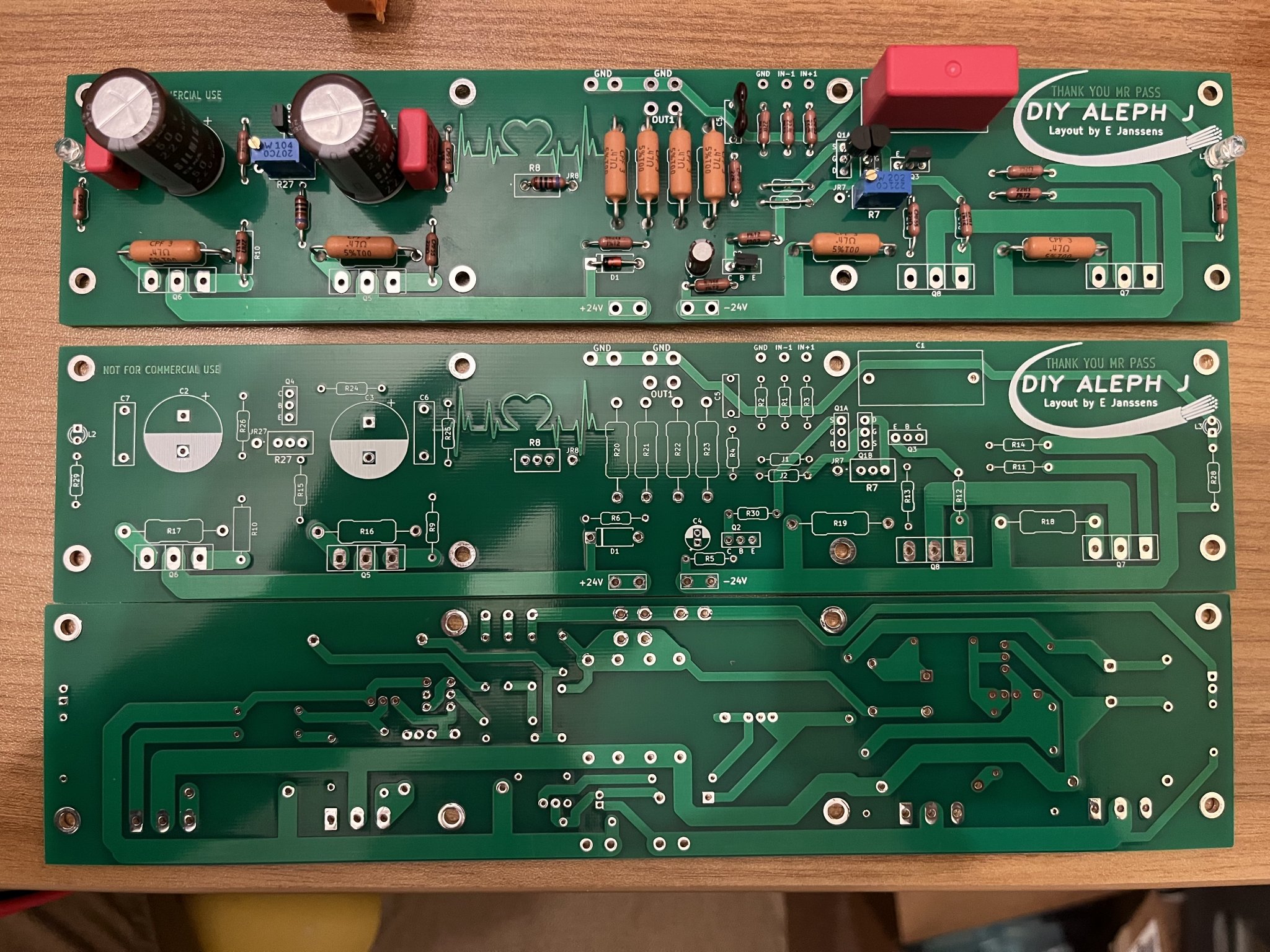

I had all the bits to make an AJ, was waiting for the DIYaudio Store to get some boards in and got bored. So I looked at some layouts, learnt KiCAD and got a few PCB’s made in china. Just finished stuffing my first board and hopefully get the second done tomorrow. I still need to sort out my heatsinks and power supply. Should have magic smoke or an amp in a couple of weeks. Never made an amp from scratch so fingers crossed

I had all the bits to make an AJ, was waiting for the DIYaudio Store to get some boards in and got bored. So I looked at some layouts, learnt KiCAD and got a few PCB’s made in china. Just finished stuffing my first board and hopefully get the second done tomorrow. I still need to sort out my heatsinks and power supply. Should have magic smoke or an amp in a couple of weeks. Never made an amp from scratch so fingers crossed View attachment 1082788
Sweet!!🙂

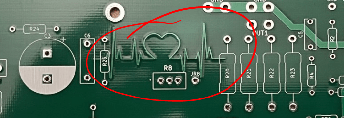

I really like the placement of the placement of the +/- 24V solder points. The heart rate monitor is a added bonus cool touch 😎👍
