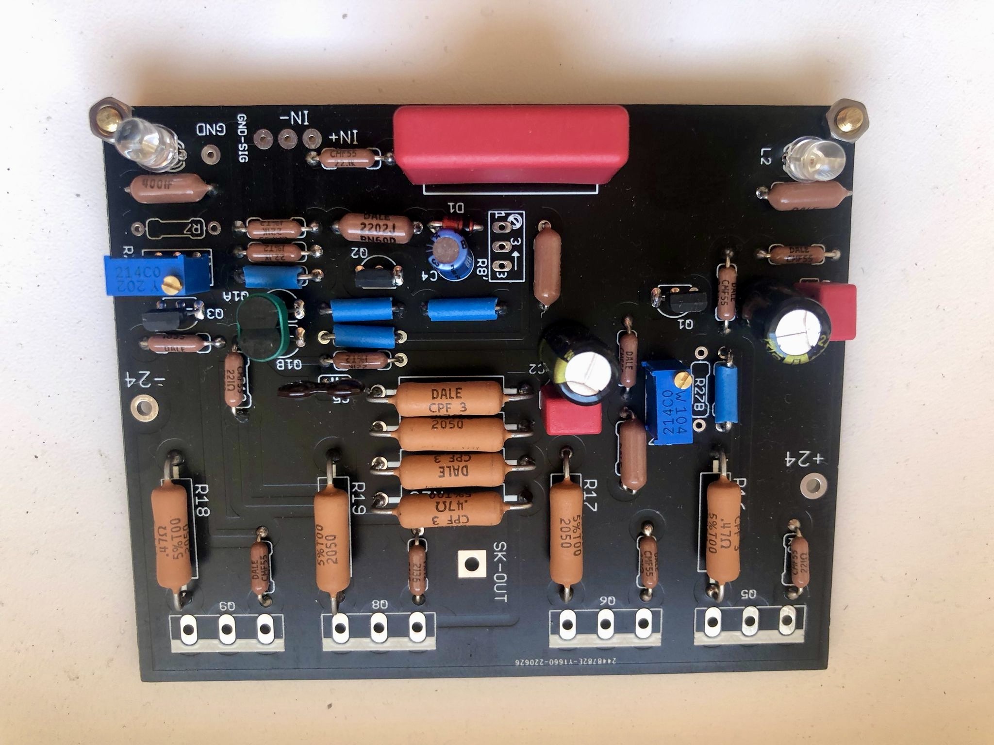

while I am waiting for the original pcb I bought a non-original board here in Italy and after having mounted it it seems to me that the trimmer r27 on the pcb is marked opposite. This is because, after mounting it, instead of reading 68k ohms I read 32k ohms. Also I tried to adjust it and to increase the ohms I have to rotate counterclockwise. Now I would like to know if the resistive trimmer is placed in the opposite position, are there problems or does it work anyway?
