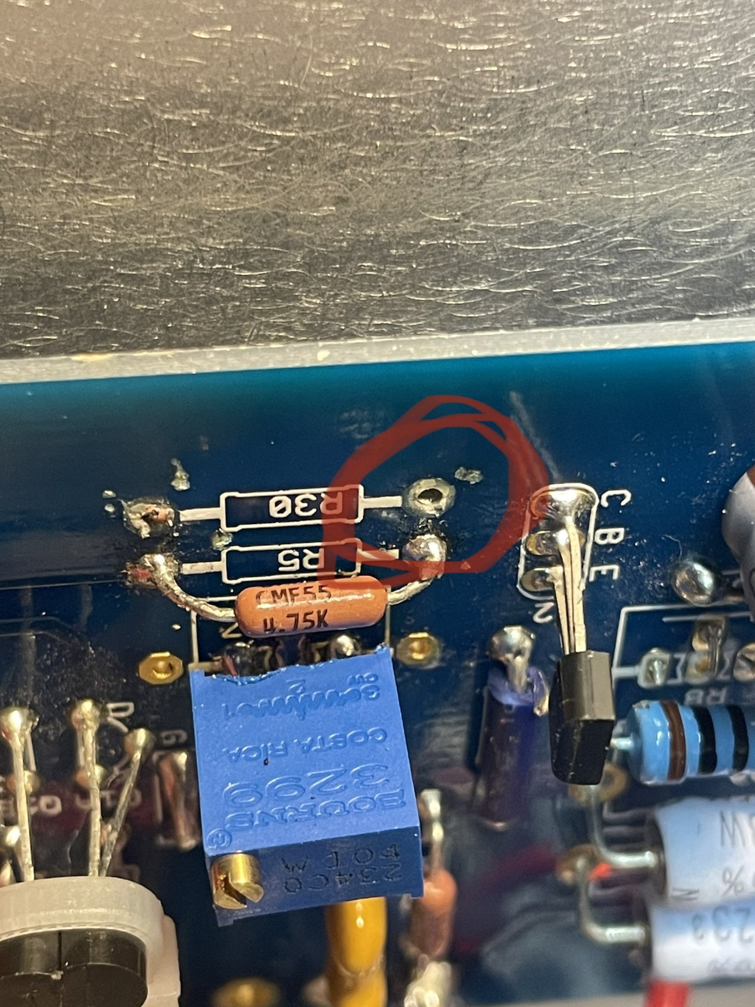

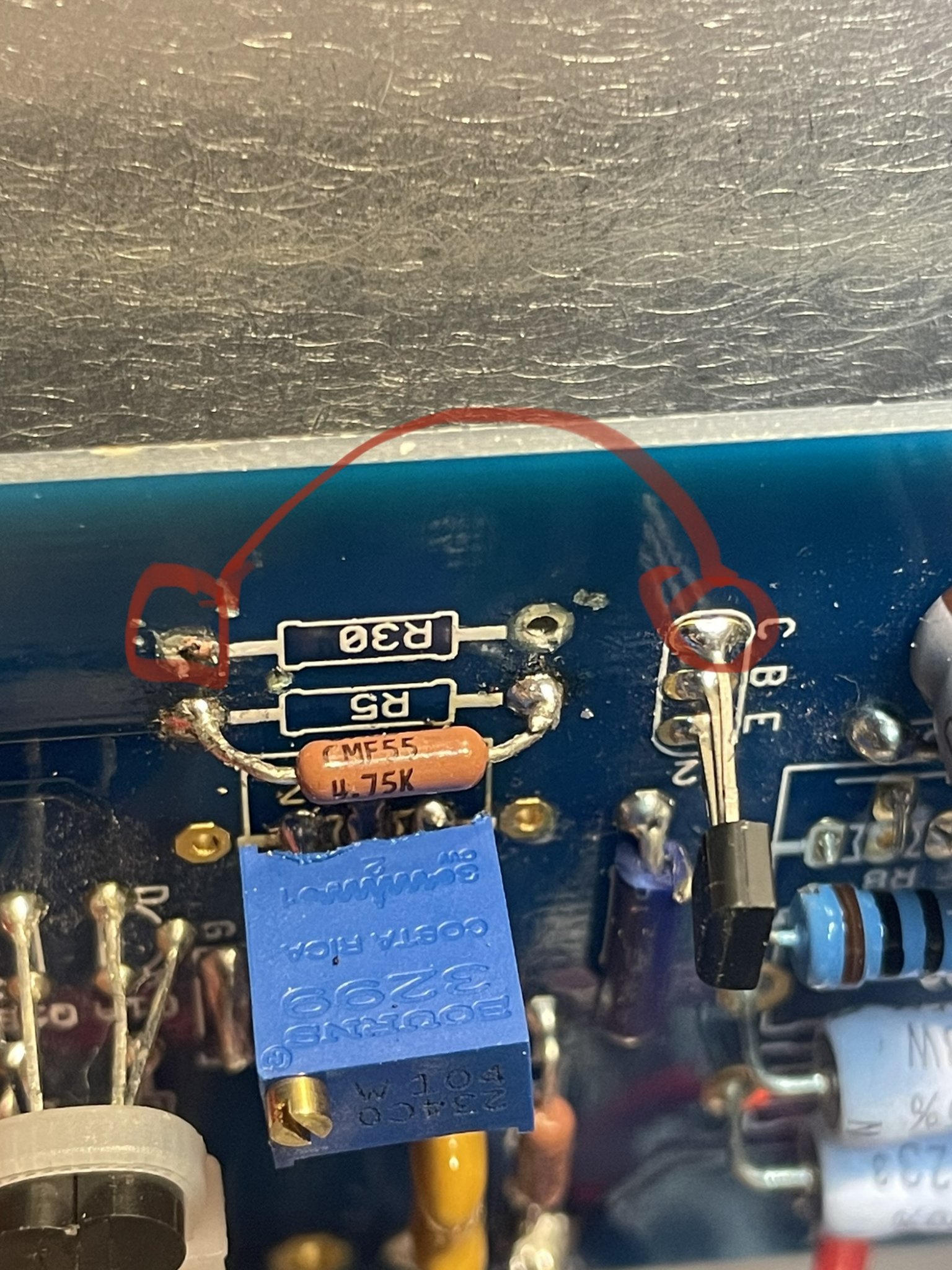

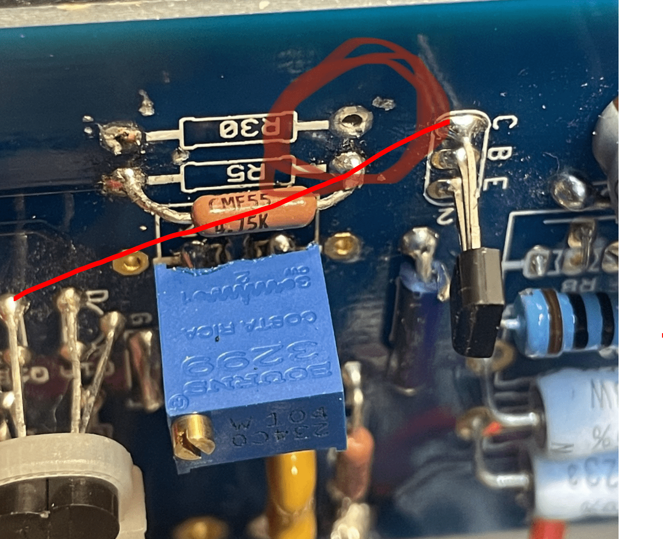

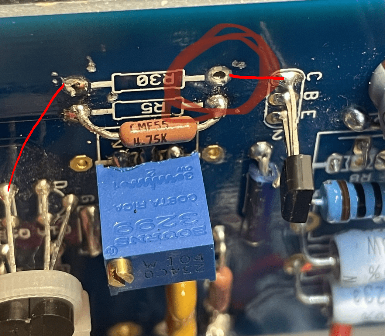

Hi All. I made a boo-boo and need some help. While desoldering the jumper placed at R30, I accidentally removed one of the solder pads. I would like to repair this by soldering a wire onto the surface of the board that makes the required connection that has been removed. I looked at the schematic, and tried to figure it out with a DMM set to continuity, but I am stumped as how to do this. I really don’t want to take the board off the sinks, as this build was a bit of a wiring nightmare, and this would add a lot of work. I have attached an annotated photo that shows the place on the board where the solder pad came off. Any guidance would be much, much appreciated.
Based on a photo I found online of the back of the DIY Audio PCB, it appears that the connection in the photo should be made. Is this correct?
Thank you very much for your speedy reply. R30 was a jumper, and the right side (in the photo) is torn off, while the left side is good. Can I put a jumper from the left side to C of Q2 as in the photo in my second post?
You can, if the PCB via/eyelet/hole marked with the red cross, is good. It seems it is, so go for it.
Perfect. Thanks. I’m going to bias it up after making the connection.You can, if the PCB via/eyelet/hole marked with the red cross, is good. It seems it is, so go for it.

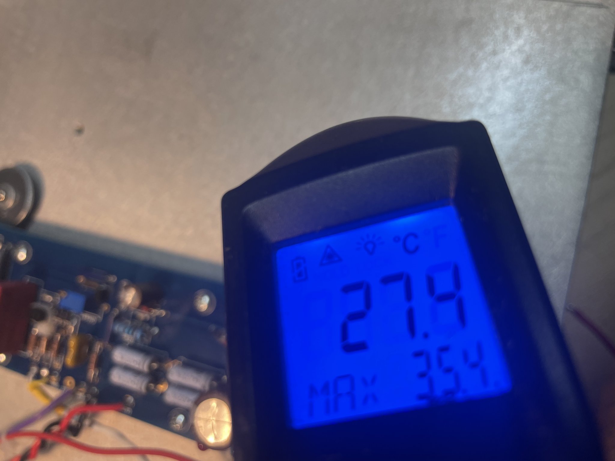

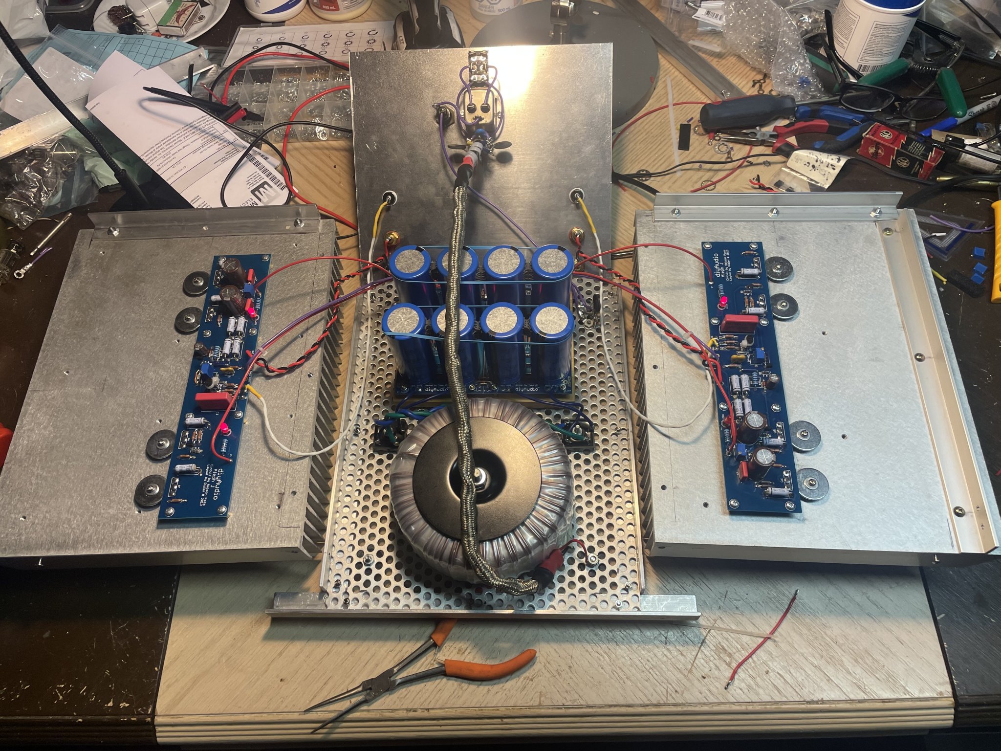

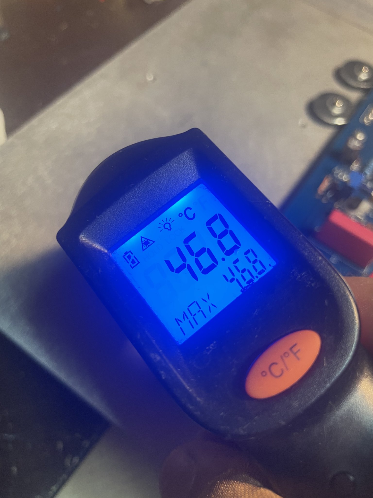

It’s alive! It has been biased at .4 Volts for an hour. One of the LEDs is dead and needs replacing. The washers securing the mosfets are at 27-30 degrees Celsius, and the heat sinks, where they are hottest close to the mosfets, are at 46-48 degrees Celsius. The measurements are made with the heatsinks flat. They should be cooler when in their optimum upright position. Does this mean that I can bias hotter?
The amp.
The temperature of the washer securing the mosfets.
The temperature of the hottest part of the heat sink after an hour.
The amp.
You probably could though I would defer that decision until after the case is put together. Your heatsinks in the vertical position should be more efficient, but the interior of the chassis will likely be hotter because of the more restricted air flow.
