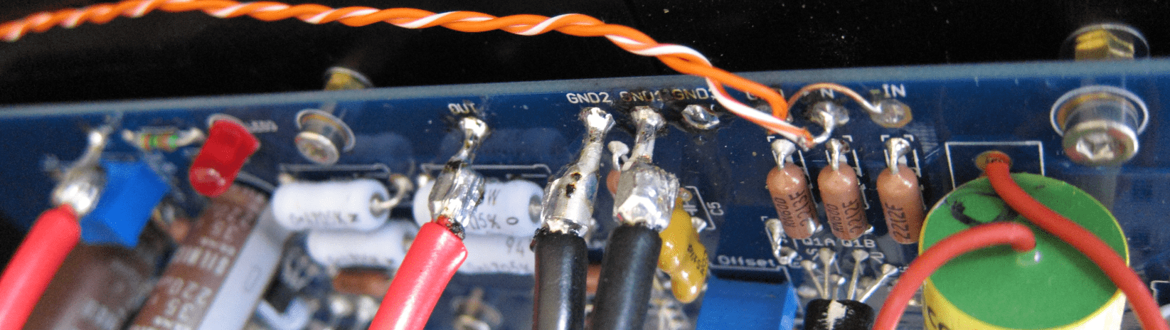

You should do a ground-lif modification, most definitely.When shorting plugs or cables from the source are plugged in, there is a slight hum/buzz in the previously silent channel, and a louder hum buzz in the noisy channel.

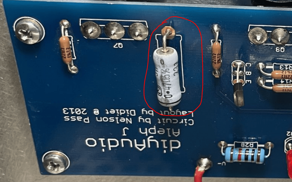

Most likely an input differential pair needs to be replaced. Did you use an antistatic wrist strap (properly grounded)? You have to use it when handling the JFETs. Once they (the JFETs) are soldered onto the PCB, you can remove the wrist strap.My guess is that there isn't a grounding issue, and that there is a bad component or soldering problem on the one noisy board.
This looks burnt to me...When I built the amp boards a long time ago, the BOM I used called for a 500 Ohm pot in the the LTP Bias space. This was apparently an error, as that is supposed to sit at 1K Ohm, so I replaced the pots with 1K resistors without removing the boards. I did this by rocking the pots back and forth slowly (they were not installed tightly to the board) until they snapped off, and then I put in a 1K Ohm resistor in their place. Unfortunately, on the board I'm having a problem with, I accidently removed the 2K Ohm pot at R7 instead of the LTP Bias pot. I replaced that pot with another pot, but did it without removing the board, and didn't do a good job. When I removed the R30 jumper and R7 to get to the pot, I tore out the trace on one side of the R30 jumper. All in all a mess that wouldn't have happened had I done the right thing and removed the board and done it properly. I am going to test voltages first as per your post, and then report back. Here are some closeups of the interior....
You are kind of in a bit of a pickle. You may need a brand-new PCB... painful.. I know....

Aleph J may require a ground lift resistor when used with a single-ended RCA input, to team the slight hum/buzz. This hum/buzz will be audible on both channels - equally, and will not cause what you are experiencing - which is the loud motorboat noise when turning the amplifier OFF. The most likely root cause for this motorboat noise is the input differential pair... and possibly the active current source transistor Q4.
You could also use a good working side (PCB) as a reference point, i.e. compare the bad side with a good working side.
I'd do the ground lift mod first, replace the Q4 second, and then replace the JFETs last.... just make sure what I mentioned above is all good first. Or, do all 3 in one go... while the PCB is removed.

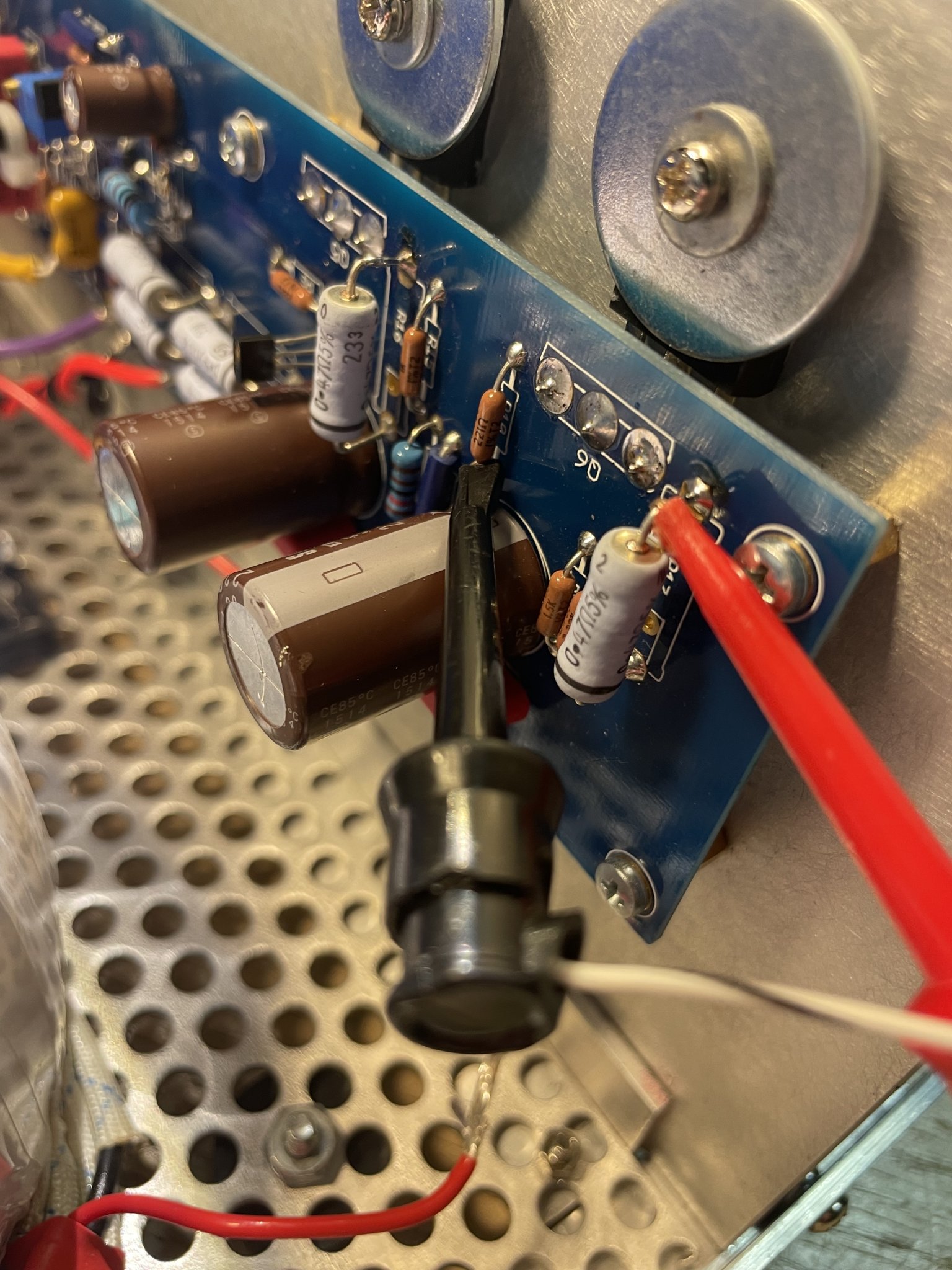

You did not measure the voltage across Q4 - the collector-emitter voltage...? (be careful when measuring this)
This is how I measured R10 to R17. Is it the correct way?

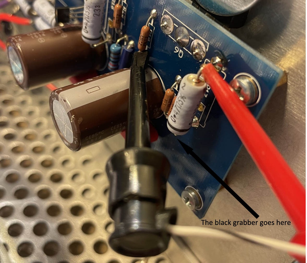

Measure the voltage drops across every 0.47ohm resistor... see the comments and the black arrow...

1. I can and will do this as I have enough slack to do so.
2. I will do this as well.
3. I have not tried rotating the transformer. I have enough slack to do about a quarter turn in one direction (clockwise with respect to my photos)
4. The chassis panels are screwed together in multiple places. There should be good continuity between panels, but I’ll check it with a meter.
5. I can move the rectifiers, but I am inclined to move the entire power supply out of the chassis and put it in another separate chassis and use an umbilical. Would this be a better path to take?
6. I tried listening with and without the shield wire connected to the chassis, and it made no difference, but if it’s best practice, I will connect it to the main chassis ground.
That said, the amp isn’t just humming. It also either makes a loud motorboat sound that starts fast and slows down, or a loud high pitched whine on shut down. My concern is that working on the hum and fixing it seems unlikely to fix the other problem. Incidentally, the amp sounds really great when playing music despite the hum and shut off drama.

What are the voltage drops across the 0.47ohm resistors?

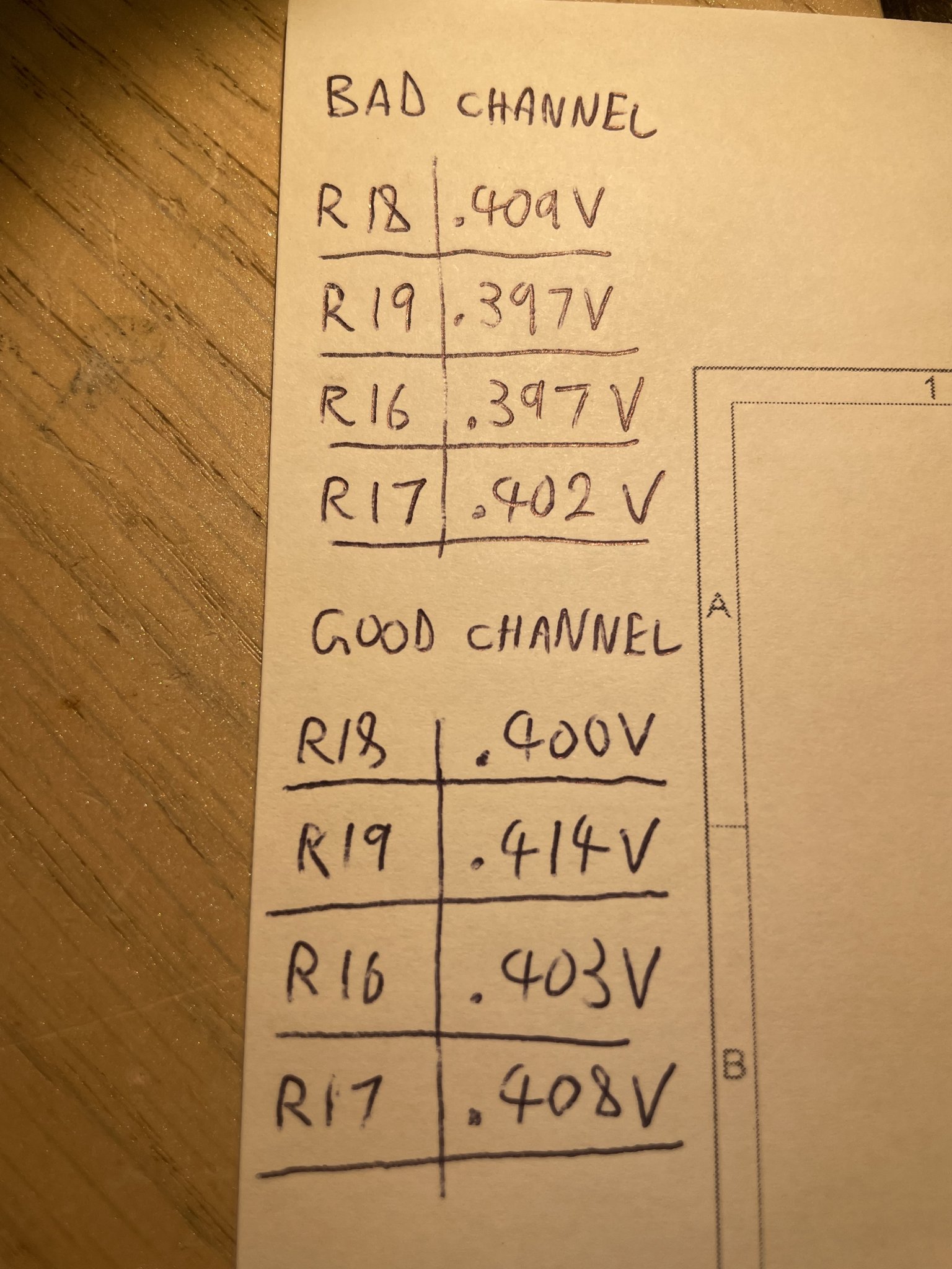

These are the voltages across the .47 Ohm resistors.
The bad channel:
MOSFETs and 0.47-ohm resistors seem to be okay. The motorboat noise is most likely due to the bad JFETs, but it could be because of the CCS transistor going bad... the CE voltage of 5 V seems too much. Replace all 3 transistors.
The good channel:
The 0.414 seems to be too much. Either the MOSFET is bad/dying, or the 0.47-ohm resistor is shorting... was this measured across the resistor that I pointed out (circled in red) in one of my previous posts?
The good channel:
I am not sure what's the story with the PCB tracks; have you repaired them?
I am assuming that you already checked your soldering... on either amp PCBs...??

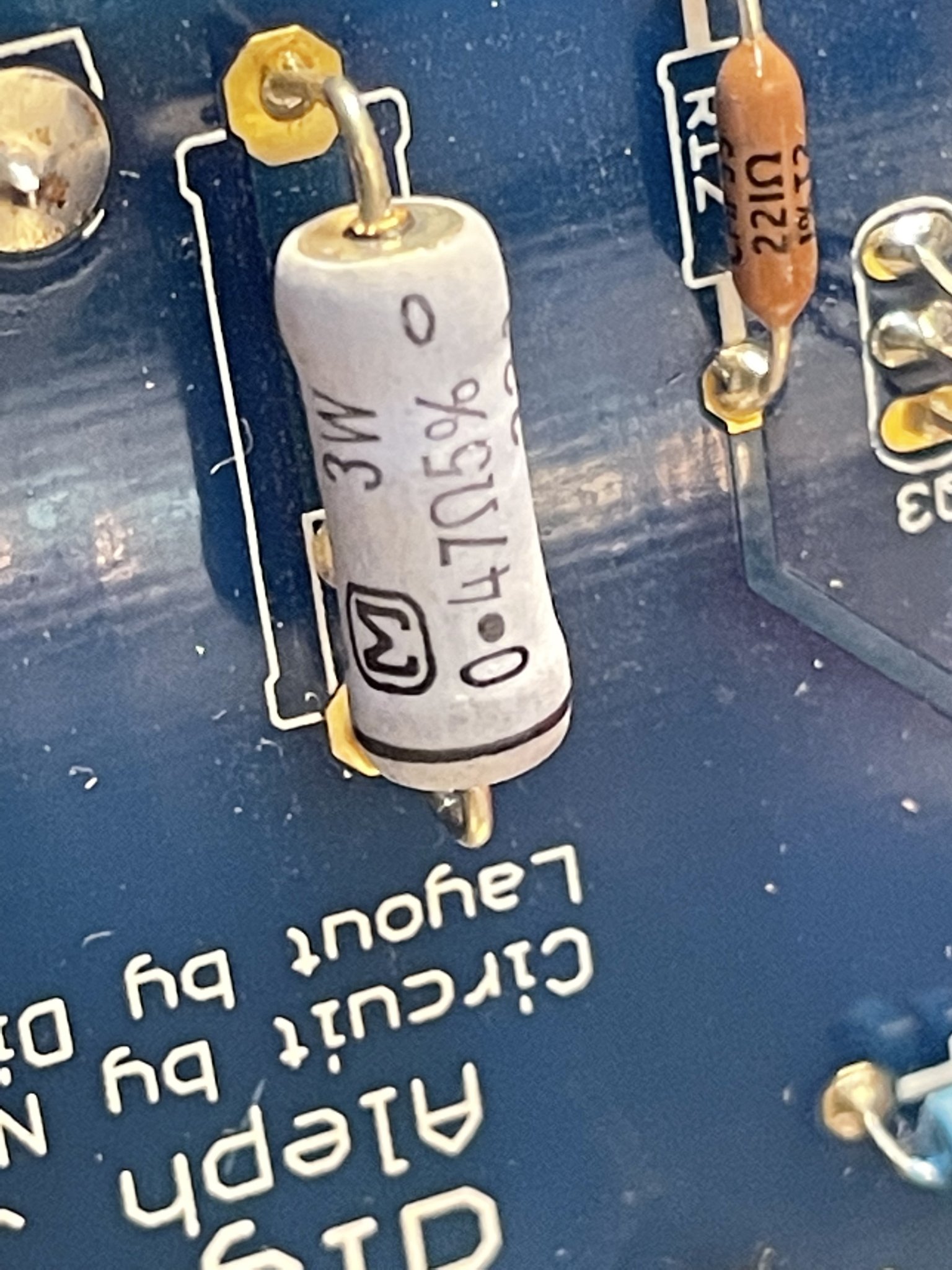

This resistor is R18 on the bad channel. It measures at .409V. The resistor at .414V is R19 on the other good channel. The darkness on the resistor in this photo was just some dirt that wiped off. It’s not hot at all in operation. Here it is rubbed clean…You should do a ground-lif modification, most definitely.

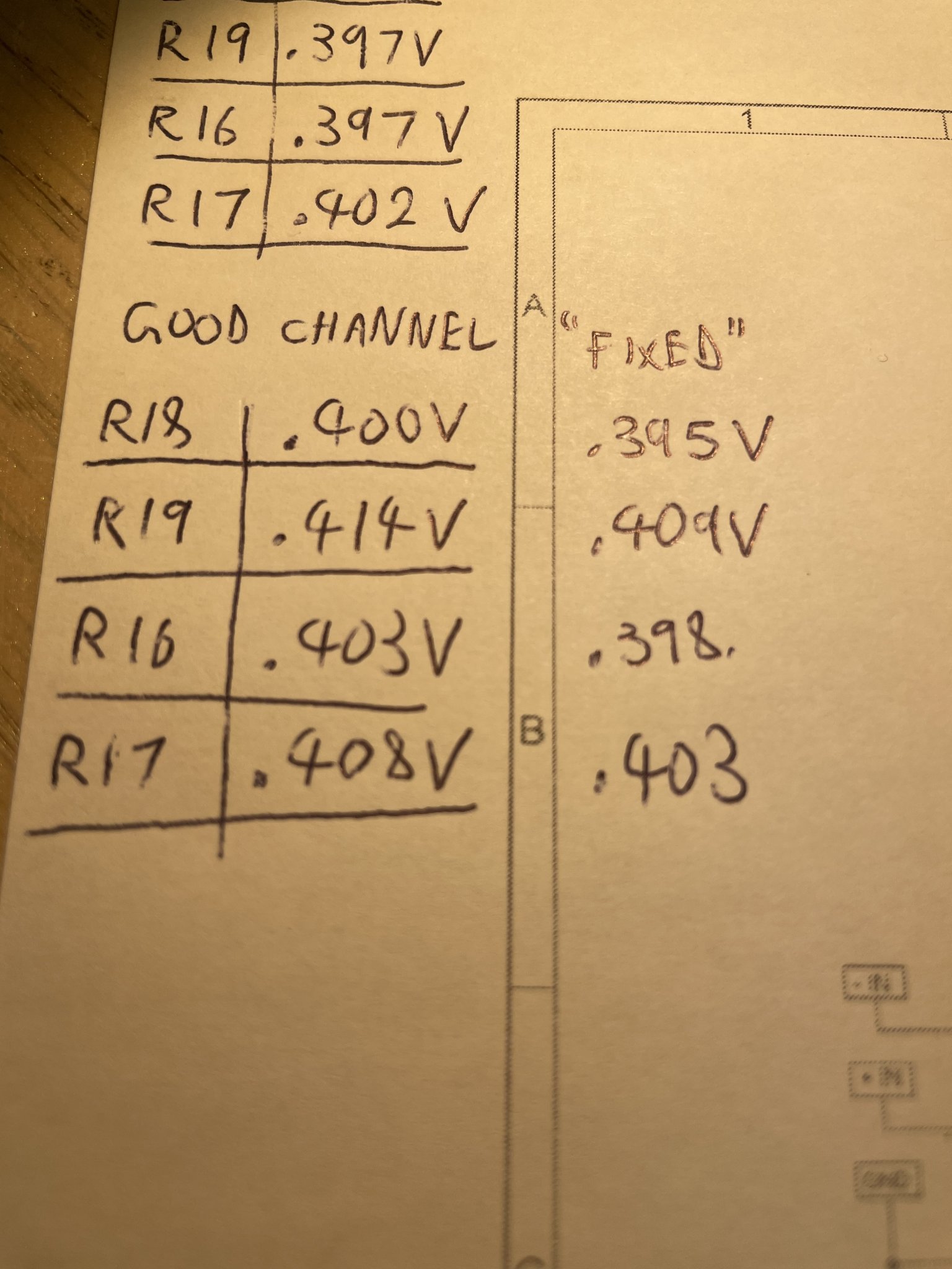

I adjusted the voltages on the good channel. Please see attached photo.The bad channel:

I think the track repair was good. I will remove the PCB and make sure that it is. By replace all three transistors, are you referring to the two jfets and the CCS transistor at Q4 on the bad channel? Q4 C to E measures close to 5V on both channels, and the transistor that was .414V is R19 on the good channel. It is now .409V after adjustment. It seems that with the adjustment, both channels show similar spread between the transistors.
I think you are not feeding the input correctly... it seems like you are feeding the shield to -IN and hot to +IN
I didn’t own a wrist strap when I populated the PCBs, but I did ground myself prior to installing the jfets. Perhaps insufficiently.Did you use an antistatic wrist strap (properly grounded)? You have to use it when handling the JFETs. Once they (the JFETs) are soldered onto the PCB, you can remove the wrist strap.
So, your amp might be okay... even though those readings of close to 5V seem high; anyway -> you just need to fix the input wiring.
You are correct! I’m going to fix it right now. I feel very dumb right now.I think you are not feeding the input correctly... it seems like you are feeding the shield to -IN and hot to +IN
