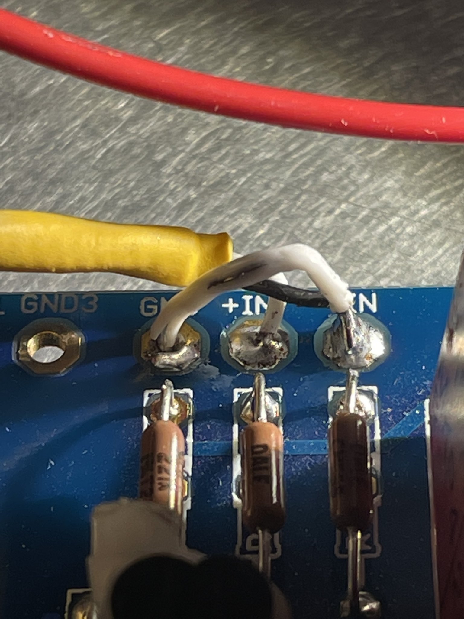

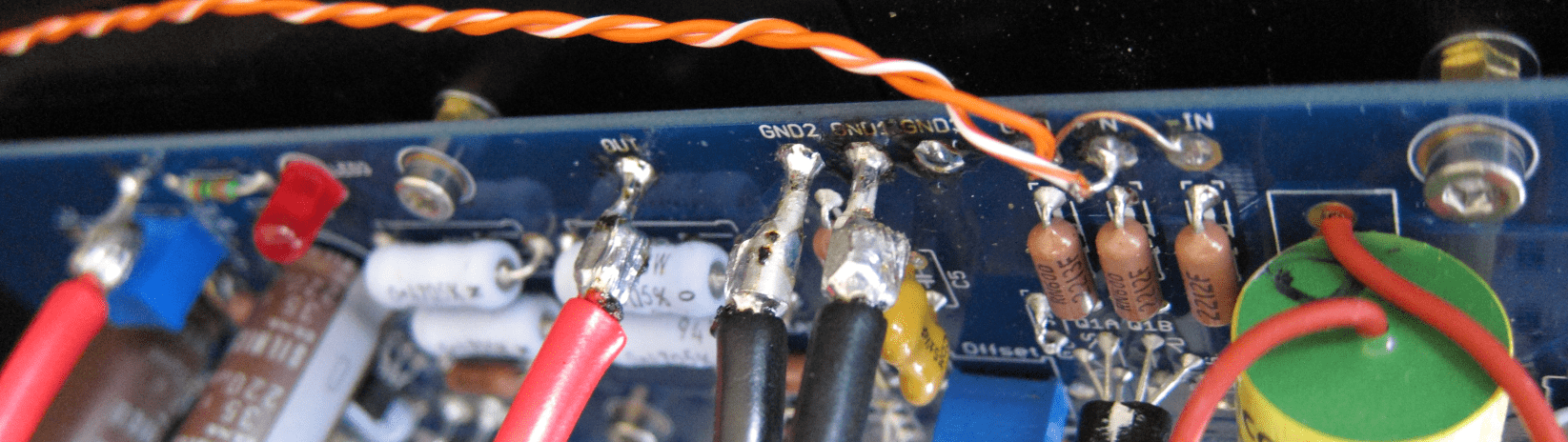

Is it okay to go to -IN first and then to ground?

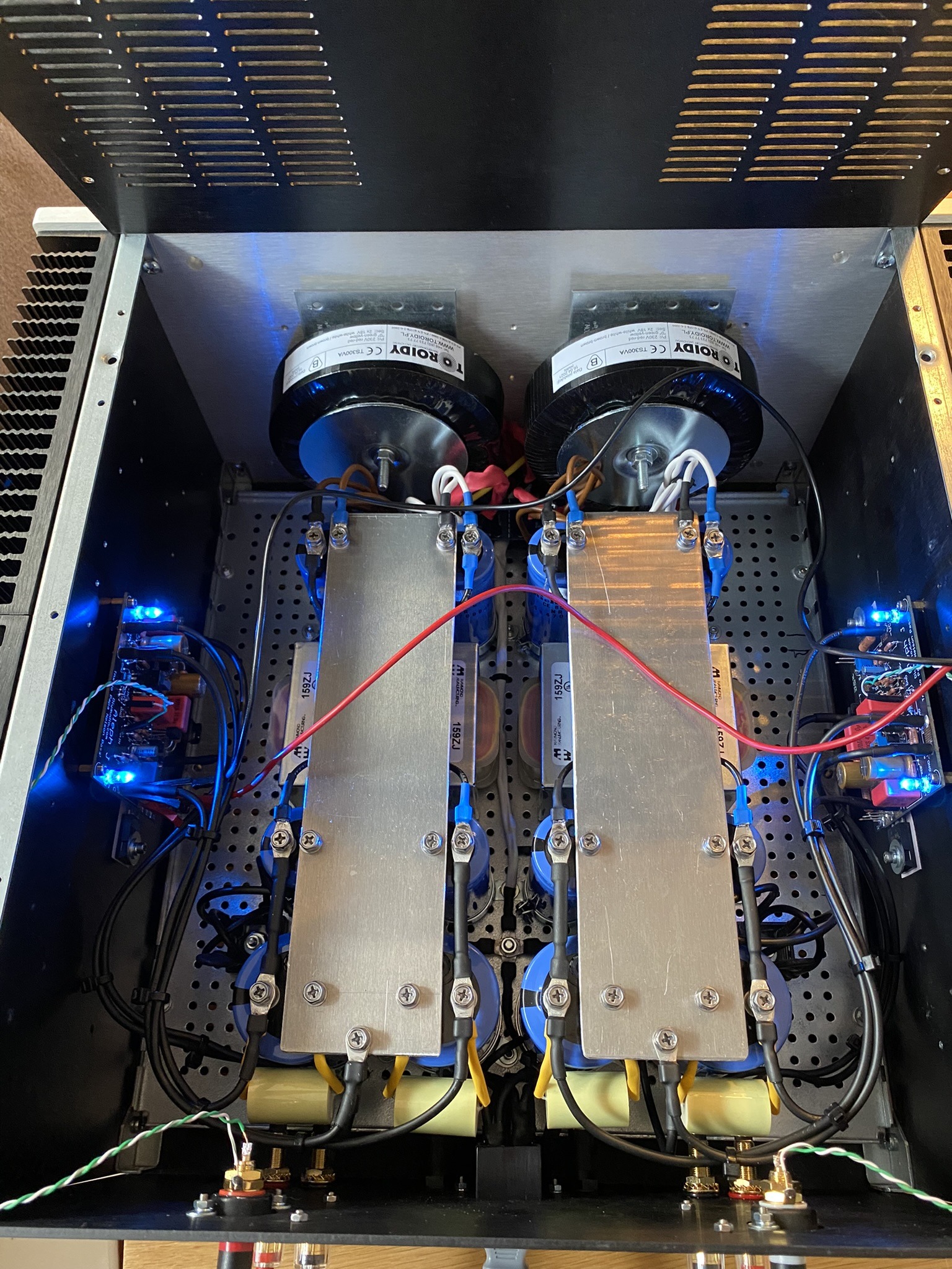

The amp is still humming, about the same as before, but now it’s the same in both channels. The amp now shuts down with a quiet thump as it should. I fiddled a bit with the wires from the power supply board to amp boards, and I can change the volume of the hum by moving them around. The volume goes up the closer that the wires feeding power to the boards get to the rectifier blocks. What steps do you think I should take next? The ground lift mod?YES !!

It may be just me, but two of those three connections look as if they were made with an iron that wasn't man enough (or hot enough?) for the job.
GND in particular.
GND in particular.

Also, twist them tightly, and consider rearranging the bridges further from the amp boards, as said before. Since it increases and decreases when moving wires around, this indicates that some - or a lot - of what you are hearing is AC ripple from the wires to and from the rectifiers, inducing small currents in the clean dc power cables, and that is then amplified by the Aleph J gain stage(s).The amp is still humming, about the same as before, but now it’s the same in both channels. The amp now shuts down with a quiet thump as it should. I fiddled a bit with the wires from the power supply board to amp boards, and I can change the volume of the hum by moving them around. The volume goes up the closer that the wires feeding power to the boards get to the rectifier blocks. What steps do you think I should take next? The ground lift mod?

Thanks. I will double check them and reflow if required.It may be just me, but two of those three connections look as if they were made with an iron that wasn't man enough (or hot enough?) for the job.

The chassis is a bit tight from side to side, and it isn’t very deep either. It’s mostly just tall. It seems that it may be best to move the power supply to a different chassis. Do you think that given the space available, I can re-wire and twist wires and have it result in a silent amp?Also, twist them tightly, and consider rearranging the bridges further from the amp boards, as said before. Since it increases and decreases when moving wires around, this indicates that some - or a lot - of what you are hearing is AC ripple from the wires to and from the rectifiers, inducing small currents in the clean dc power cables, and that is then amplified by the Aleph J gain stage(s).

Well, it is difficult to say, it may or may not. Remember, moving the psu out creates issues of it’s own, and dangers. You really need to know what you are doing.The chassis is a bit tight from side to side, and it isn’t very deep either. It’s mostly just tall. It seems that it may be best to move the power supply to a different chassis. Do you think that given the space available, I can re-wire and twist wires and have it result in a silent amp?
I would recommend you try and see how good you can get it with the psu inside the amp chassis.

1: First off, follow bokys advice on the hum breaking resistor. 10-20 ohms should do it.
2: Just twist them wires, and route them close to the chassis floor, as far away as possible from the bridges and transformer.
3: Consider collecting the psu gnd’s on one side of the psu boards.

Boky pointed out an error in the wiring of the input jacks on the two boards. When I fixed that, the loud noises at shutdown stopped, and that plus some fiddling with the power wires to the boards indicated that the left over hum was indeed a grounding and/or lead dress issue.

As Andy mentioned, twisting of wires to minimize loop area is beneficial. To each channel, the V+, V-, and Gnd should be tightly twisted together. The Gnd should follow the V+ and V- wires to their connection points on the board, and then the Gnd goes to its connection point.
Rotating the transformer to find the quietest orientation is also beneficial. If your transformer is an Antek, I have found that they "leak", and the quietest orientation is with the location of the AC in and out of the toroid pointing towards the front and back of the case.
