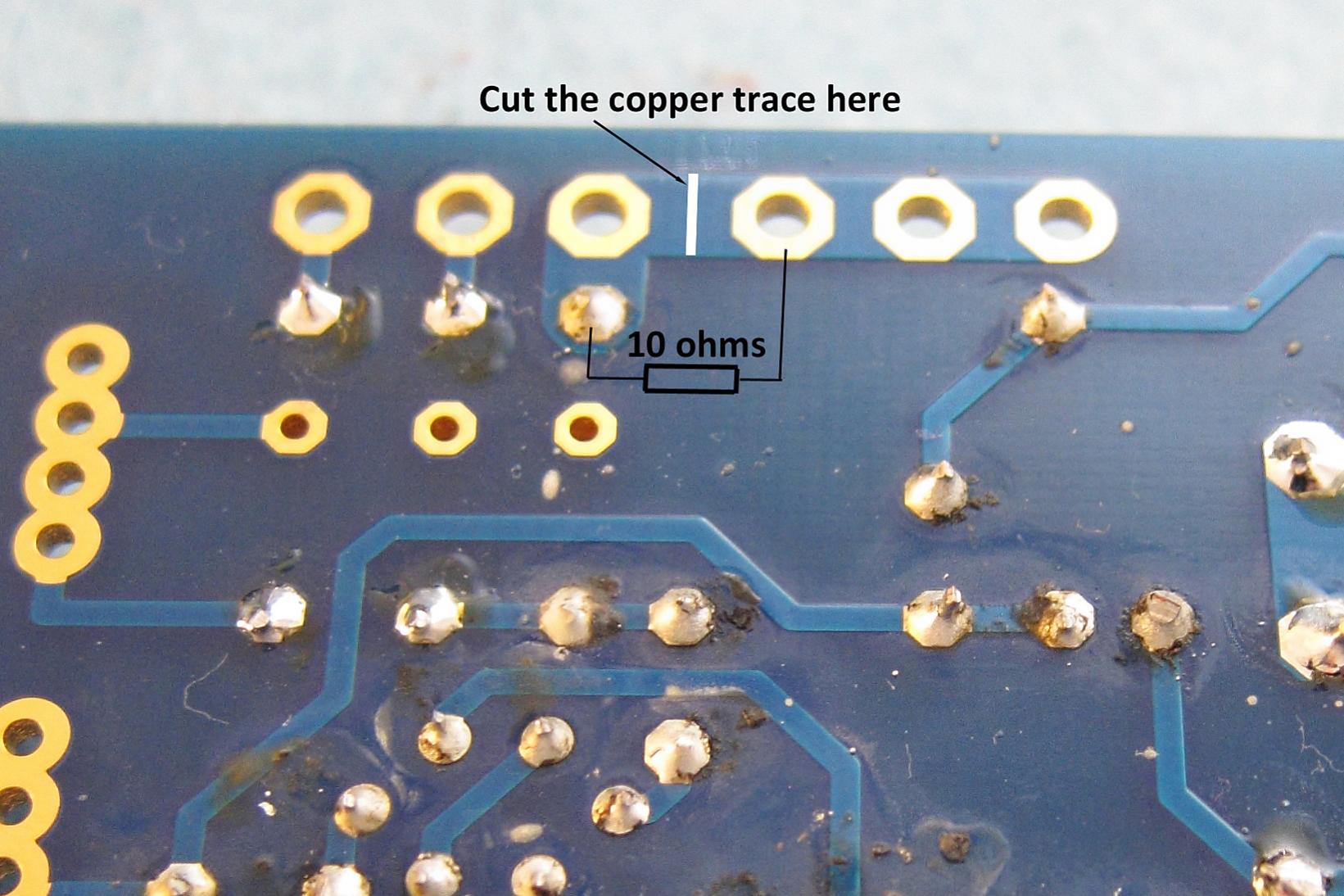

Next is Boky’s ground mod. Is it best to desoldering the transistors from the PCBs in order to remove the PCBs? Is it better to unscrew the transistors from the heatsink??

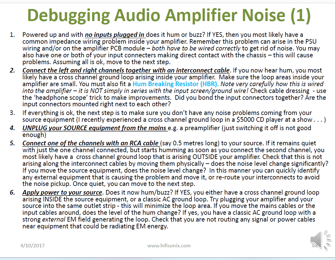

Some trouble shooting tips from page 68 of diyAudio member Bonsai's Ground Loop article:
Bonsai's Ground Loops Article
It is worthwhile to read the whole article.
In the end when the preamp, gain, and amplifier is sorted and there is still hum, then it may be that the power supply ripple is too high. The Aleph J is single ended so the noise rejection is lower than that of a push-pull amplifier. With 105dB speakers the ripple may be audible. I know that with my 103dB speakers, my single ended SIT amplifiers are hum free. However I recently finished Zen Mod's Redneck DEFISIT amplifier and it had a very quiet hum that was audible with my ear to the speaker. The difference between this amplifier and my other hum free amplifiers was CRC versus CLC power supply. In the end I replaced the 0.1R in the CRC with a Hammond 156B (1.5mH 0.07 Ohm) choke and the amplifier is hum free on my speakers.

Thanks. I’ll have a look at the article on gain distribution. I don’t use a preamp. Lately it’s a PC source, with Tidal’s own volume control, to a DAC and then to the amp I am using. The hum is there with shorting plugs, or nothing plugged in, as well. I suspect that it is from residual ripple. I have 264000 uF of capacitance in the power supply, and just the usual number of resistors required for the supply without any of the additional optional ones.well, when dealing with speakers so sensitive/efficient as yours, one need to take care of every link in chain - one of most important being gain distribution

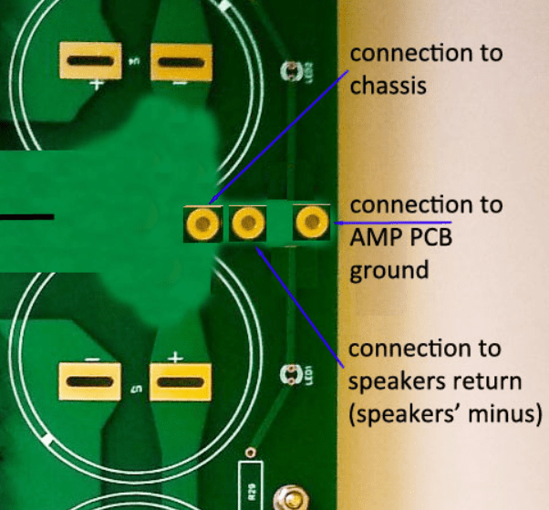

The power supply ground points are also not the same, as mentioned above. Here's something I posted earlier; it is a beginers' PS PCB design of one of the meberes here on forums. The proper common routing back to the PS PCB shouild look something like this:

I will run the wires from the rectifier along the bottom of the chassis. I'll have a look at the termination of the ground wires on the power supply PCB and see if I can get them closer together at the star point. Once I get the toroid vertical, there will be more room for a more careful arrangement of the parts, and for the additional inductors and additional capacitance if required. I just posted a response to Ben Mah asking about adding an additional LC to the existing supply rather than replacing the R in the CRC with an L. So a CRCLC.A small note on you audio gnd wires. I perhaps was unclear earlier. Having them mounted after filtering is good. But you can also achieve a further reduction in noise by soldering them together at the same point of the PCB. This is because by having one at each side, you create a loop area between the left and right side of the board. And this loop area is connected together through the noisy high current junction between the two psu halves.
