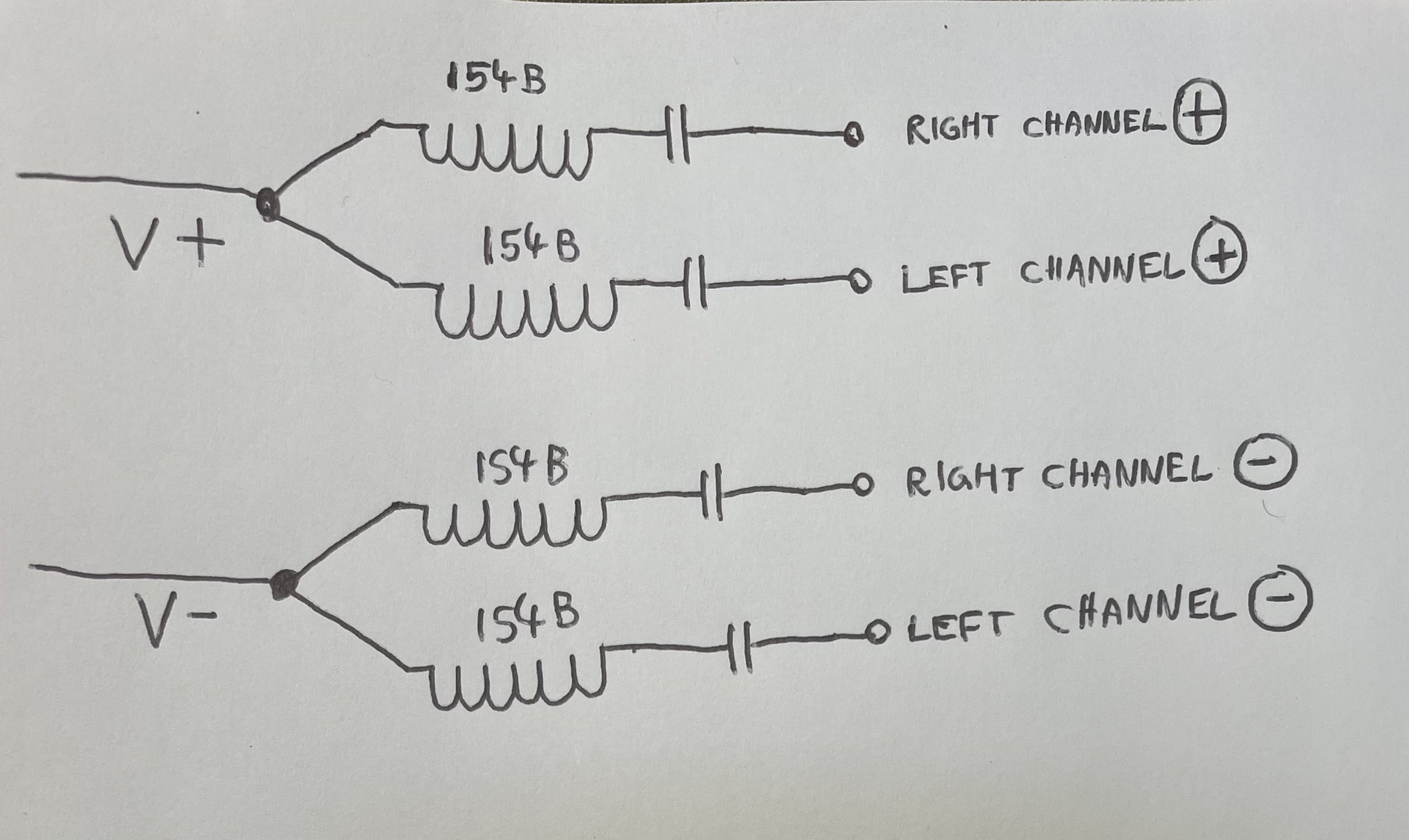

I don’t have the 156B on hand, but I have literally dozens of the 154B. It is 3mH at 1.5 amps and .14 Ohms of resistance. Can I use one (or more of) these instead? Does a pair in parallel give me 1.5mH at .07 Ohms resistance and double the current capability? I can add two per rail for a total of four in the power supply. Is the 1.5 amp rating enough for the Aleph J? A single 154B would provide 3mH rather than the 1.5mH of two in parallel.
Each channel draws about 1.7A so a pair in parallel per rail should work. The slight overage in current through the chokes will lower the inductance a tiny bit but that shouldn't be a problem. The chokes are rated for 300 VDC so power dissipation should not be an issue.
Great. Does it make sense to add an LC to the power supply since I'll have the room?Each channel draws about 1.7A so a pair in parallel per rail should work. The slight overage in current through the chokes will lower the inductance a tiny bit but that shouldn't be a problem. The chokes are rated for 300 VDC so power dissipation should not be an issue.

Yes.Great. Does it make sense to add an LC to the power supply since I'll have the room?
Instead of paralleling the chokes, you can provide a LC section to the V+ and V- to each channel. This has the advantage of some isolation between channels.

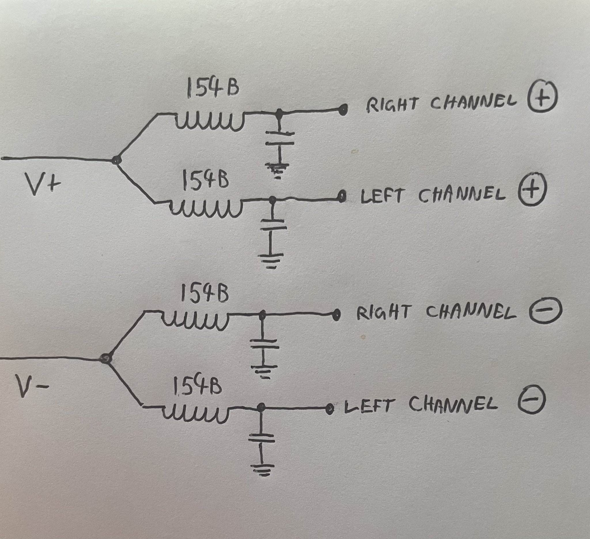

Thanks. So split the V+ and V- rails with two chokes per rail, then a capacitor, and then to the boards as in the diagram? Is there a minimum amount of capacitance recommended for the final capacitance node in this case? I ask because while I have several different pairs of large value capacitors, I don’t have quads of as many types. From memory, the quads are 5500uF and 10000uF. Also, I have a few quads of much smaller value (100uF) film capacitors as well if that will work, and provide some advantage.Yes.
Oops.cap in parallel, not in series
except if your intention is to make The Muter instead of amplifier
Thanks. Will do.What Zen Mod said. On V+, cap + to choke, cap - to Gnd. On V-, cap - to choke, cap + to Gnd.

Be sure what you are doing with your gnd. For example, with LC after CRC, you beed to consider moving your junction to the end of the supply. Follow the T, as suggested by boky, and cut a metal triangle to establish it, is one way of doing it.Thanks. Will do.

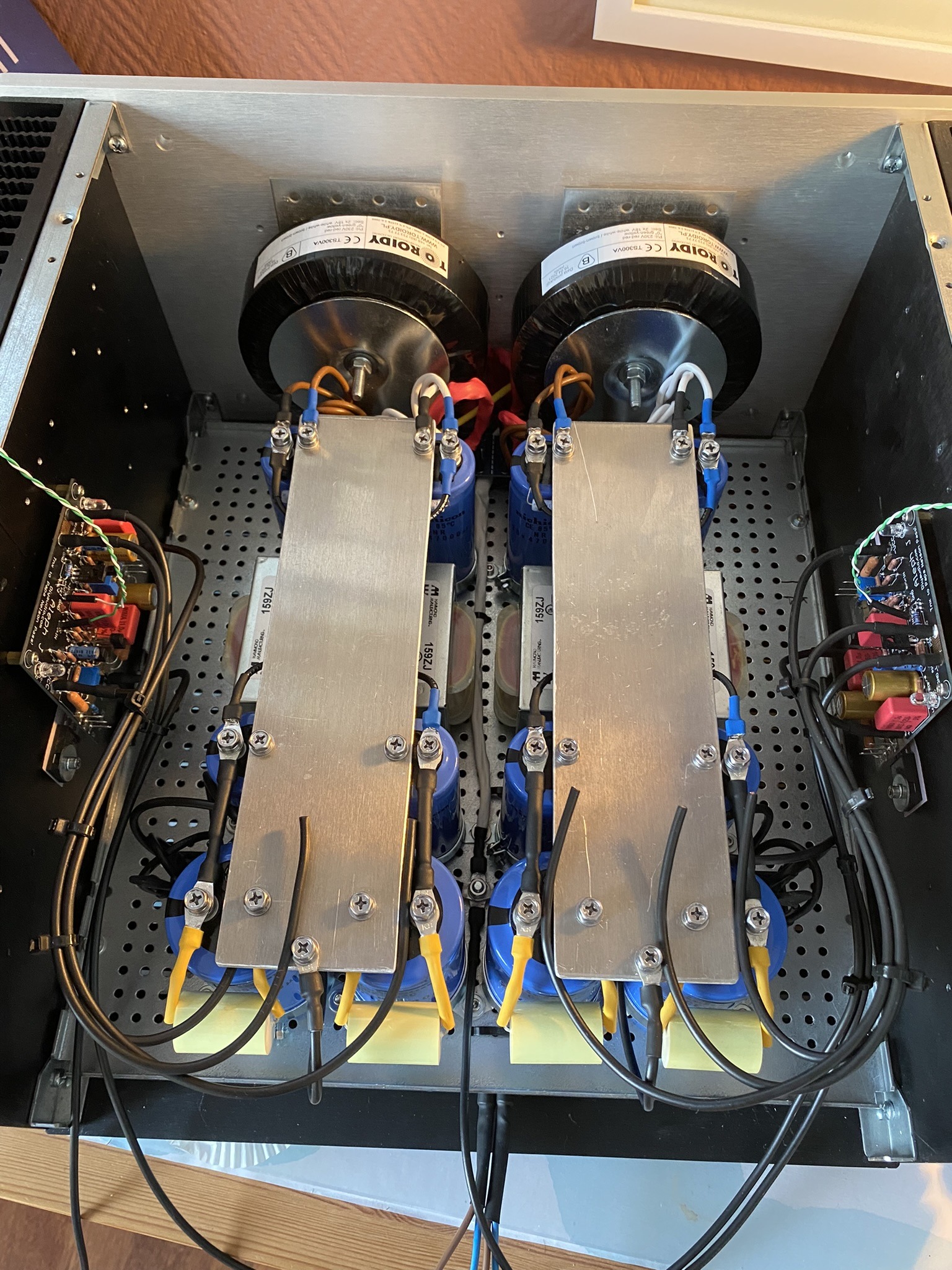

See the pics of my J earlier, and you’ll get the idea. Also, see Zen Mod’s blog. He hand built a few PSUs earlier, modelling this pretty much exactly
Make sure your gnd takeoffs are not in the middle of the junction between pos and neg halves, is the essence, and for 104db sens, make that point at the quietest part of the PSU. This can be other places than at the end, but the end is often close to the quietest part.
That said, it might work tapping the audio gnd off one of the cap joints. But it is seldom the most quiet place, though it can be quiet enough.
Remember/ collect your audio grounds to one point. I know you are allready accustomed to this thinking, I saw early on your perfect junction takeoff to chassis gnd
Edit: agree with Boky: the uni-PSU has a crappy gnd layout. This is your chance to remedy that
I’m confused. Please explain what this means.Follow the T, as suggested by boky, and cut a metal triangle to establish it, is one way of doing it.
If I understand your post correctly, I need to take the main ground connection off the PSU board and move it to the new end of the power supply. Also, I need to remove all previous connections made between the halves of the existing PSU, and connect the augmented halves at the end of the PSU? This would make the final connection at the last set of four capacitors if I split the current supply off and feed two chokes as per my drawing. Is this correct?
Your photo looks great. It looks like the metal plate is used as the ground plane. Is this correct? How did you attach the caps to the chassis underneath? Where are the rectifiers?Be sure what you are doing with your gnd. For example, with LC after CRC, you beed to consider moving your junction to the end of the supply. Follow the T, as suggested by boky, and cut a metal triangle to establish it, is one way of doing it.

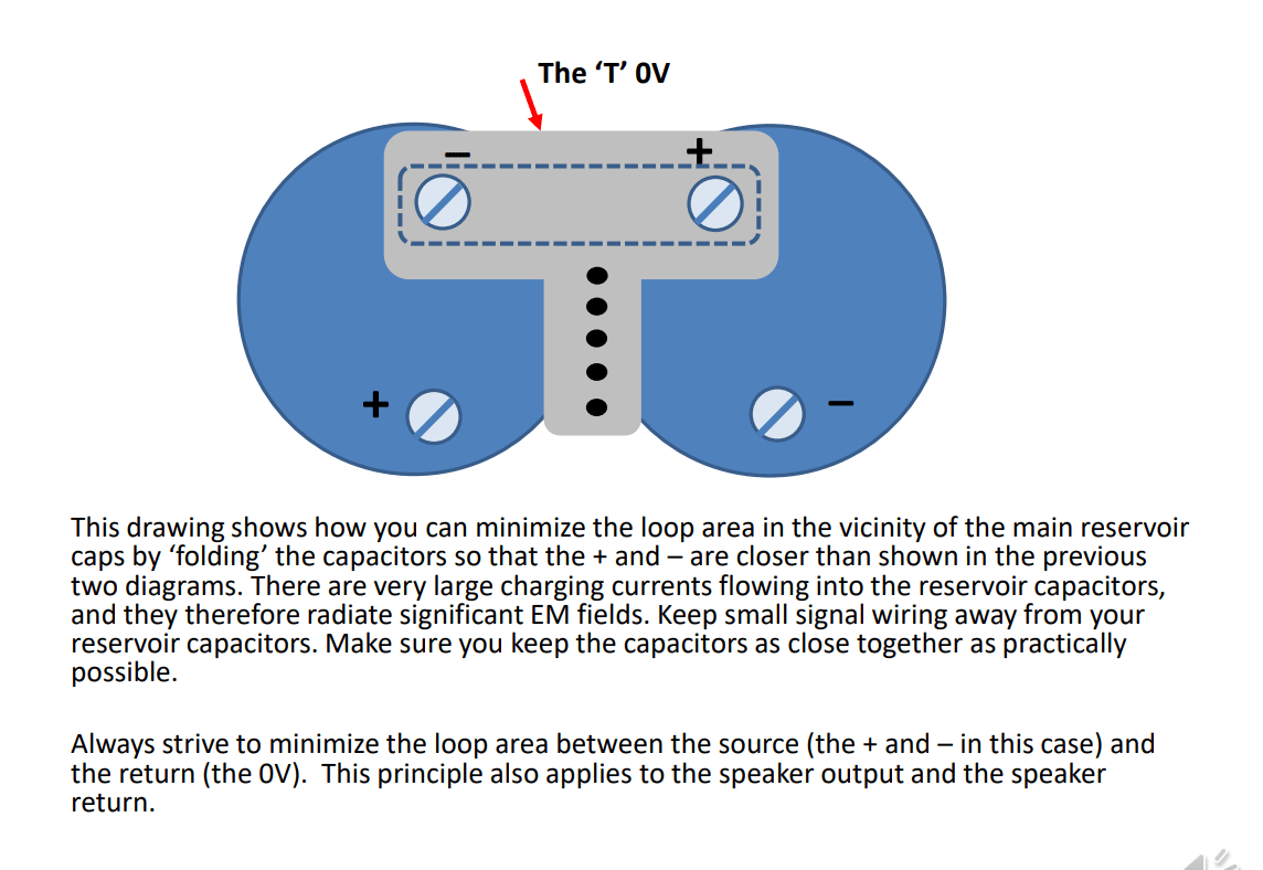

You can leave the existing power supply board as-is.
You can connect the chokes' wires for one channel to V+ and V-, add a Gnd wire and twist them together. Connect the other end of the chokes' V+ and V- to the capacitors, and connect the Gnd to the top of the Tee. The V+ and V- output wires are then connected to the capacitors and the Gnd wire is connected to the bottom of the tee. Twist the wires and route them to the amp board. Repeat for the other channel.
Note that the Tee need not be Tee shaped. The critical point is that the Gnd output is outside of the 0V region. A triangle or rectangle shape is ok.
Ground connection of bipolar supply capacitors - from Bonsai's Ground Loop article page 60:

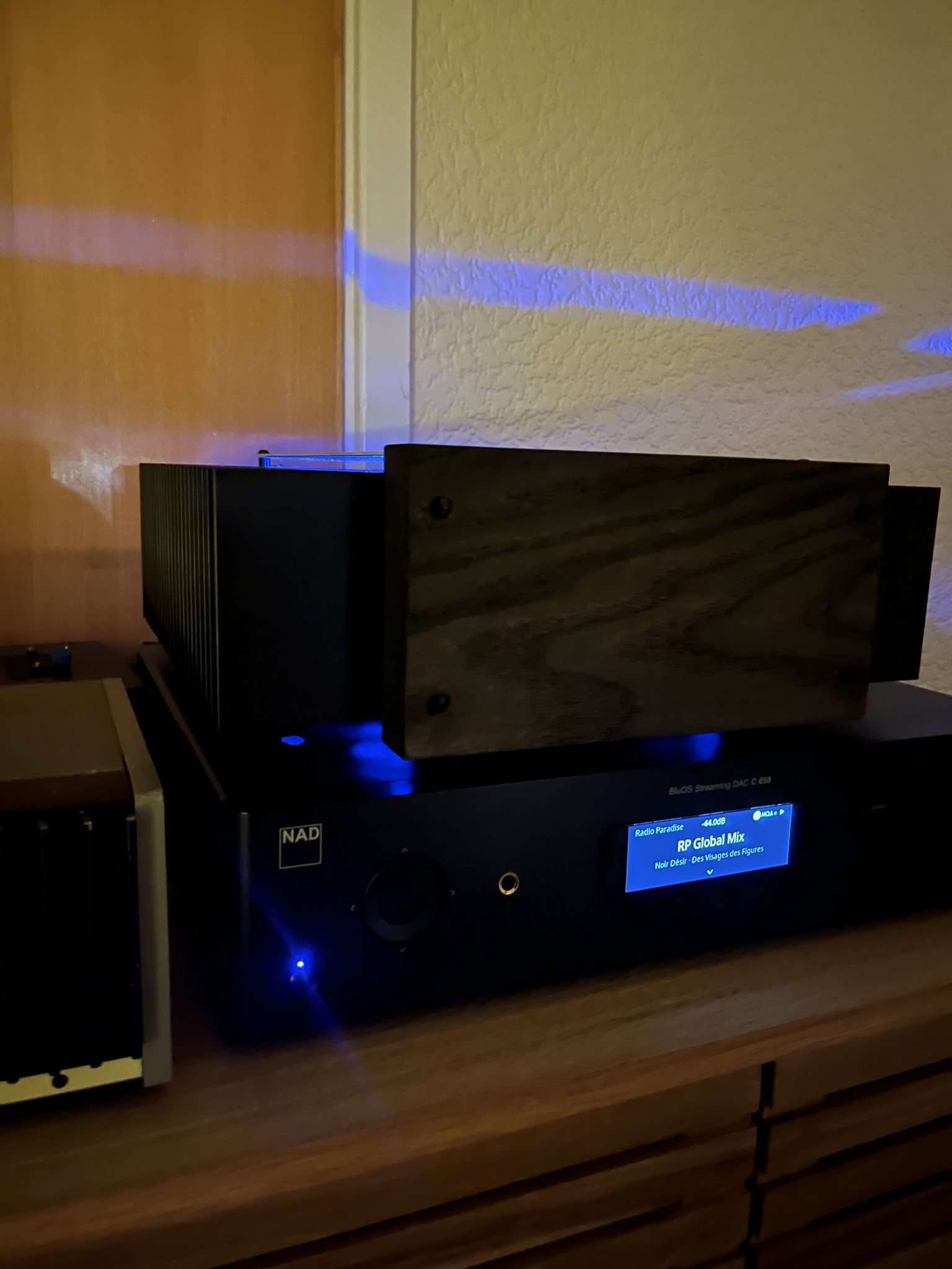

I tried a wood face plate but don’t really like it. I will try something else soon.
