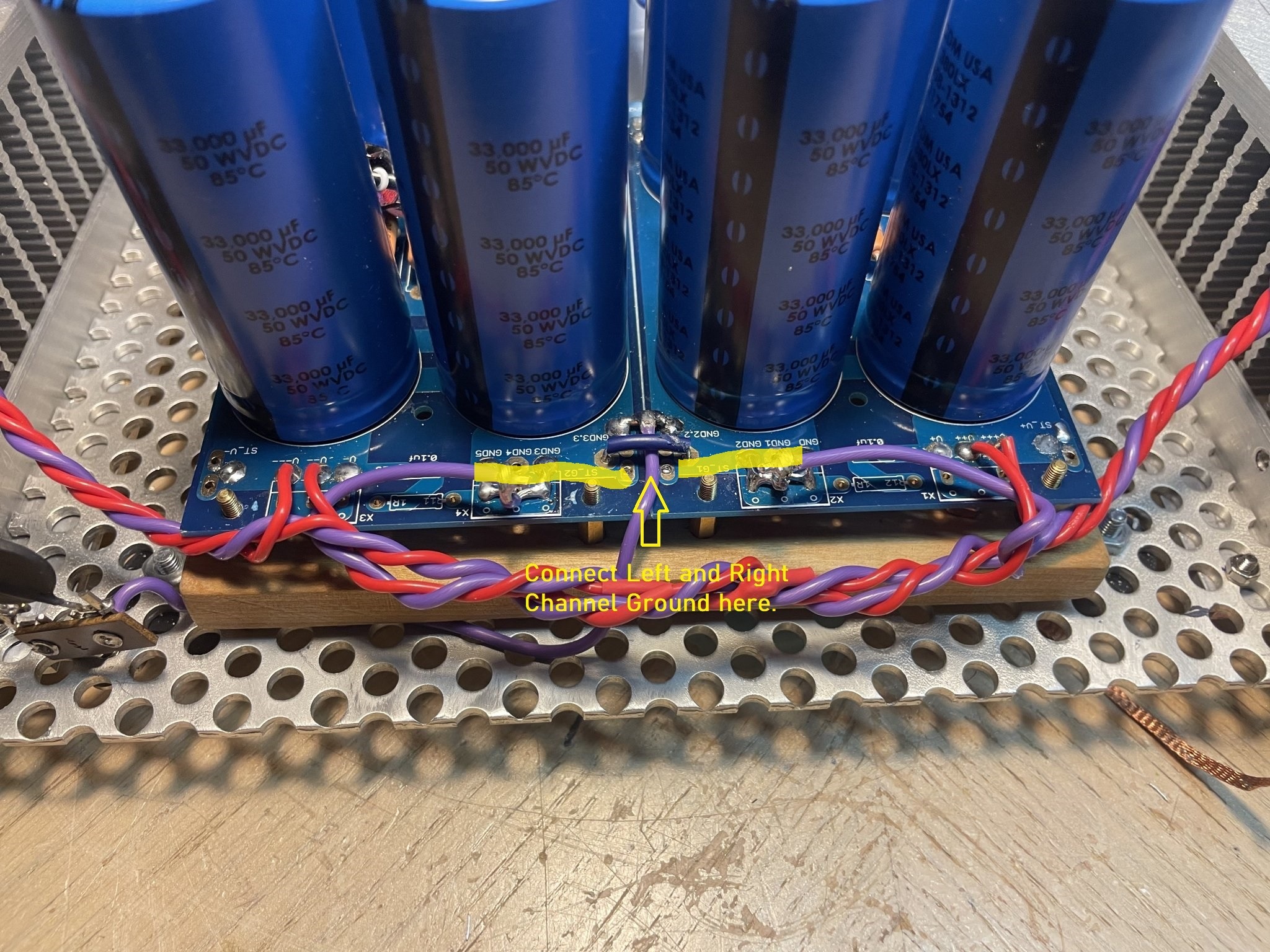

I will go through Bonsai’s tips. Here is a photo of the ground wire connections…I am not sure whether the meter's AC measurement is accurate since 1mV of ripple seems too low for a CRC power supply.
Since the power supply powers both channels, the difference in noise between the channels is most likely not caused by the power supply.
Have you tried Bonsai's Debugging Amplifier Noise tips (see post #8,768)?

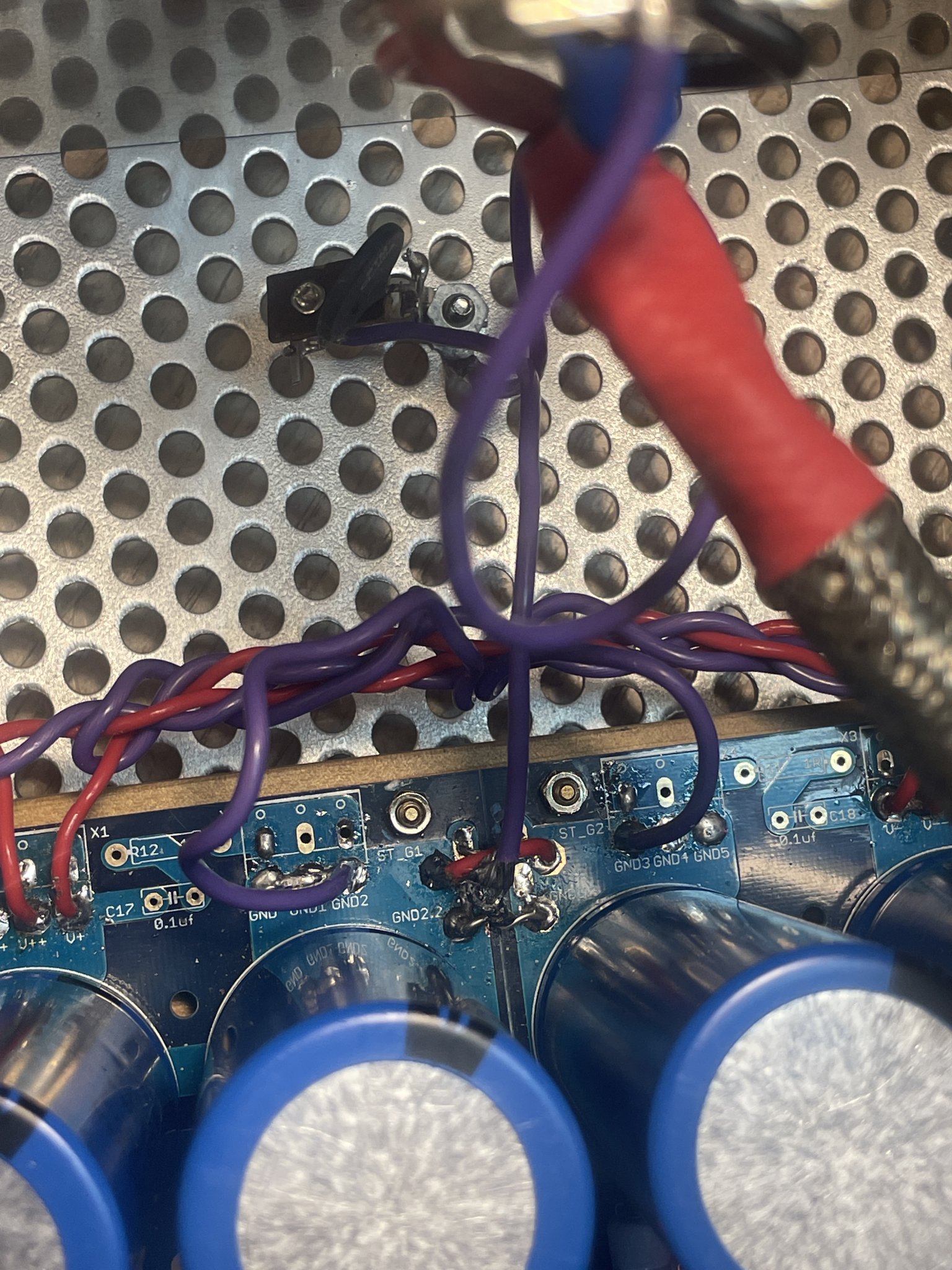

Are the left channel V+, V-, and Gnd wires connections to the power supply board made at exactly the same locations as the right channel wires?
I don’t have a true RMS meter. I do have a couple of oscilloscopes, but haven’t learned how to use them yet. It’s on the long list of things I need to learn. If only both channels were like the right channel…You can not use that multimeter to measure the ripple. The ripple is not a sinewave!
A better solution is to use a true RMS meter... the best is to invest in an oscilloscope.
It’s not easy to see in the photo, but there is a wire loop in the middle between GND2.2 and GND3.2 that I could connect all the ground wires to rather than at GND2 and GND3. My work on ground needs to be cleaned up as the wires are longer than needed just in case I need to add the additional LC. I will work through Bonsai’s material before I do anything else. I agree that if I have a good and a bad channel, the problem is unlikely to be the common power supply.This may not make a difference but it is best to connect the ground wires to the PS board at one location only.
I think there's an opportunity lurking here. You'll be able to see the ripple... and measure it as well - very accurately. You'll also be able to check for oscillations and trace the input signal as it gets amplified... which may help you identify the root cause of your problem.I don’t have a true RMS meter. I do have a couple of oscilloscopes, but haven’t learned how to use them yet. It’s on the long list of things I need to learn. If only both channels were like the right channel…
There is no doubt that you are correct, but I don't know the first thing about how to use an oscilloscope. I have two that are supposed to be fully operational, but I bought them and never tried using them. Is trouble shooting this circuit with an oscilloscope something that can be learned quickly?I think there's an opportunity lurking here. You'll be able to see the ripple... and measure it as well - very accurately. You'll also be able to check for oscillations and trace the input signal as it gets amplified... which may help you identify the root cause of your problem.

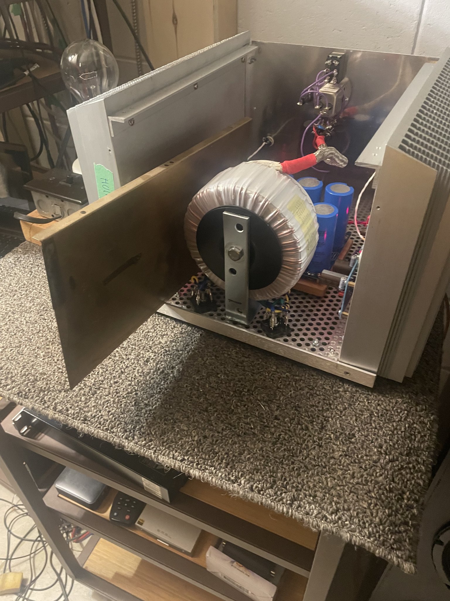

PROBLEM SOLVED!

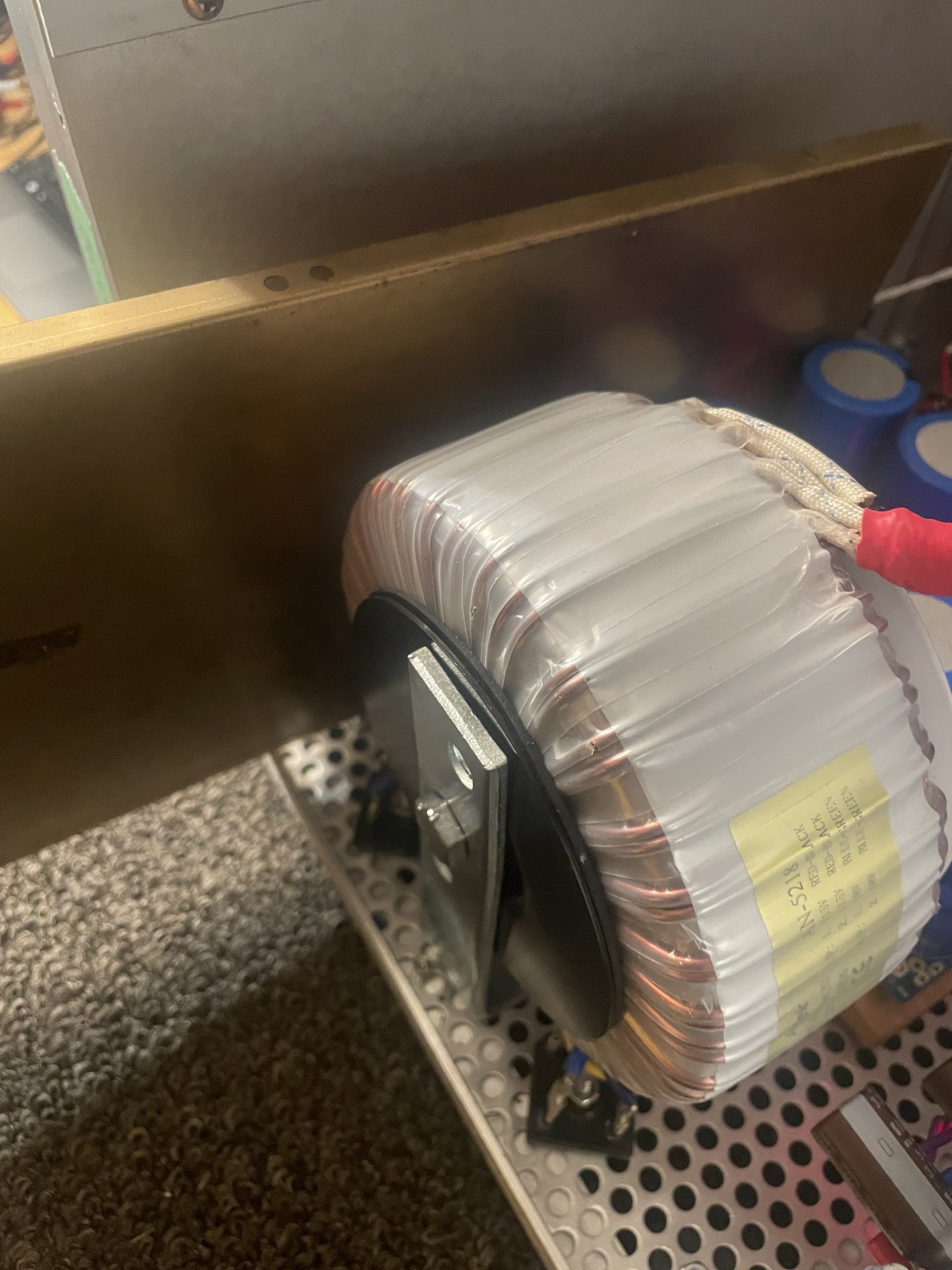

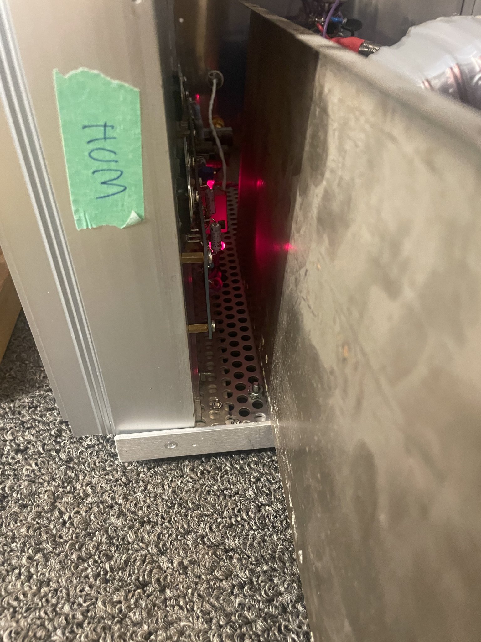

It seems that the either the transformer or the rectifiers are too close to the circuit PCBs in my amp. Placing the metal sheet between the transformer and rectifier eliminated the buzz, and made the left channel as quiet as the right one. I think that because the PCBs are not mirrored (ideally they would be), different parts of the circuit are exposed to the radiated fields of the transformer/rectifiers, and some parts of the circuit are more sensitive to this radiated energy than others. Part of the problem is that when I layed out the amp, I did so with the intention of leaving enough room on the top part of the heatsink for the 2017 Sony VFET amp that I also have a kit for. I figured I could put one power supply and two amps into one chassis since the heatsinks are so tall. This put the Aleph J PCB closer to the transformer than it would have been had I built for just one amp. My chassis is also on the narrow side.
I am going to cut the sheet in the photograph in half and install one half per side as a shield between the transformers and the PCB. Thank you all for your help troubleshooting. Hopefully, by tomorrow night I will be listening to my completed and noise free Aleph J!

Yes, I see that the non-mirrored boards are an issue here. The left channel has the signal carrying output mosfets right next to the transformer whereas the right channel has the output mosfets at the back of the case, away from the transformer.
So shielding is a solution. Another solution is to rotate the left channel board 180 degrees.

You may not need to shield the whole left channel board. Try shielding only between the transformer and output mosfets.
If you haven't done the Bonsai debugging tips, I suggest you do to confirm that there are no other issues.
If shielding of the right channel does not reduce the right channel noise further, then it is likely that a reduction of the power supply ripple is needed to further reduce the noise. The easiest way to do that is to replace the resistors in the CRC filter with two 154B per rail. Or with more work, add LC to the rails.
Rotating the left channel board 180 degrees is also an alternative to shielding if you find that shielding of the right channel does not reduce the right channel noise.
Alternatively, you can shield the transformer with a circular shield.
