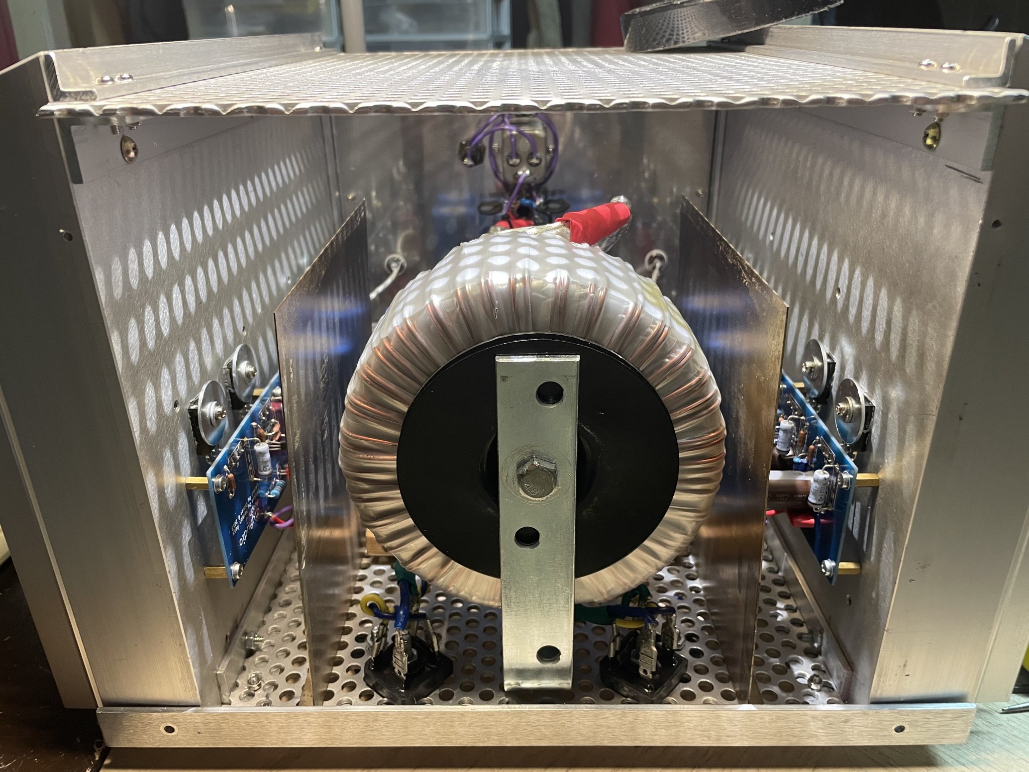

There isn’t my buzz/hum in the right channel, just a slight hiss right at the speaker. I will probably cut the metal sheet in half and put it on both sides just to appease my desire for symmetry, but I have checked, and the shield on the right side doesn’t seem to make any difference. I experimented a bit last night, and on the left side, the shield doesn’t need to cover the whole board, just the part closest to the transformer as you suggest. Rather than using a metal sheet, do you think a bag over the transformer made out this copper mesh would work? I tried a thin sheet of aluminum and it reduced the hum, but not as much as the brassy looking sheet in the photos from my previous post.You may not need to shield the whole left channel board. Try shielding only between the transformer and output mosfets.
If you haven't done the Bonsai debugging tips, I suggest you do to confirm that there are no other issues.
If shielding of the right channel does not reduce the right channel noise further, then it is likely that a reduction of the power supply ripple is needed to further reduce the noise. The easiest way to do that is to replace the resistors in the CRC filter with two 154B per rail. Or with more work, add LC to the rails.
Rotating the left channel board 180 degrees is also an alternative to shielding if you find that shielding of the right channel does not reduce the right channel noise.
Alternatively, you can shield the transformer with a circular shield.
Thanks. I checked the plate and it is magnetic.magnetic shield is usually best of material which can be magnetised
so , Al or Copper is no good
heavy steel, Mumetal, yadayada

I listened to the amp last night for several hours. It is quiet close to the speaker, with just a faint hiss and a tiny bit of hum with my ear next to the drivers. To get rid of the rest of the hum, which is definitely already acceptable, the additional LC is probably required. The amp is equally quiet with inputs shorted or with an iPhone plugged in. When I plug it into my system, which these days is mostly a PC streaming Tidal to a DAC, and then to am amplifier, there is much more hum and hiss through the speaker. The amp obviously doesn’t require a preamp, but a volume pot would be great so I can fiddle a bit with the gain structure. Seeing as how I have not committed to a front panel yet, what is the best way to add a volume control to an Aleph J? I have a few very nice Daven 100K stepped pots that I could include in the front panel, or in a separate volume control box. I think that it would help the noise level from the system if there was less signal going into the amp. On my computer’s volume control, anything above around 10 out of 100 is way too loud. My preference would be to lock the volume on full with the PC and use a pot to control what the amp gets.
