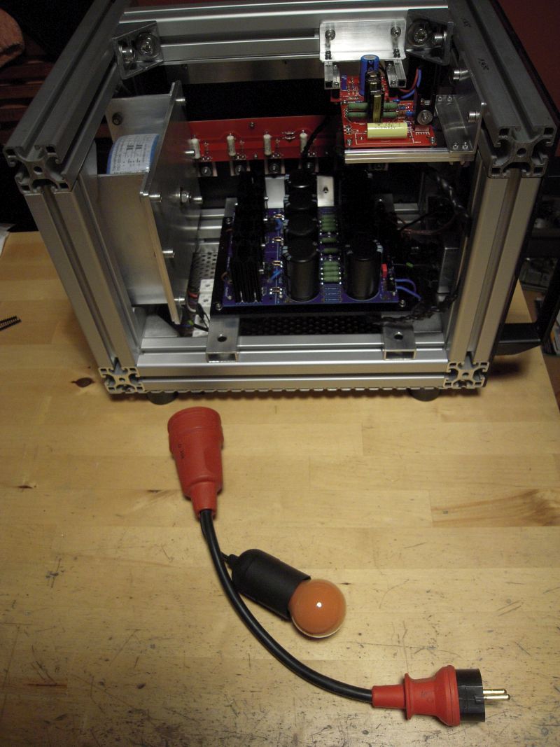

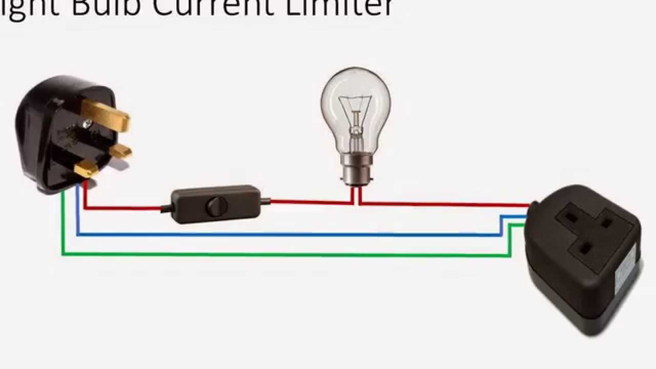

Hello joppepoppo,
if you don't have a variac - as andynor suggested - it is good to have a simple
dim-bulb-tester for first startup or after a repair. No :redhot:, please!
Cheers
Dirk 😀

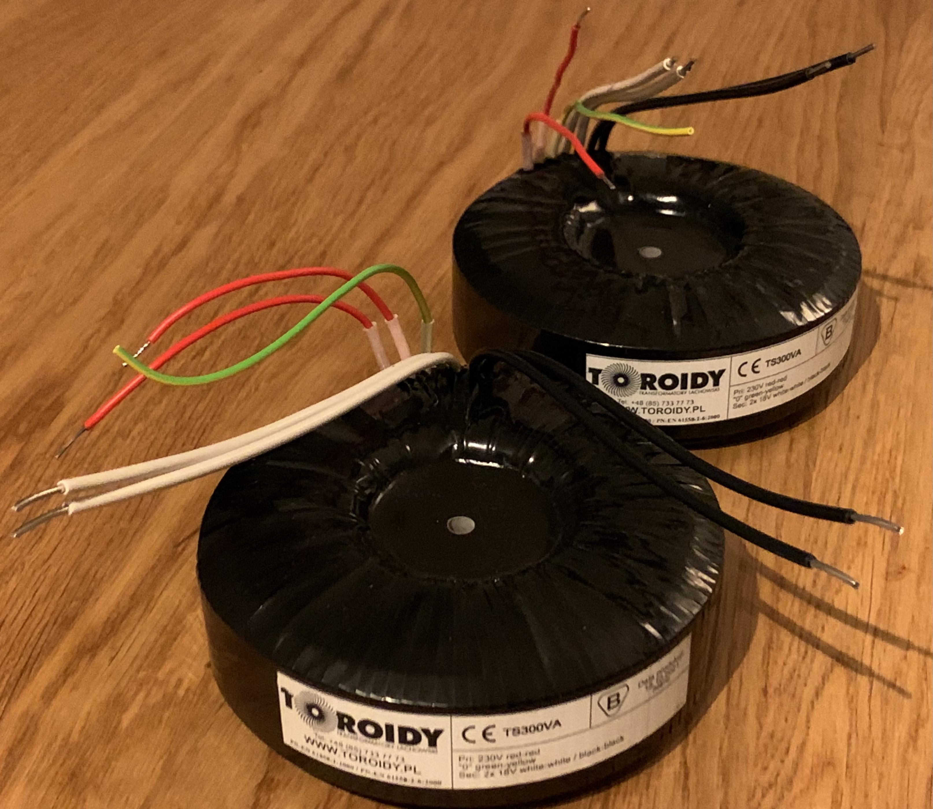

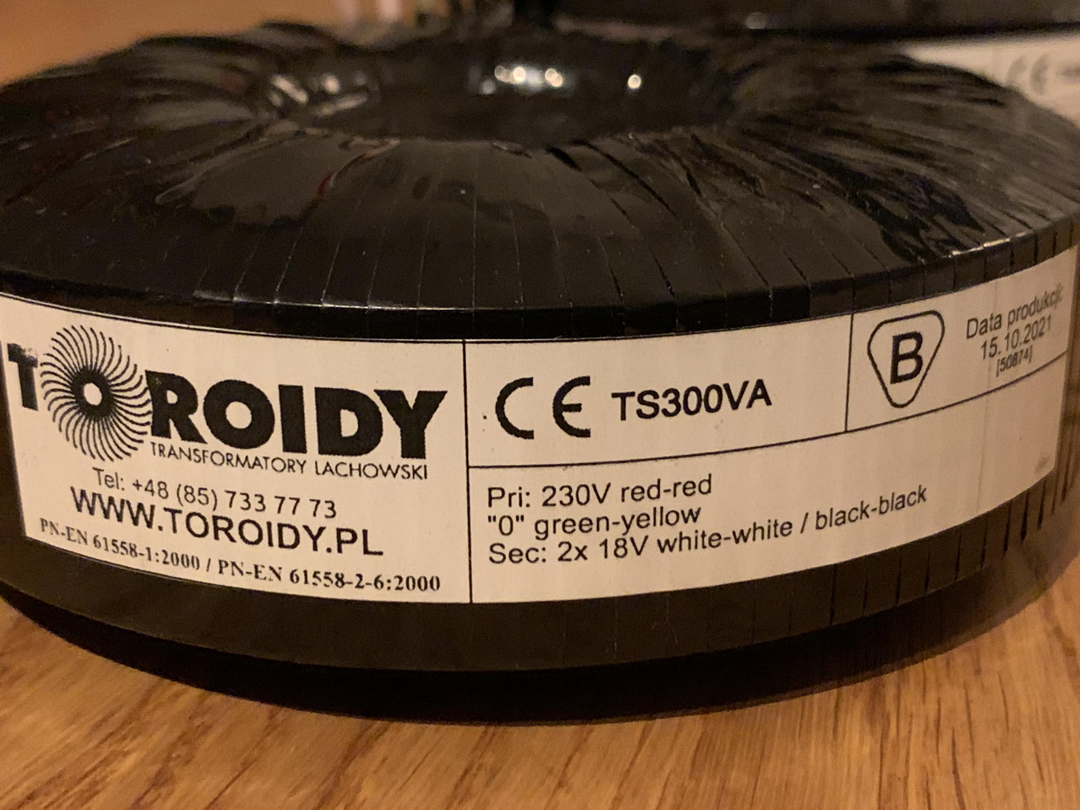

What is the green and yellow connected to inside the transformer? To some shielding or to the core? Center tap???
We have got 230V here in Sweden.
Should i connect green/yellow to the safety ground in the Aleph chassie?
