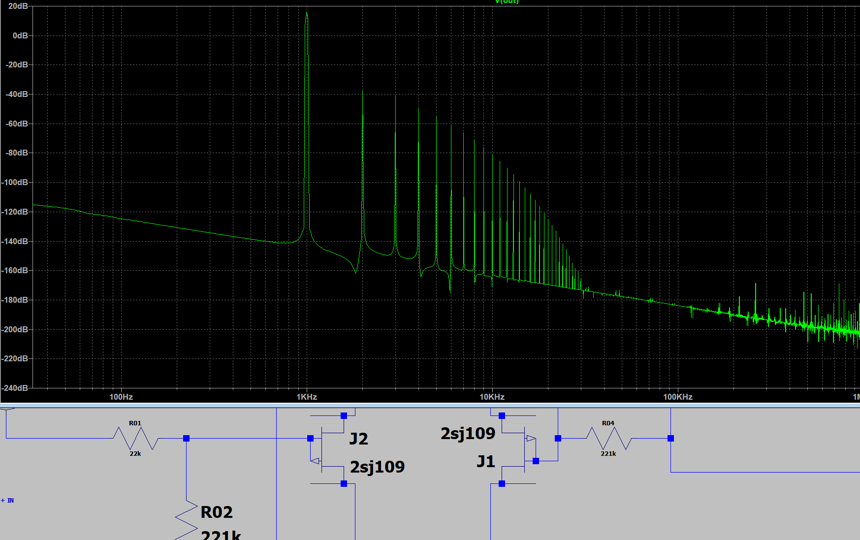

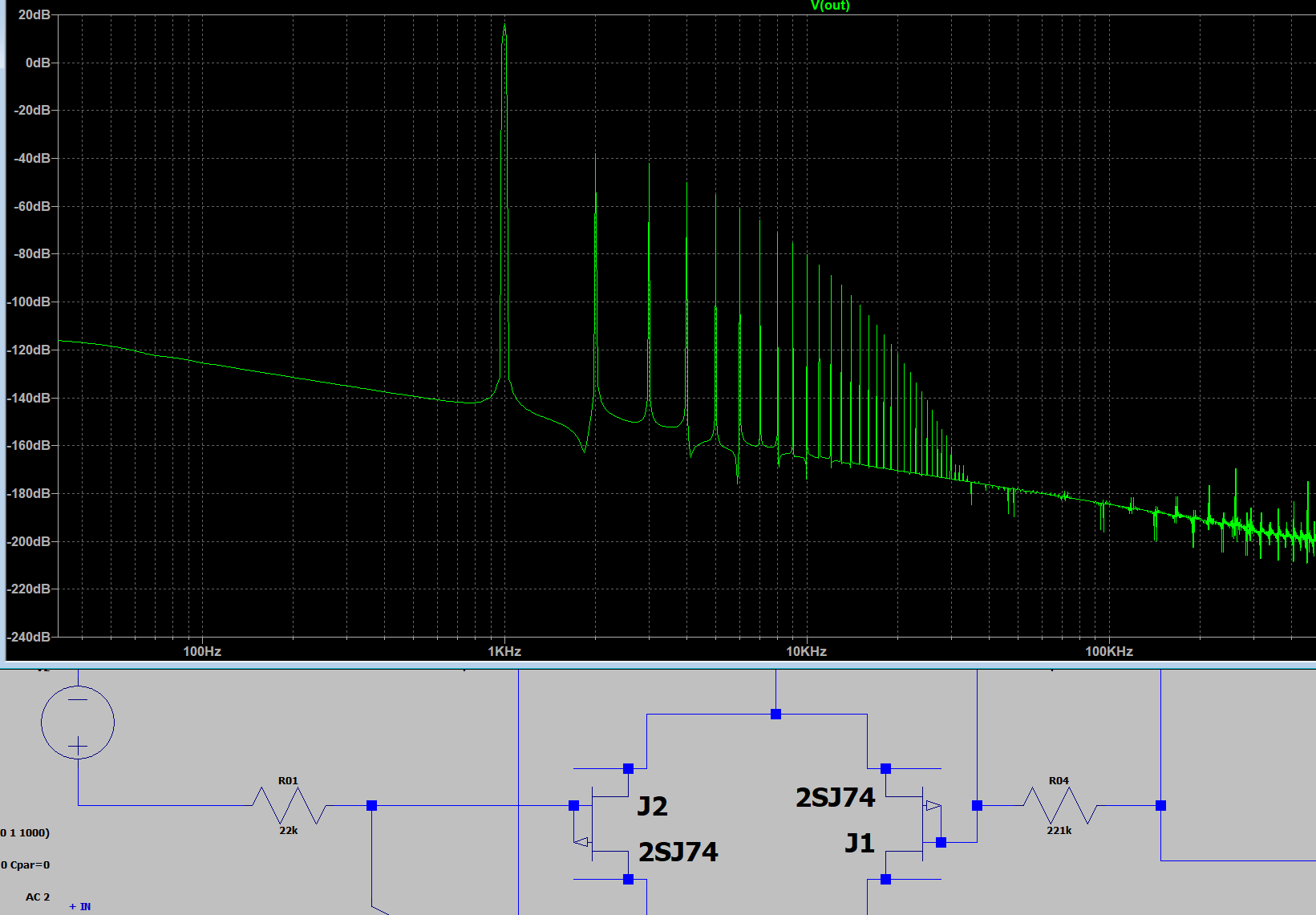

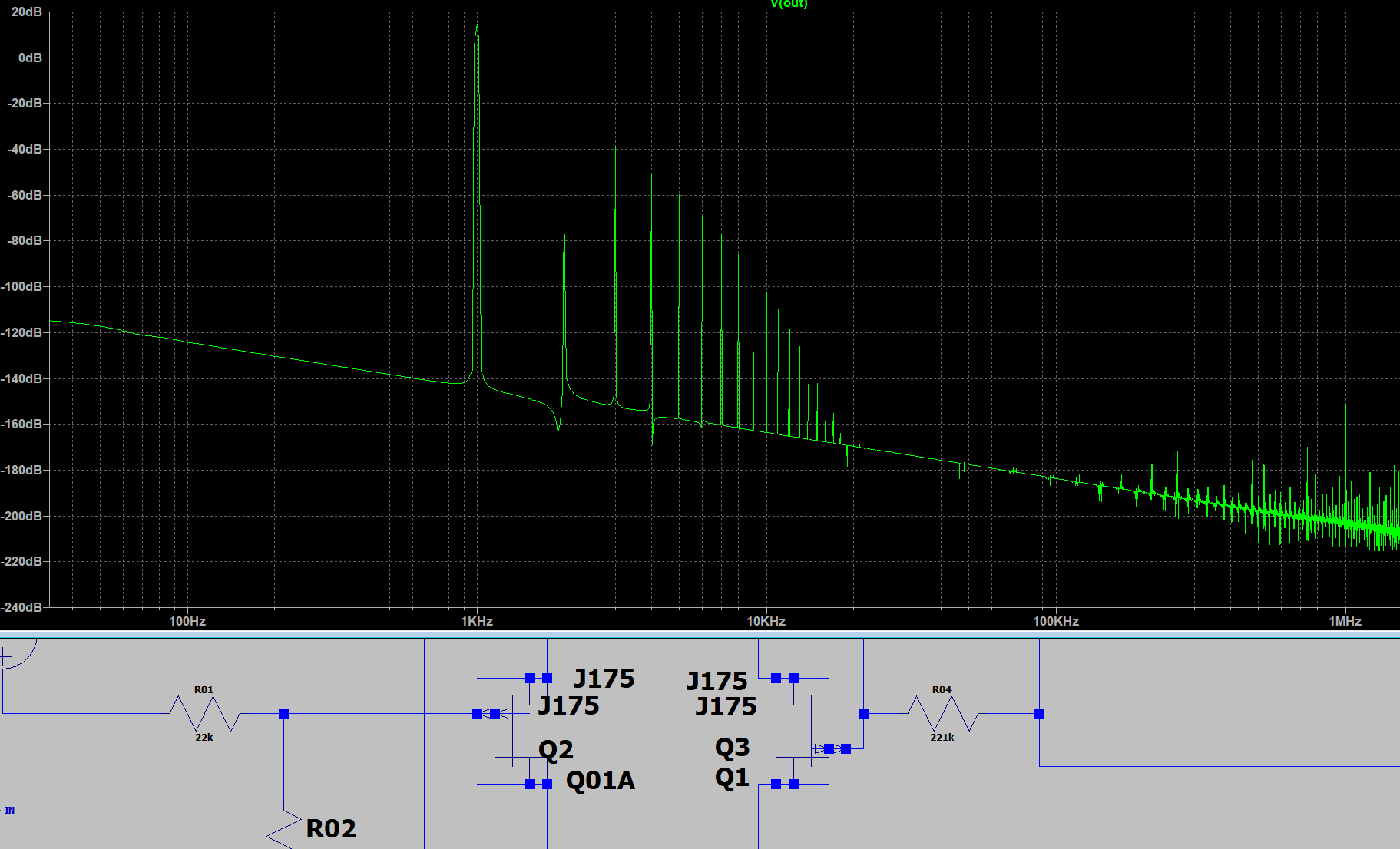

j175
It was probably beaten to death, but what about j175 for input stage?
It is not biased by Idss, so i am not worried about it.
Did some spicing in ltspice, but pretty sure j175 model must be broken, it gives too low H2 for paralleled 175's..
I know this is not discovery of warm water or anything, and worse than Toshiba parts for sure, but how much worse can it really be for a junkbox build? Maybe j176 or 177 would be better, but 175 is what i have on hand..
Why is p-channel jfet world so dead in 2021? Born too late to explore the world, too early to explore the stars, but just the right time to watch pch jfets dissapear.
Put the images and sim file in attachments
Cheers

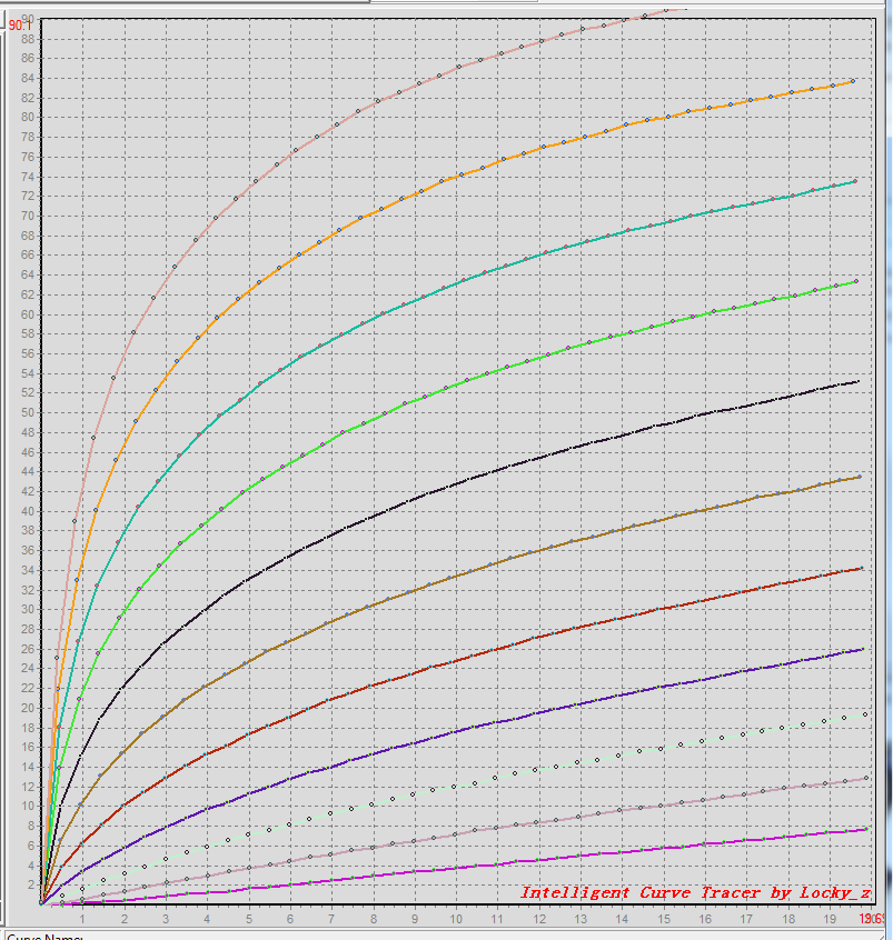

J105 is a pretty crappy amplification transistor, and a wonderfully excellent analog switch.
Here's an Ids versus Vds plot of data I measured from a J105 using a curve tracer. Bleah.
Forum thread: Measured data on the J105 Nchannel JFET
