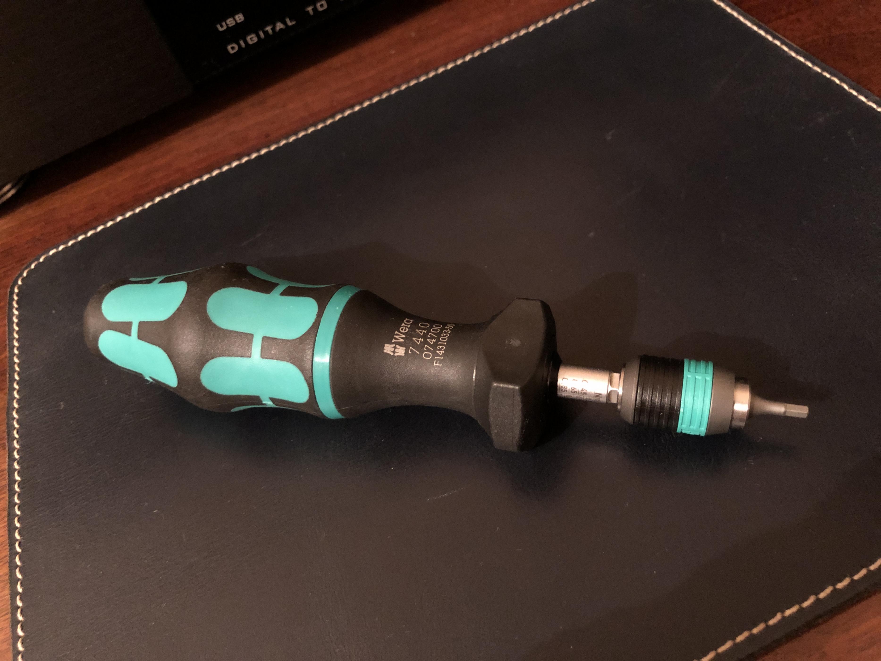

Took care with torque wrench during mosfet assembly, @ 0N85.
Andy
By the way the tool I wrote about ~64 pages earlier.
It have 0.05 Nm steps like 0.85 Nm, 0.9 Nm, 0.95 Nm and so on.
Bits fixation is so neat and all mechanisms work so smooth.
The feel in the hand is so pleasant. Not cheap not luxury, just right.

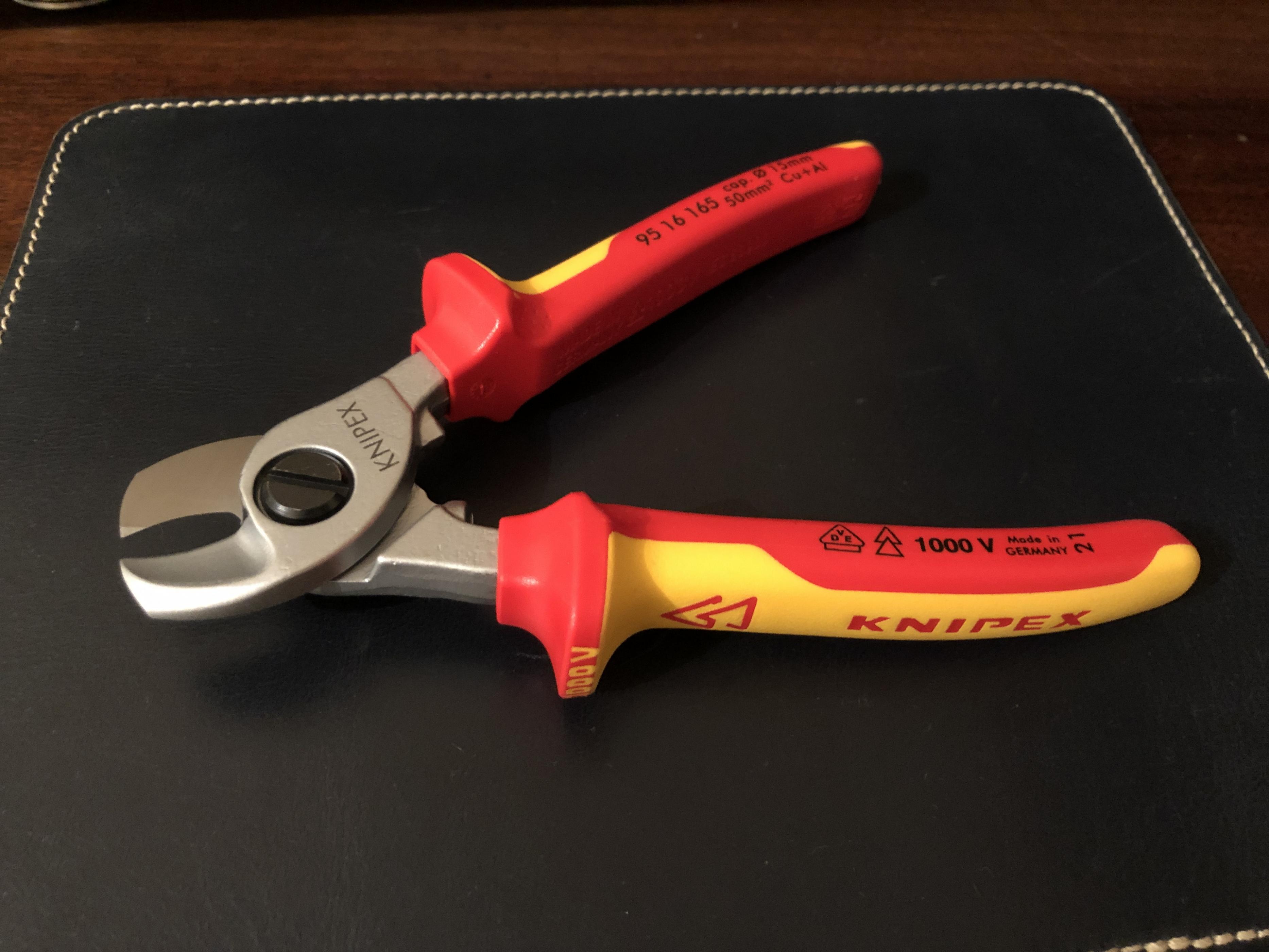

Another tool I also bought is Knipex cable cutter.
Unnecessary. But there was a good discount so I could not resist.. :D
It cuts the cable like a butter.
This tool is also meant to cut only copper or aluminum conductors.
Steel will damage cutting edges.
Amazing feel just to hold it in my hand. So smooooooth. :)
