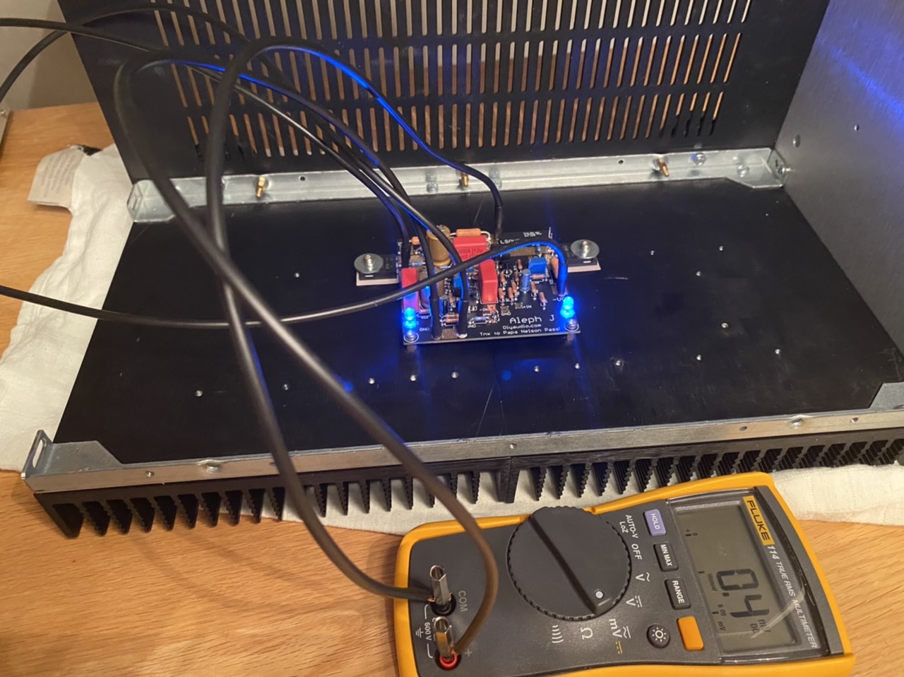

Hi all,
I had a mishapp when stuffing the boards. I changed places on one of the ztx450 transistors and the 550 transistor. Im now a bit concerned I might have over heated them when un- and re-souldering them to the boards. I havent powered up the boards yet but when I do, is there something I should look out for ( except the obvious flashes and smoke 😉) to tell if these devices have been damaged in any way? Or better yet, is there a way for me to determine this before putting power to the boards?

have universal tester, or Hfe function on DMM?
if no, test them with diode test

Yes, thanks for the tip. I used the dioder tester but since ( i suspect) the transistors are souldered in place i dont get the expected voltage drop. However both the npns measure the same and so do the pnps. I have spares but if avoidable id like to keep them as spares ��
Sounds good. Have variac? If so, good to use. If not, just switch on and quite wuickly off the first time, in case somethings off.
Monitoring source resistors is a good idea. Ensuring low or no IQ at first power on may be a good idea, at least on problem chan.
