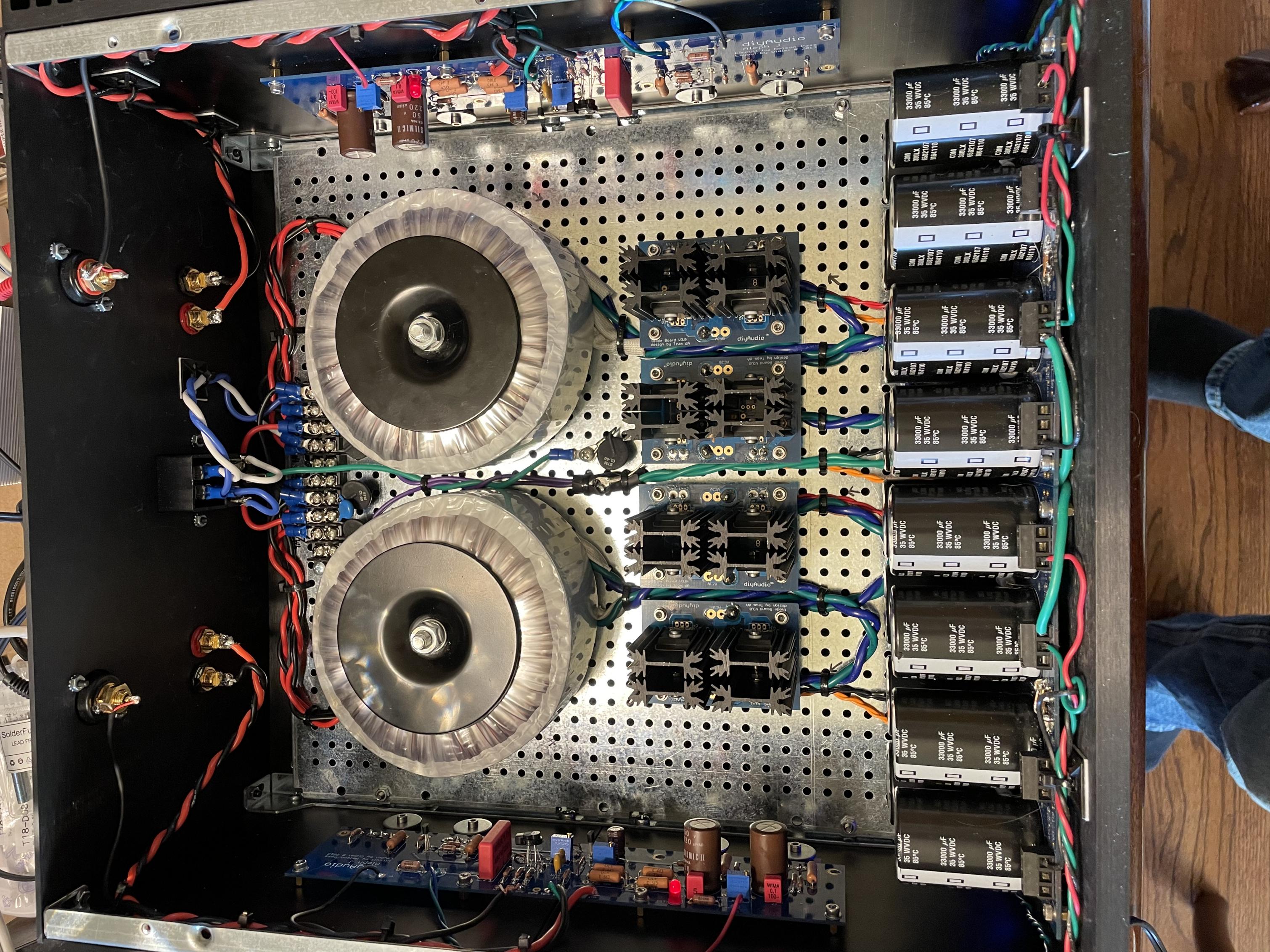

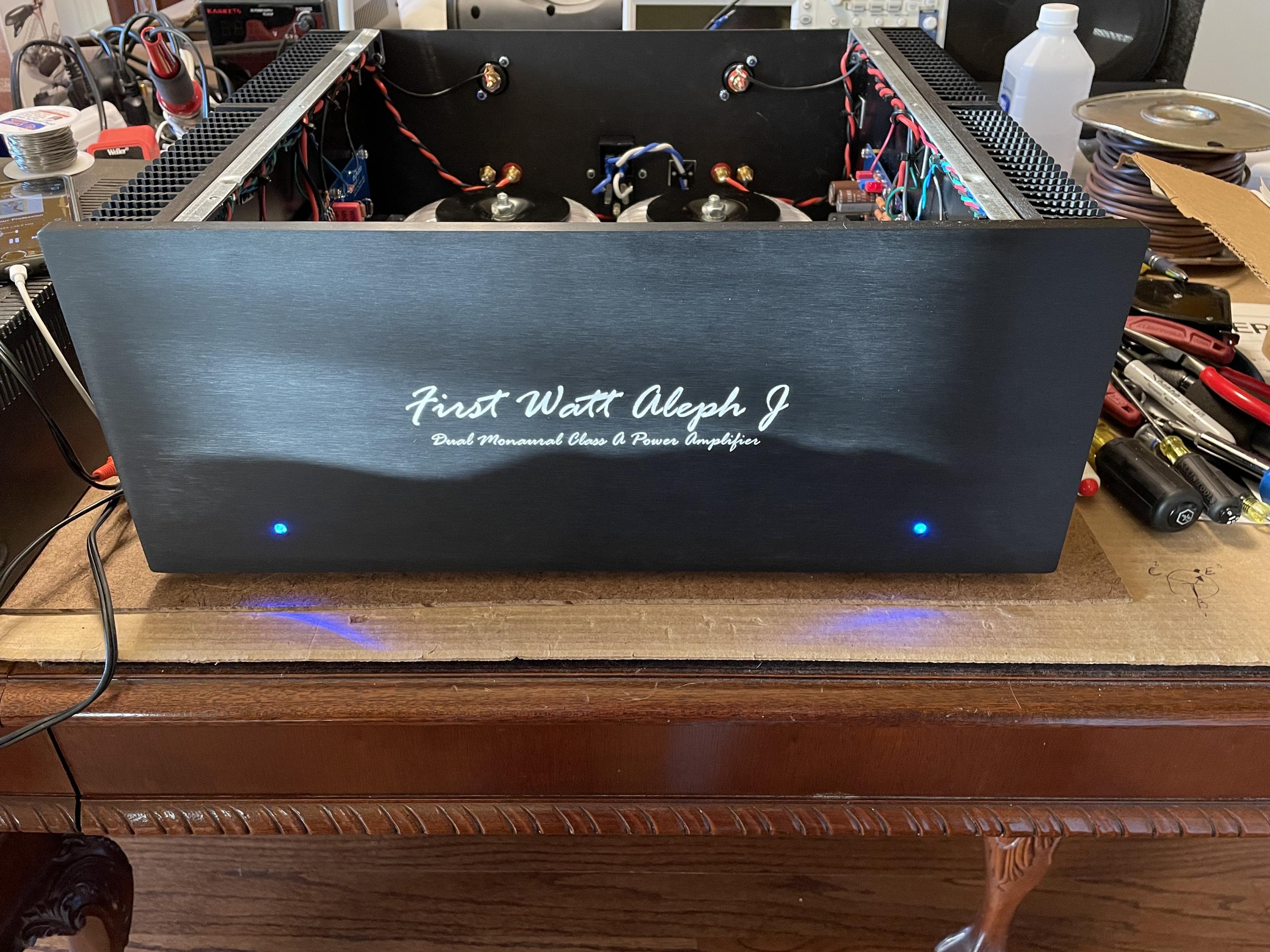

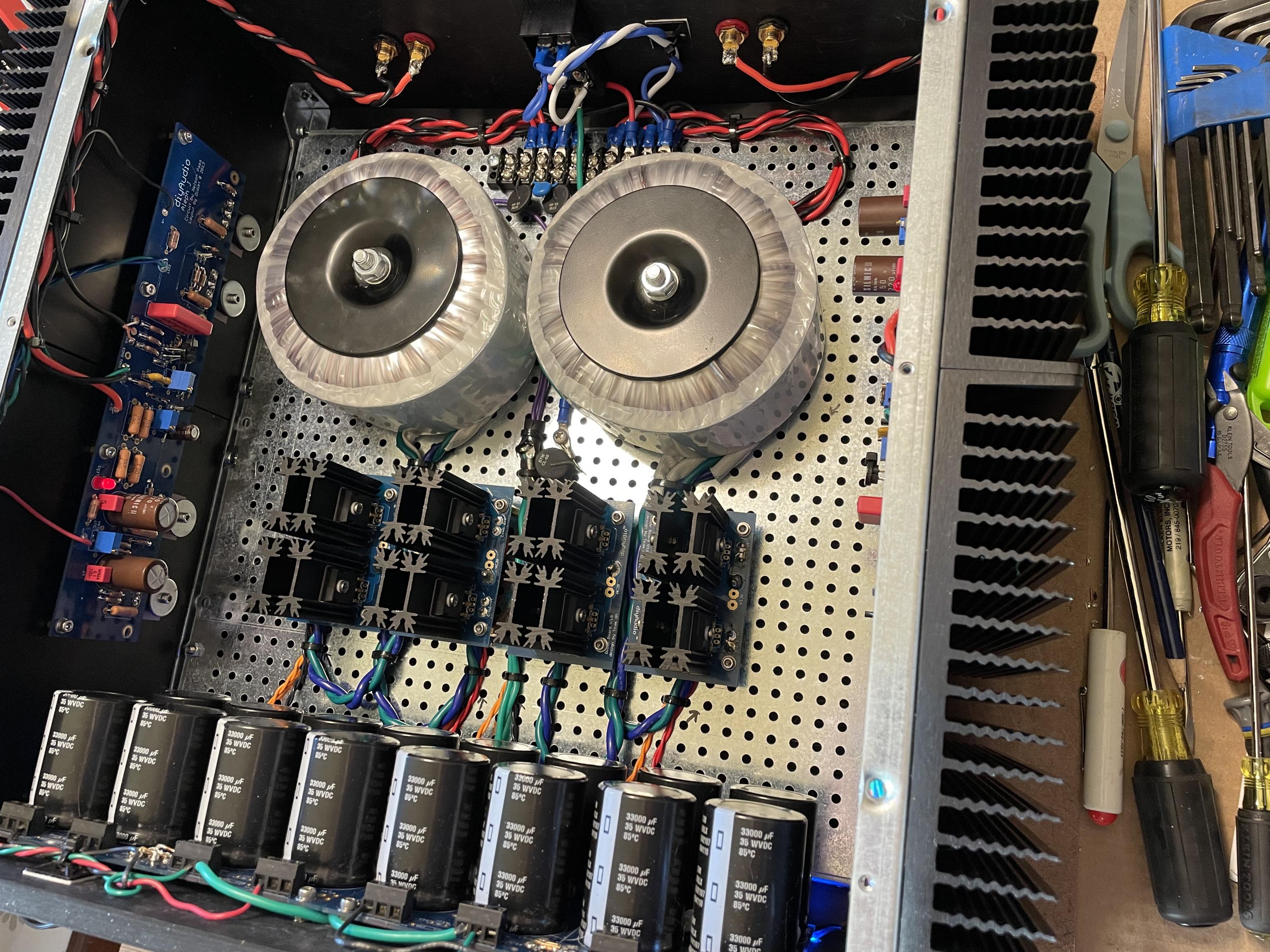

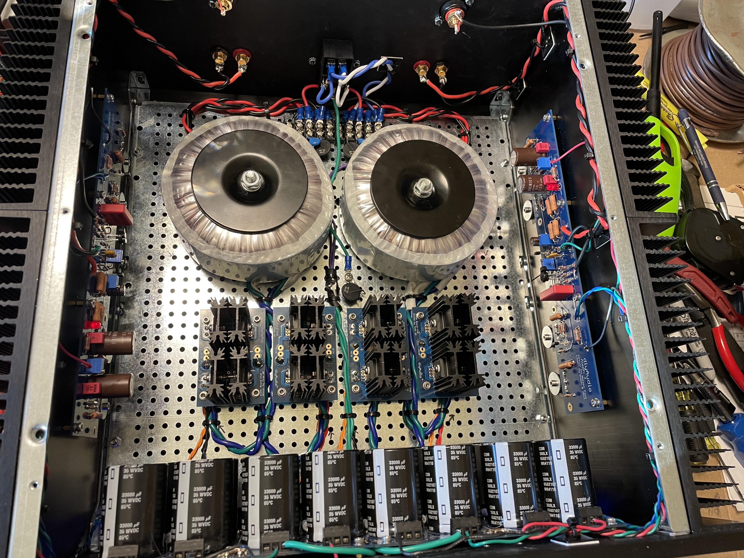

SUCCESS!! I’ve just completed my Aleph J monoblock build. It’s operating silent and sounds great this far on my test speakers. Thank you to all who contributed with their expertise. Please feel free to critique what I’ve done so I can grow going forward on perhaps this build our future builds. The only I know I should’ve done differently is used smaller VA transformers instead of the 400VA are in this amp. I will do that in the future because this thing weighs a ton.
I have questions about R8 TP bias. I have a pot 25 turn pot installed there in its mid position. What is this pot used for or TP bias? I was searching through the many pages of this thread but can’t seem to come up with anything yet. Anyone please? Thanks in advance

Post #1 from the esteemed Mr. 6L6 human gift to Greedy Boyz, should enlighten that question. Seen in conjunction with schematic.
