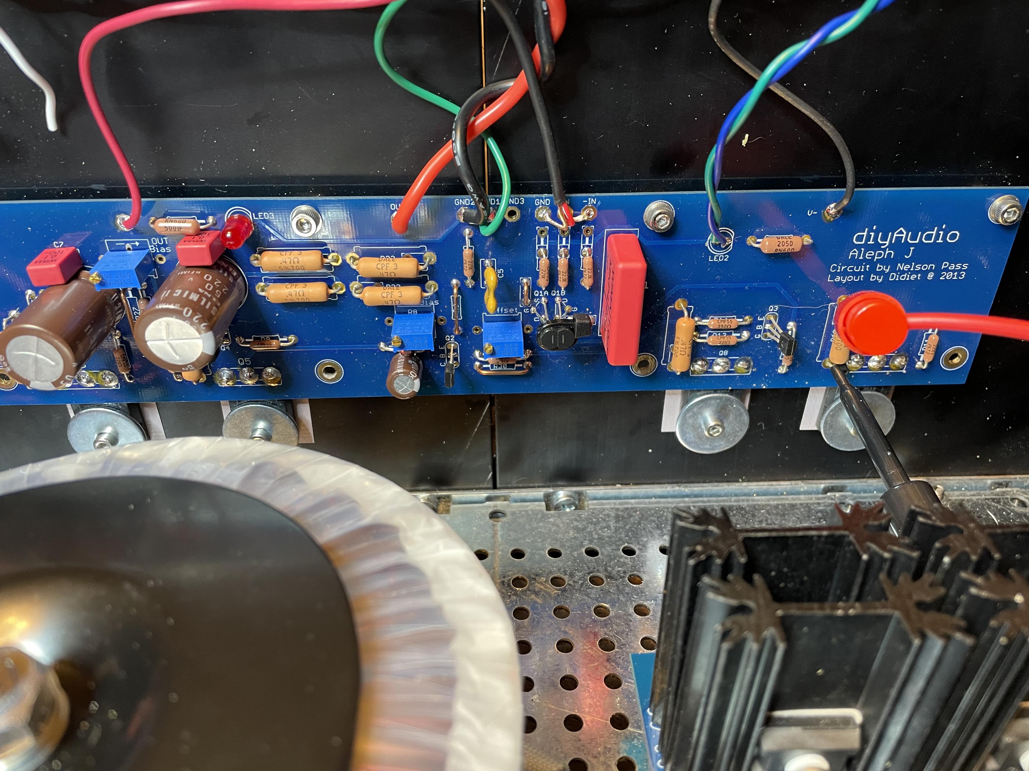

Hi Gang, as 6l6 caught the other night, I reversed both of the zener diodes and on the right channel, rather than removing resistors R1,R2 & R3, for now I soldered jumpers in to populate those resistors to the top terminals of the board. I’m going to replace those resistors with new but I didn’t have any on hand, so I ordered more. Anyways, the left channel is biasing perfectly and the offset is also adjusting beautifully. The right channel is a different story. Using my variac and dialing up slowly with my meter on the far right resister, when I start getting around 50/60 volts, the bias is skyrocketing well over 400-450mv. I’ve tried dialing the bias pot down with no affect. Both pots were set to the half way position prior to soldering them into the board. Can someone point me in a direction? I’m at work and wanted to get this out to the group this way perhaps tonight when I get home I can take a look. With that being said, I have attached the same pic from the other night. The zeners will be pictured backwards and the resistors not populated but they have both been changed.

Andy, maybe. I’ll know more tonight when I get home from work. I found a little snippet piece of a wire across the center and end terminal of the bias pot. I removed it and I lowered the pot down to get to 350mv. I shut it down and got the sack. I will know more this weekend for sure. Thanks again because having the board of a few different times I never noticed this. But after I removed it, it seems to be working but I don’t want to rule out a possibly defective pot. Joe
