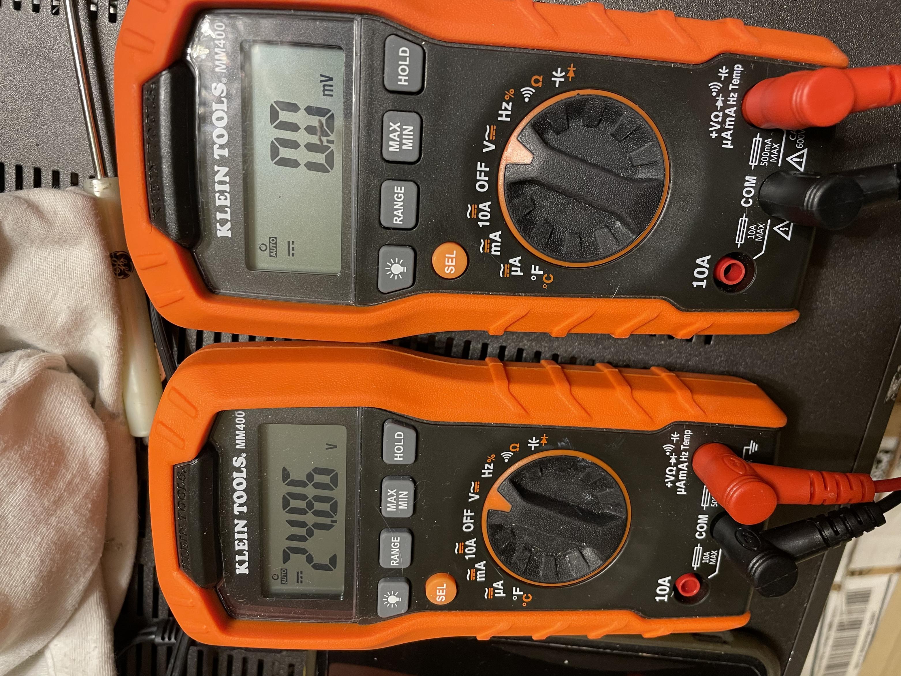

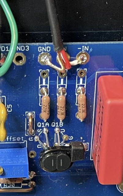

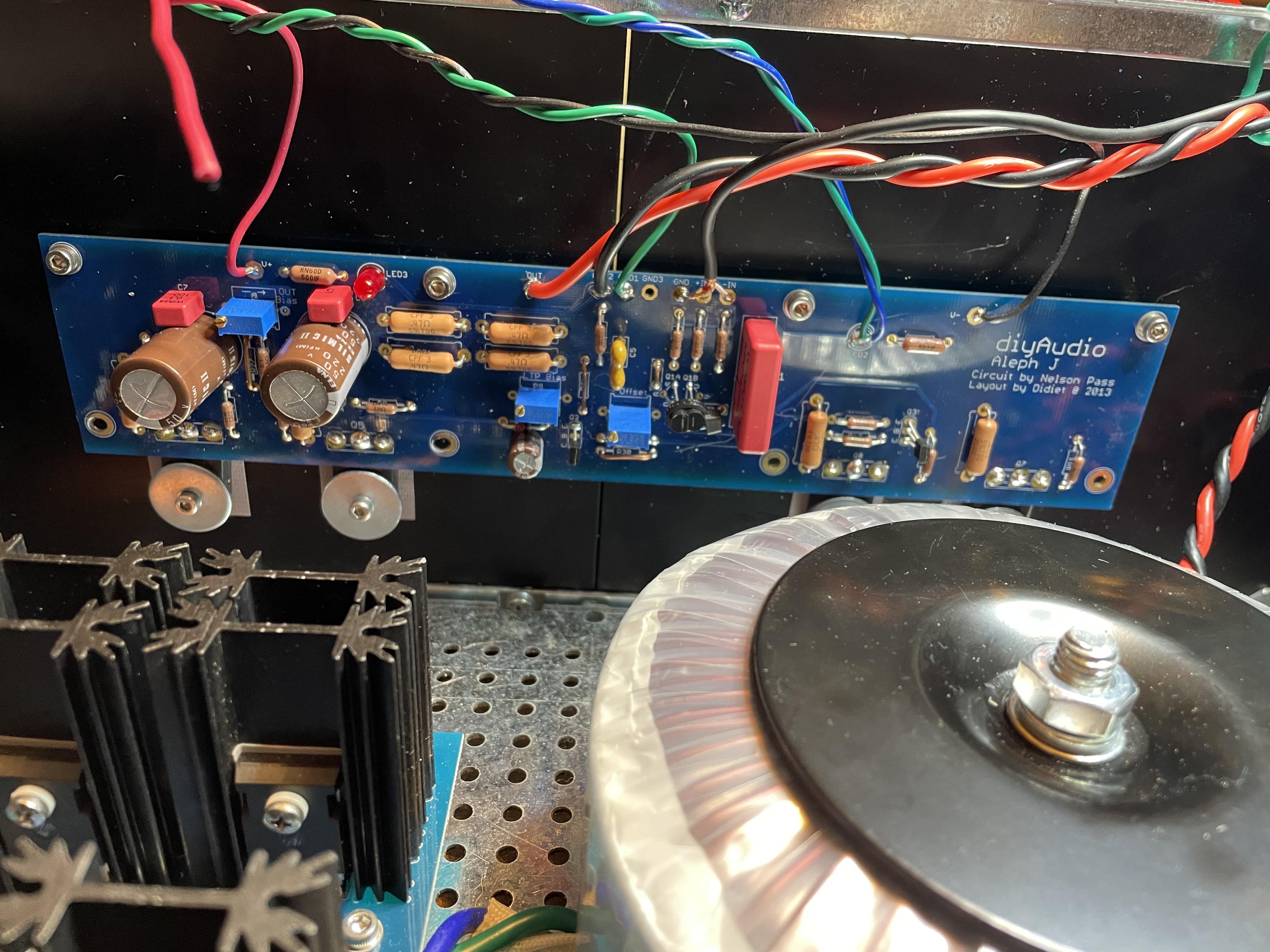

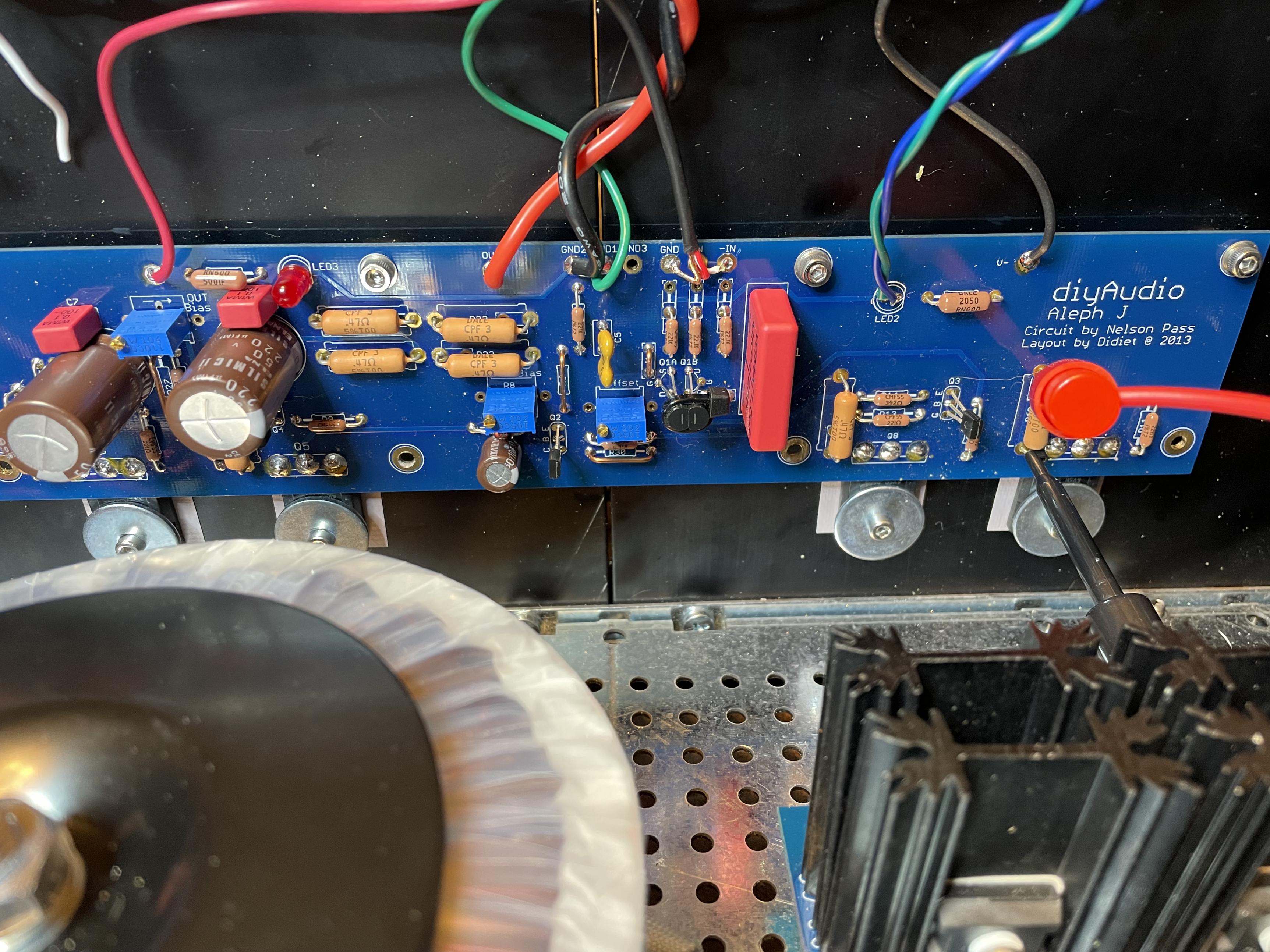

Hi Guys, can someone take a look at the pics below. I am in the process of building an Aleph J. The power supplies are good measuring +25/-25vdc. I have the same voltage to both channels boards. I am trying to set bias and offset. My bias is 0mv and my dc offset measures 25vdc. See pics. No matter which way I turn the bias pot, I get no bias at all. The dc offset pot varies the 25vdc slightly up or down a volt or so. I have the same situation identically on both channels so it’s obvious I have made the same mistake, but I’m not seeing it. Can someone please throw an eyeball on the pics for me and let me know your thoughts. Thank you in advance.

The zeners are in backwards.
Once you have that sorted, this channel isn’t going to make any sound as the resistors must be attached to the topmost pads.

Well spotted!
Just shows how important it is to check everything... the parts' values, the tracks on the PCB (as I did just now on my spare Aleph J PCB), transistors... and of course, what seems to be the latest requirement these days on this forum - the ancestry DNA / the family-tree 🙂
