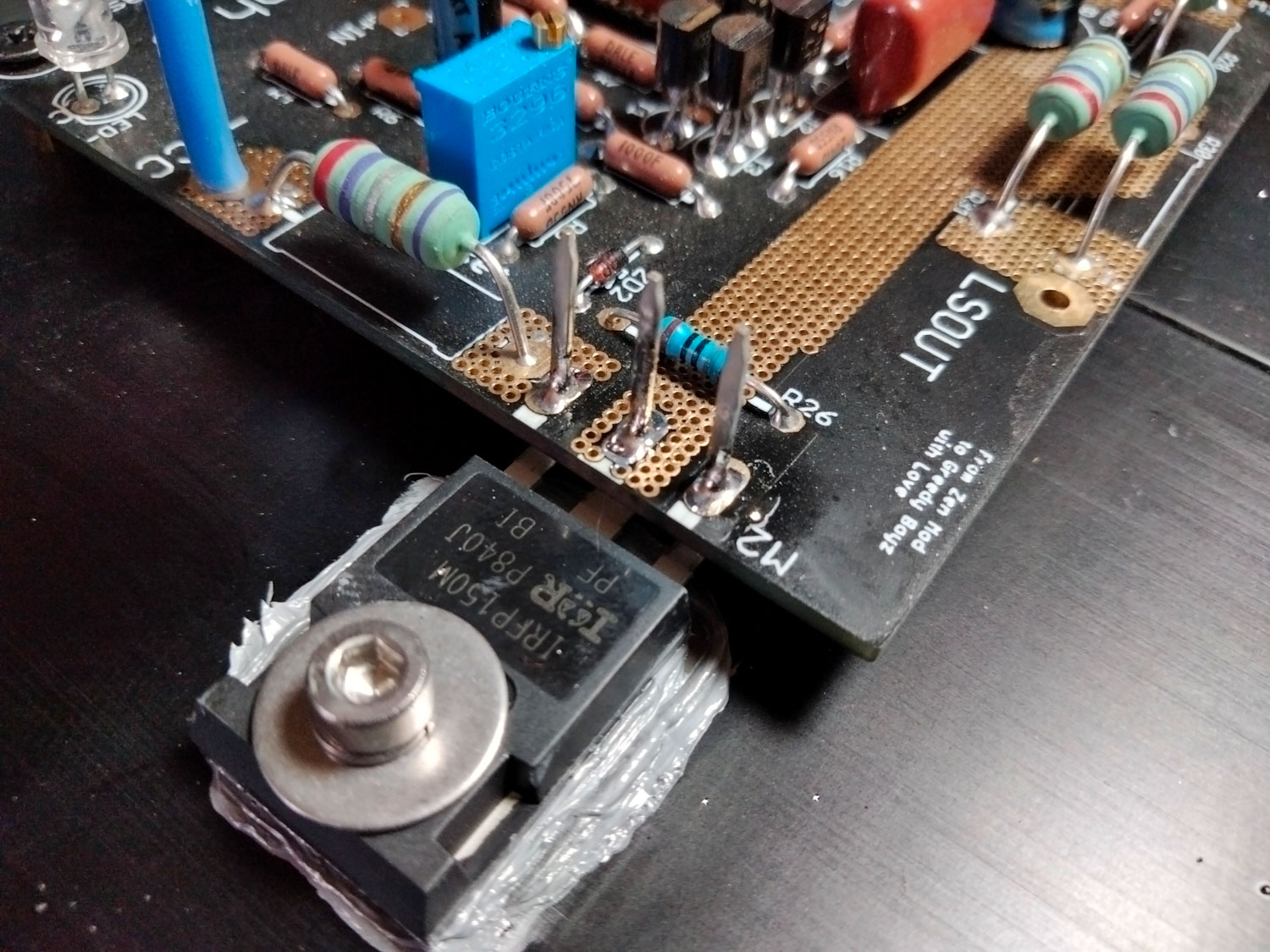

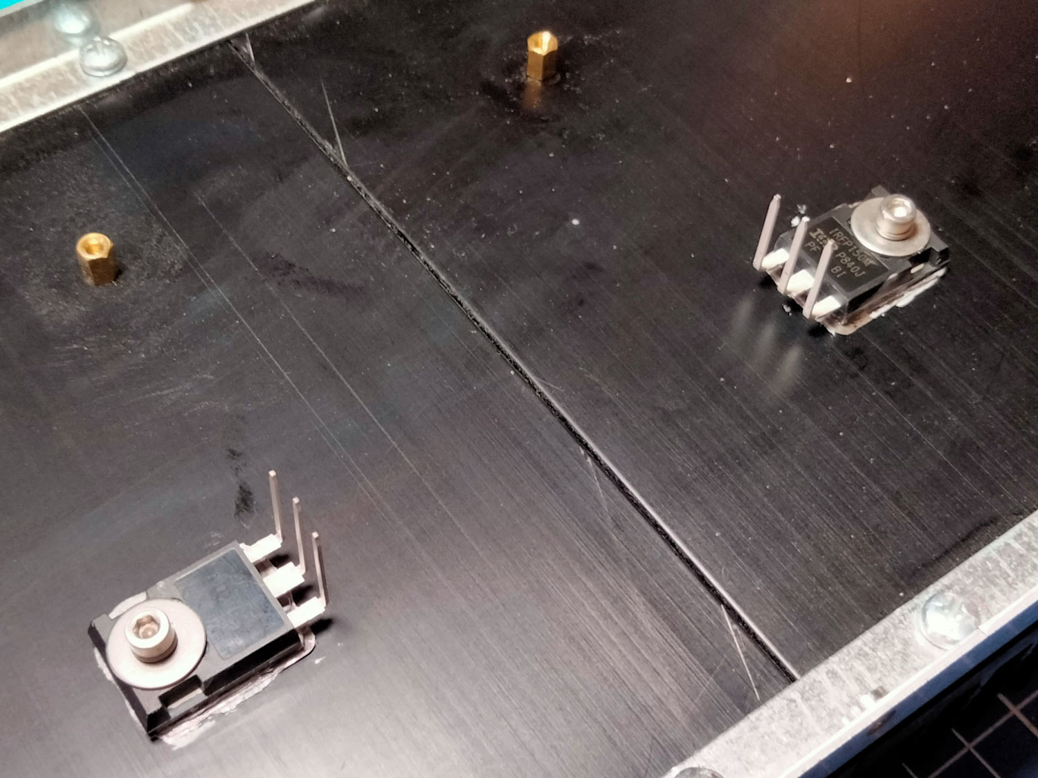

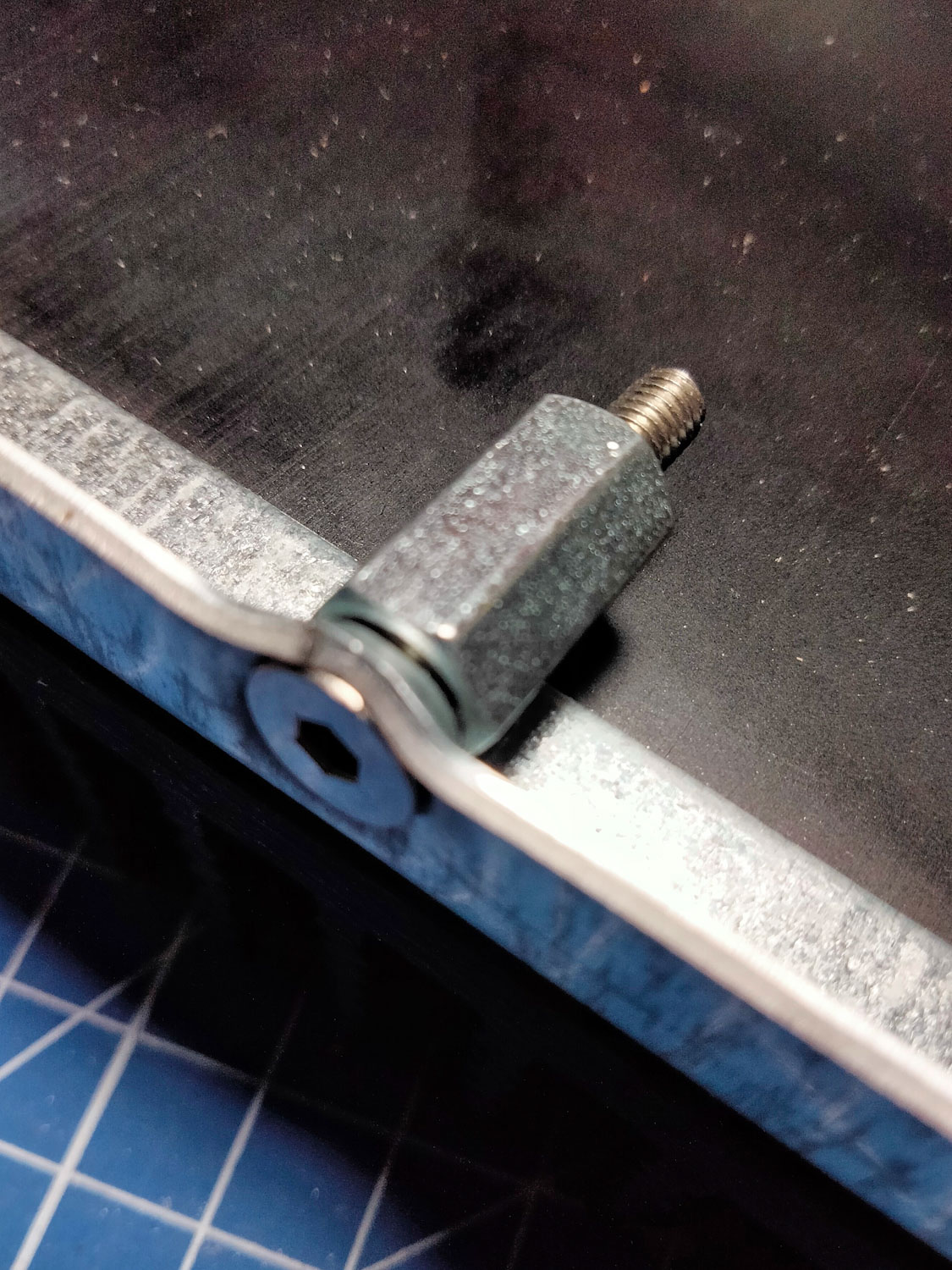

I found that M5 15mm double nut that seems perfect for the purpose (here with 25mm M4 screw)
Let's start!

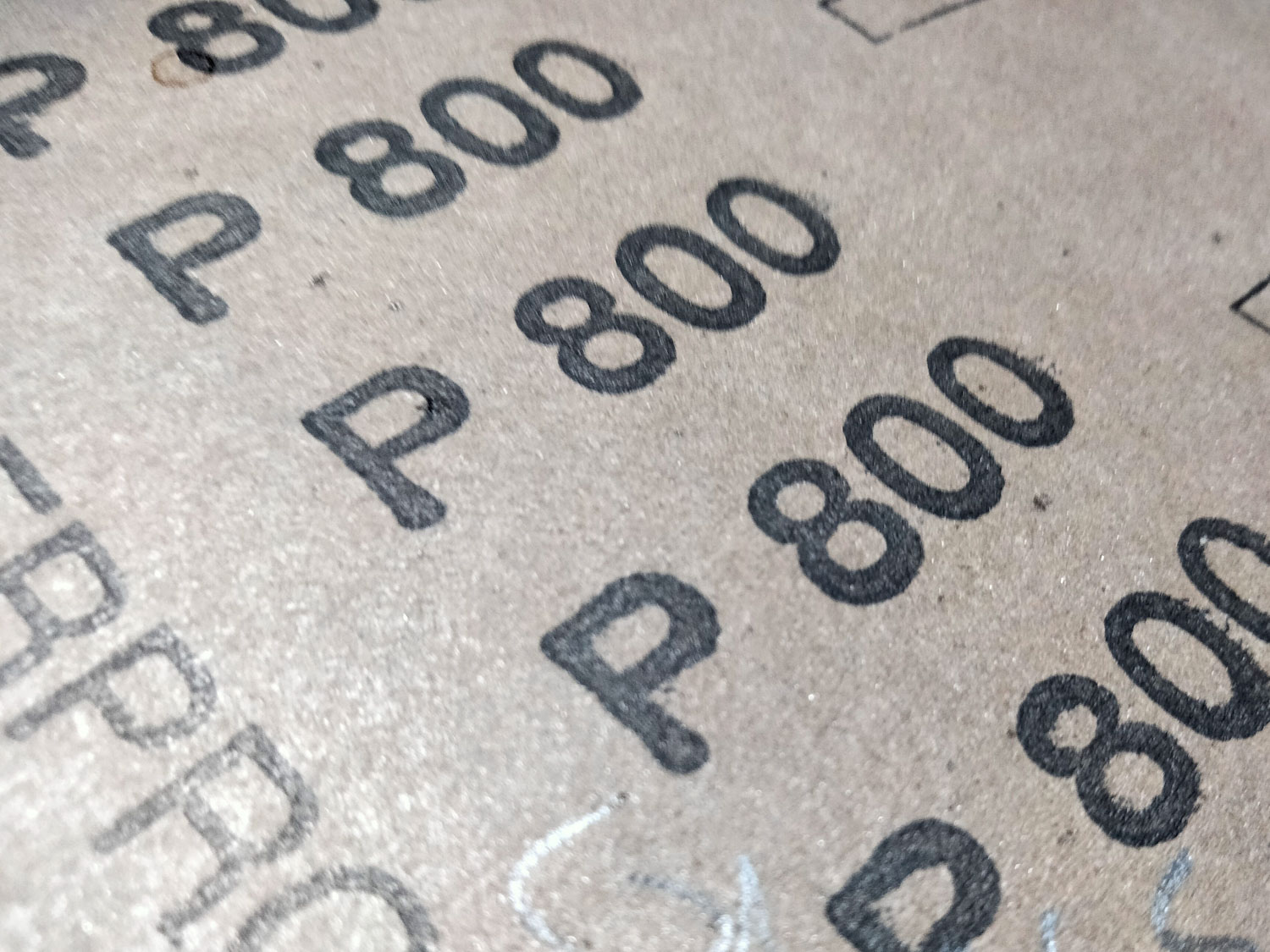

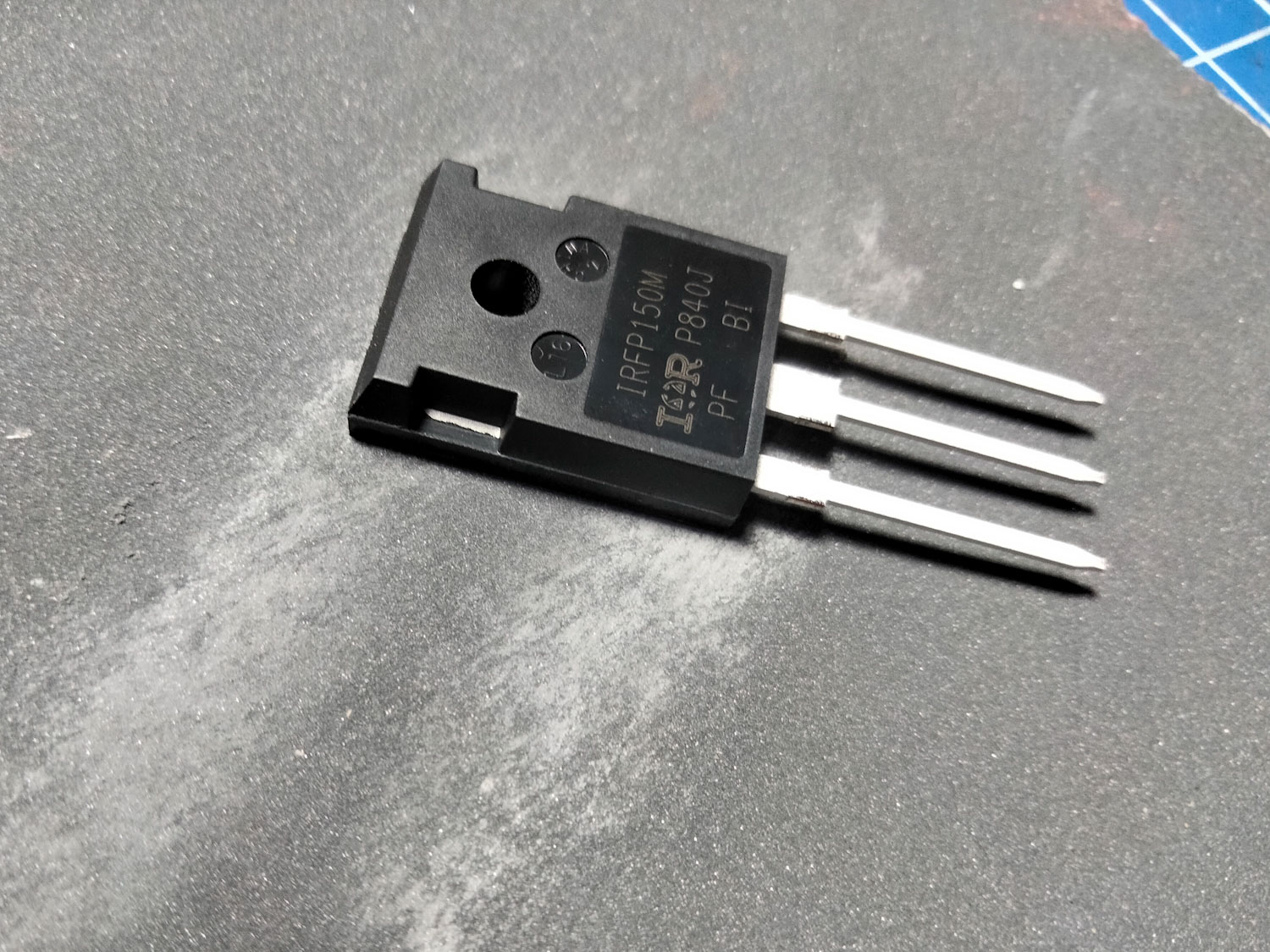

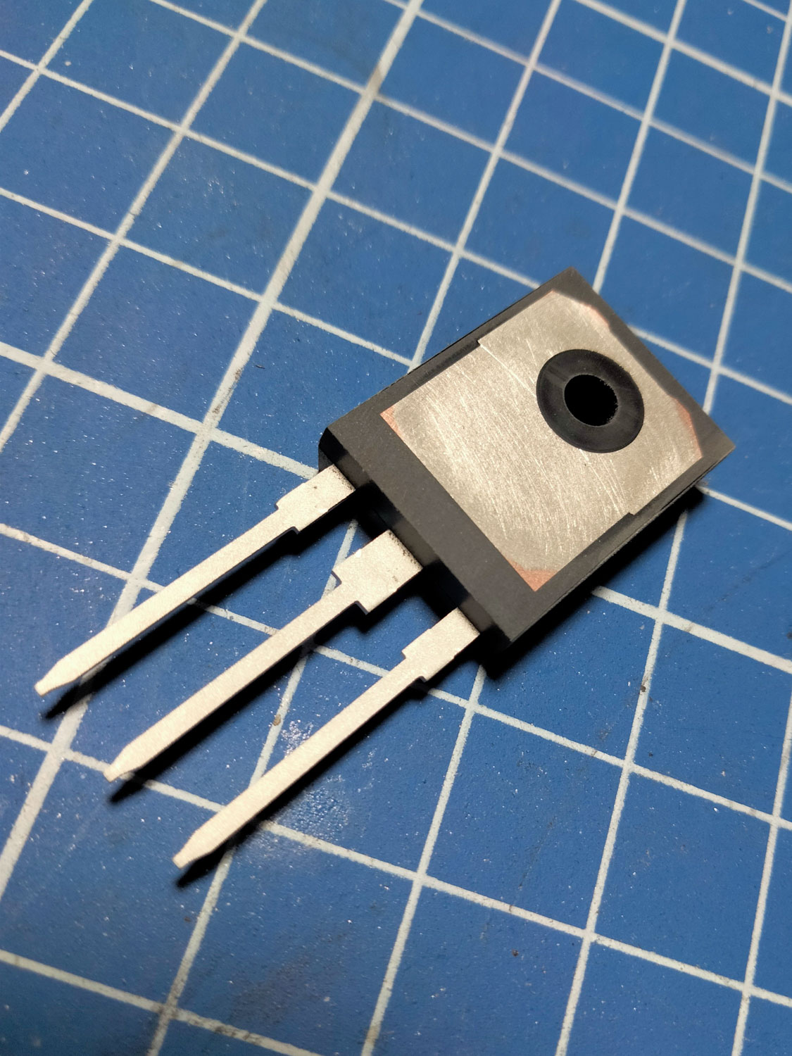

Little sanding for levelling the MosFets

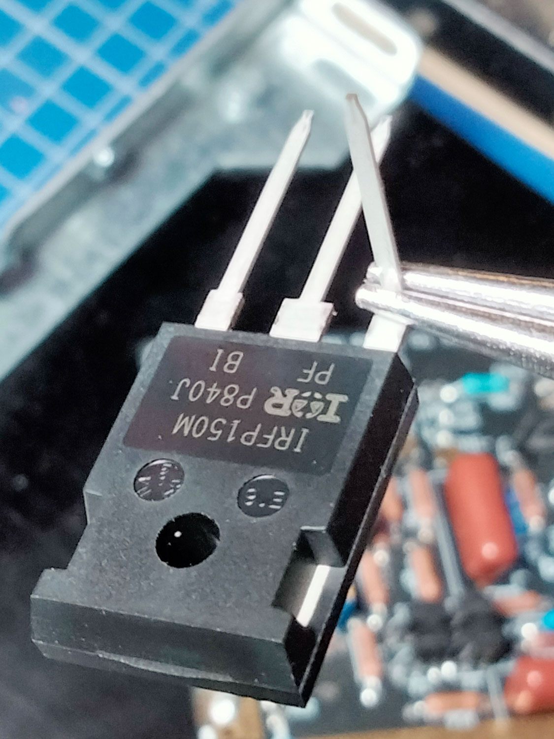

Bending da legs...
Trying with loose screws...
So, at this point, better to solder legs, solder wires from back and mounting it with gop and micas, washers and screws
OR
Solder legs, put gop & micas under mosfets, washers and tighten the screws, in order to solder wires from top as suggested somewhere by Jim?

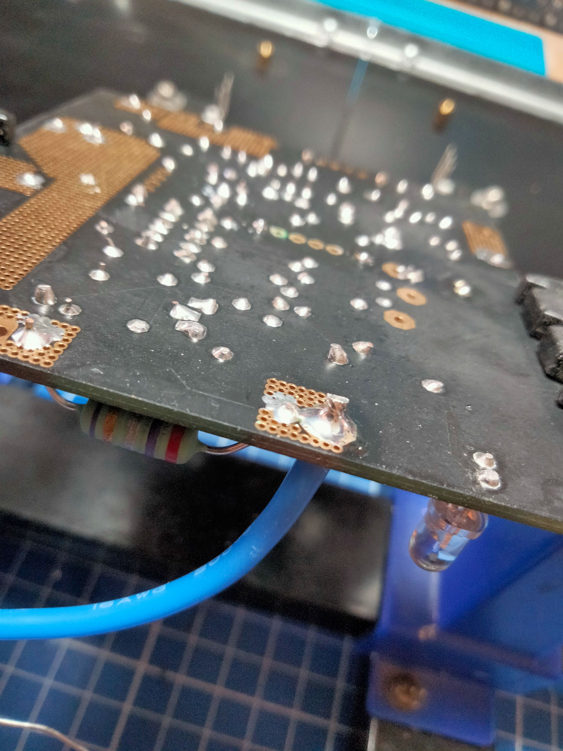

So, I will solder wire, put goop on micas and mosfets, adjust everything with loose screws, tighten the screws and solder the mosfets...

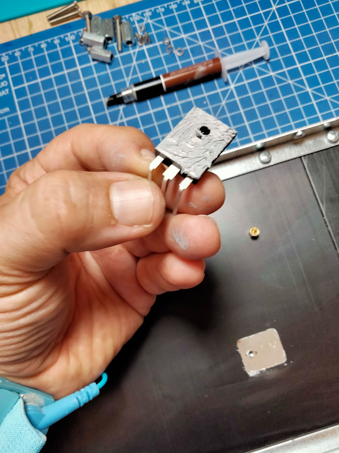

Hi all!

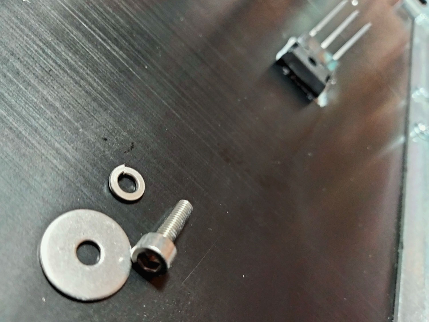

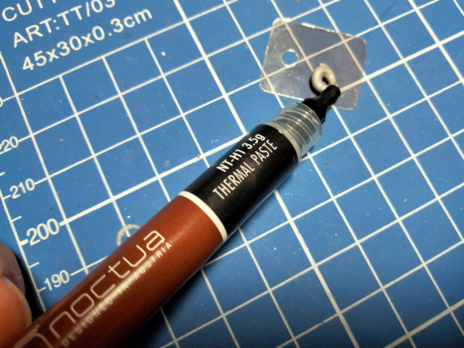

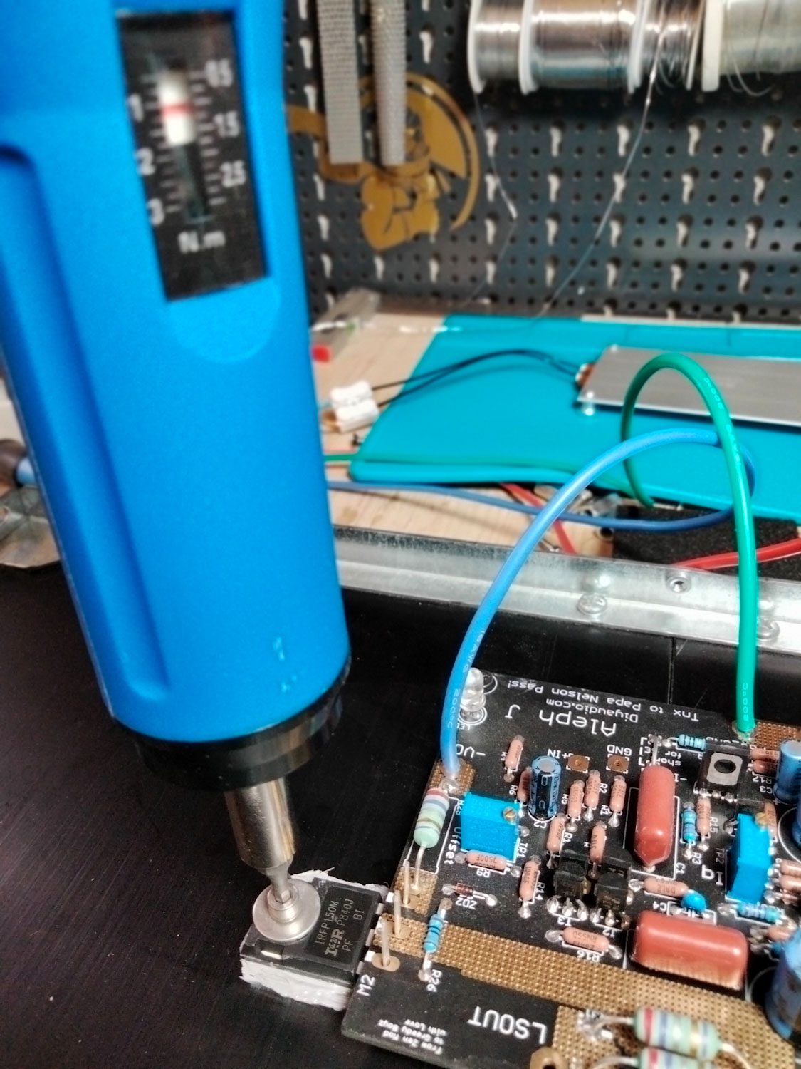

Goop on micas and MOSFETs...
Inox 10mm M3 Hex screw, inox M3 Split washer and inox M3 fender washer

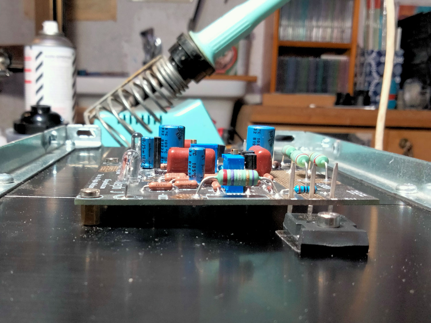

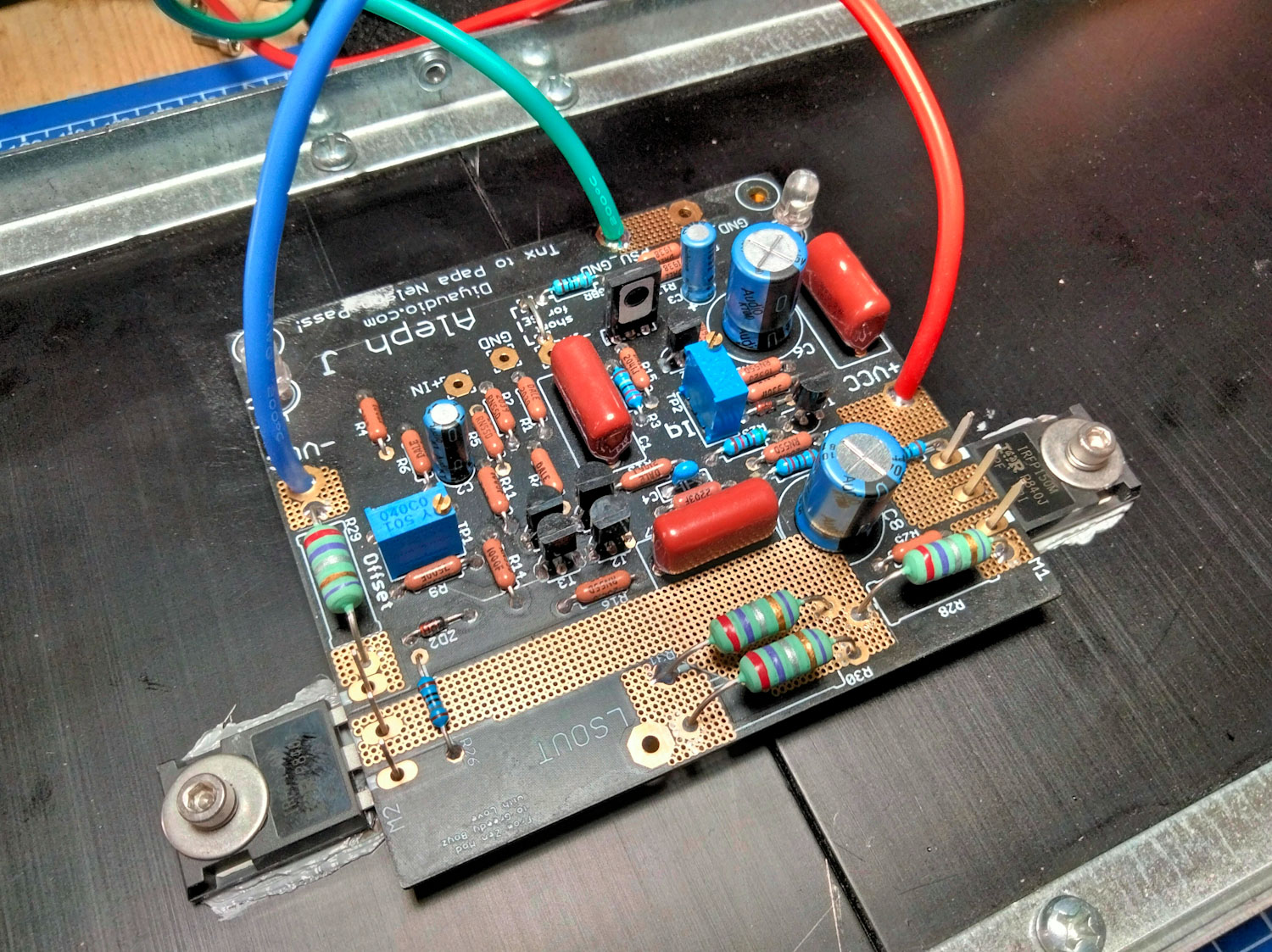

MOSFETs in place with loose screws

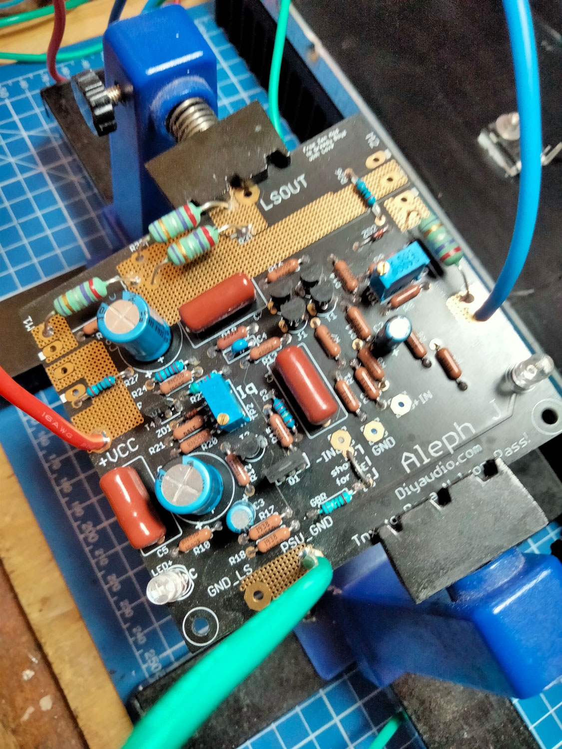

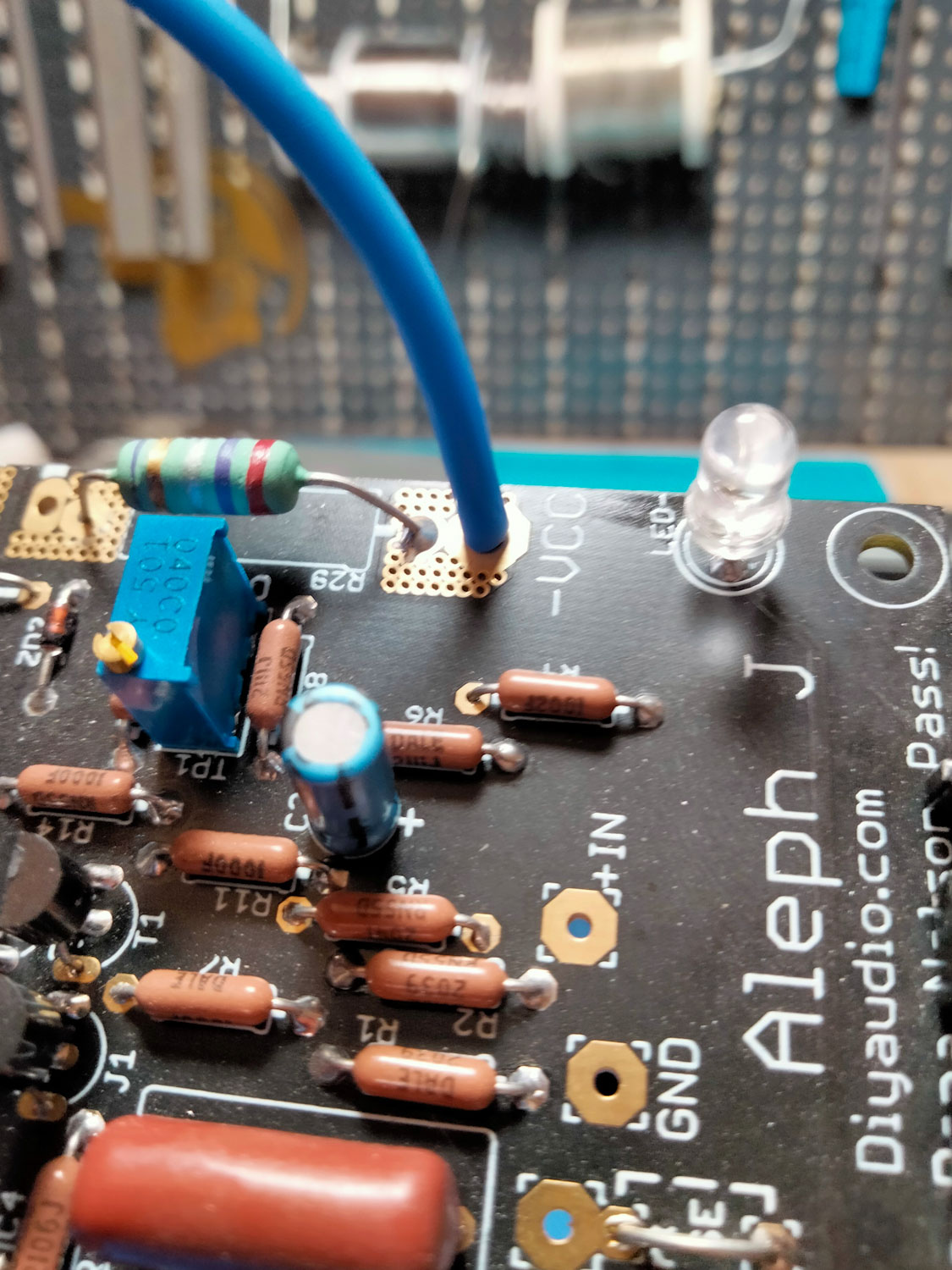

In order to facilitate wiring, I decided to solder PSU wire before, signal input and loudspeaker output wires after

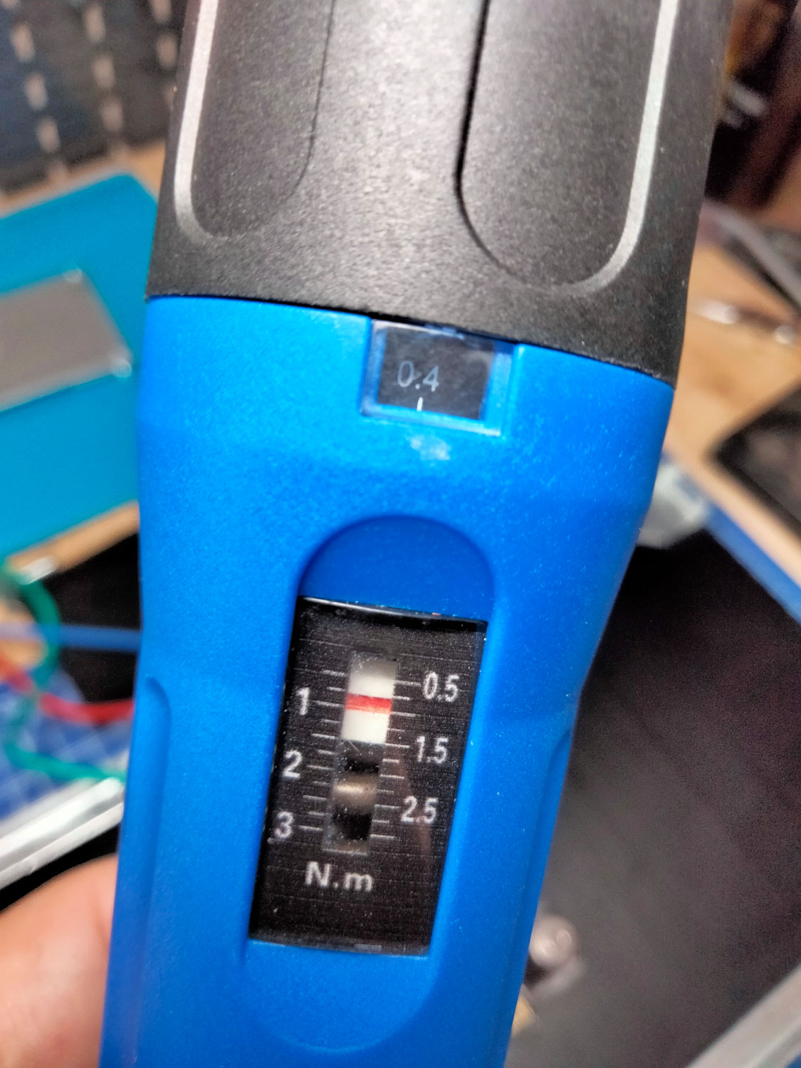

PCB ready for tightening screws
Set torque screwdriver to 0,9

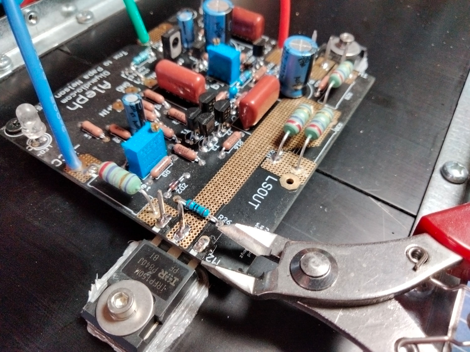

general remark:
bigger solder tip, temp cranked to max - that's proper way for soldering mosfet pins and power wires
fast and efficient, that's less stressful than endless gnawing with tiny tip and measly temp
edit: smaller size French wrench is handy to keep mosfet from rotating while torquing M3
mosfet pins - I'm cutting them rarely - handy to have them for measurements
