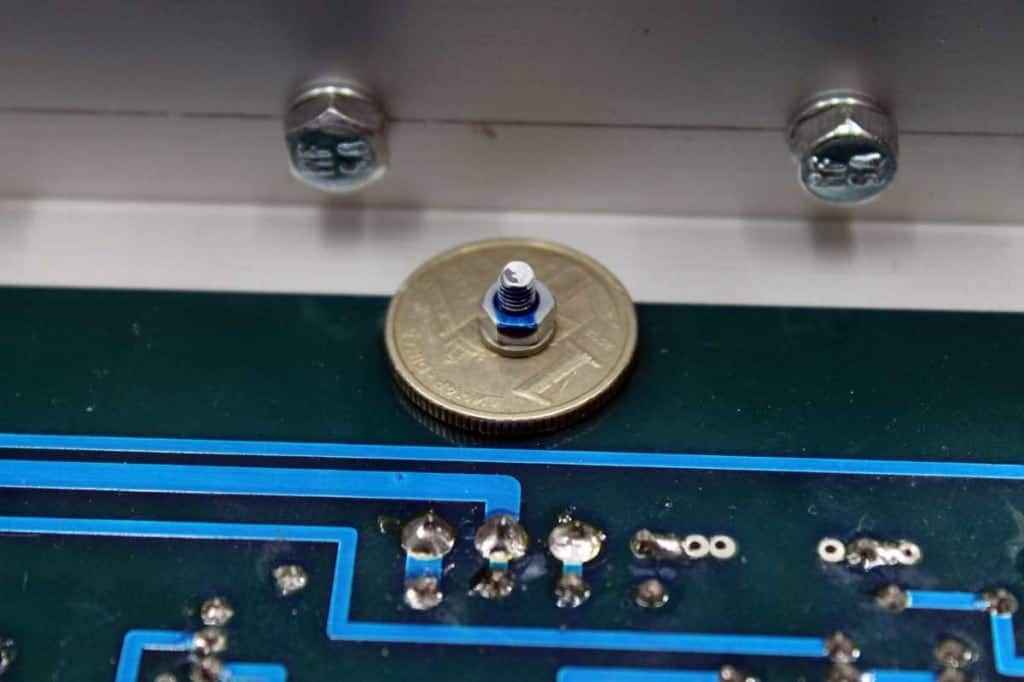

how you see it is not fet mount?
mosfet pins are there, big washer is with reason, split washer especially with reason
damn greenhorns .......
I'm always using split washers, especially if there is thermal cycling
and with A Class amps, pretty small part of case is not thermally changing in time
I wrote before - had few amps for repair , Dodo 35A metal diode bridge - beancounter didn't put split washer , bridge got loose, gone Dodo

I see it now, haha. Damn Batsch.
Yea, I have stocked up on split washers following your example. But not for fets. Luckily I have a ton, so they will go in.

Keratherm 86/82 is better than mica&goop, many times confirmed
Important : 86/82 is magic No./type ; got by Vendor mistake/error different type, paid unseen error dearly (repeated repairs until I didn't found what is wrong, plus Dodo pair of Dynaudio woofs);
but! - with Keratherm I'm finding that use of SissyTorquedriver is a must - even when torqued to 0.9Nm precisely, there is obvious higher pressure/indent in area around screw hole
if you screw with Keratherm too much, you're ..... well, increasing possibility to be screwed in the end
Keratherm , then Alumina oxide (plus goop!), then mica&goop
you say : "you always use goop" ......... yes, but you're evidently looking only at pics of my T-Beds; it's logical that I'm using mica and goop there
