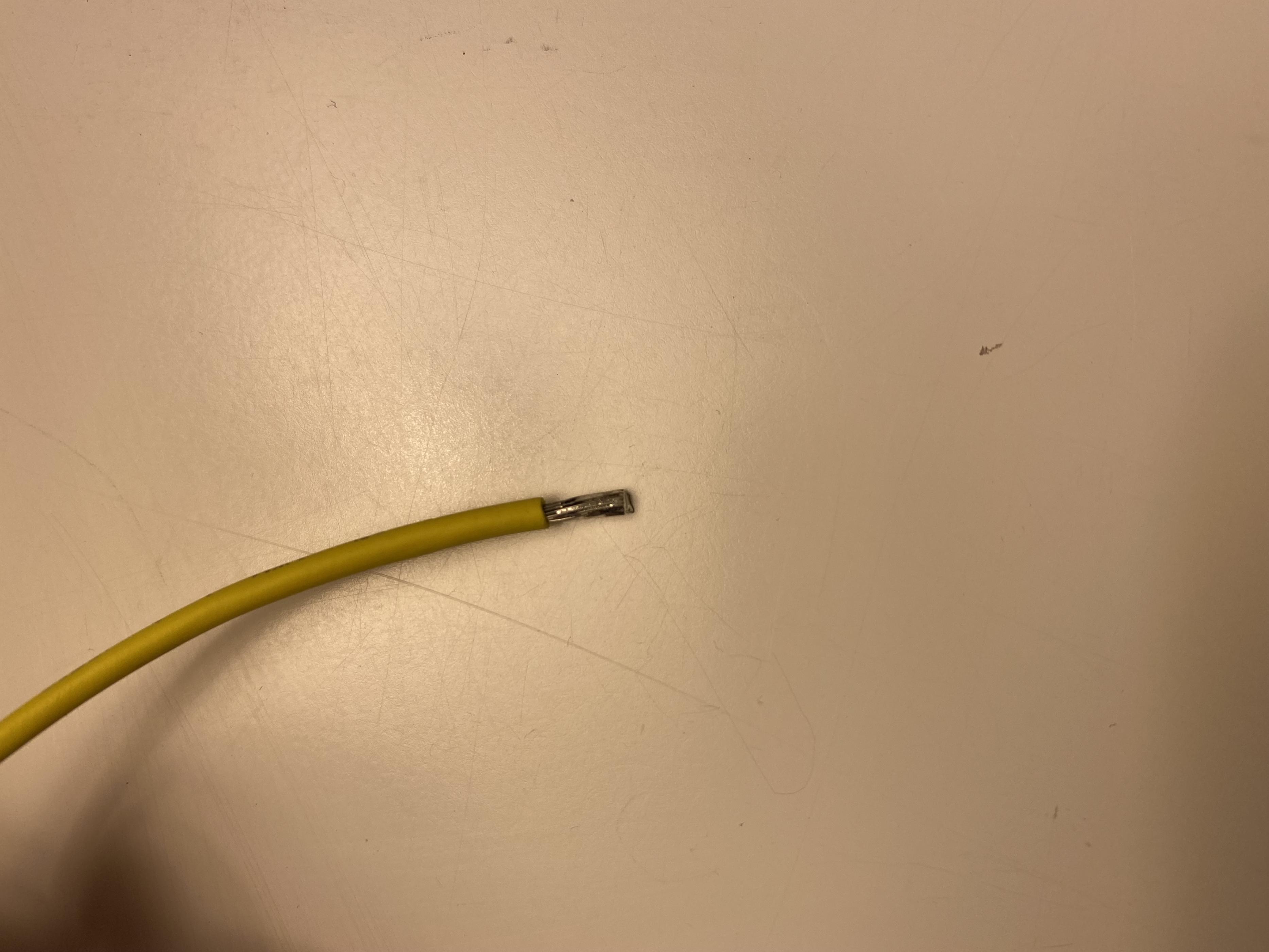

Q re transformer leads
I am about to wire up the first mono block in my Aleph J build. I am using Avel Lindberg 250VA transformers. The leads on the transformers are tinned. (See attachment.) My plan is to use crimp connectors (circular and snap on) on the leads. However, I have a vague recollection that one should not tin the wires when using crimp connectors. Is my recollection correct? If so, should I remove the tin before crimping?
Thank you for any assistance anyone can provide.
Jazzzman

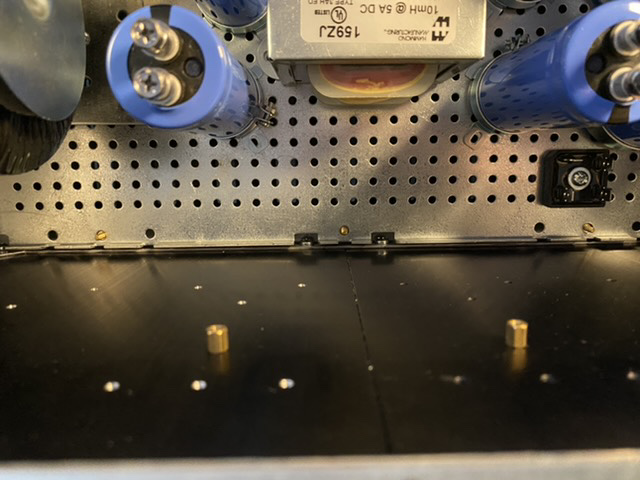

Far behind. But finally dismantled my BA-3 today, saving the boards for later tinkering and upgrades.
Seen here don’t look like much, and probably aint much, but managed to fasten the rubber feet through the bottom plate and heatsink frame by drilling the holes larger. Also included is ZM style spacers which I managed to mount using a star M3 screw into the sunk in hole - so that the screws are clear of the bottom plates. Spacers are standard China stuff, and a washer helps stabilize it.
Slooowly, but steady.
No boards arrived yet, but the PCB spacers have found their place in the sinks, Poseidonsvoice style, which happened to be my plan too.
Andy

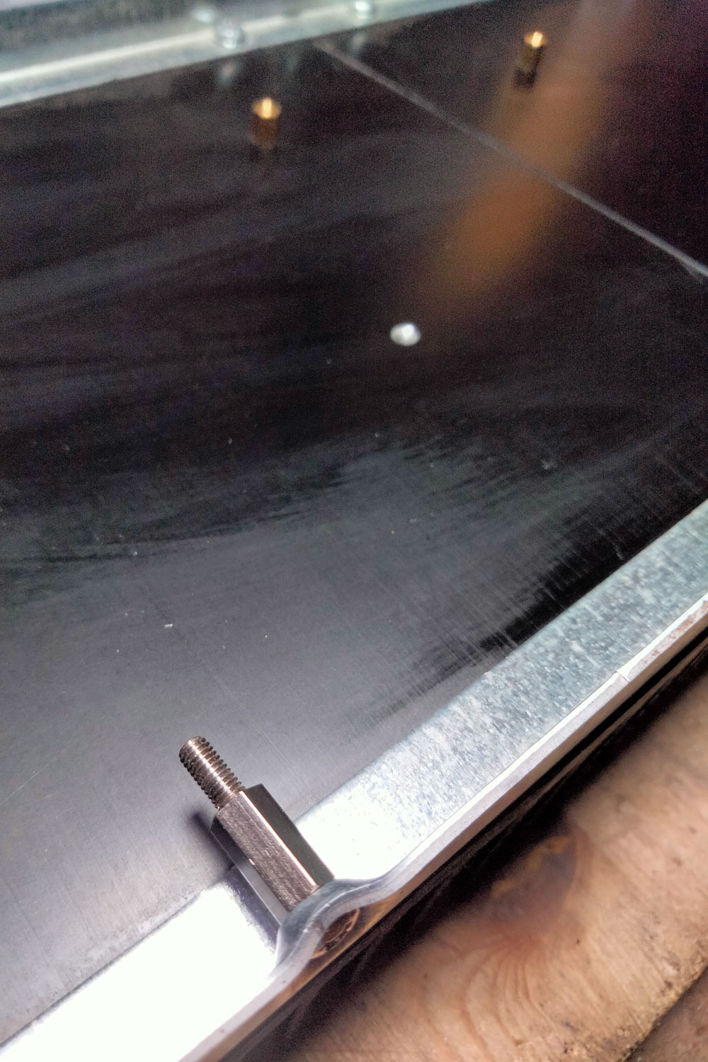

I tried your method but M3 stands seems too thin to me for donuts weight...
I put a washer right under the spacer to stabilize, and also I put in a third spacer per side - in the middle point (see pic). I expect it to carry a dual mono with 2x300, 12 porn caps and 4 x 2.5 pound inductors. They seem not to hold, or tested?
Unless you are using this? Google bilderesultat
:rofl:
Jokes aside: ZM’s approach is probably far more stable. A bolt and towered nuts to achieve desired height. Gonna try my way, and if it fails, Mightys way. I had many spacers on hand, so…
Btw your build progress looks fantastic!
