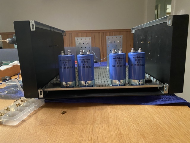

Aleph J Zen installed. Time to listen & compare.
Best,
Anand
Bloody awesome!

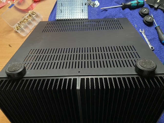

Far behind. But finally dismantled my BA-3 today, saving the boards for later tinkering and upgrades.

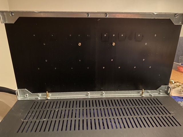

Seen here don’t look like much, and probably aint much, but managed to fasten the rubber feet through the bottom plate and heatsink frame by drilling the holes larger. Also included is ZM style spacers which I managed to mount using a star M3 screw into the sunk in hole - so that the screws are clear of the bottom plates. Spacers are standard China stuff, and a washer helps stabilize it.
Slooowly, but steady.
No boards arrived yet, but the PCB spacers have found their place in the sinks, Poseidonsvoice style, which happened to be my plan too.
Andy
Andy
And makes it very ease to slide the PSU section in and out, leaving enough room under it for P2P screws and AC cables. Thanks for the recipe/inspiration, Mighty!
