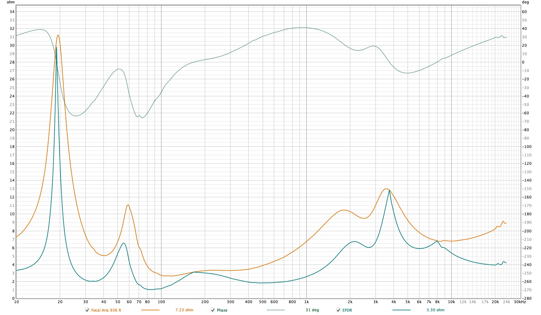

Ive found some focal aria 948 speakers for a banger deal.
But the only thing holding me back is that ive rad that they can be quit hard to drive due to a large impedance dip down to about 2.5ohms in the frequency range of 70-110hz.
do you think the aleph j will be fine for these?

I'm thinking a number of speaker manufacturers would call that one a "nominal 8 ohm load." Typically, anything north of 6 ohms gets lumped into the 8R category. This speaker only dips below 6 ohms from 150-300Hz (a small range of frequencies). Sure, at 125Hz we get the double whammy of 60 degree phase angle plus lower impedance, but the box tuning lies at 50Hz with a corresponding phase angle that is pretty close to zero degrees. Most "reasonably" robust amps will be pretty happy with this load.

OK so I'm unable to find a graph with the 948 measurements. But they supposedly measure very similar to these aria 936.
936 is slightly easier to drive. But not by much from what I've read
I'm unsure what the aca puts out into 4ohms. But aleph j is about 12.5 watts

BenE: as ZM was indicating earlier, you might want to look into push-pull amps with impedance curves that dip that low. This is especially the case with that blue curve that seems to spend lots of time between 2 and 4 ohms. Single ended amps may struggle more with these designs.
Ahhh okay, makes sense. Thank You for the clarification Eric! I've been eyeing up building an f4 for a while, so this is as good of an excuse to make a new all as any. But I'll do some research into a few others too and then decide

My apologies if I misread the graph. I thought the dotted line on top is phase and the two solid lines at the bottom are impedance curves for two different speakers…
