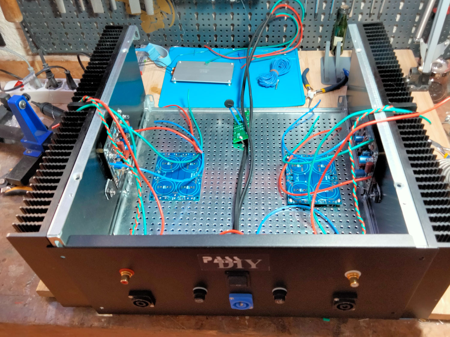

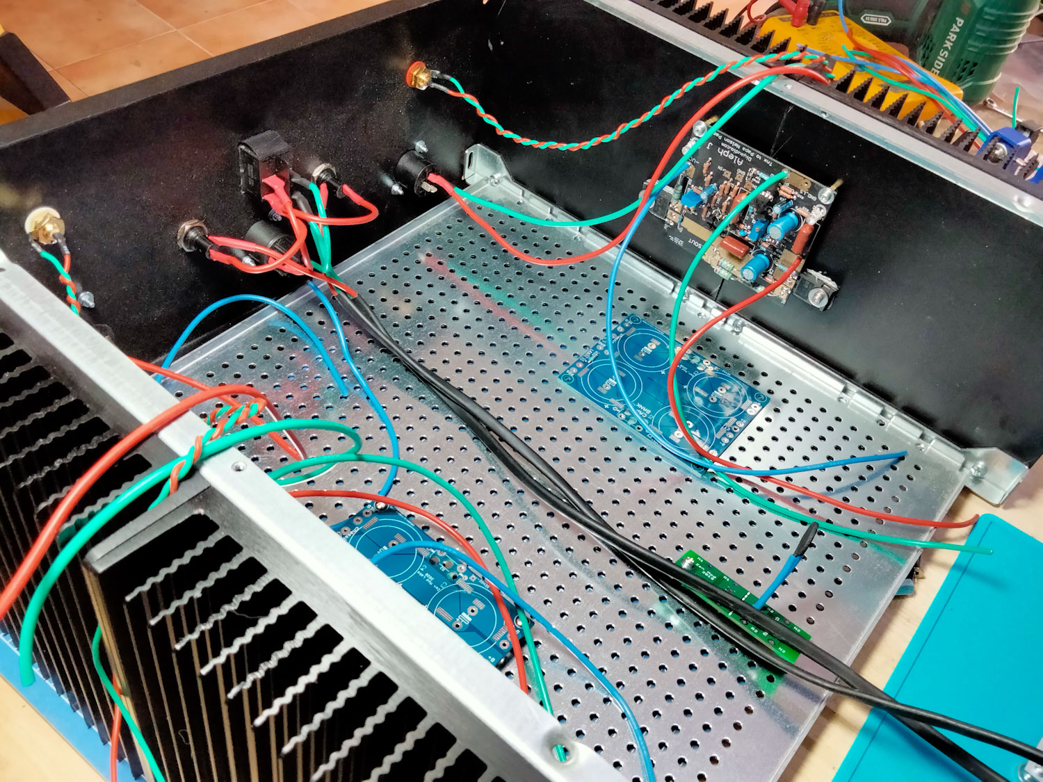

Bad news, I joined the dark side, just ordered these goodies! You will learn to hate and avoid me as I have plenty of questions on my first 'real' build!!! Thanks for the support and encouragement!

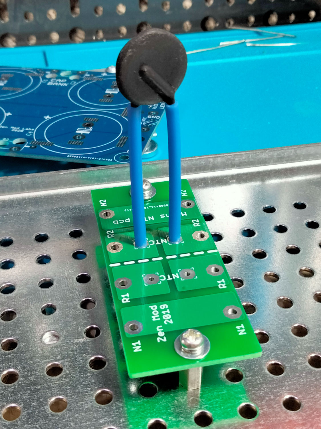

@ZM: NTC to chassis in pcb has little lead spacing: as I need two thermistors for the purpose (dual mono), I can order only a CL60 for primaries pcb and sometimes more adapted for GND position. What do you use on this board?

find ones of 10mm Dia
Is this ok?
https://www.mouser.it/ProductDetail/Ametherm/SL10-2R505?qs=PVyXUKBeRH3tC2uwKpKe4g==

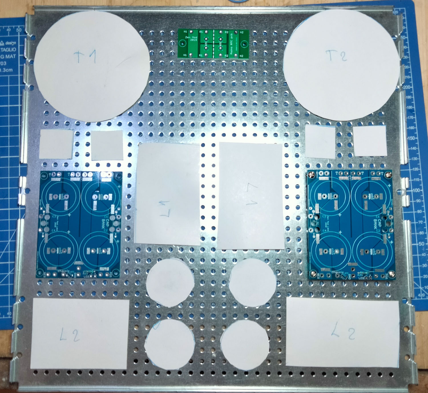

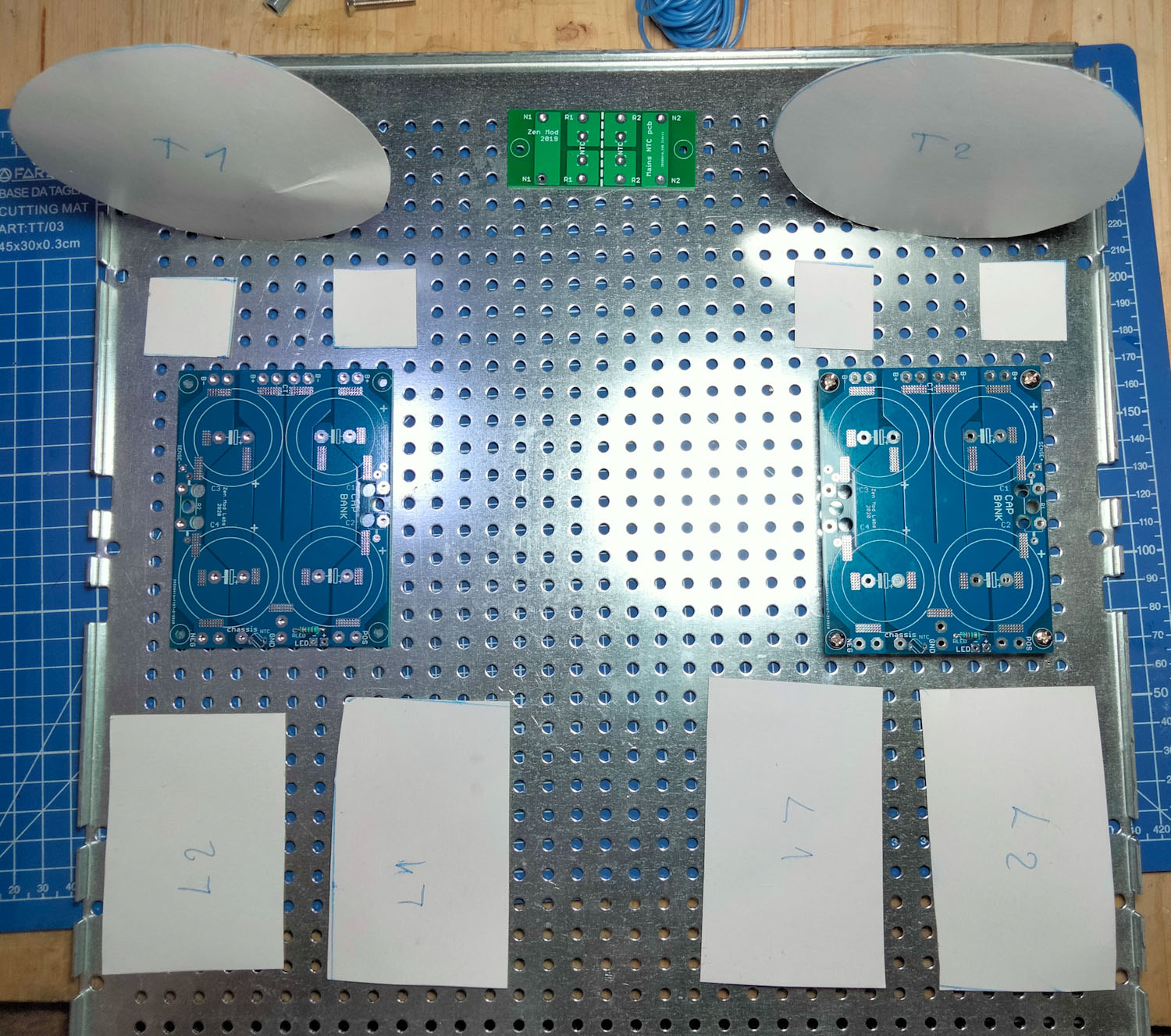

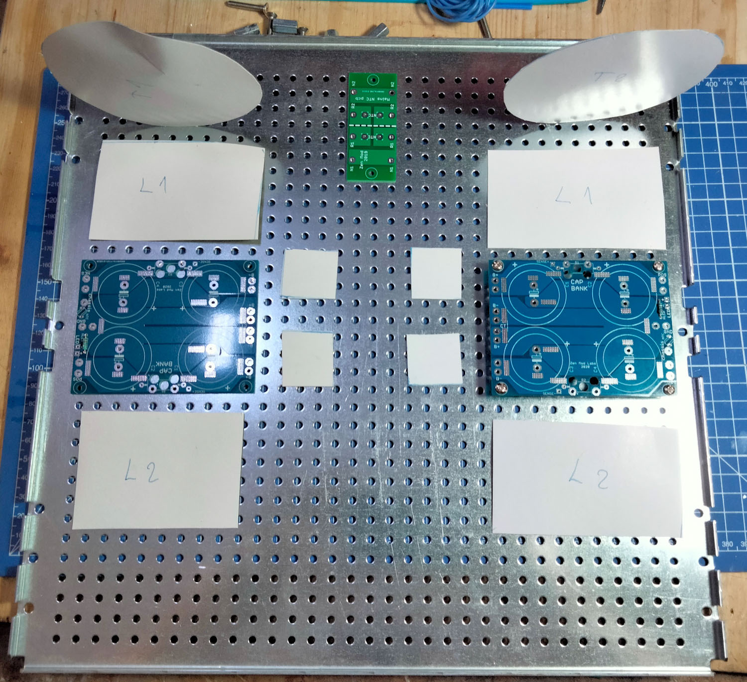

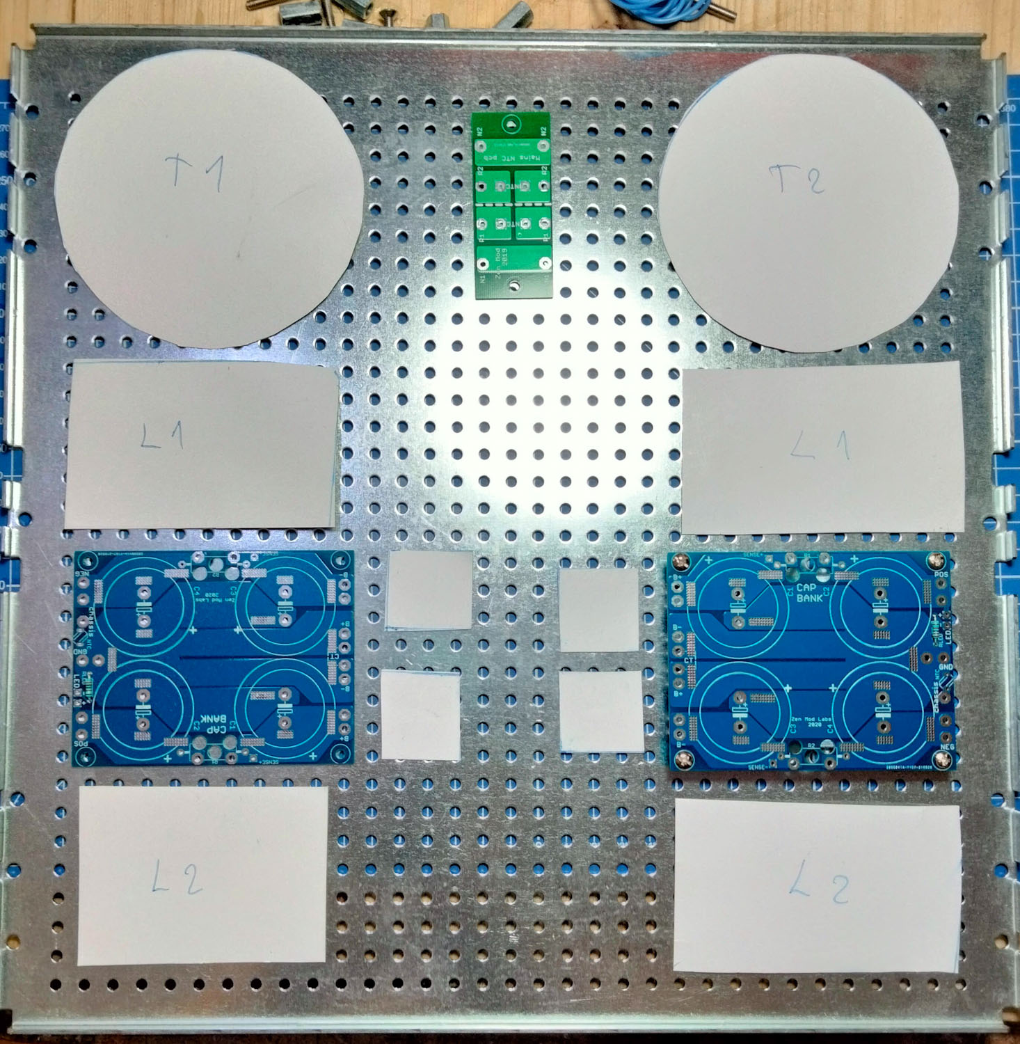

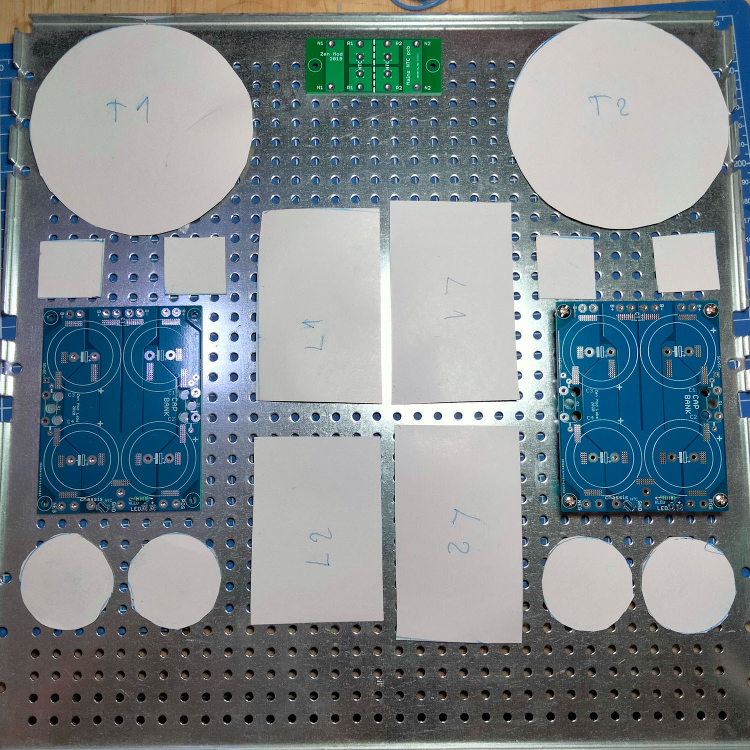

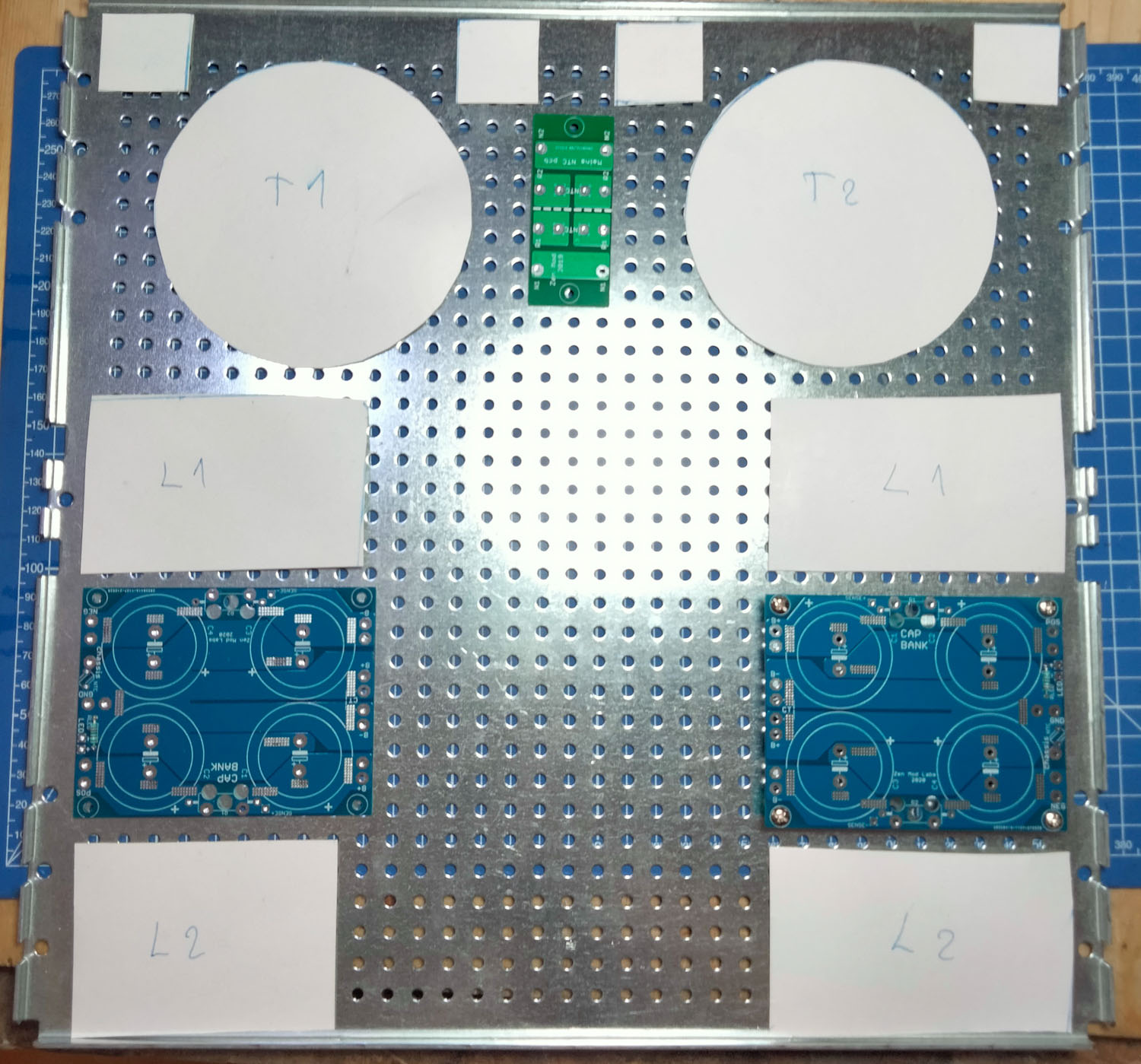

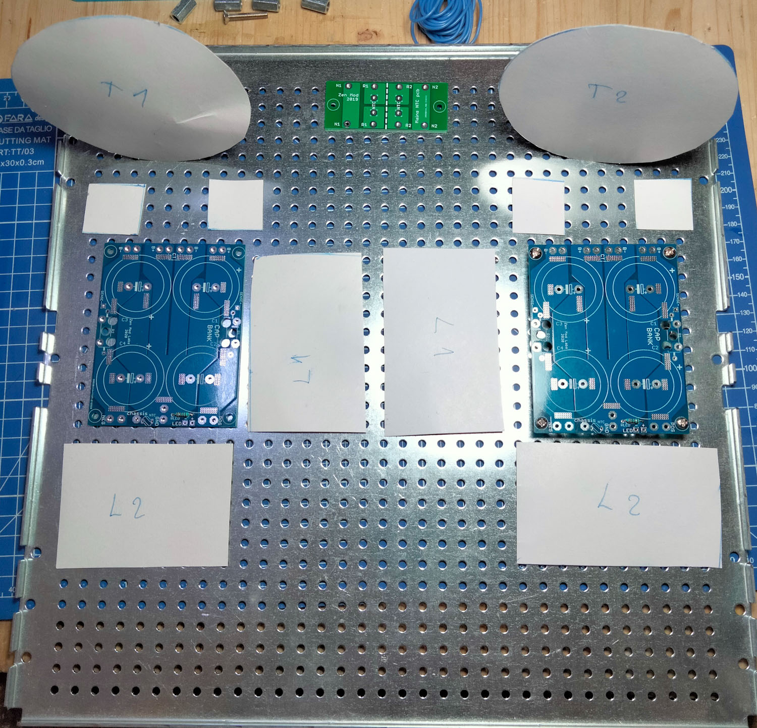

Thanks. Better 90 with chokes near the back panel or with chokes on sides?
The chokes are „instead“ of the 0R1 resistors, so one left one right? Why not turn the cap-bank 90° and make choke-capbank-choke? Symmetric and aligned…
(PS: you could hang an Italy-flag onto the long-legged cl60, or make a clothes-line between the 2 😉 )
