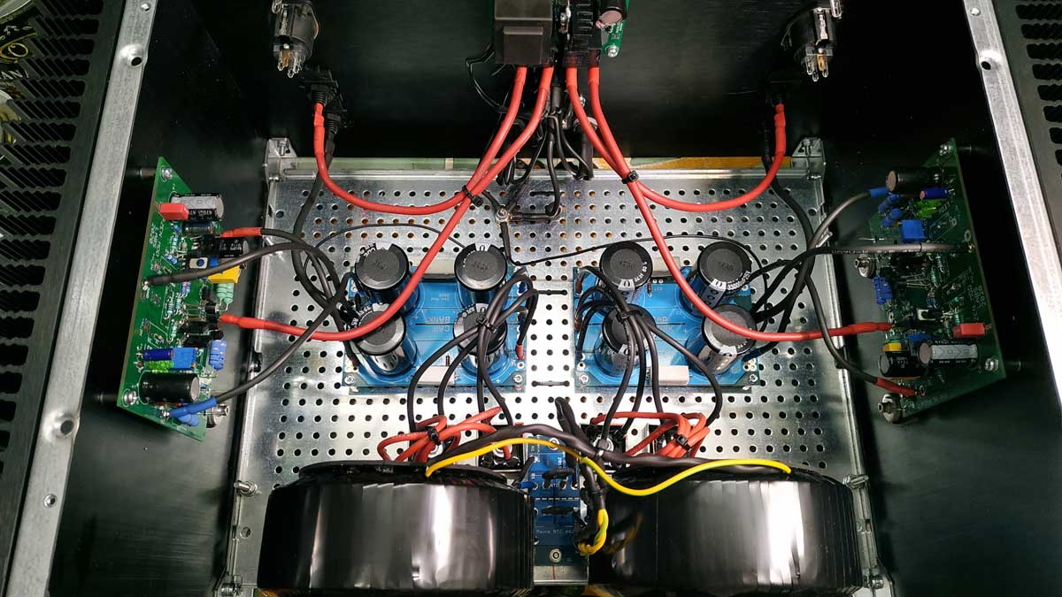

Depending on how you have to connect your inductors to the PCBs, I would consider placing them at equal distances both from each other and from signal wiring, while at the same time not having them close to the back panel. The wires will have some ripple on them, and also the inductors can have a magnetic? field affecting circuitry and signal wires etc. also, bridges should be kept close to center of chassis, and equally far away from signal wiring etc.
As for the the runcaps, I would keep those. Think about Mightys layout. Main difference to yours being inductors: how about putting the inductors under the PSU PCBs? Wiring will be short, place will not be an issue. Inductors are easier to place in a P2P PSU, since with a PCB you need the inductors on the sides of the PCB, or you will need to extend their wires.
I am putting my bridges between the transformers, saving space and keeping them far away. Excited to hear what Mighty thinks. I most like the last one you said looked good up there in the earlier post, of the ones posted.
Edit: that is the same one ZM liked best. Go for it!

Those snubbers are infact R+C’s, if my eyes serve me right. If you look really close at the yellow shrink, they are a tiny bit thicker on one side. Mightys mighty solder skills at work.
If I were you, I’d go for suggested solution, and extend inductor wires for furthest rails if needed (solder only). If the amp is quiet, be happy. If not, you can consider inductors under PCBs. That will move bridges and the whole PSU a bit further away from the circuit, and possibly enabling you to twist some of the inductor wires together.
Very nice, Mightys CRC gone CLC without major layout changes.

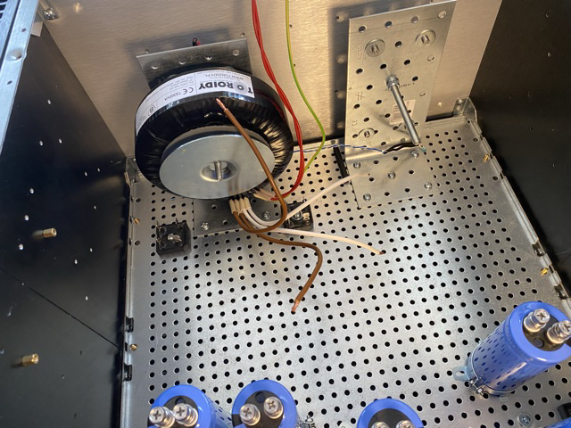

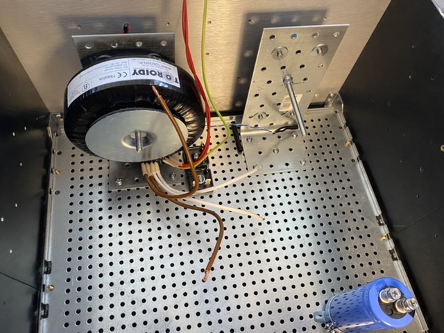

I know you have limited twisting OCD, compared to some. Papa does too, ref to FW builds. However his bridges are always put at the back of the chassis. I think I am OK/good either way, but the two pics attached show two alternatives. Practically speaking, one bridge on each side of the tranny, is preferred, if distance to PCB is OK. Distance to first MOSFET measured to approx 7 cm.
The other solution, between trannies, is obviously the quietest, having all the worst ripple carrying wiring in one place as far away from sensitive stuff as possible, approx 20cm. But space is a bit tight.i could easily make it work though, and also there is room to move the trannies further from each other.
Why this challenge? Many, many caps. A proper BJ needs big caps :rofl: So no space for bridges in front of trannies.

move your donuts all the way to front
that way you'll gain few cm, then put bridges in front
you can also mount L brackets for Donuts from underside, there is enough space from base plate to front plate

Softstarts behind them is reason why they aren’t all the way against the front… will contemplate… bridges placement is the compromise, or loose 100.000uF 🙁
Perfect solution would be your NTC board between trannies, and suggested mounting from under the bottom plate. You sending? I did order a blank PCB to make NTC board myself. It sid not have cooper in it, so not usable for mye purpose… Greenhorn.
Edit 2: Haha! Funny. That is just the solution I have been making in my head, needing your NTC board since connection block is unwanted. But every time I ask about PSU parts you dodge my question :clown:
