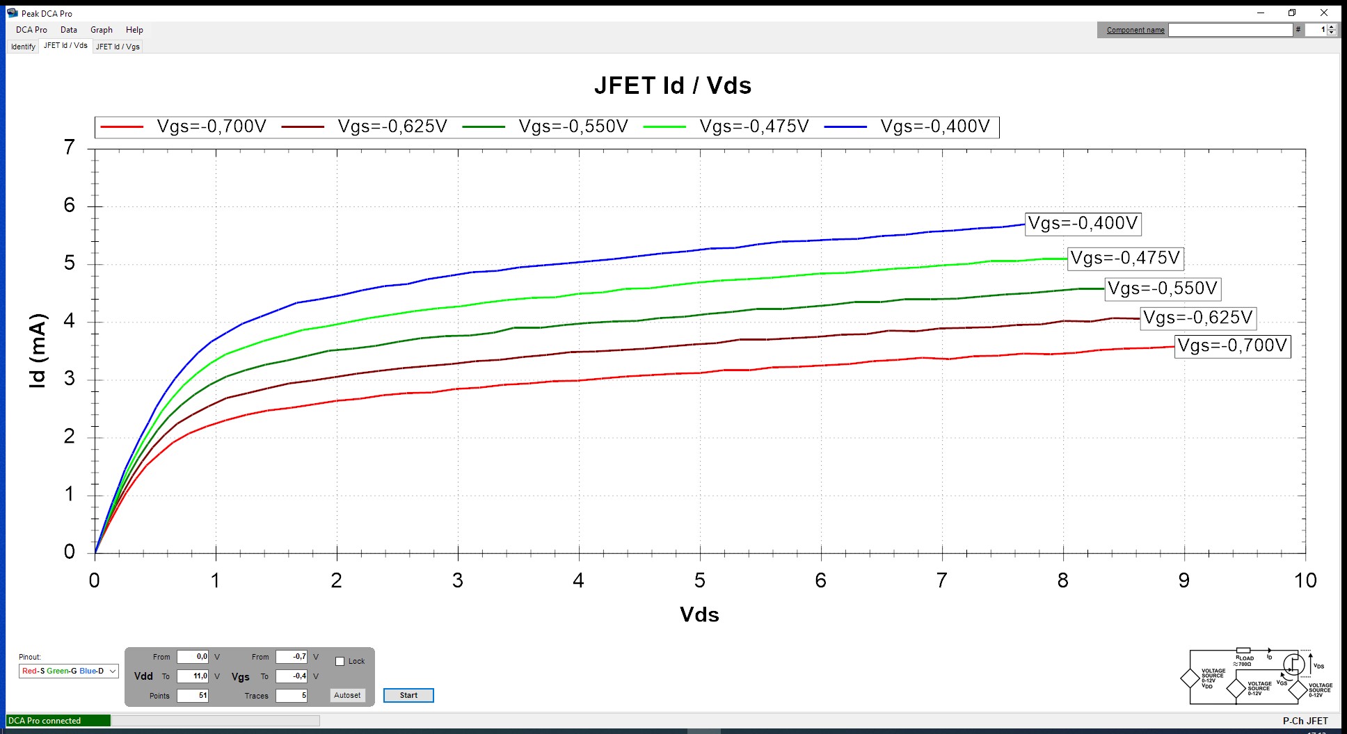

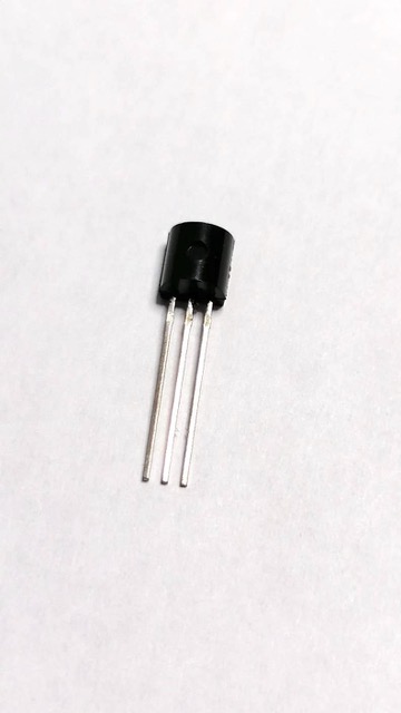

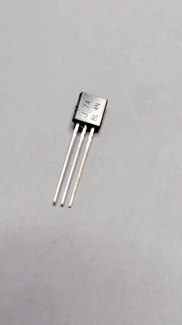

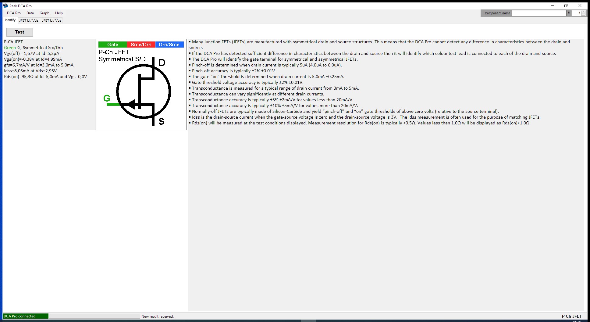

Hello,
i am a new subscriber and i intend to assemble an aleph j amplifier, i have a question for you, i have purchased 2SJ74-BL transistors. not having certain elements to be able to make a comparison, I relied on a test carried out with DCA Pro, these are the results, I wanted to know if you think they can be used.
Here are some pic of the tests performed out on one of them.
Hello,

tricksters,
If they are genuine 2SJ74BL then they will work fine. I suggest you do not match
base on the measurements from the DCA pro. There is a note about that on the
jfet matching page of the diyaudio store:
JFET matching information – diyAudio Store
Instead I would suggest you measure the Idss of your parts using the
simple voltage source (can be just a 9V battery) + resistor method mentioned on
the same page. You can then match based on those measurements.
