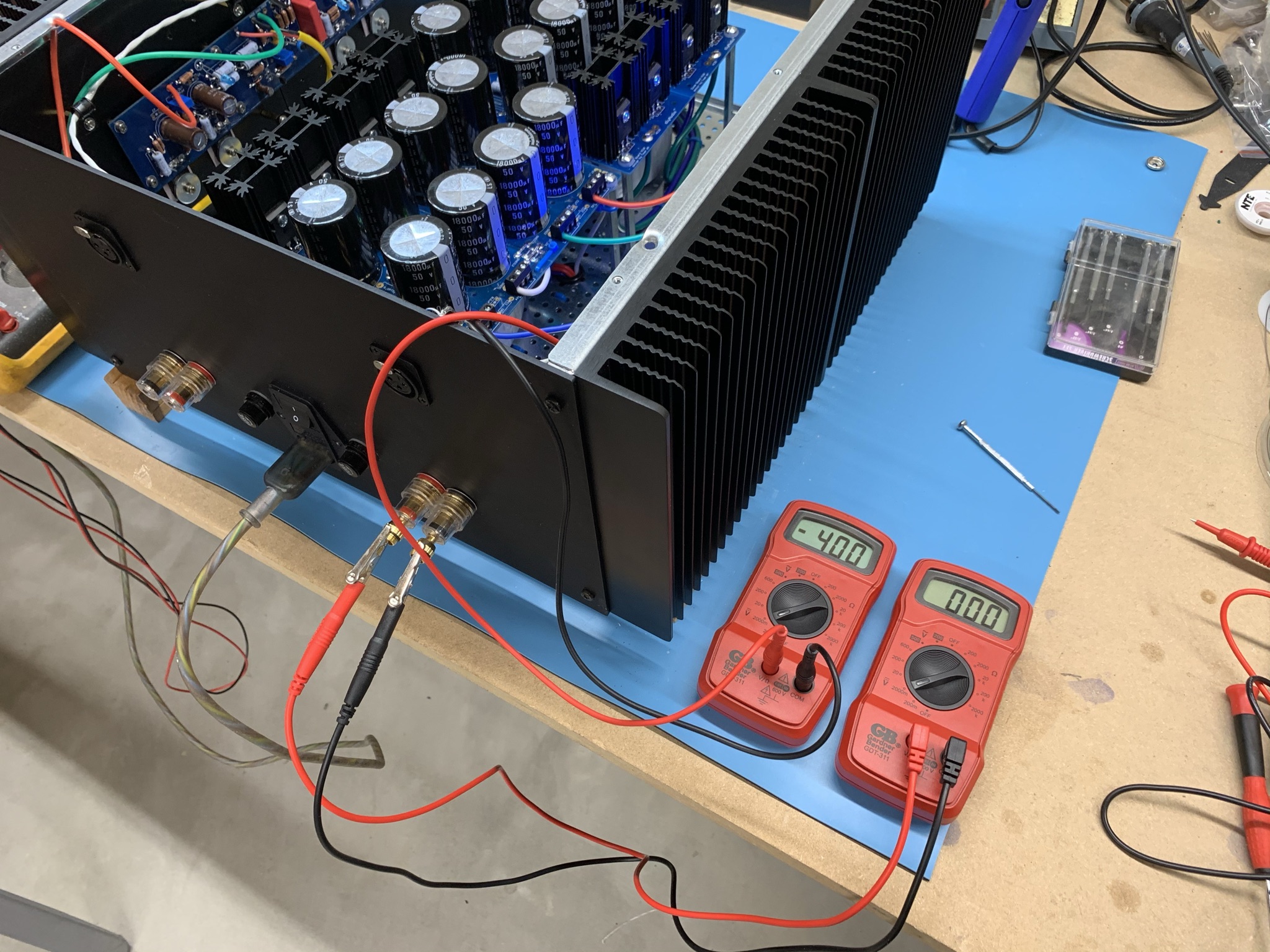

Since most of the parts are already here, I am going to build my first release into a smaller chassis that has 3U/300mm heat-sinks on either side. I don't think I can run it like that for more than 15 minutes or so. Would it be possible to lower the bias to compensate?if similar to Modushop heatsinks, expect 55C with 80W of heat
Would that be 0.4 to 0.5A or 1.4 to 1.5A? Per channel or per transistor pair?lower bias to, say, 1A4 to 1A5, and make Babysitter
then observe temperature again, and increase Iq accordingly
I am confused because 6L6 wrote in the beginning of this thread that the quiescent current of just over 1A might need a fan for 4U case.
Edit: Is the difference due to "per channel" vs "per transistor pair"?
500mV bias = 1.06A = 22.55W/device. This is hot. You could not do this if you build your amp in the 4U chassis without a fan somewhere.
